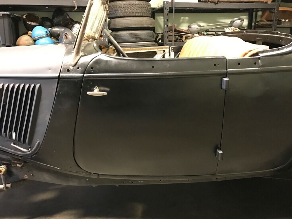

    Door tops and cowl top look like rounded off closed car (Squirrel suggested Vicky and may be correct) as they don't have the Roadster reveal or curvature.

    The old saying don't throw the baby out with the bath water comes to mind...yeah if those were roadster parts it's a no brainer but...I don't think they are...so if not they are either a clever modern welding and patina job or a piece of 1950's leaded art! Mysteries will be revealed when you have a look under the cowl/dash and behind the door cards (like why is the body bead pointed on the cowl?) if it's the former so what?...cool '33-4's have been built starting with less ('33 roadster being my favourite Ford) but if it is the latter that's what the HAMB is all about! Back in the '50's it was not at all uncommon to see a model 40 stuck on a Deuce frame! In fact at a certain point in time it was all the fashion...especially early '50's east coast... therefore it is traditional. So now you have a simple job of hacking off that fugly *** end whether it was done in the '50's or '90's it's gotta go...the cool thing is you can lengthen the ****pit area by leaving part of the panel behind the doors when you weld the '34 coupe 1/4's on...you might even be able to use the trunk lid skin...and here's the very best part...you get to drive it the whole time!!! yeah even with the *** end hacked off you can still make it to cruise night as long as the taillights work! who ever gets that luxury? especially when it comes to those long term "lose interest" projects...this thing is done except the 1/4s! Happy motoring...

    After peeling back the plastic interior panels, I am about 99.6% sure it is a phaeton that had it's rear door skins and back panels sectioned into several pieces and welded back into a two-door tub of sorts. It's hard to get pics, but the top rail of the body is not fabricated, it's stamped that way. It aperars the rear door skins were de-hinged and welded to the center posts.

    I can't get the rear interior panels all the way off without removing the seats, and I'm just not into that tonight ! I tried to get the best pictures I could holding the panel open. The hammer-welding looks pretty good !

    I think the door post mean Phaeton also, because it has the (now hidden) provisions for regular opening doors in back, not suicide, what other 33-34 Ford would have that ?

    Anyone with more experience than me that can look at the additional pictures I posted last night and confirm my su****ions that its an open car cowl & doors ?

    @Elvis100 ? have a look at some of Elvis' posts on door wood...
    I'm intrigued by the Ozzie body idea... @drylakespeedshop were phaeton door tops from downunda similar to these?
