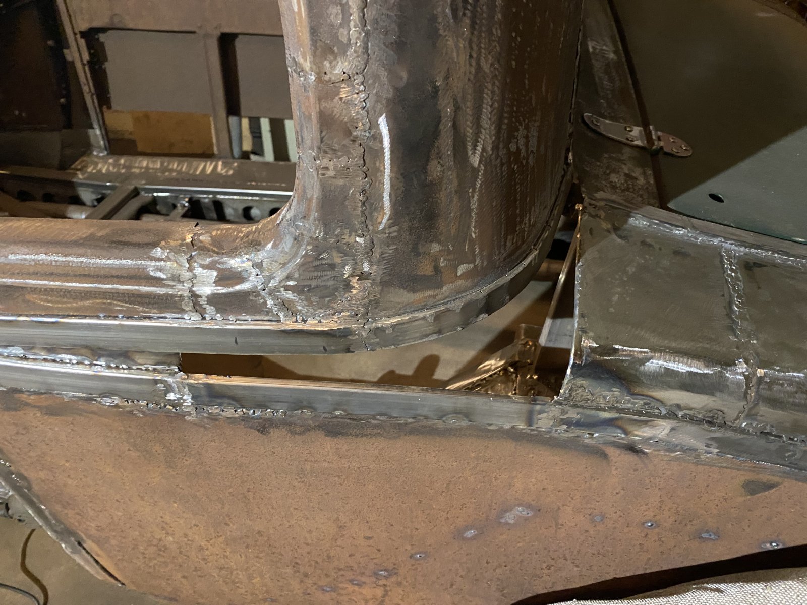

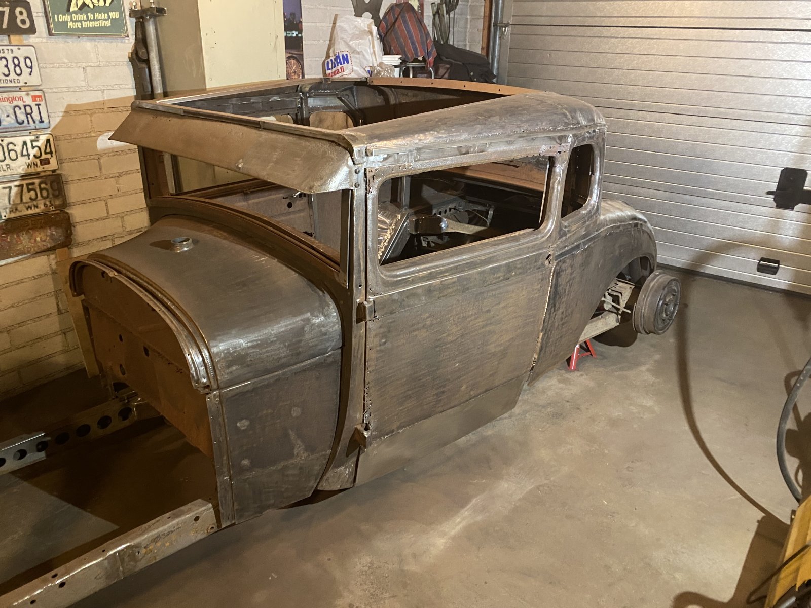

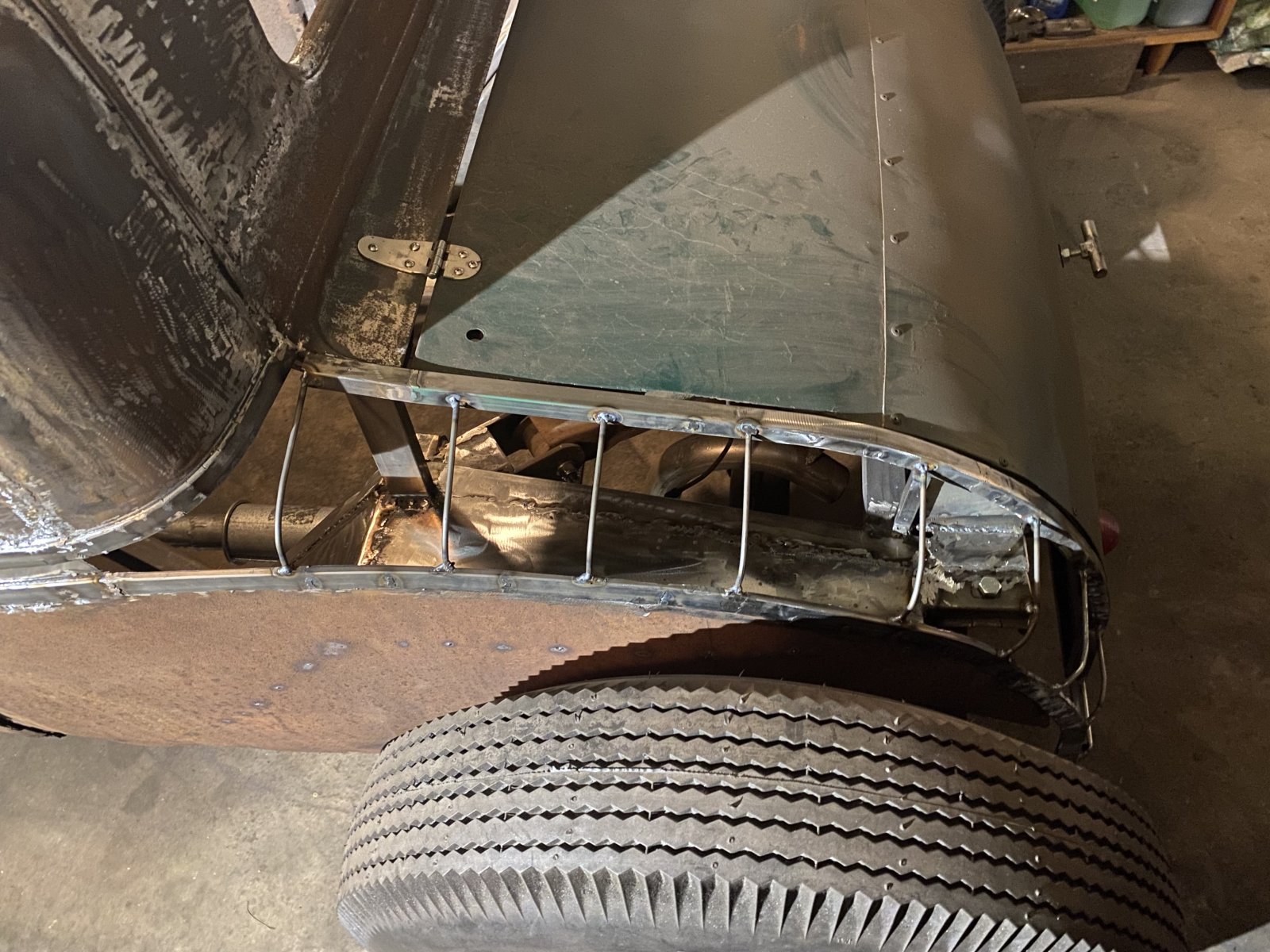

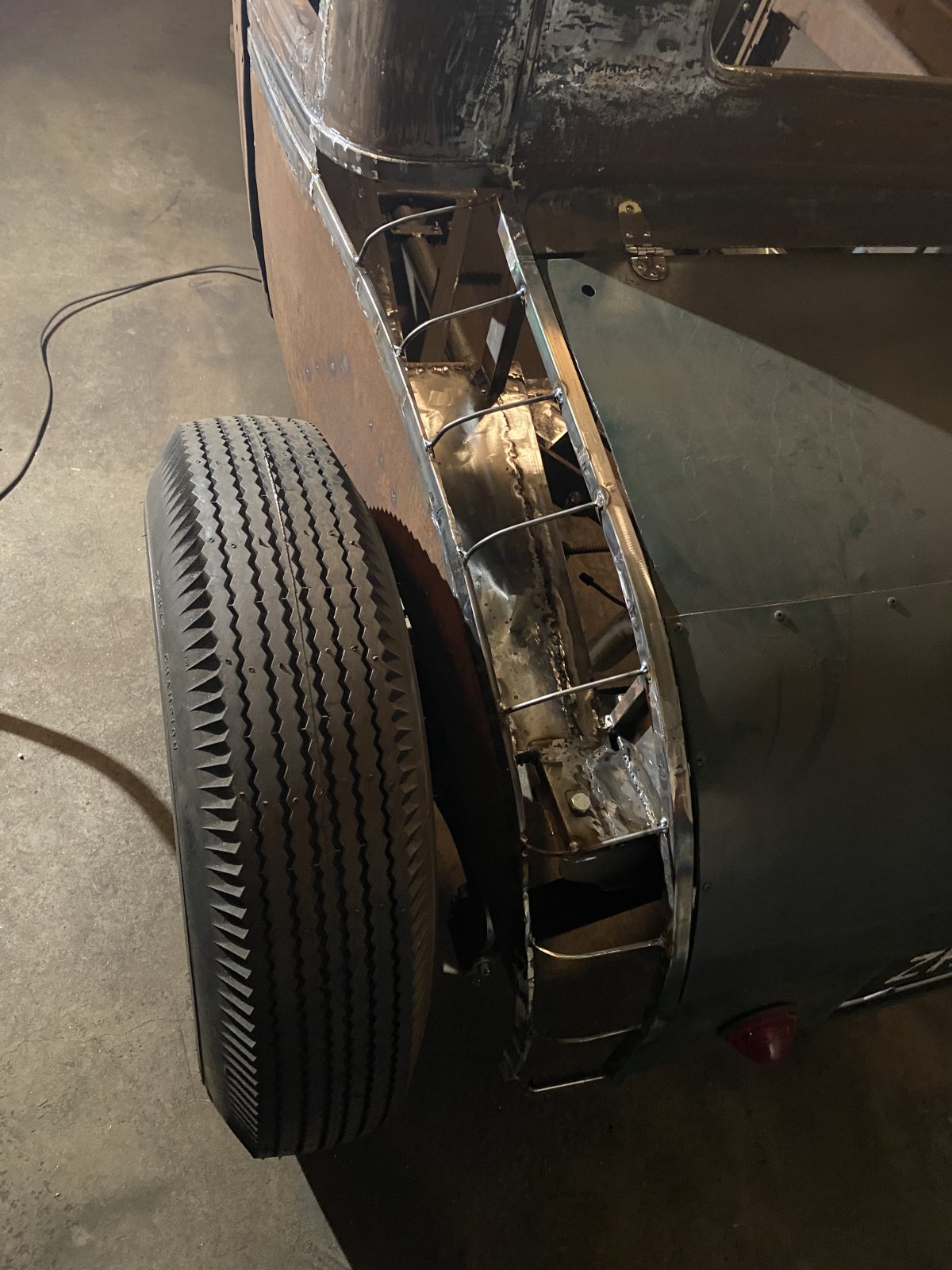

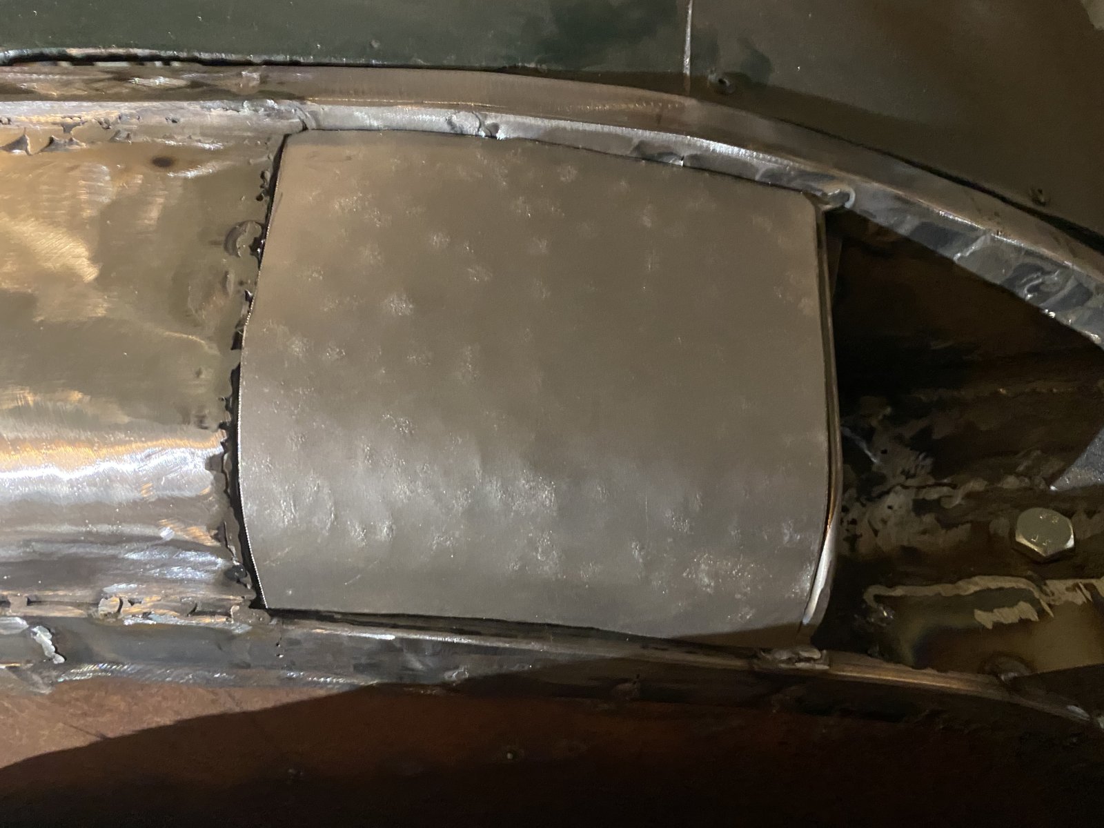

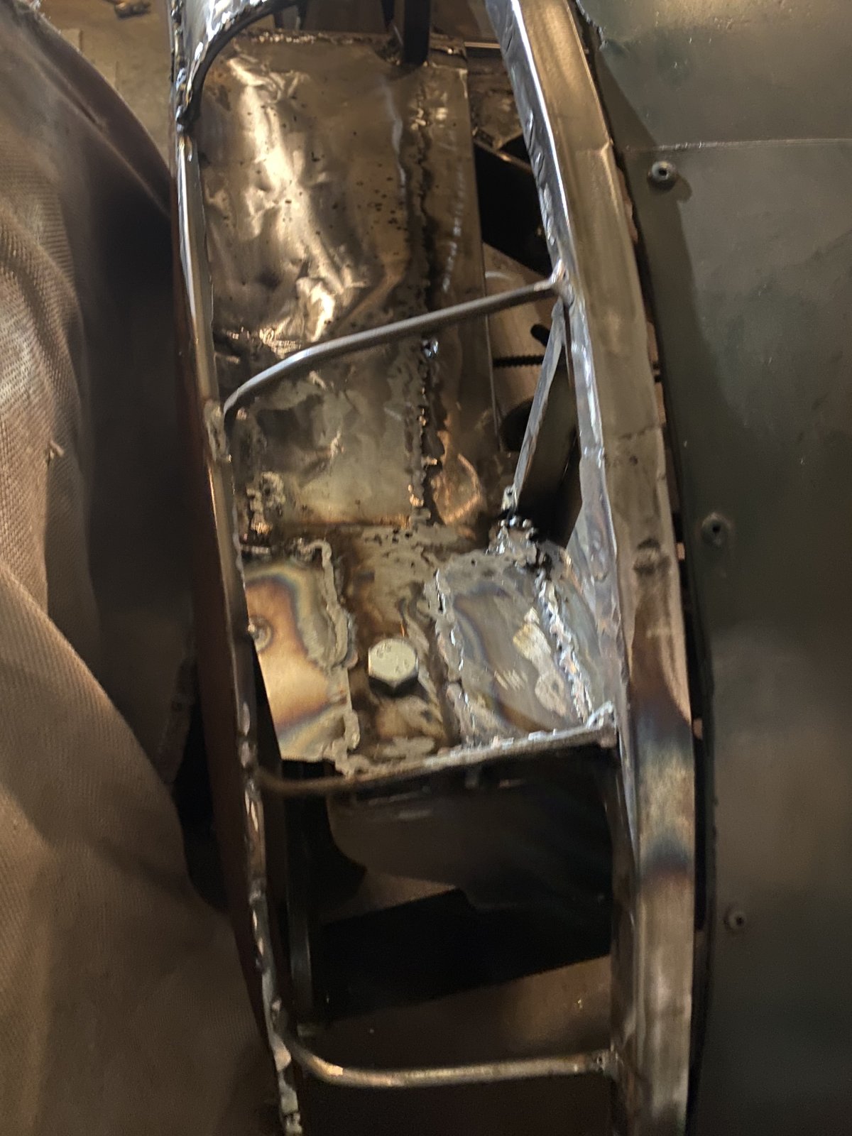

    Design of the rear corners. This phase I have planned for a long time. I don't have any top professional sheetmetal tools, such as English wheel or a shrinker-stretcher etc.
    So the old school methods are used. Shape with a round rod and double-curved sheetmetal is hammered in between. It worked out well and it looks as it should.

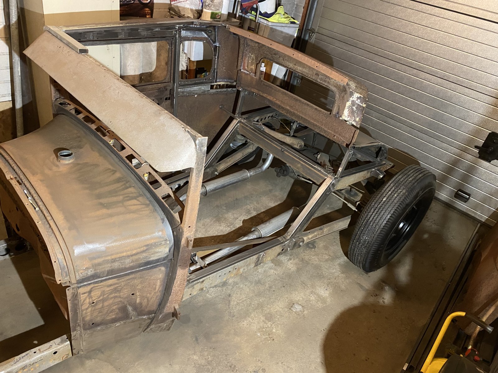

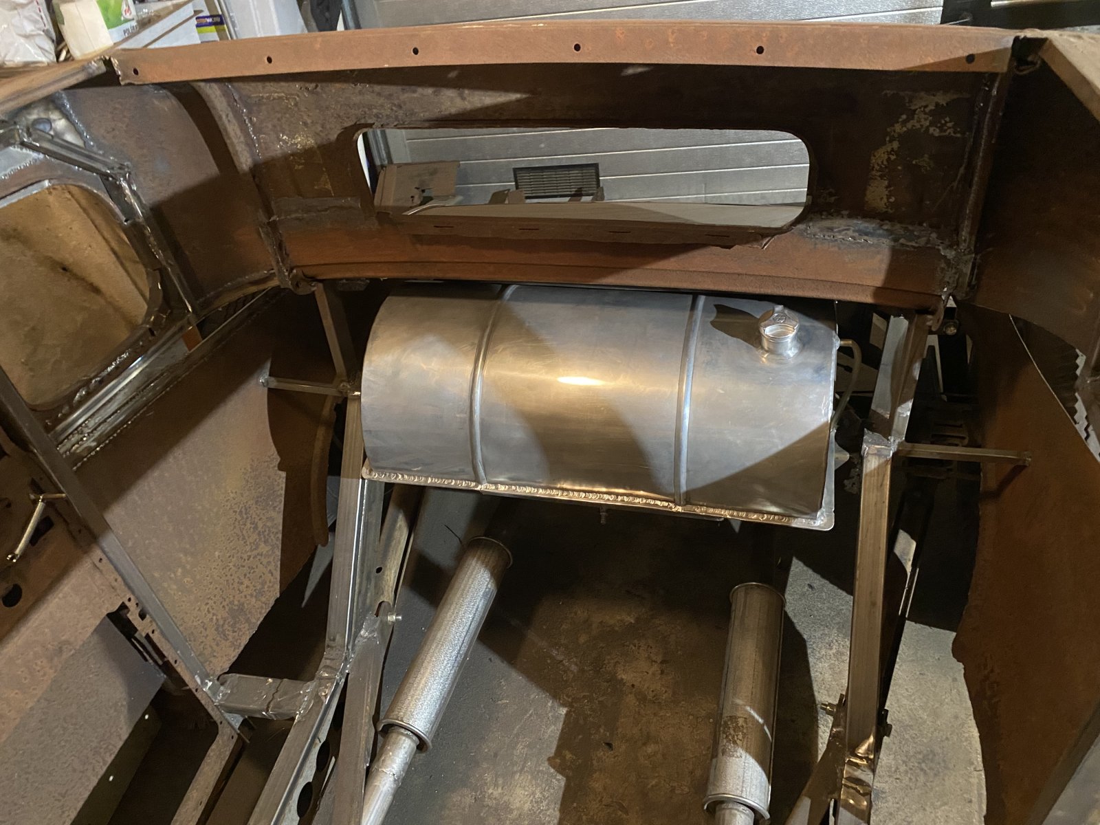

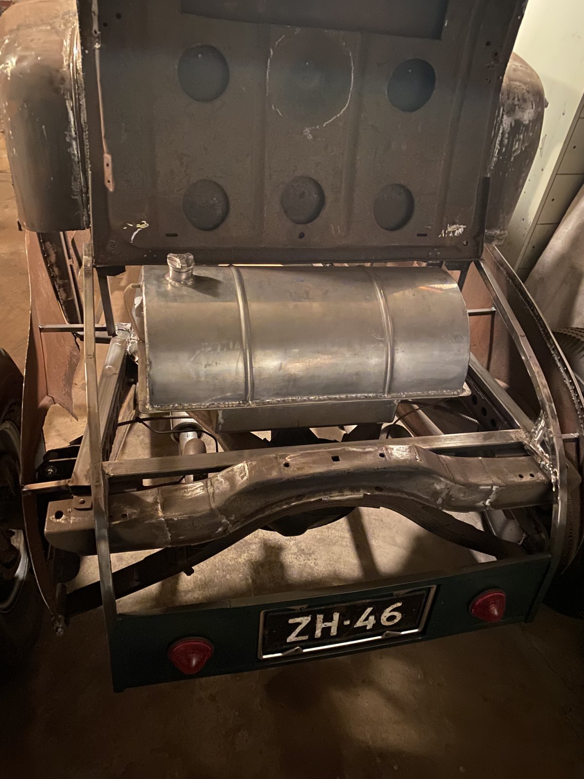

    Found me a cool aluminum tank but I cannot fit it in. I tried everything and made even more room but no, it is too big. ☹️ So I sold it and it goes now into a Model A Roadster which has original frame so it should fit. Now I need a new tank again.

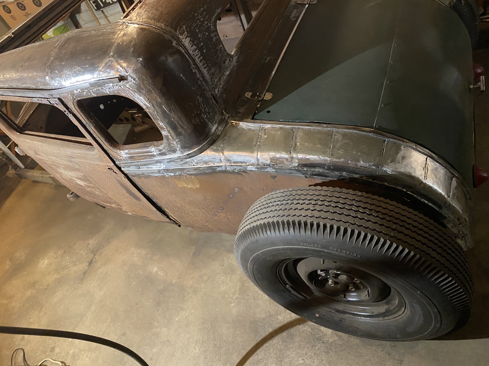

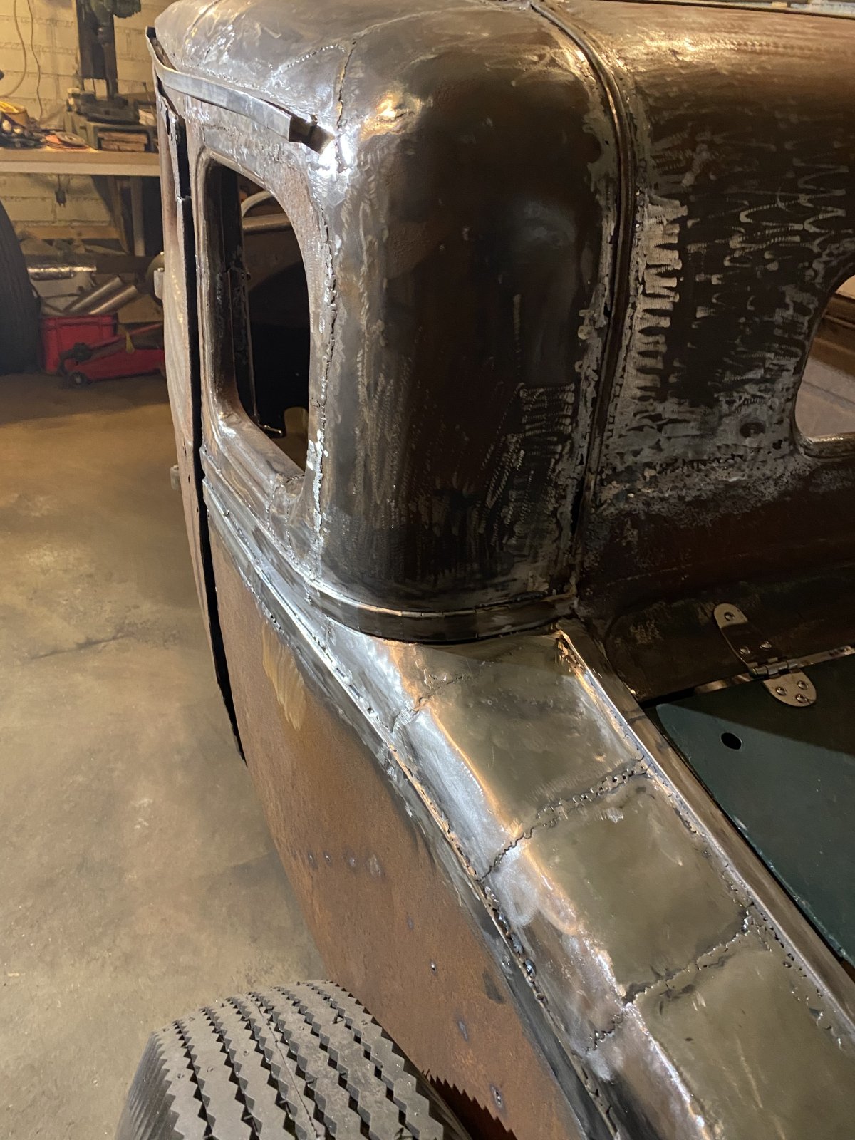

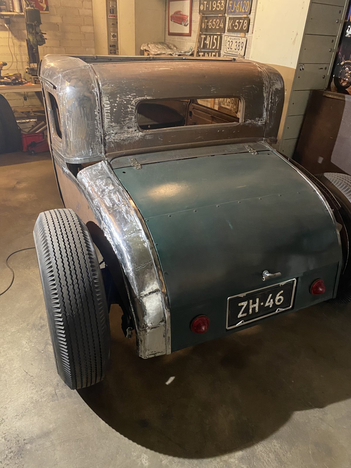

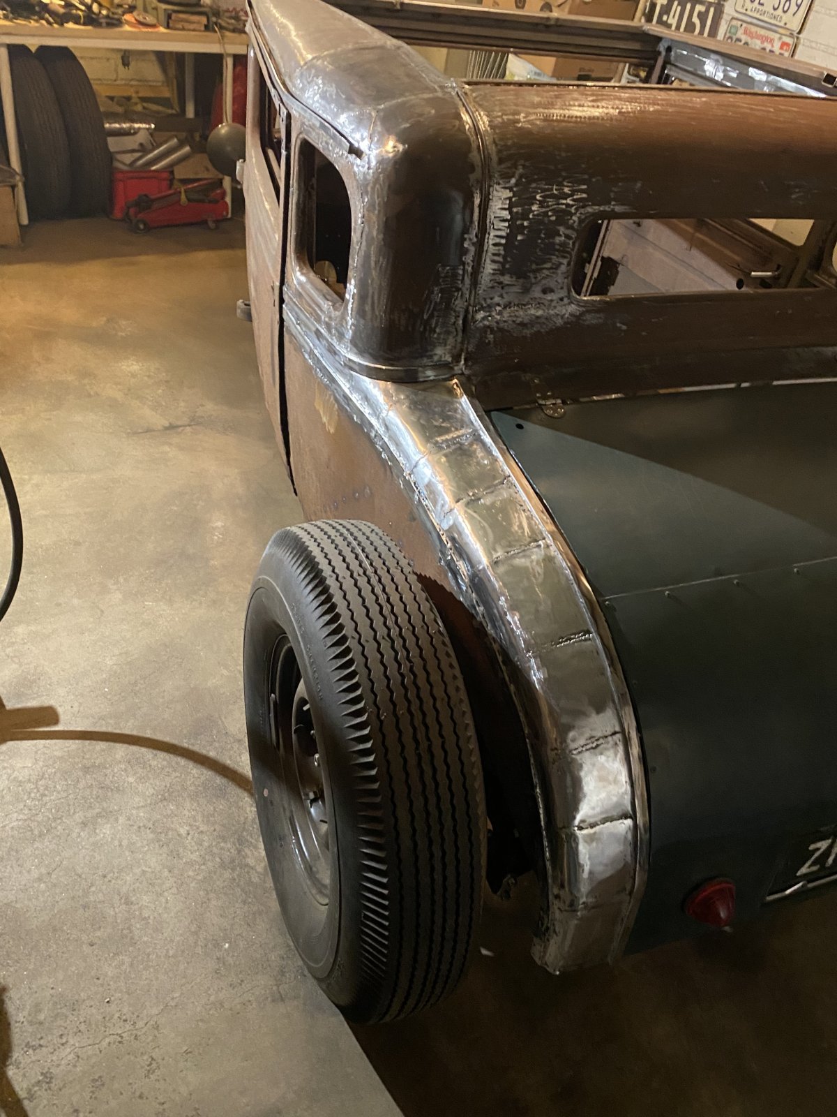

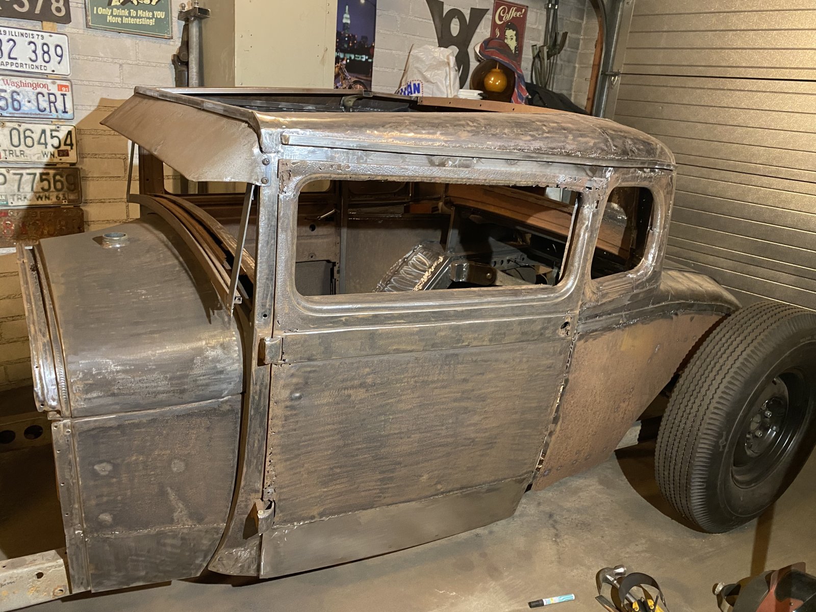

    One step back and two forward. I must say I’m really happy how this corner turned out considering all welding and shaping!
    It’s still rough and needs grinding but you can definitely see the Coupe look in there.
    Mika

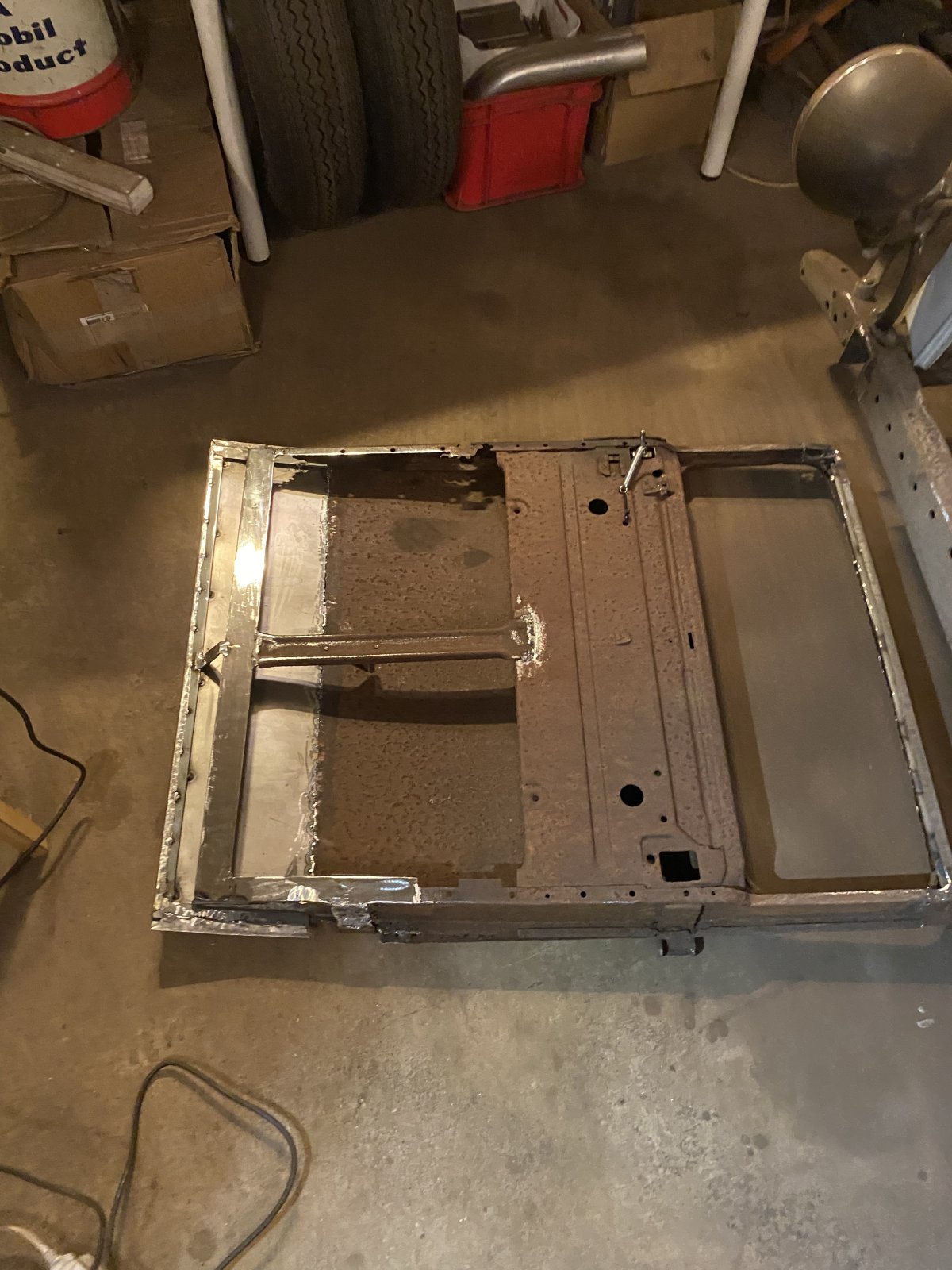

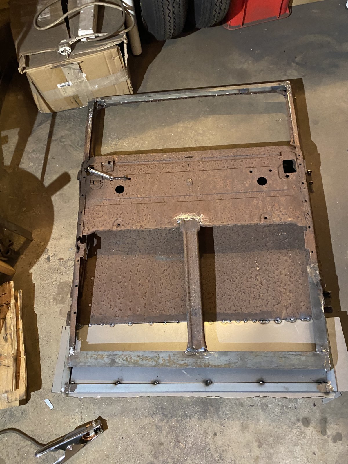

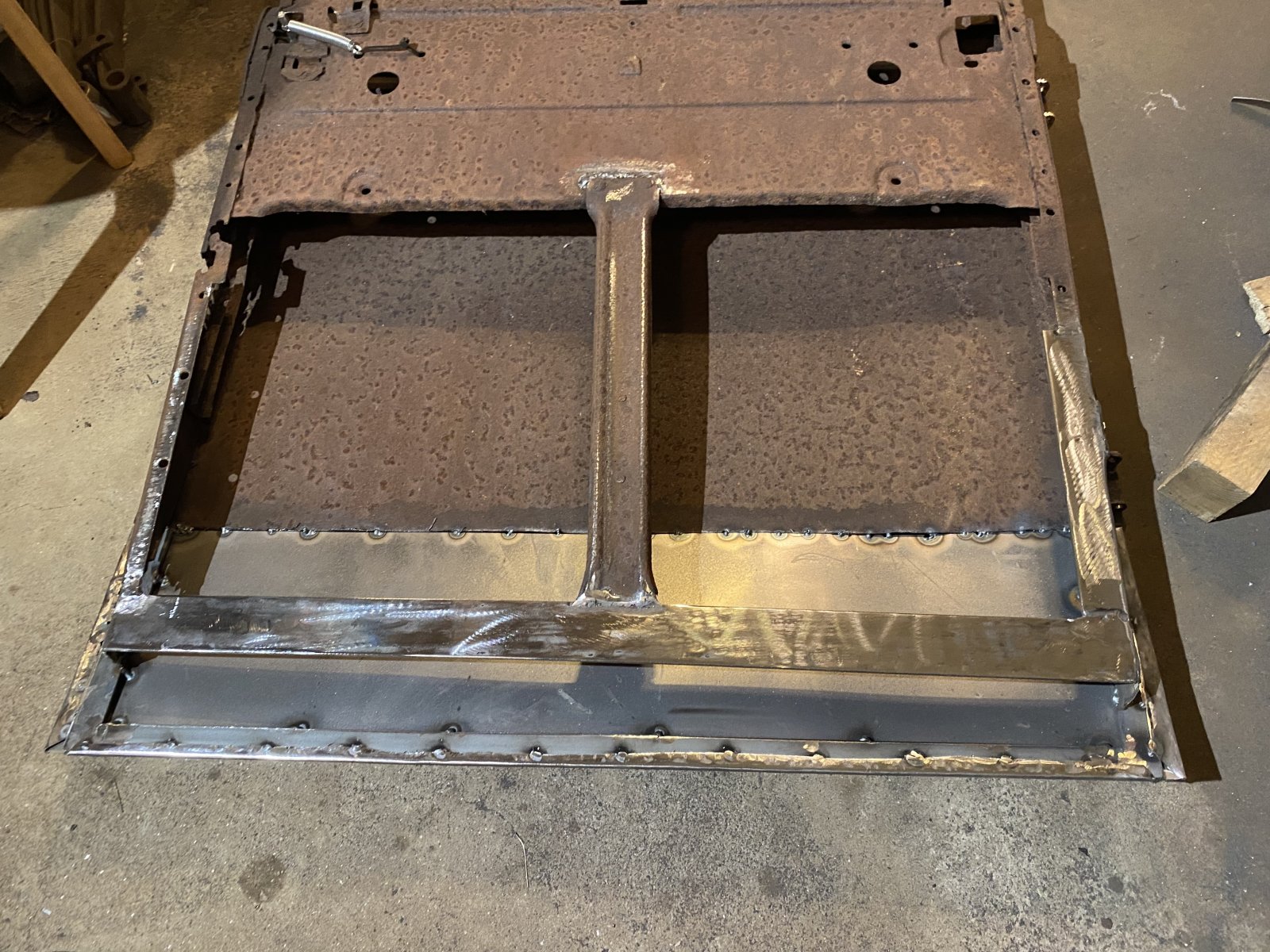

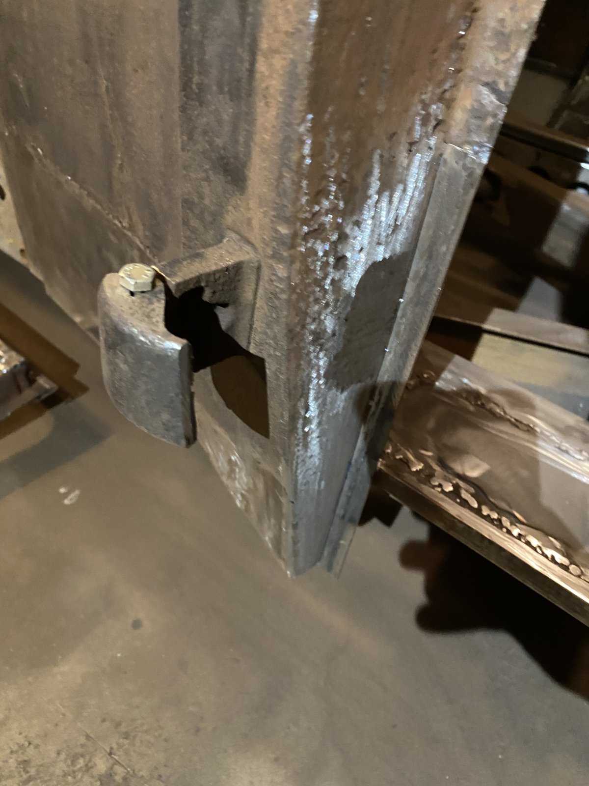

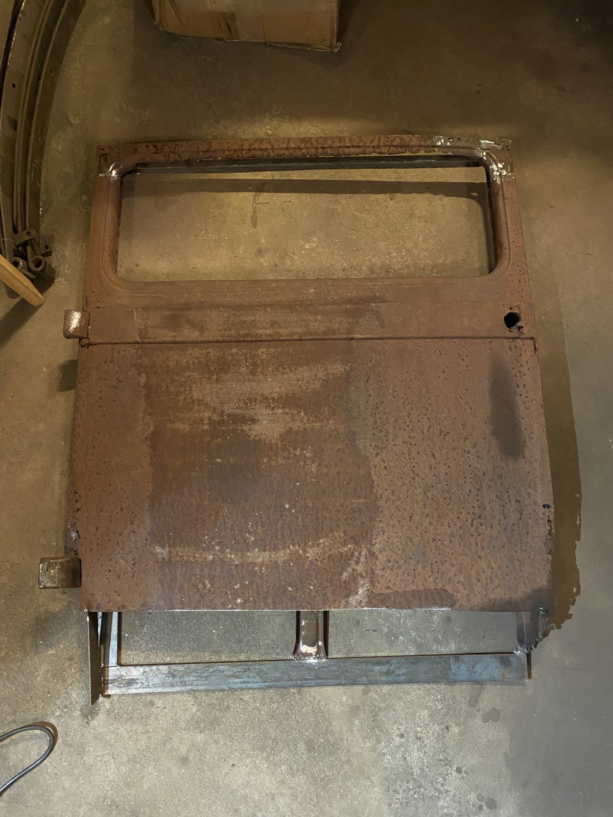

    My doors are so miserable that I don’t know if I should laugh or cry. I think if I just keep tinkering them every now and then, I will eventually have a pair of decent doors.
    Tonight I fabricated the bottom section on the driver’s door and it turned out pretty well. Considering it was all long gone.
    Mika

    Today I welded and filled some holes, ground some rust and adjusted the door with grinder, welder, and a big hammer. Rust grinding is dirty job but very rewarding.

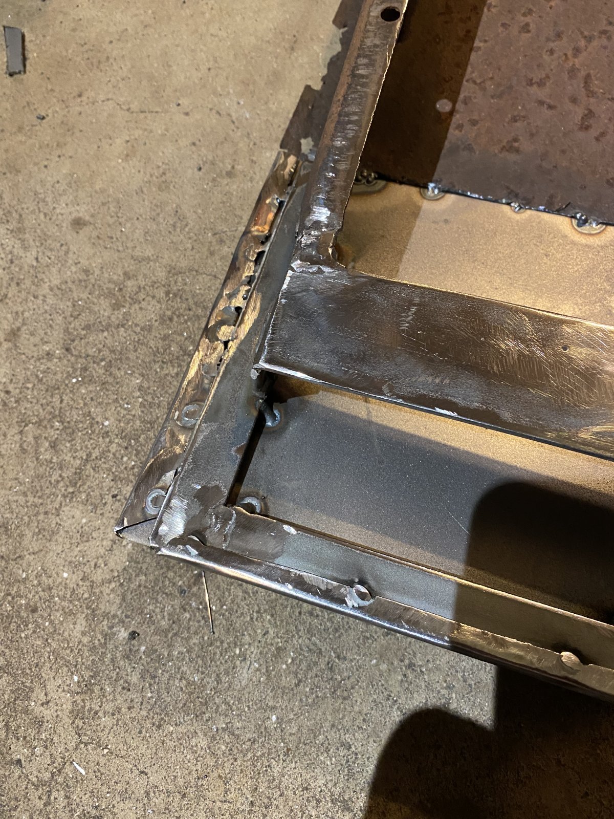

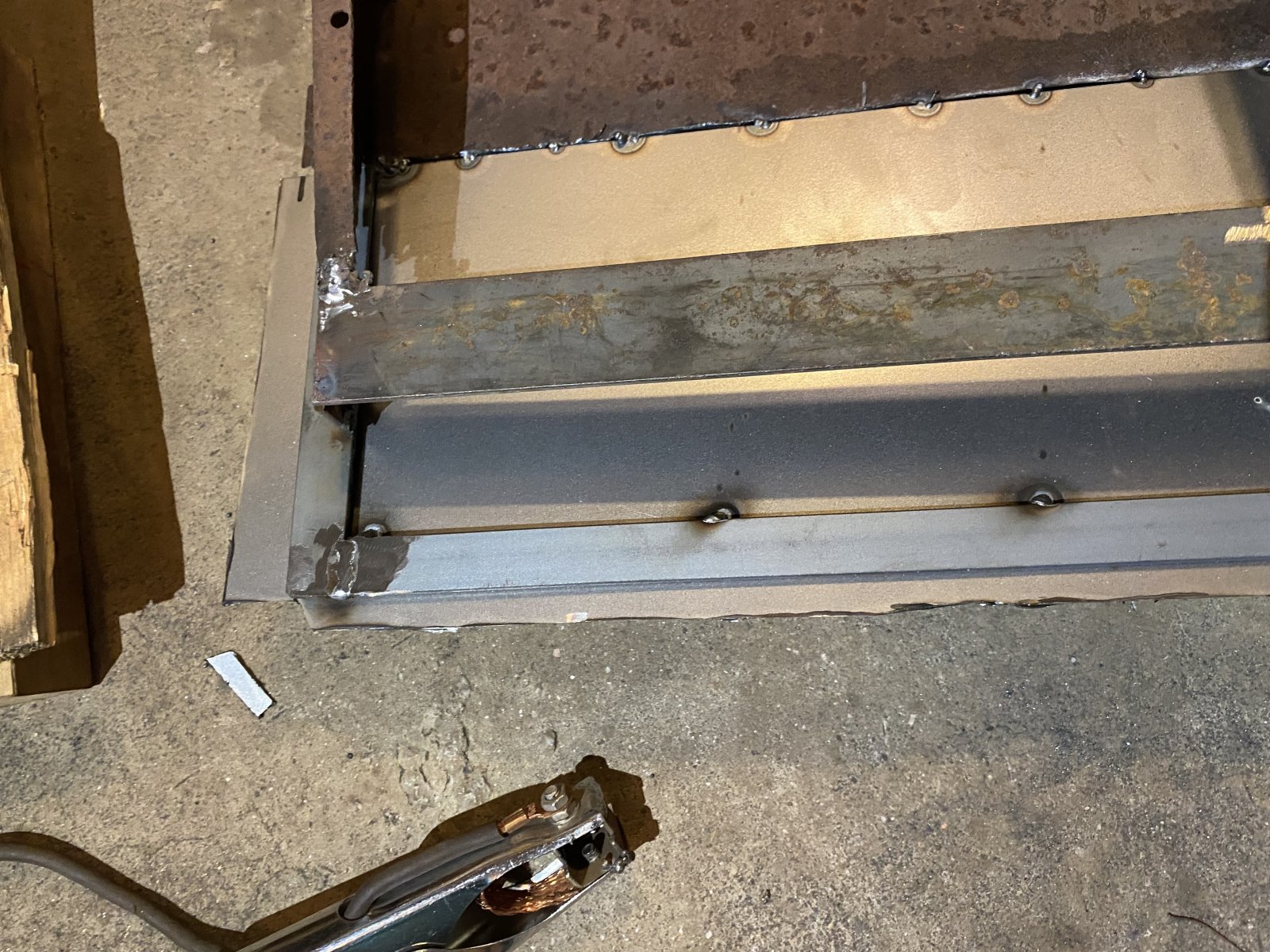

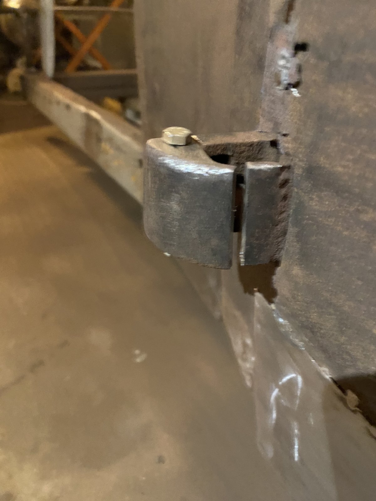

    Grinding rust off and adjusting the door hinge with zip cut and welder.

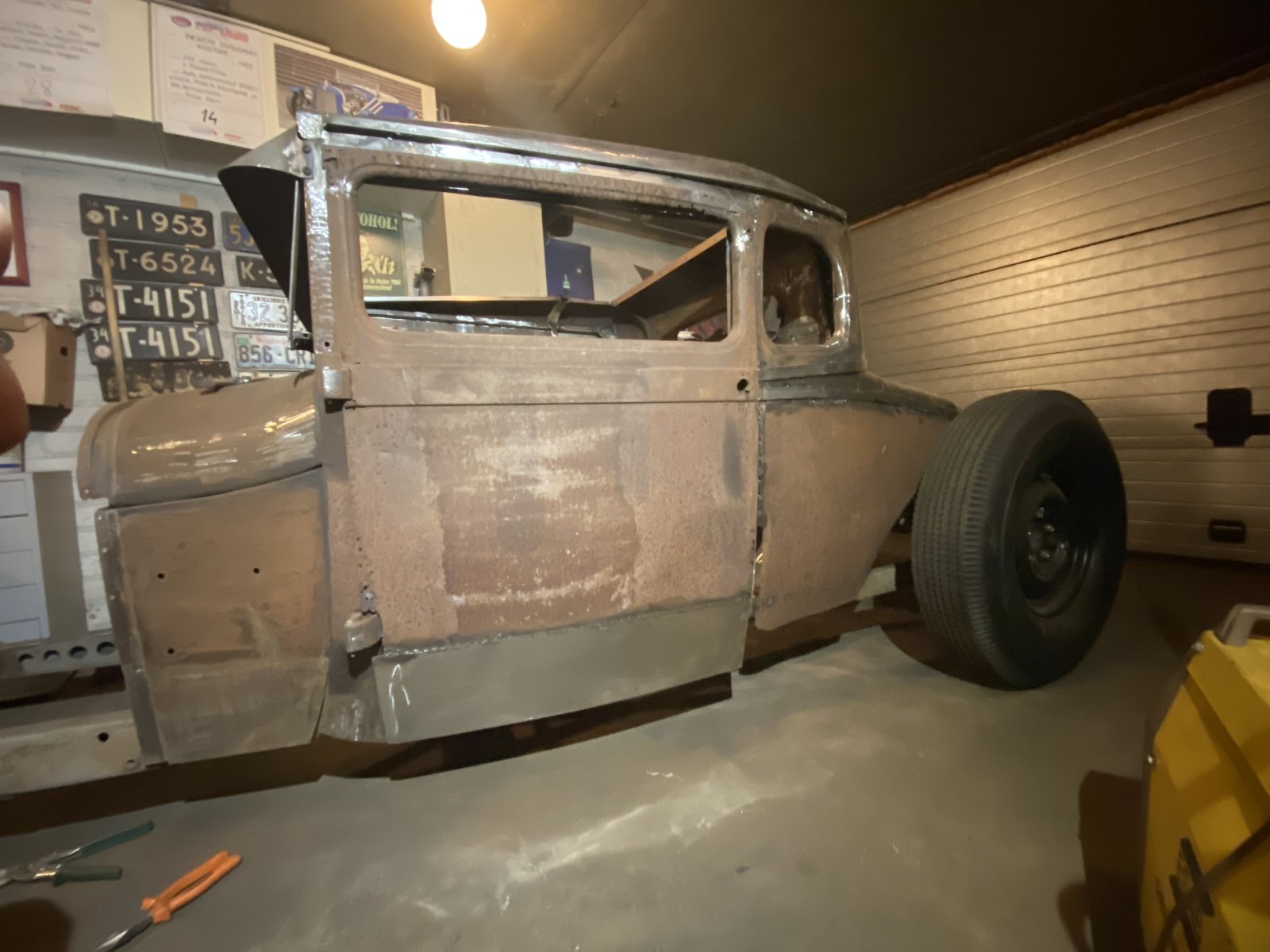

    Driver’s side is almost done. Of course lot of work still left but the major gaps are done. Especially if you compare what it was.

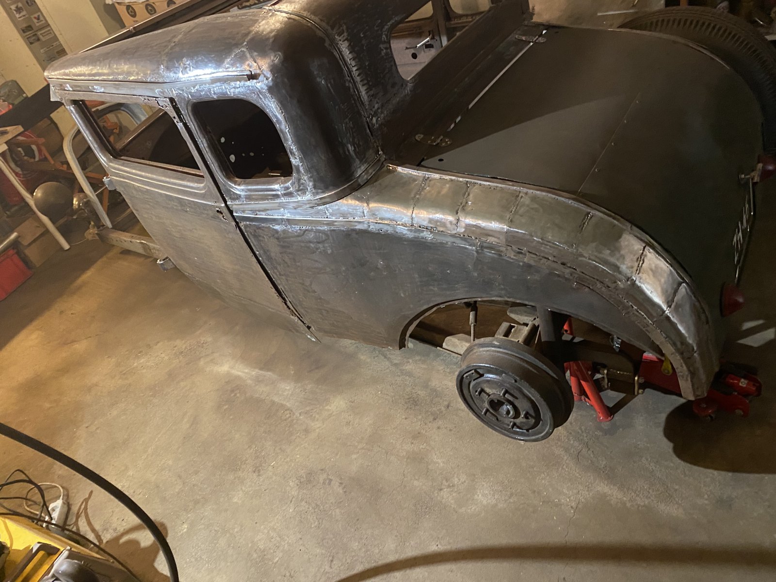

  30. attitudor
    Joined: Sep 28, 2004
    Posts: 3,134
    attitudor
    from Finland
    Driver’s side quarter panel is pretty much done. Here’s a picture of it. However I hammered it quite heavily after this picture to get it aligned. So now it looks better. I realized that it was too much inside and needed to come outwards a bit. Note the ”dent” in the middle. I will post more about the other side which will be next.
