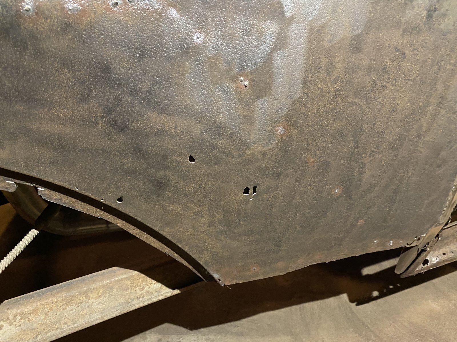

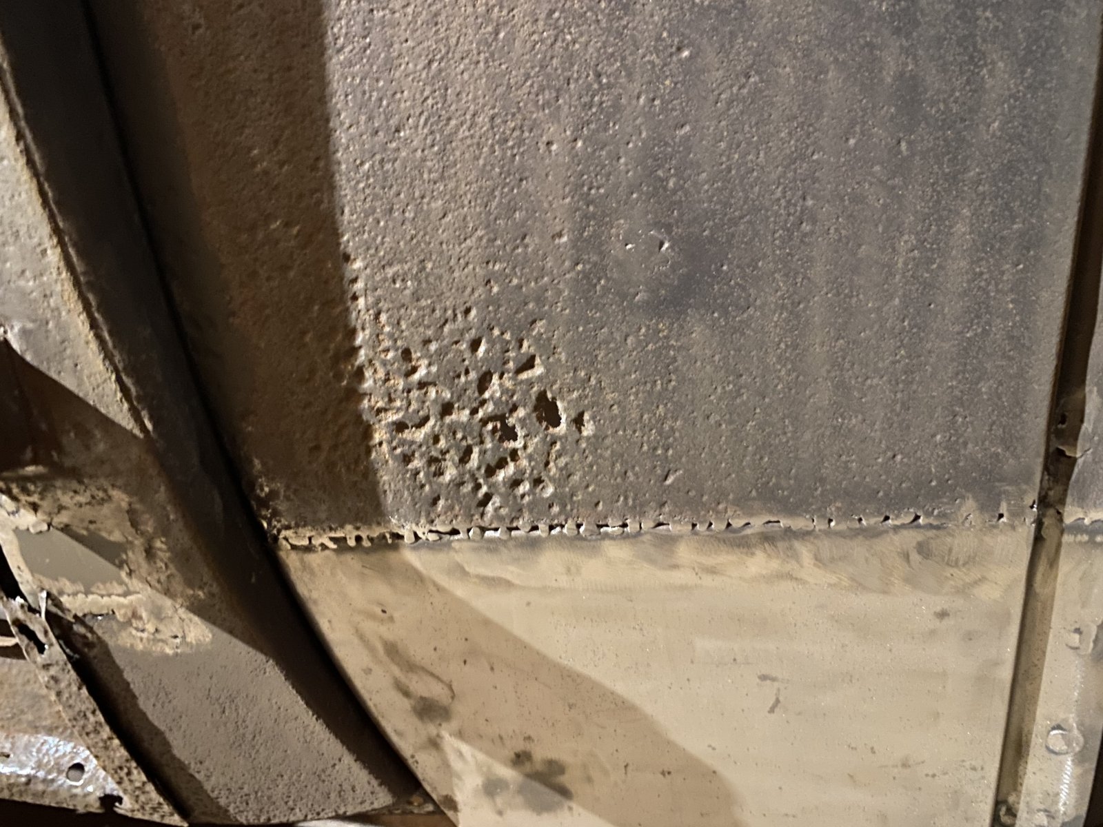

    Grinding rust off is dirty job. But it is also rewarding to see all that thick and loose rust to disappear. And it is also frustrating to find out that you have pinholes in f***ng middle of the door and quarter panel. No turning back.

  8. Squablow
    Joined: Apr 26, 2005
    Posts: 18,494
    Squablow
    That cowl spot is going to need a section cut out and welded in for sure. But the quarter isn't horrifyingly bad, you might get away with holding a block of br*** behind those holes and welding them closed from the front. I've had to do that a few times. If the metal around the holes isn't thin or covered in deep pits, I see no reason not to just weld the holes closed.
  9. attitudor
    Joined: Sep 28, 2004
    Posts: 3,134
    attitudor
    from Finland
    Yes, good hints. Thank you. I have heard that br*** thing before, I should try it.

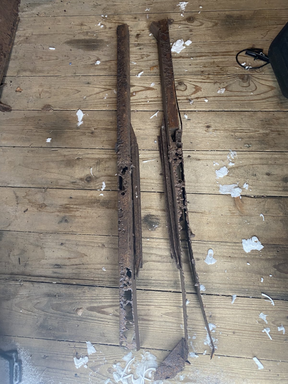

    It is unreal, but these B-posts are going to Sweden to a fellow Hamber who contacted me and asked if I still have them. I’m giving them for free, I almost threw them away already. He is not using them but taking the shape. Glad to help!

  10. Squablow
    Posts: 18,494
    Squablow
    The fact that those specific door posts could help fix not just one but two cars is pretty surprising. Nice that you can help the guy out with that.

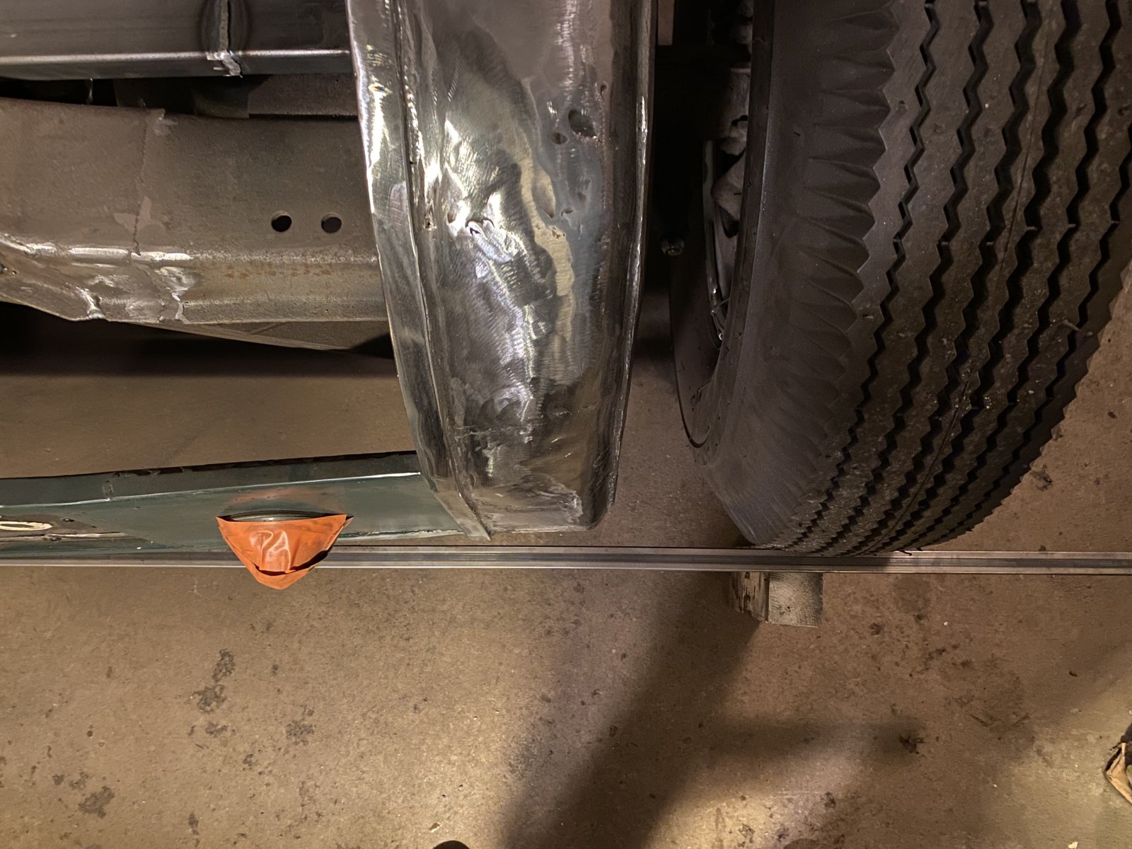

  11. attitudor
    Posts: 3,134
    attitudor
    from Finland
    I had a short break. I’ve been reading the HAMB, especially old survivors and old east coast style hotrods threads. Cool stuff.

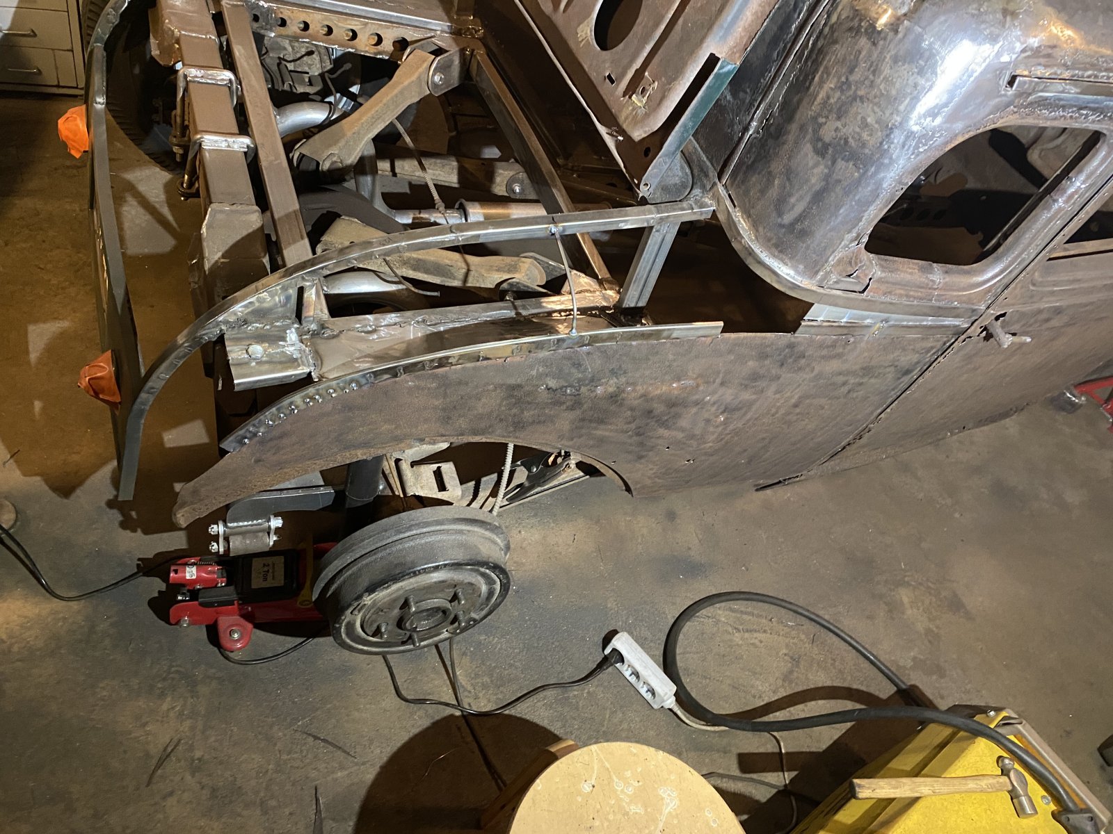

    Found another inner fender, it is an original Coupe part. The other one is old repro. You can see the difference. No matter, they need to be cut anyways.

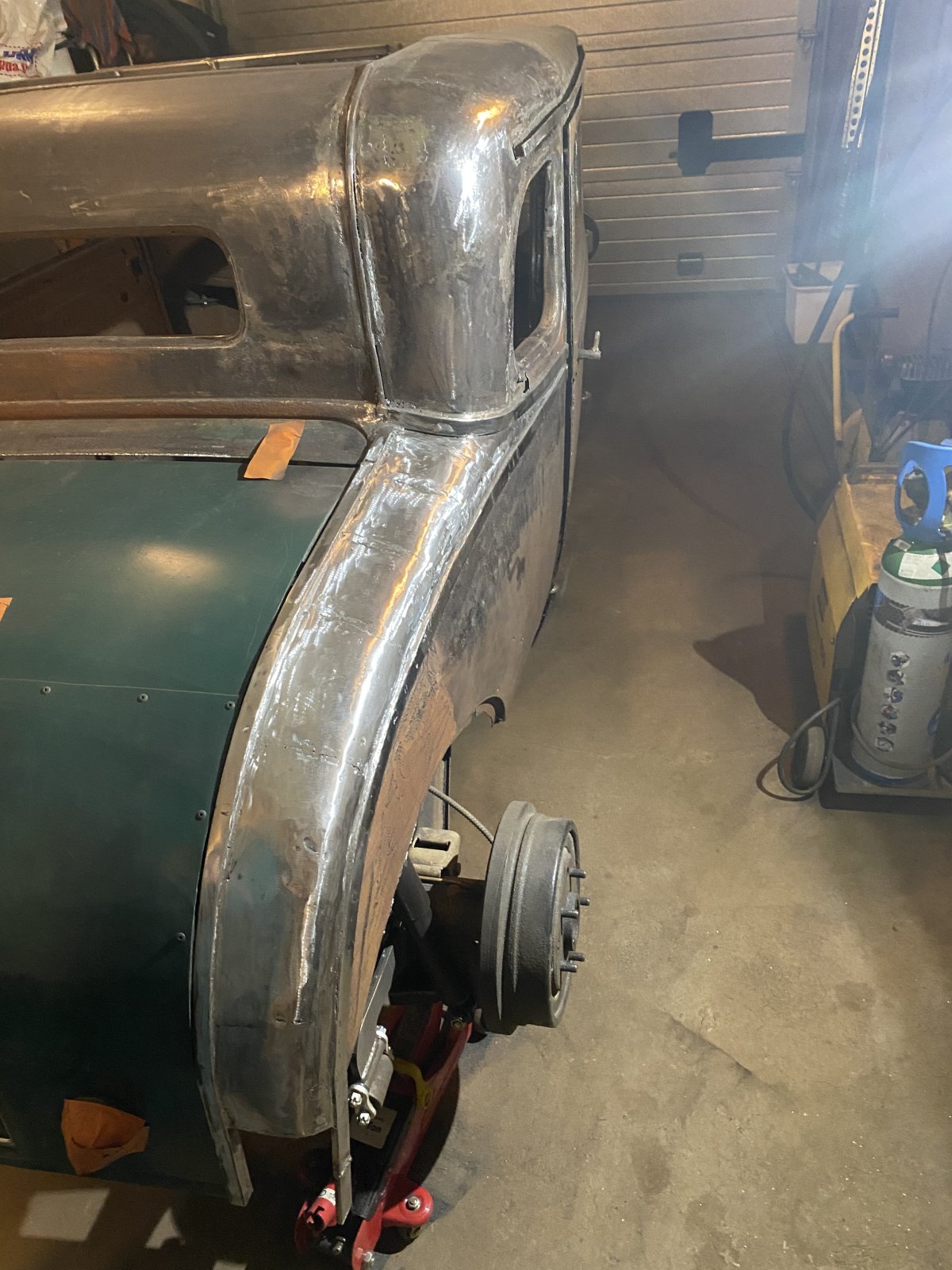

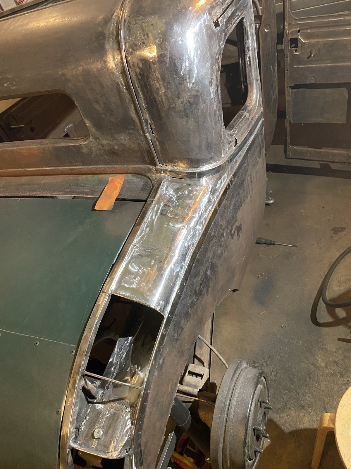

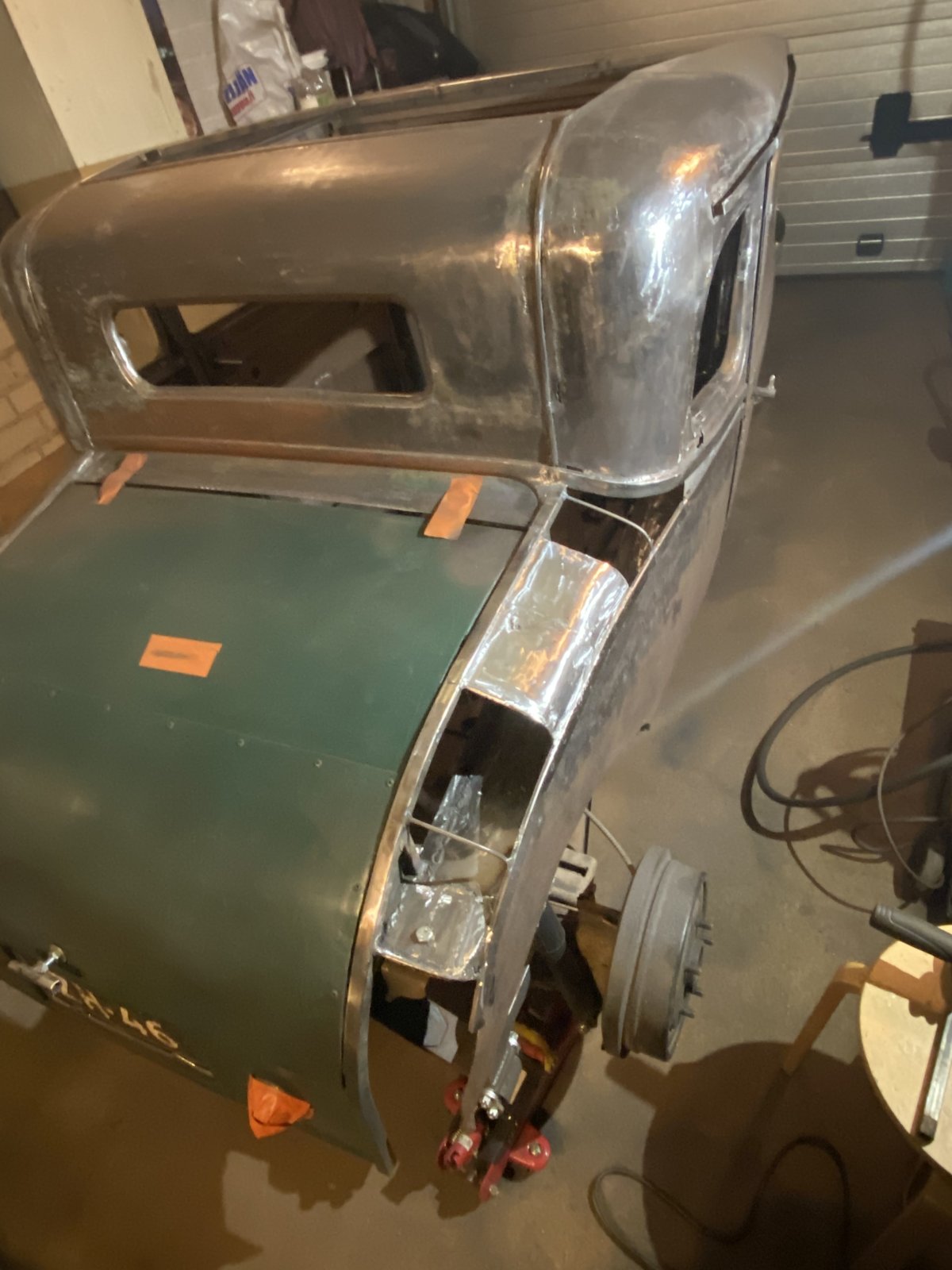

    Finally finished the rear window corner, it has been in my mind for a while. Also cut off my mistakes from the p***enger side and started to rebuild the rear corner. This time I’m quite happy with the progress so far. After finishing the skeleton it will have new steel hammered and welded in place, likewise the other side. Good progress.
    7A009C9B-D67A-4FC3-B872-81D6E4E3DEFE.jpeg 309AA878-BFB6-4511-8255-DE0BF96D58F5.jpeg 5CE1FF3B-D54C-4008-B230-BD66FA13D5EE.jpeg D7842022-1D13-4ABF-A6C1-D30ADB9C62CB.jpeg 2C5443EA-008F-4C1B-BBB0-04F70687B551.jpeg 3BFF4885-8EB5-48CA-9AC7-7FCB70BDF8D0.jpeg 30BF7F54-89DE-4A3E-AD61-C4CFD37E0F99.jpeg

    Haha! My project is in the Primer Magazine garage scene stories! Project continues with the right rear corner.

    Magazine coverage! That's pretty cool. Corners are shaping up.

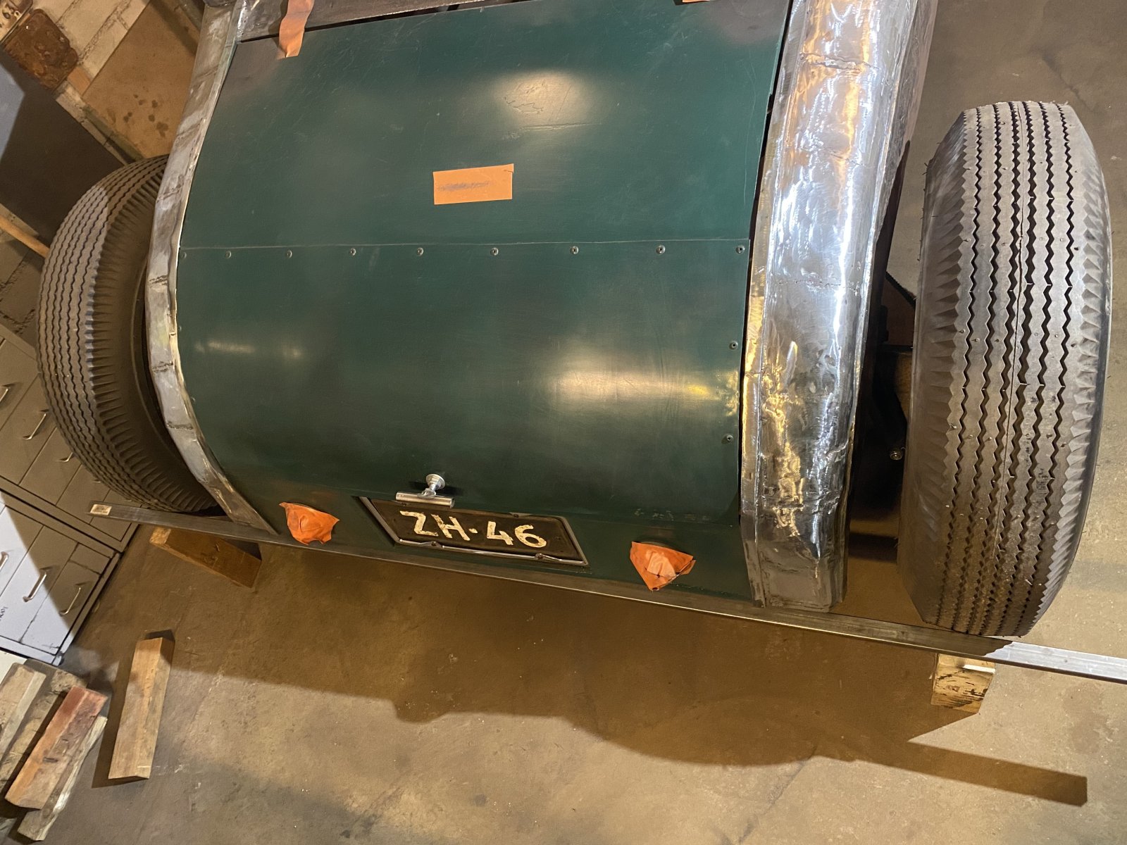

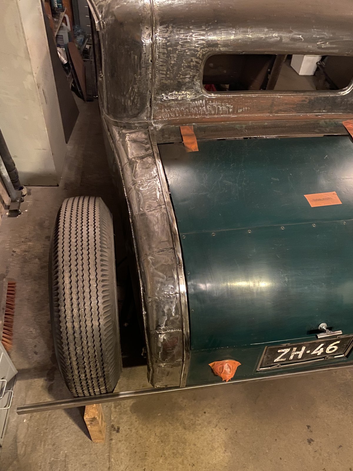

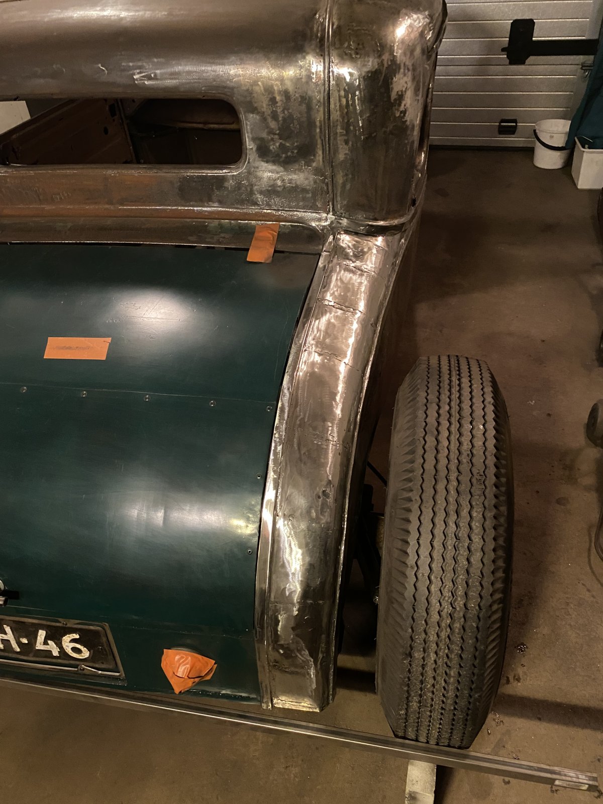

  20. attitudor
    Posts: 3,134
    attitudor
    from Finland
    Sh*t, sh*t. I have made a major mistake. I finalized the p***enger’s side rear corner. It looked all right at first but then I realized that something was wrong. It took me lot of time and measuring and finally I figured what’s wrong. You can see it from the pictures. I need to cut off the corner and add 1/2 inch in lenght. Damn.
    Well, of course I’m happy to notice that now and not later. But still.
    It has been extremely difficult to make them symmetrical, and now I see one reason.
    3005CCD9-88D4-44B9-B579-BC61C7288C25.jpeg 5049F7EA-54CF-4CFB-9338-EC35E218E4D3.jpeg E61AF596-B904-4209-8EAF-12E6FFFF2794.jpeg

  22. Outback
    Joined: Mar 4, 2005
    Posts: 3,371
    Outback
    from NE Vic
    Dang, so easy to do, hopefully not too much work to fix it!
  23. attitudor
    Posts: 3,134
    attitudor
    from Finland
    I’m back on track! It was painful to cut but now it’s OK and I can move on.

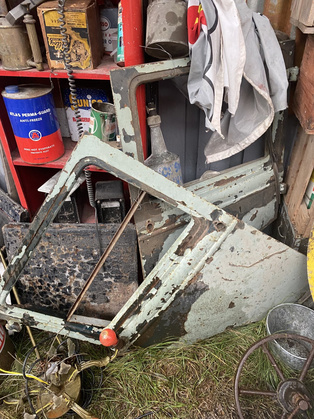

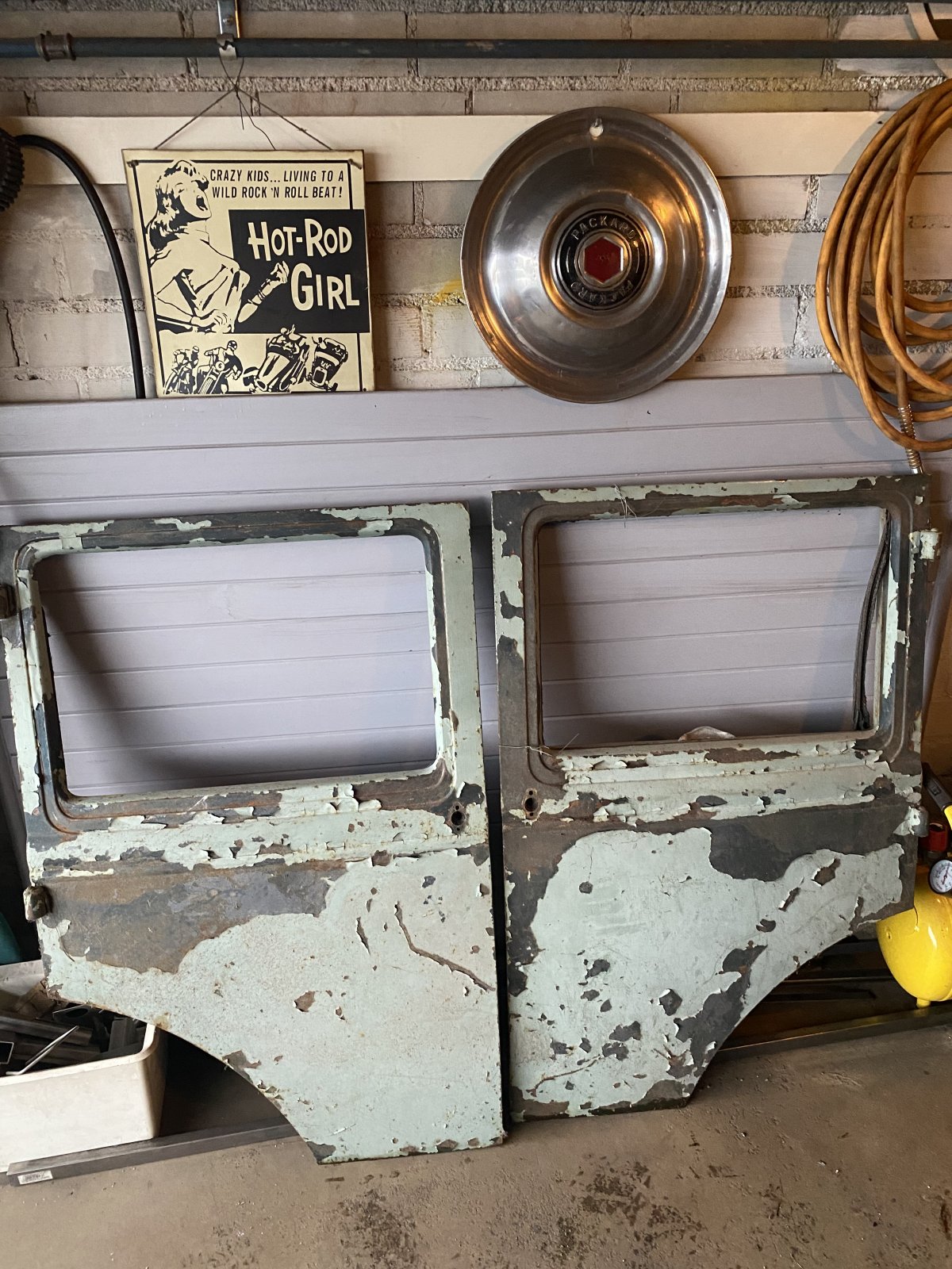

    I still have a chance to buy all those doors. Wish somebody could identify them for me. Or at least tell if those grey ones could be from Model A Briggs body. The Roadster/Touring doors are pretty cool with side curtain holes and top post holes in them. I’m struggling with the decision. I don’t really need them and they are not that cheap. But again, they are getting very rare at our heights.

  27. 2Blue2
    Joined: Sep 25, 2021
    Posts: 411
    2Blue2
    After seeing what you done so far...
    A little welding and I think you could just make a car out of those old doors.

    Haha! That’s actually what I was thinking! I know one cowl which is available and and… :)
    After sleeping one night I decided to make a homerun with these Briggs-body Model A doors. I made some horsetrade to get the price right. So here they are!

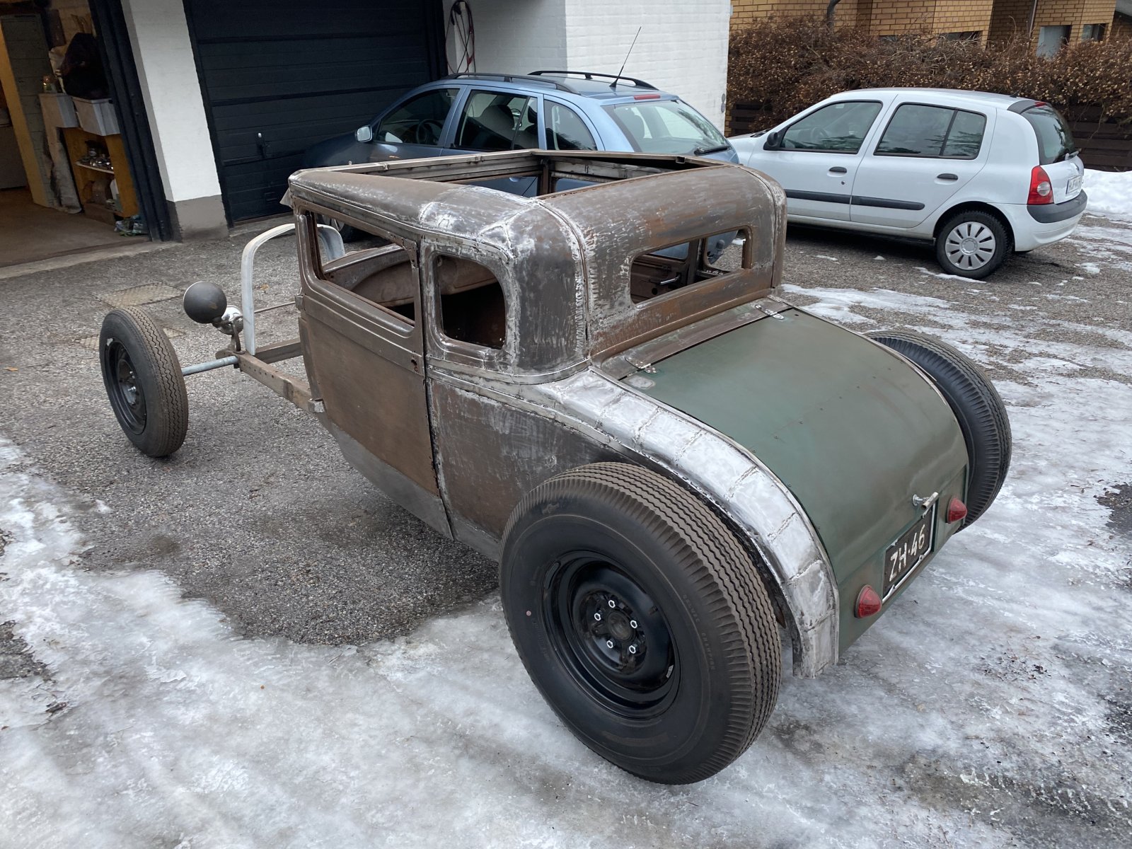

    Good progress today. I think I can say I now have a Coupe.
