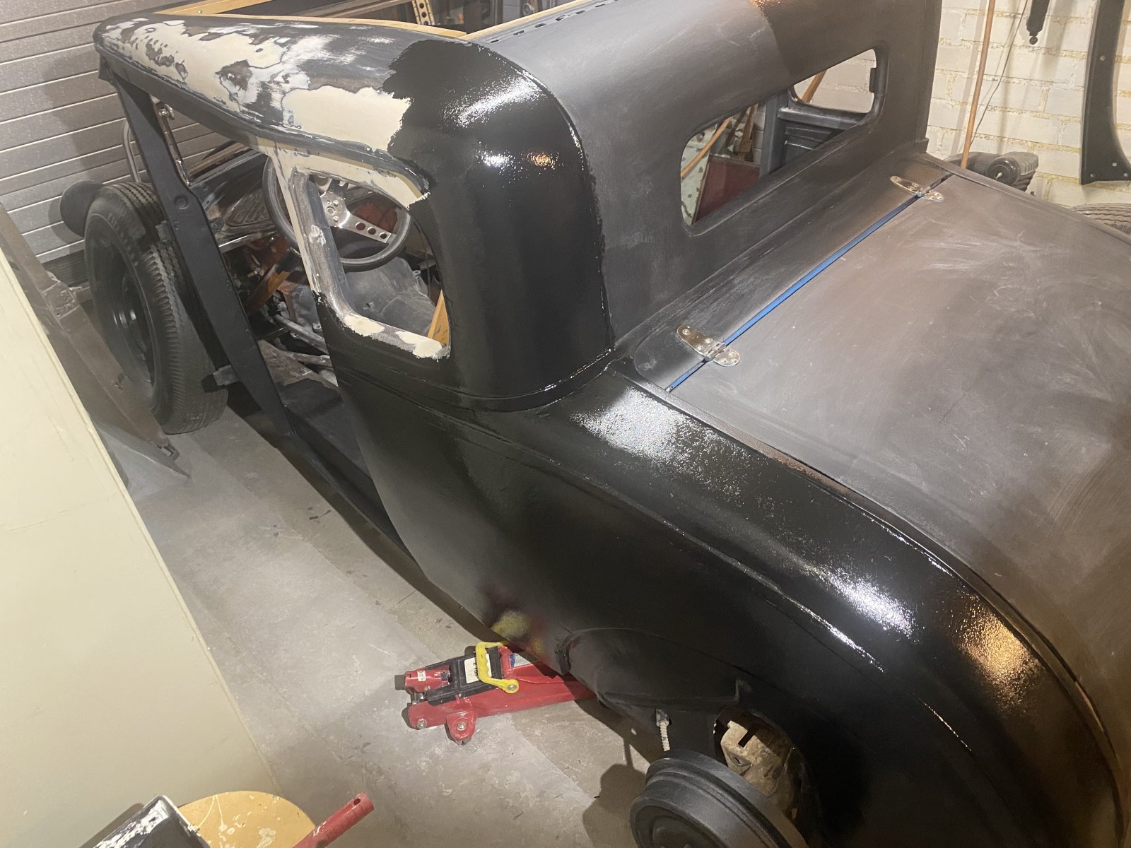

    The trunk lid looks so much cleaner now. Great to see this progress. Should be a great base to do bodywork on, if you decide to.

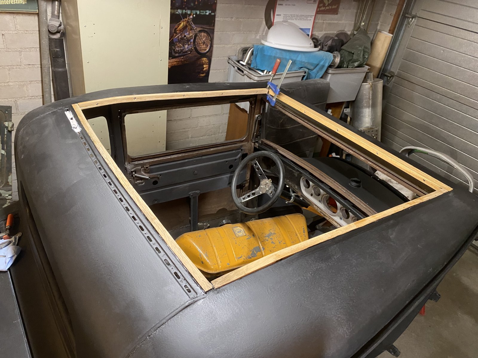

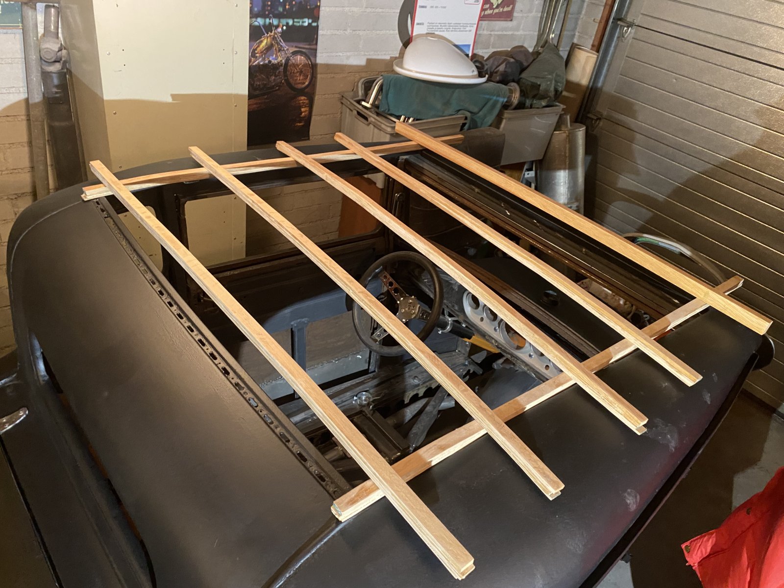

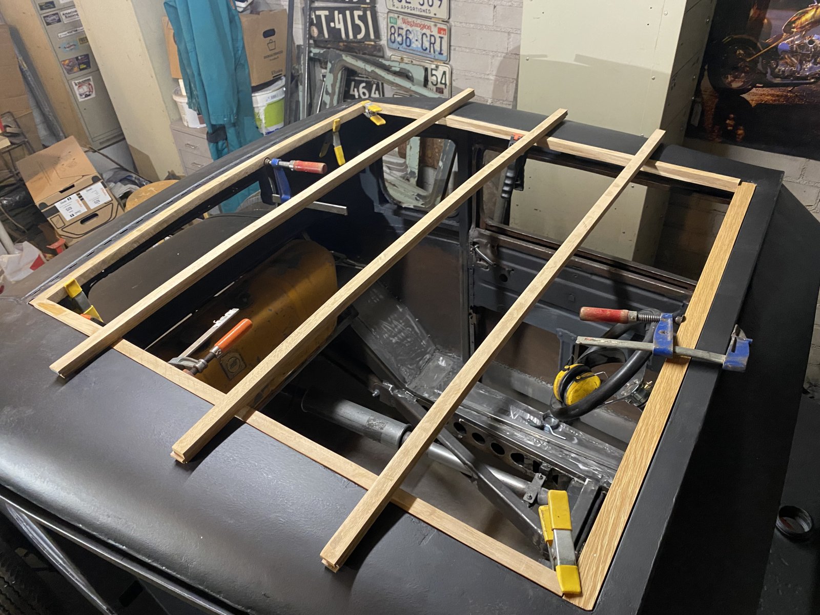

    My dad made these super nice roof bows of oak wood.
    I was able to screw the frame in place. Still needs to figure out how to attach the middle cross bows. Looking good. They will get varnished later.

    Looks great! How did he curve the bows? I’ve thought about steaming them or just cutting the arc into them

    Yes, steaming would have been one option. However, he cut the wood in strips and glued the strips together on top of a self-made jig to make the same arc on them.

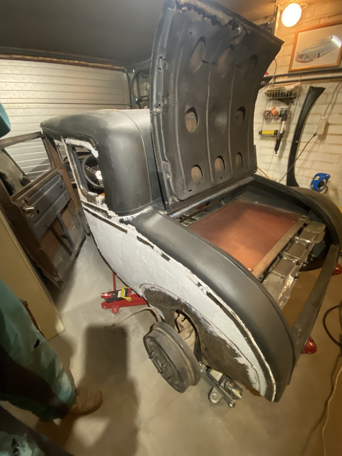

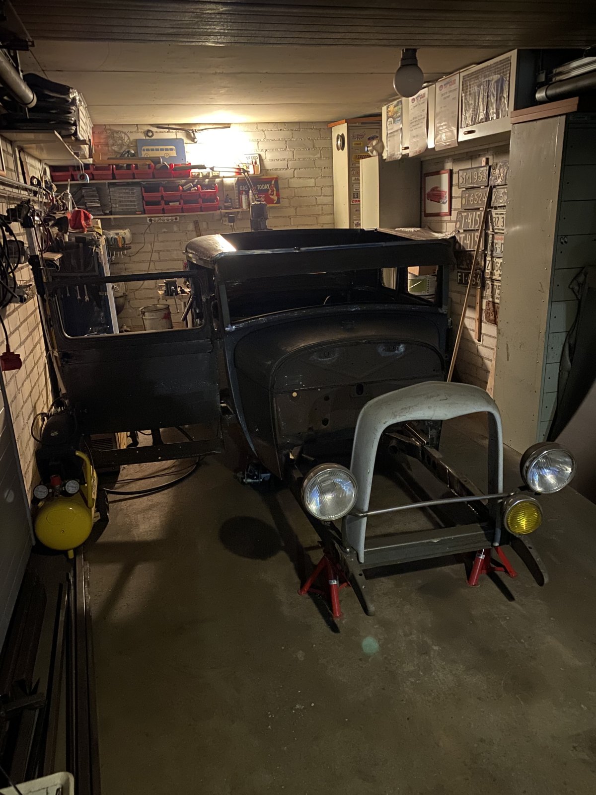

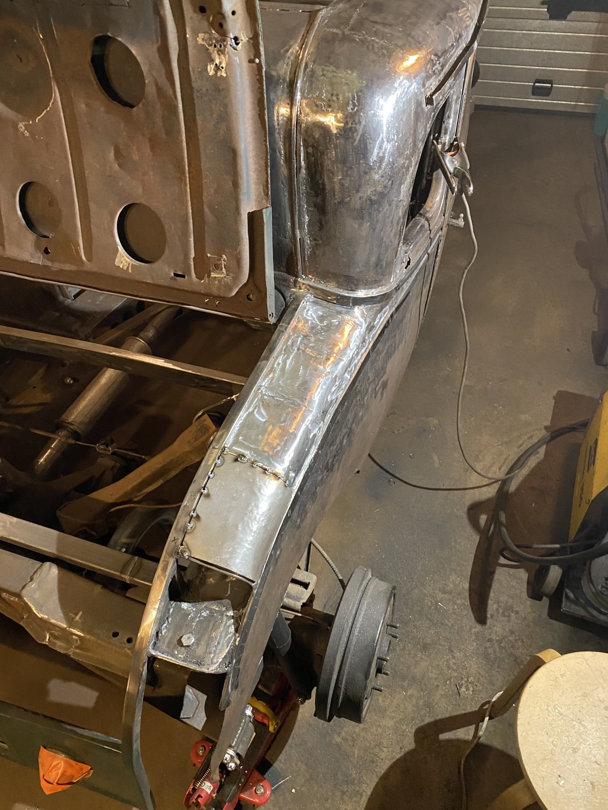

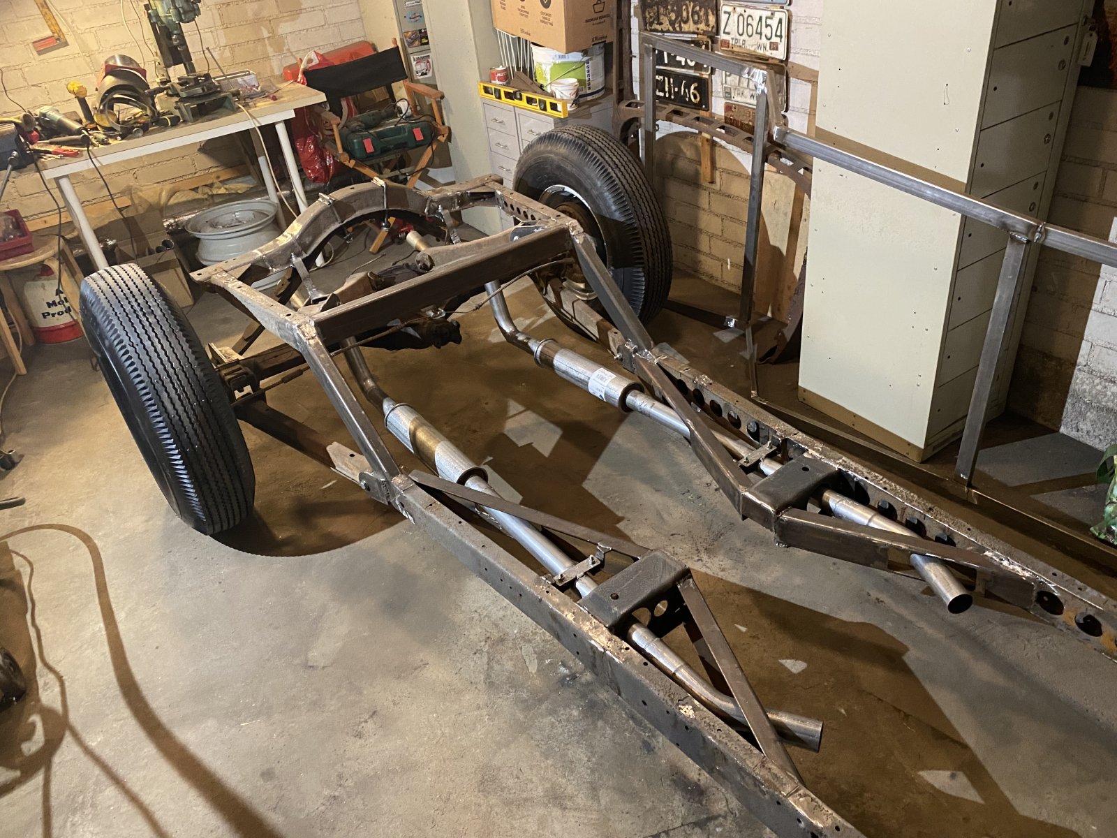

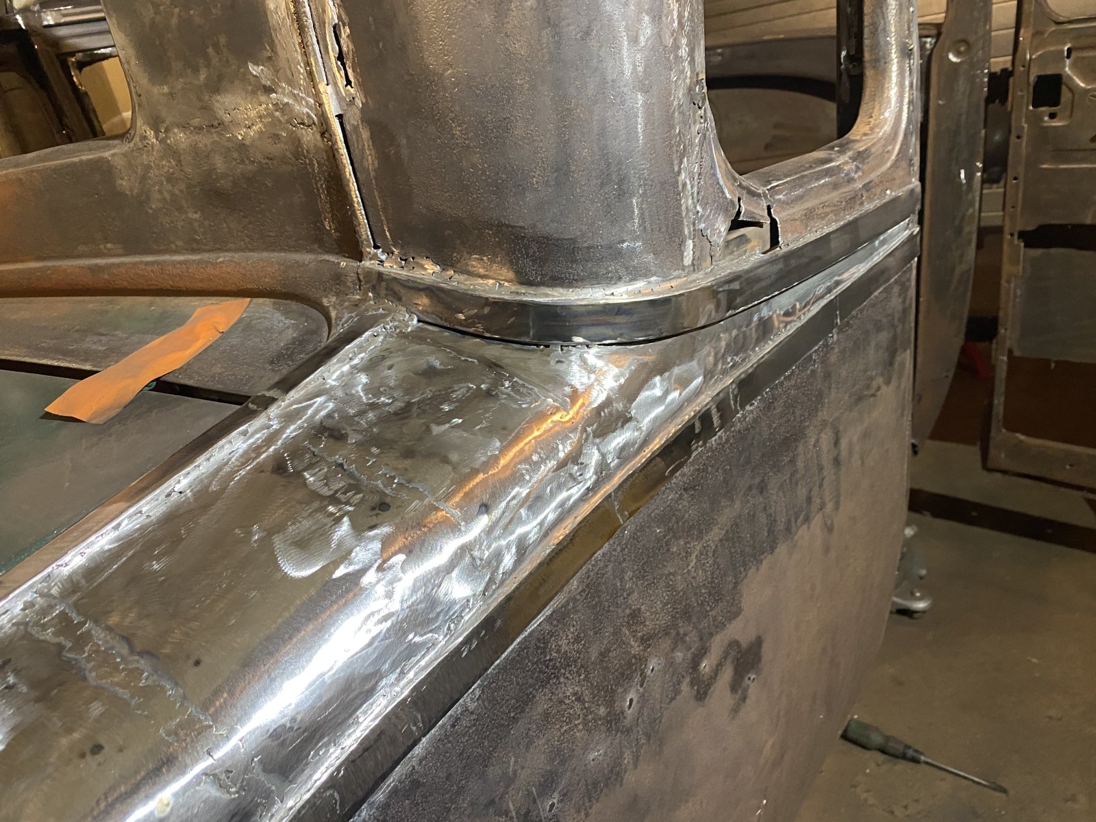

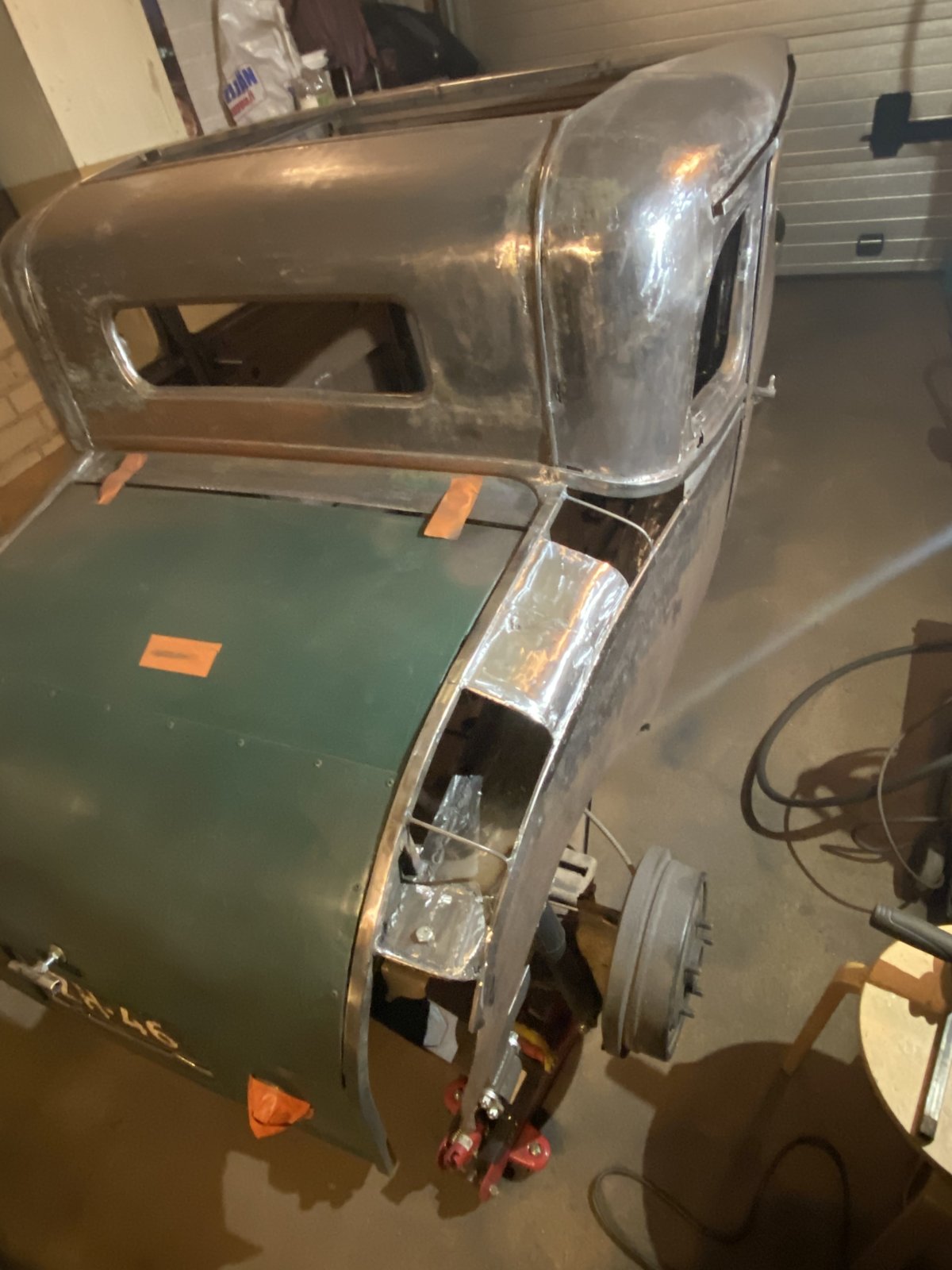

    Something again. Found a 32 grill frame on internet from old buddy for a half price. Also built a wooden floor in my small trunk. Then continued welding on the drivers side. Quick and dirty bodywork and black paint. IMG_1577.jpeg IMG_1576.jpeg IMG_1606.jpeg IMG_1630.jpeg IMG_1631.jpeg IMG_1633.jpeg

  10. nrgwizard
    Joined: Aug 18, 2006
    Posts: 3,040
    nrgwizard
    from Minn. uSA
    On the '32 5w I had eons('75->'77) ago, the factory wood joints for the cross bars were notched into the side pieces(similar to timber-frame houses, but no diagonal wedge cuts), just straight cuts & iirc, a small machine screw w/a thin washer under the head + a "T-nut" was used to hold it in place. The cut-away on side piece was about 25%, w/the "finger" end on the cross bar sitting down into the top of the side piece. Whole mess was screwed into(under) the top sheetmetal thru the slots, which also are for the top material to be nailed into/thru. IIRC. No pics, eons ago. Hth.

    Yes, thank you for the explanation. I think we are going to try something similar with my dad who is a woodworking spe******t. I don't have skills to get joints matching to each other. Welding is so much easier when you can fill the voids or grind it down.

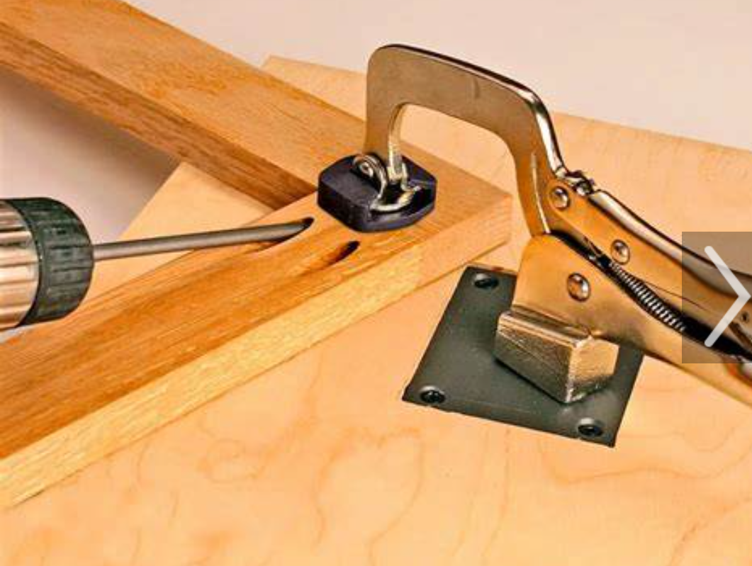

    You can Kregg jig pocket screw the bows in to the frame they make stainless screws for it can leave them exposed too. Like the screws under your dining room table is put together with. Your dad looks to be a good carpenter. That's what I do too. Screenshot_20240321-192350~2.png

    The Kregg pocket hole screws hold strong !
    I think HF sells a knockoff jig now too.

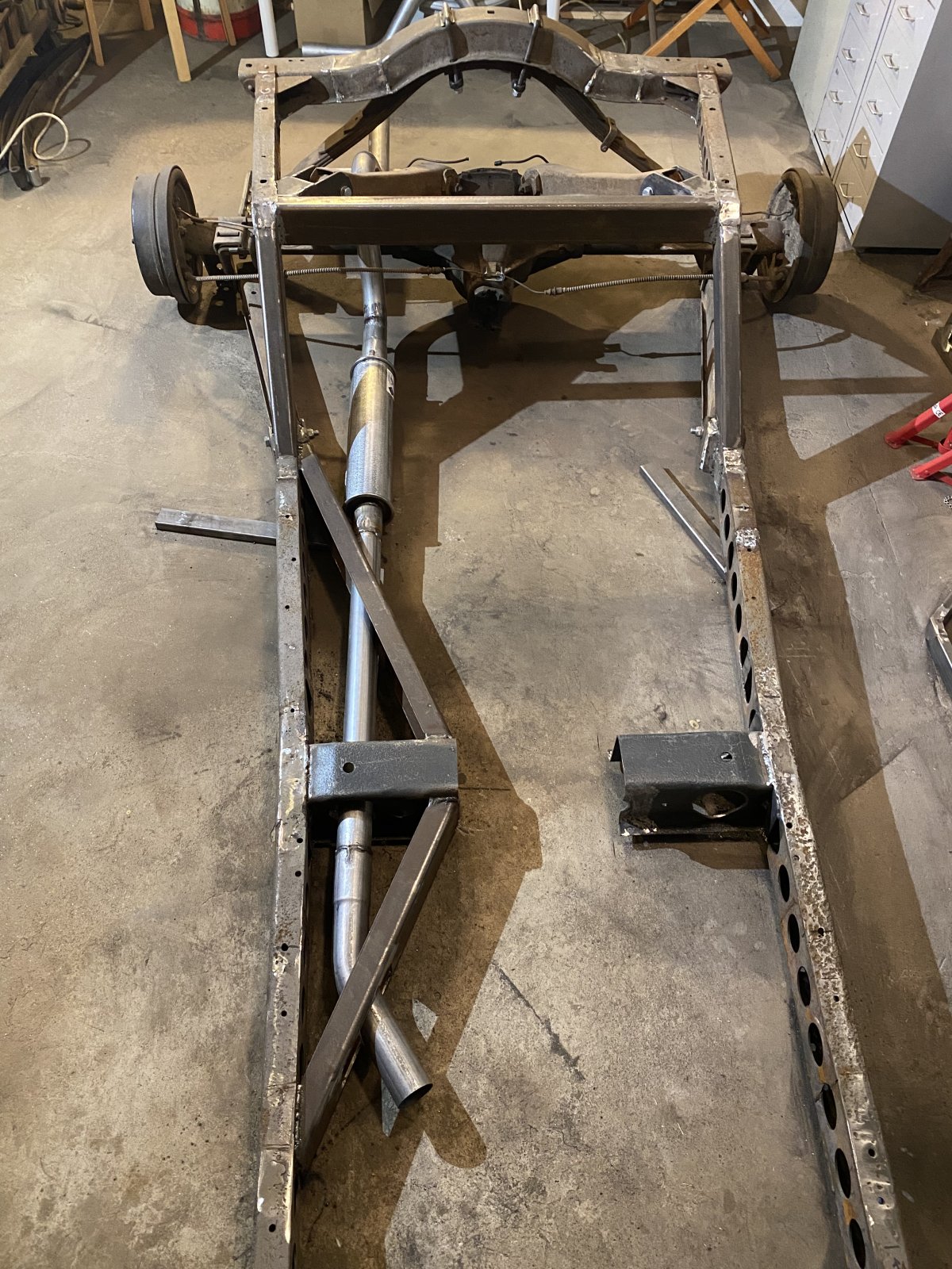

    I like how you repurposed the factory 4 bar rear suspension to the step in the frame. Very cool! I will definitely be following this build.:)

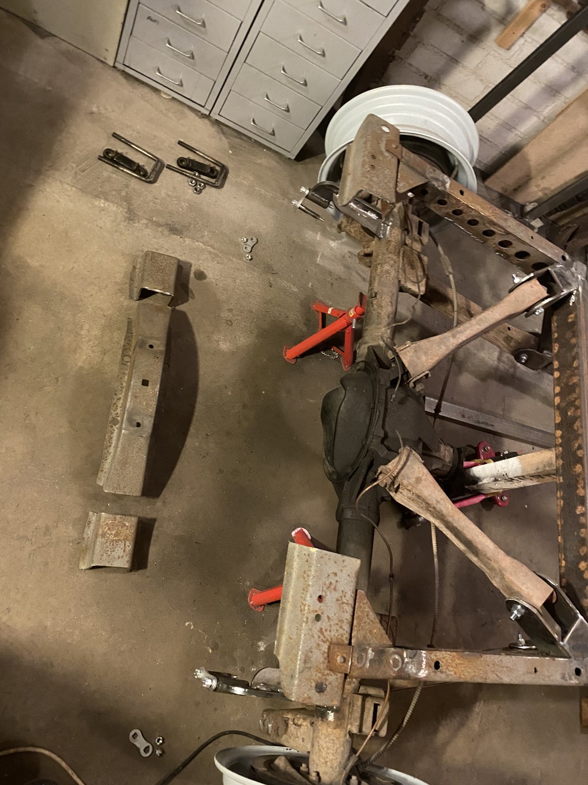

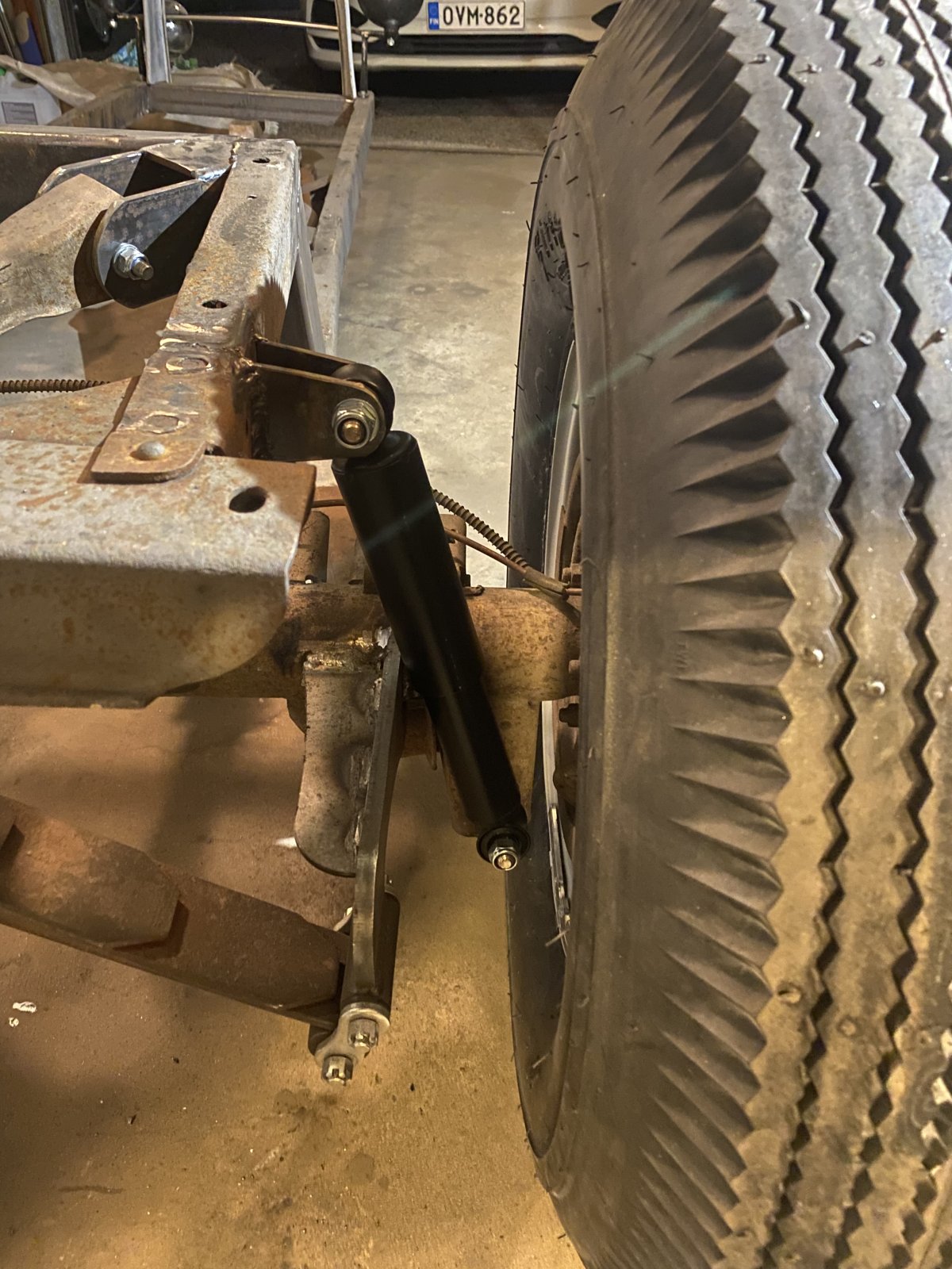

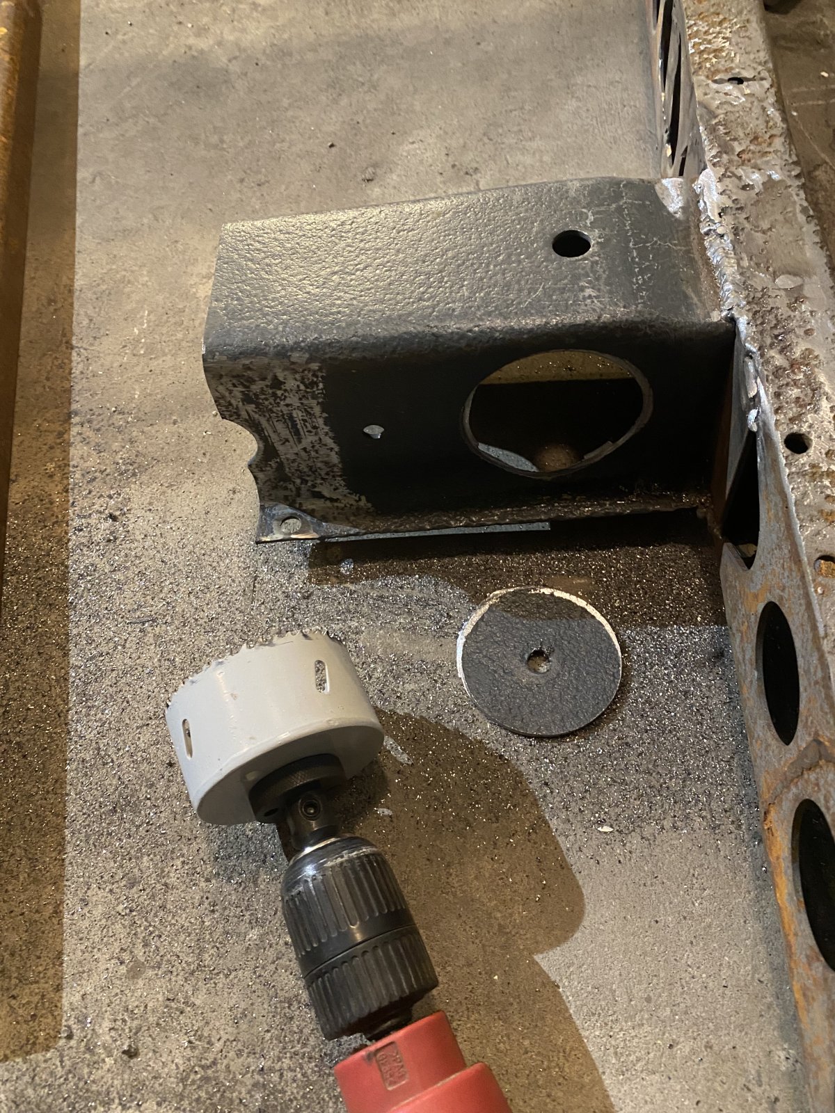

  23. attitudor
    Joined: Sep 28, 2004
    Posts: 3,134
    attitudor
    from Finland

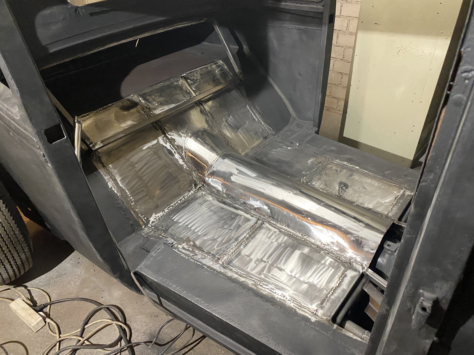

    After one night I’m ready to fix my mistake and make more room. Now it looks OK.
  24. attitudor
    Posts: 3,134
    attitudor
    from Finland

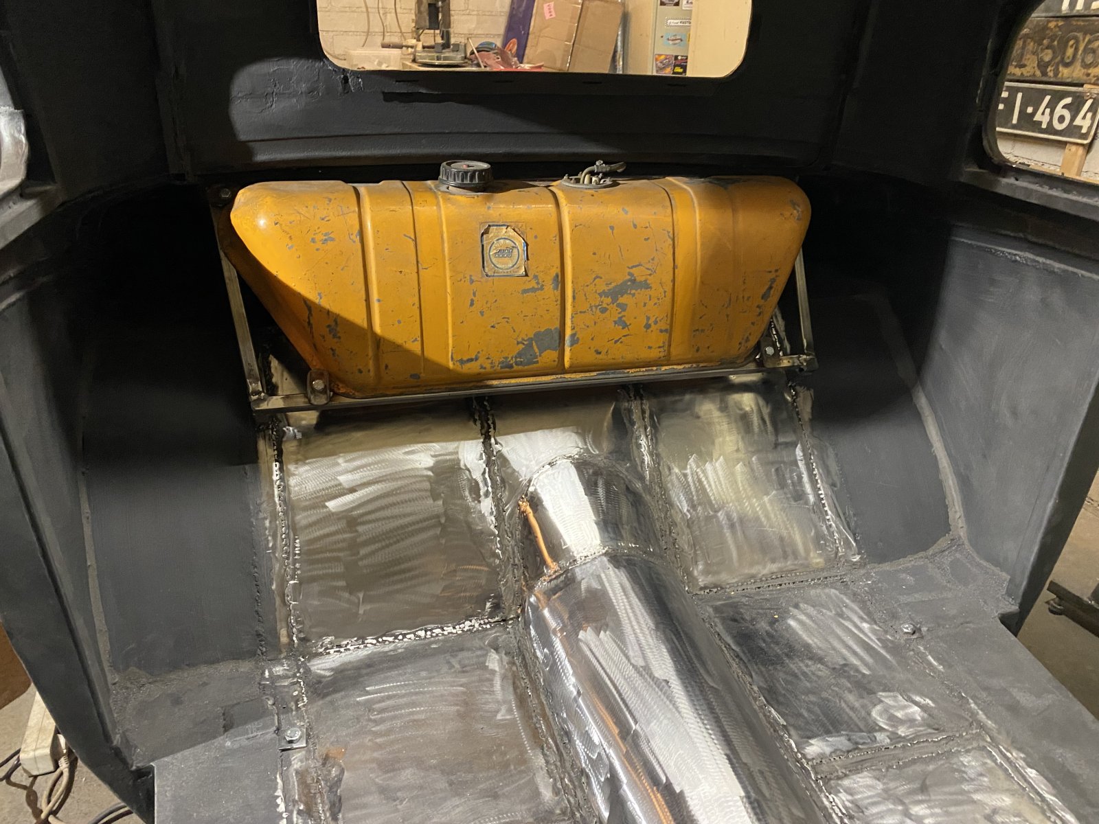

    Fiat 600 tank fastened with VW Bug body mounts. Hot rodding 101: Use what you have.
  25. attitudor
    Posts: 3,134
    attitudor
    from Finland

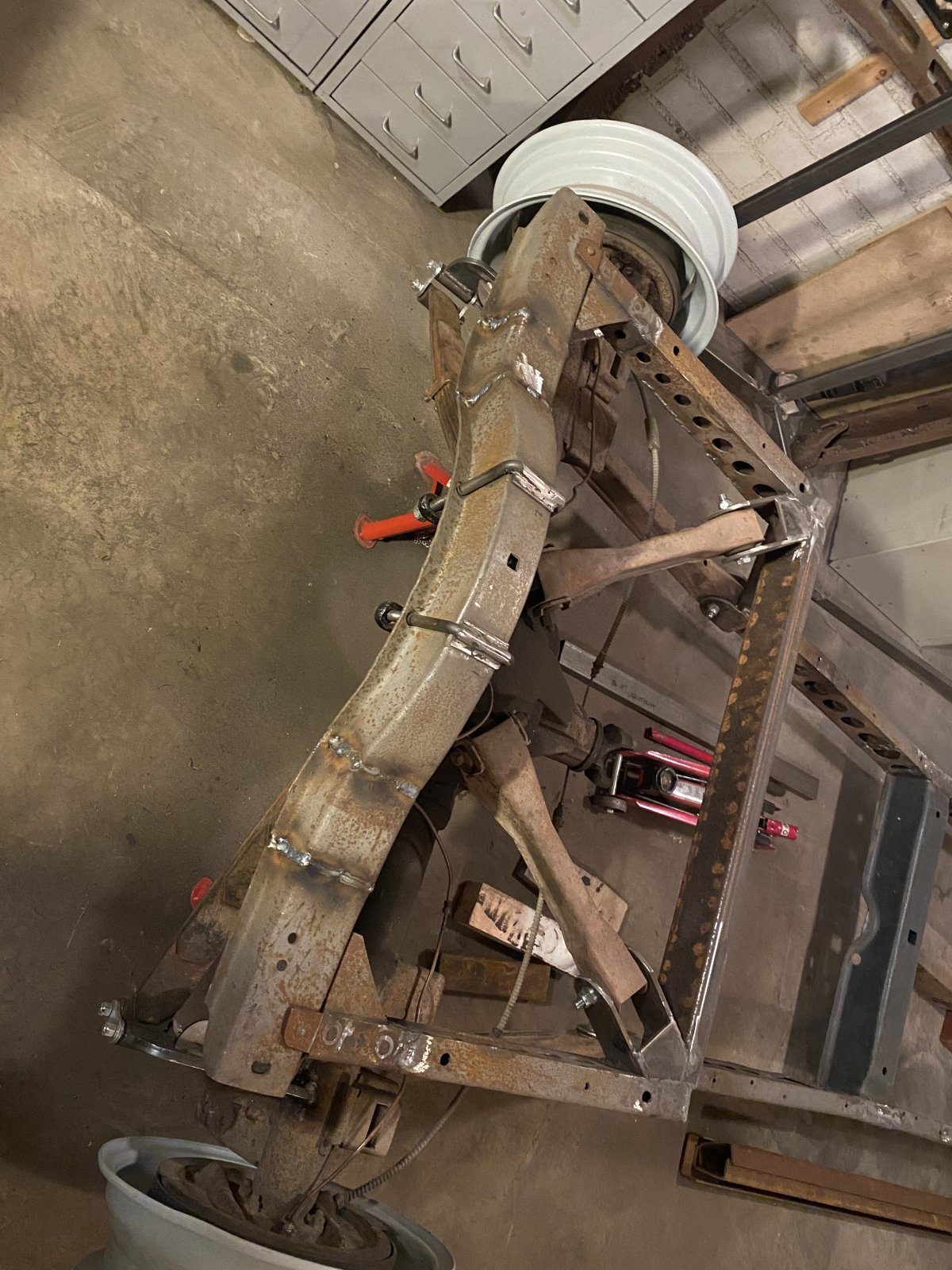

    After weekend rush we have a floor! Also seat in place. Made some space for the tunnel.

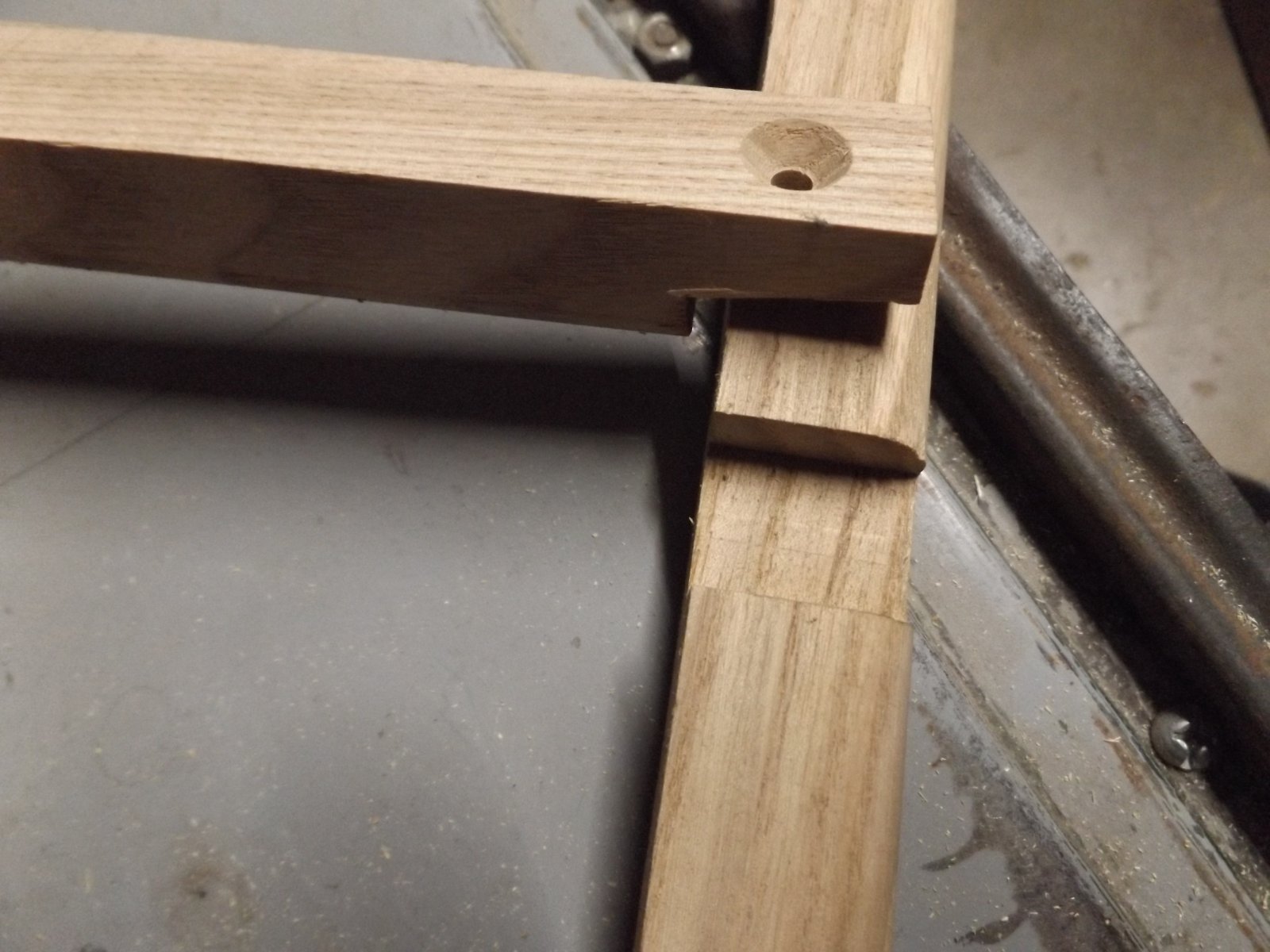

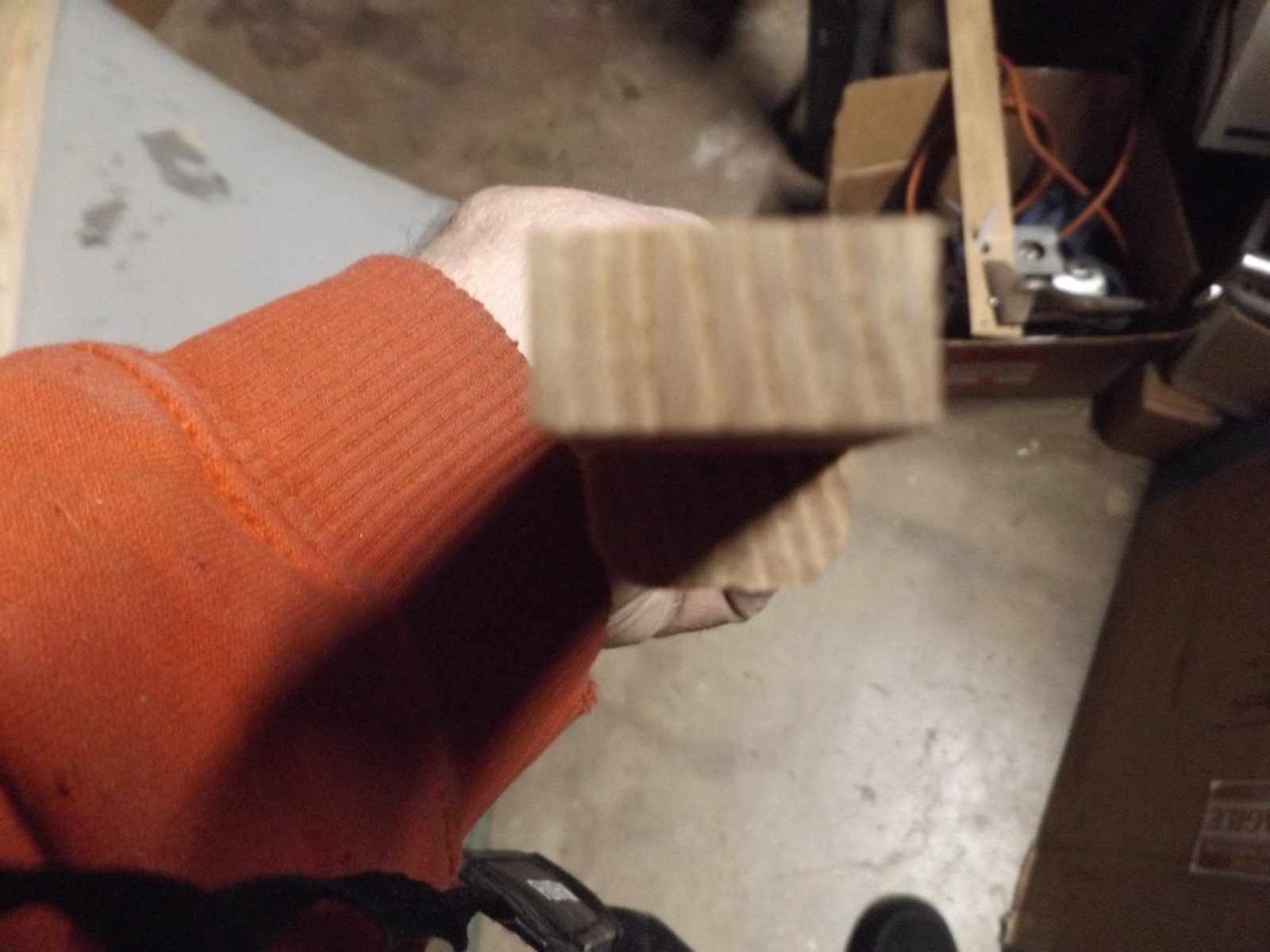

  27. The37Kid
    Joined: Apr 30, 2004
    Posts: 32,495
    The37Kid

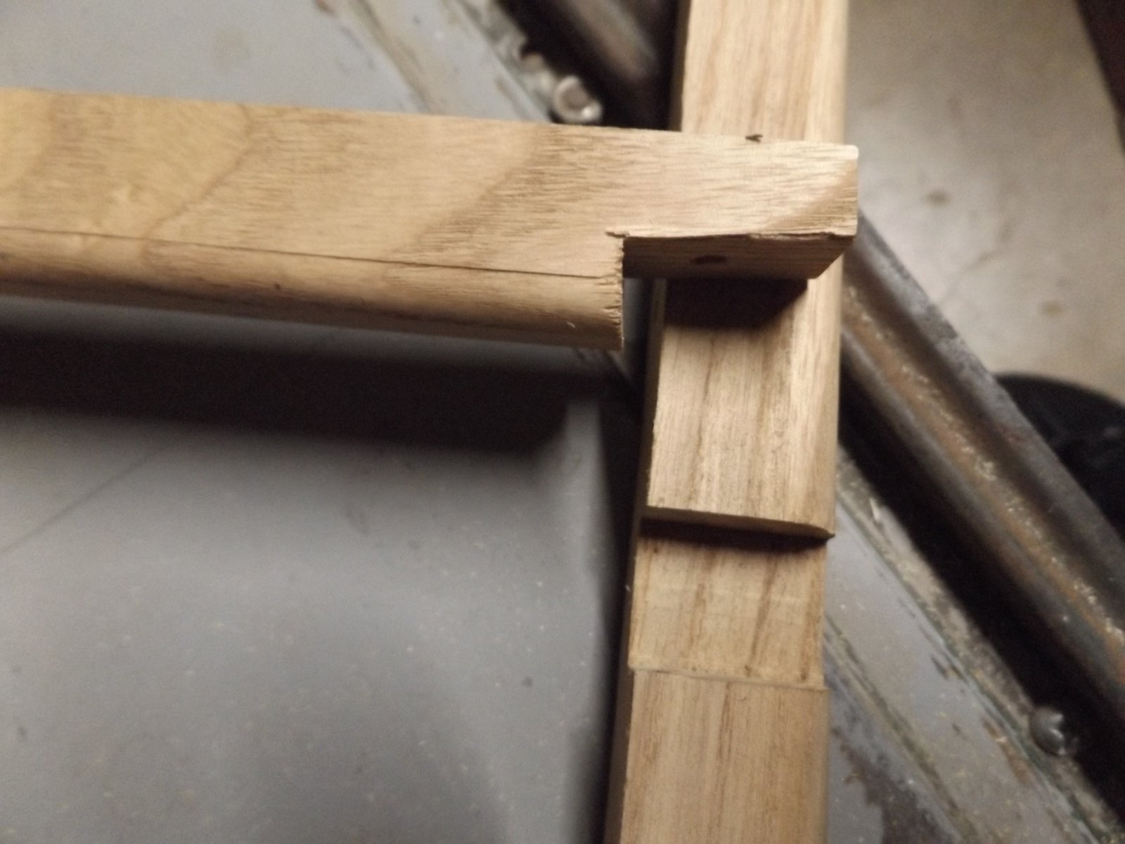

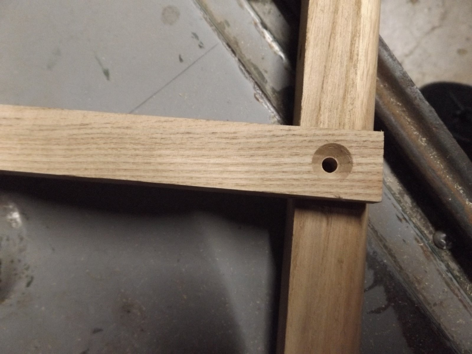

    Some shots of the stock top bow to side rail joints. The underside of the top bows are rounded so they don't effect the headliner. Bob
    DSCF0713.JPG DSCF0714.JPG DSCF0715.JPG DSCF0716.JPG DSCF0717.JPG DSCF0717.JPG
