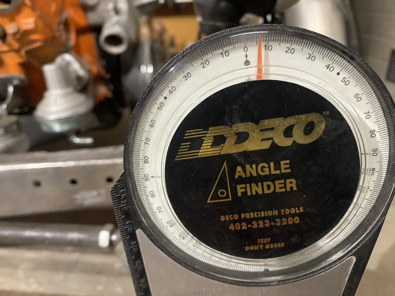

    I bought all parts and target was to ***emble the front axle during the Easter. But I have serious problems, the shackles won’t reach. I don’t know what is the reason. All parts should match. 48” axle, 31 1/2 spring, 2” shackles. What’s wrong?
    [EDIT] The perch boss center-to-center is 38”. This must be a spring in front type of axle. Damn.

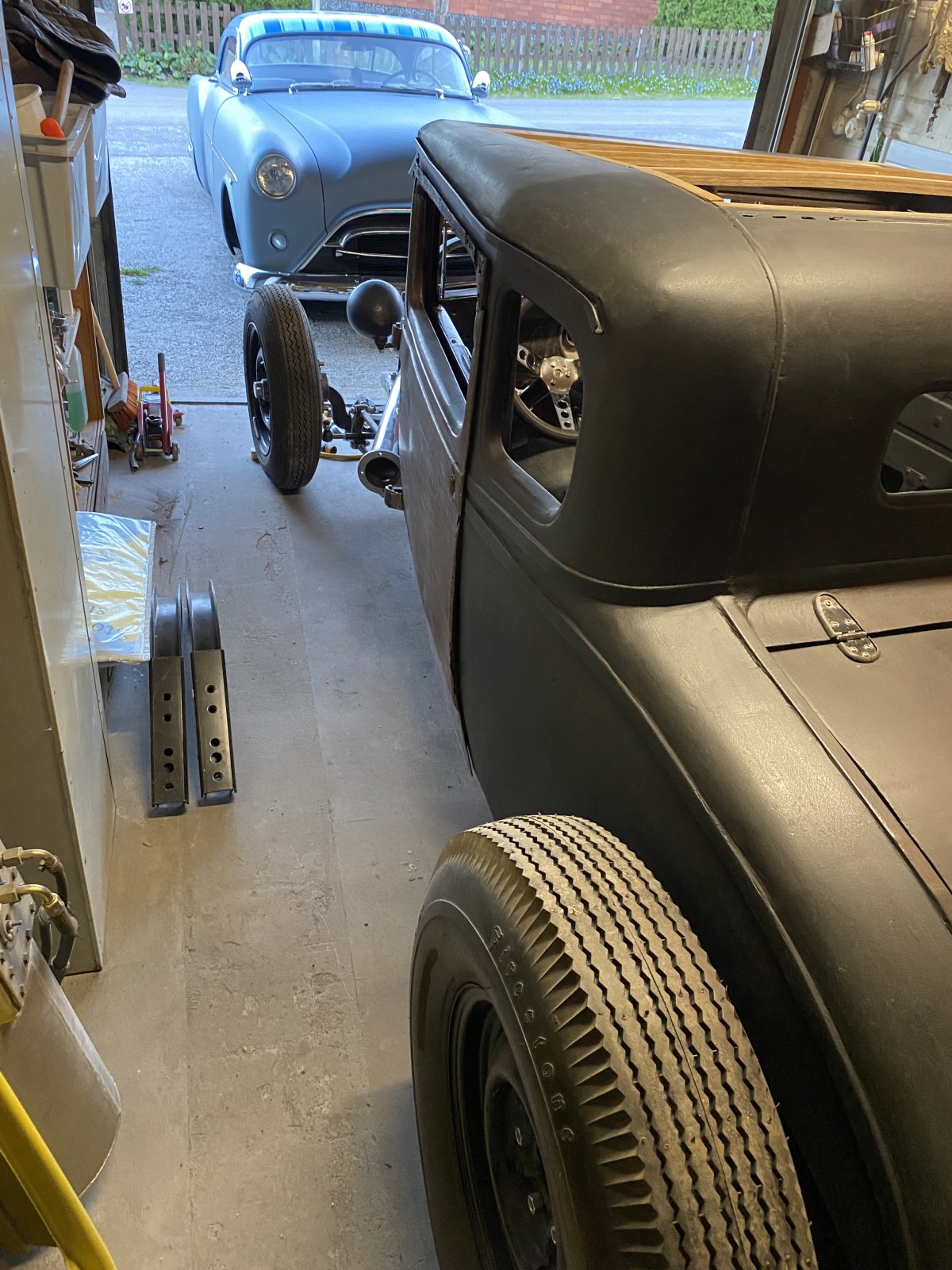

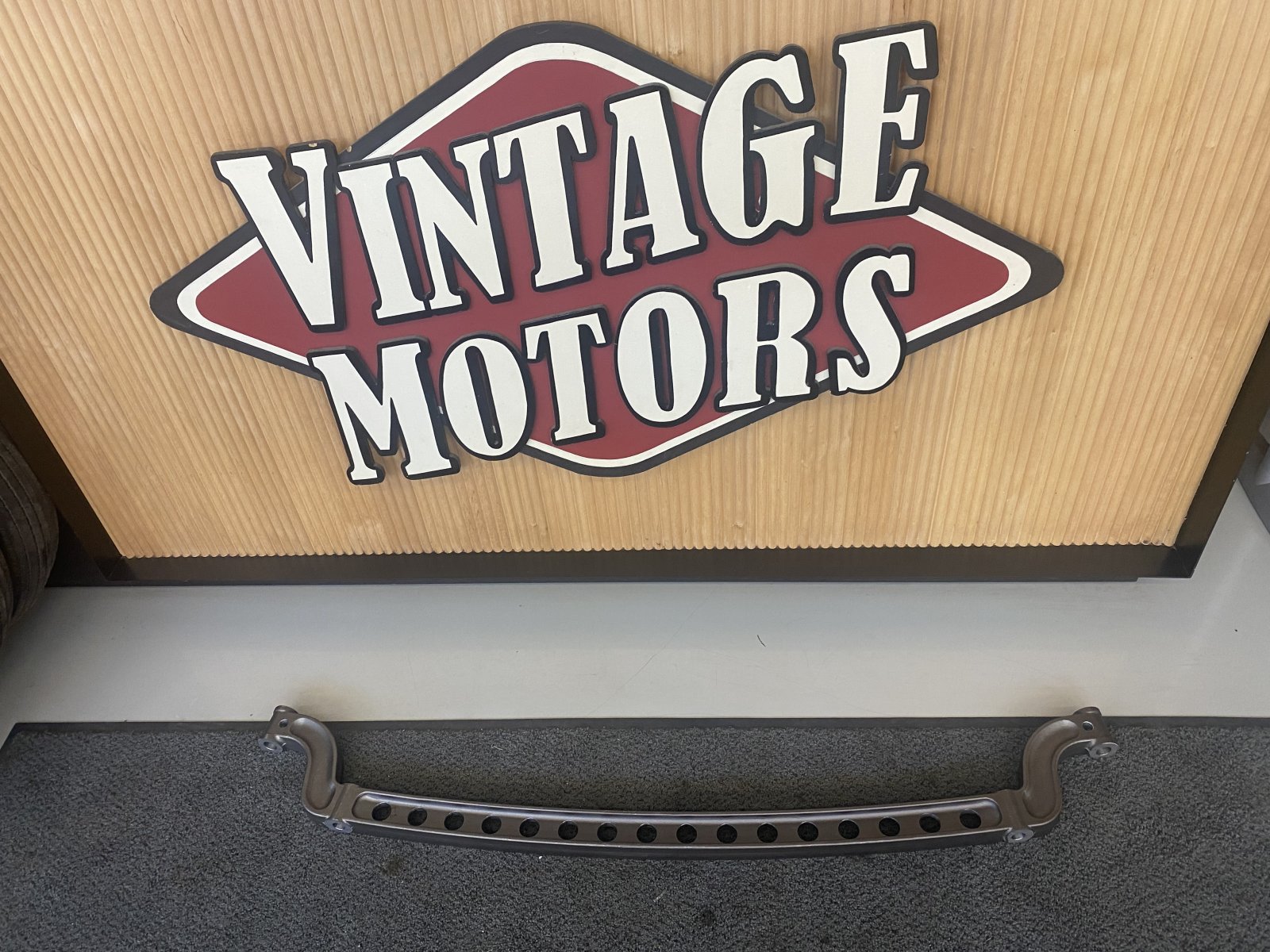

    The show must go on, Let’s continue with a brand new axle! Cool old School Roadster was visiting the shop at the same time. IMG_1755.jpeg IMG_1754.jpeg IMG_1756.jpeg IMG_1757.jpeg

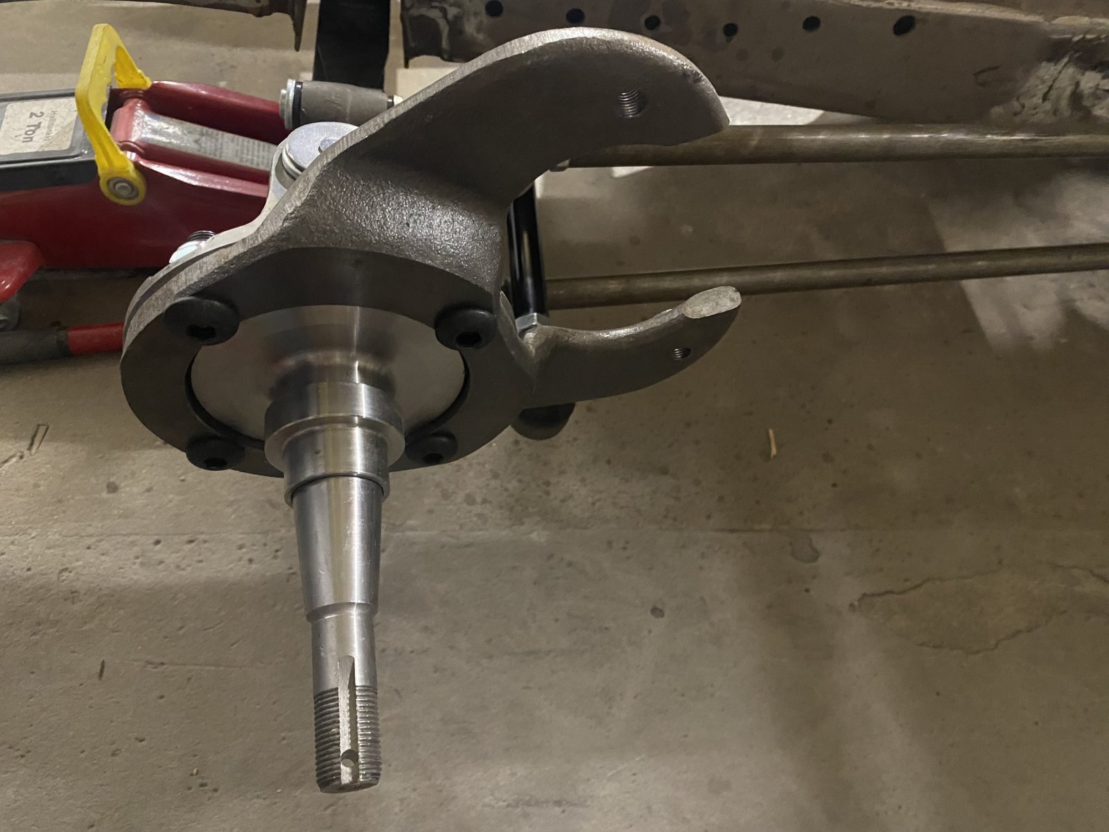

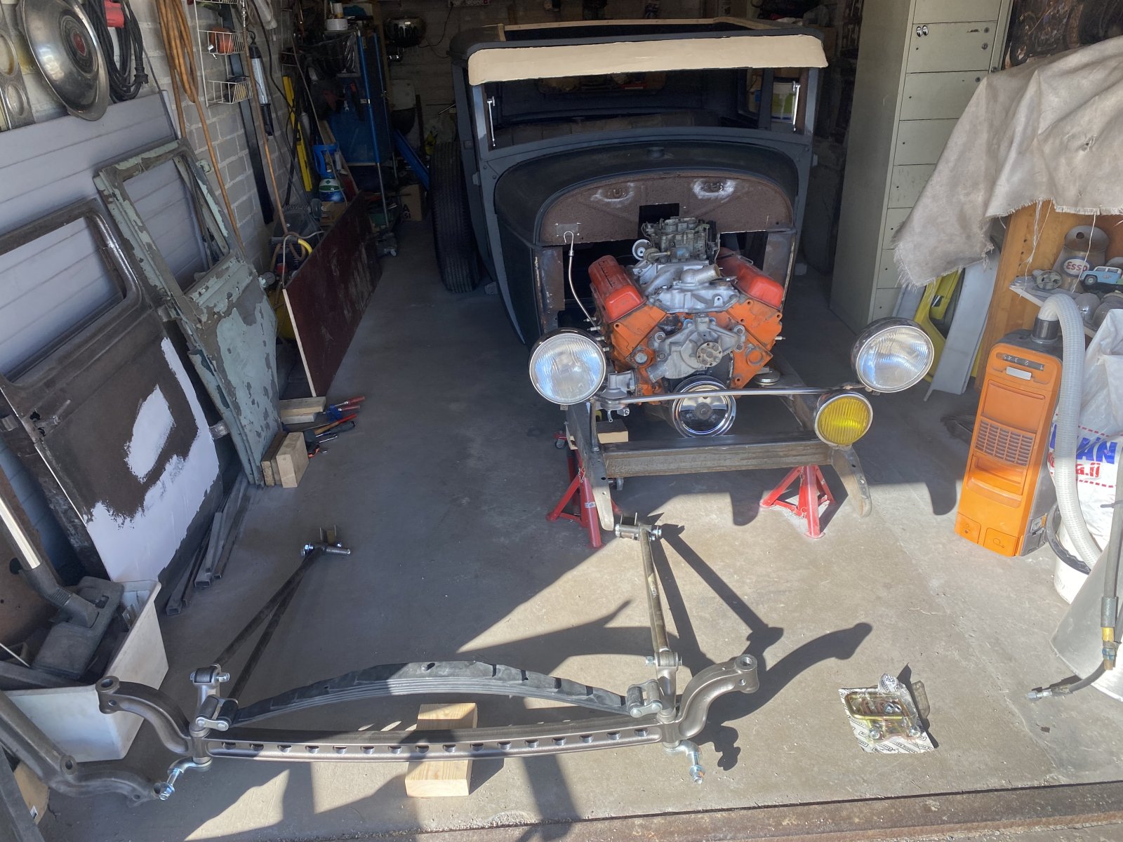

    Good progress today after all the h***le. We have an axle.

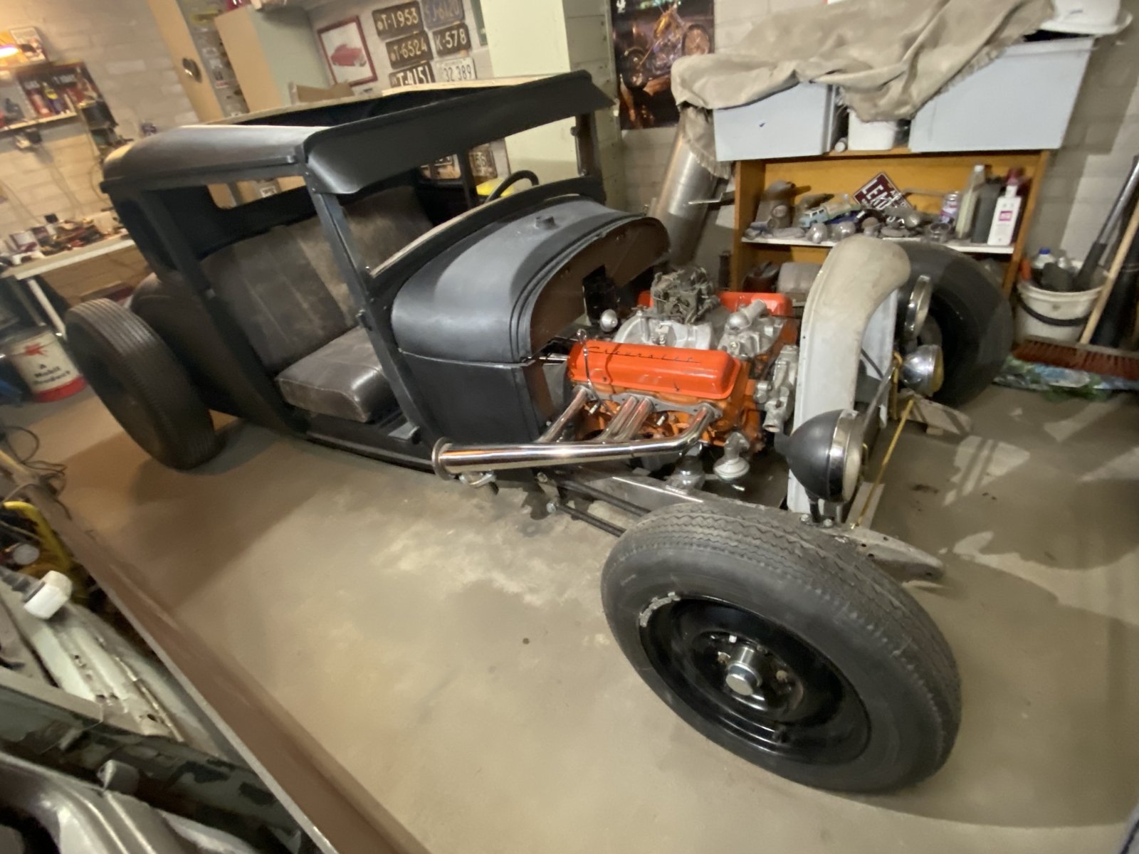

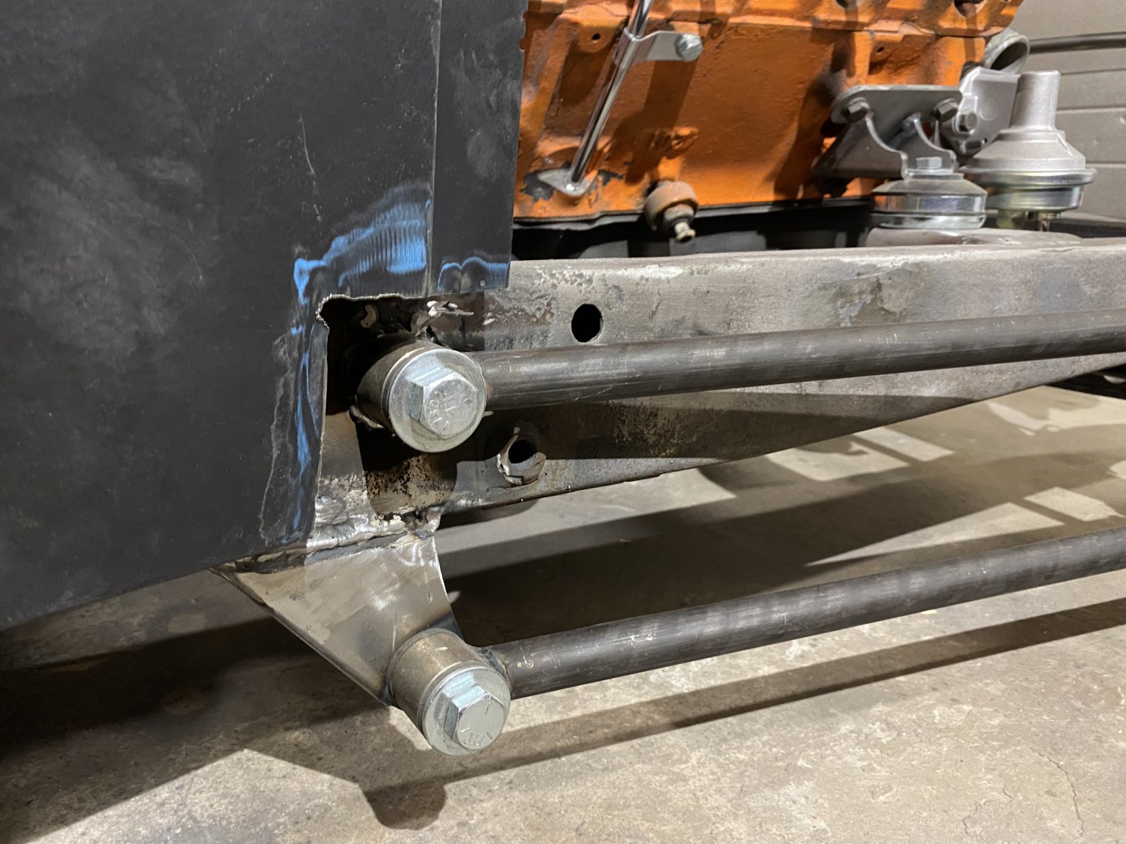

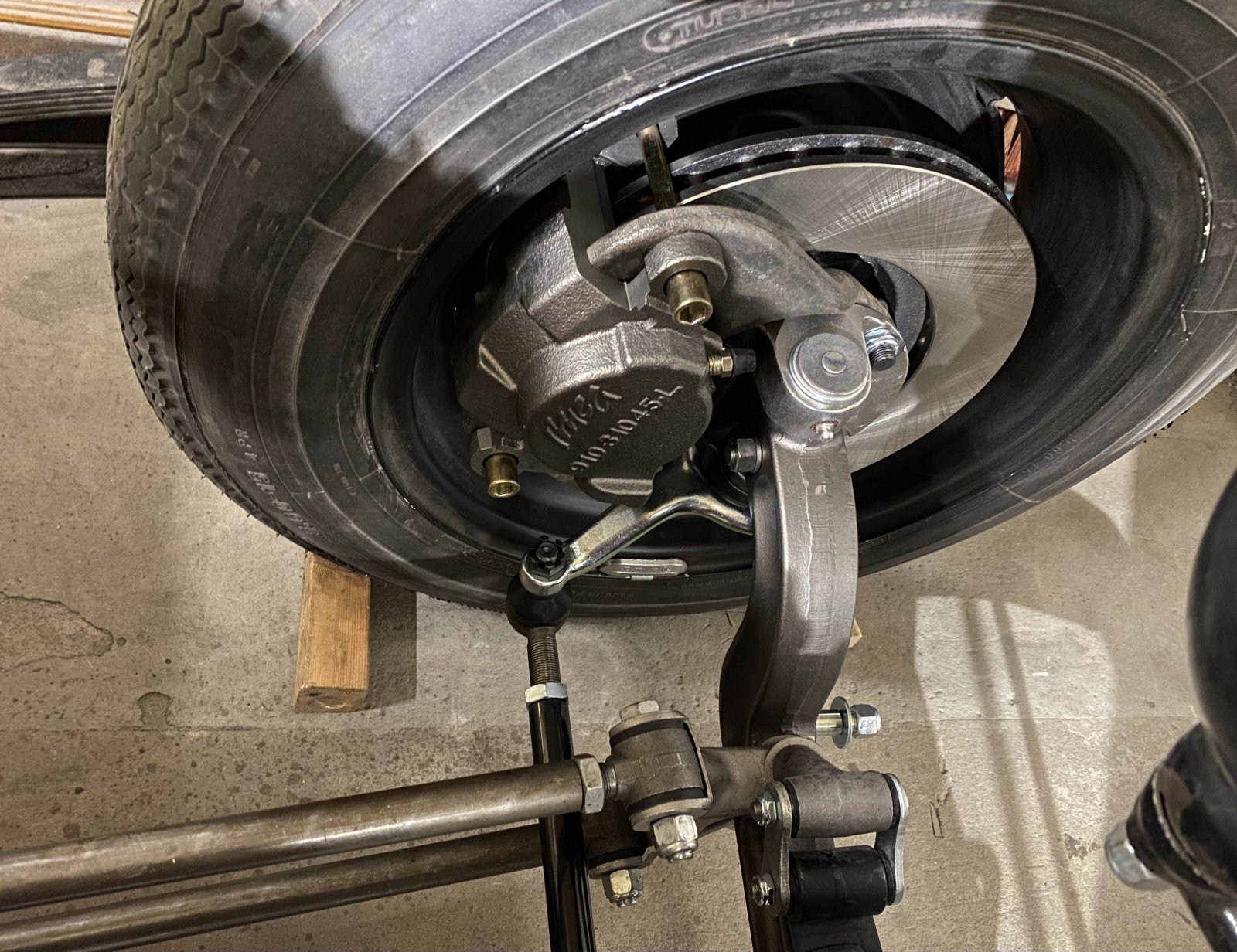

    We have a rolling Hot Rod! First time rolling after decades. This was my target for this building season.
    In Finland we must have disc brakes and fourlinks for a SBC. They don’t look too bad. Also I’m very happy with the quality of parts.

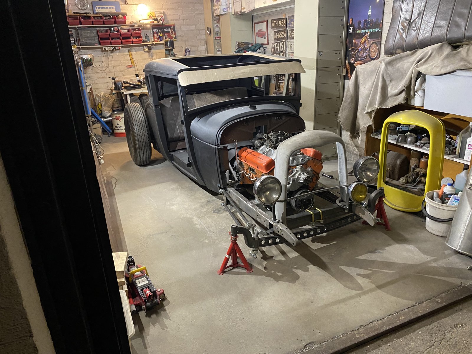

    We are outside! Feels great to see what I have done during the winter. Looking just right! I’m very happy how the Hot rod came out.

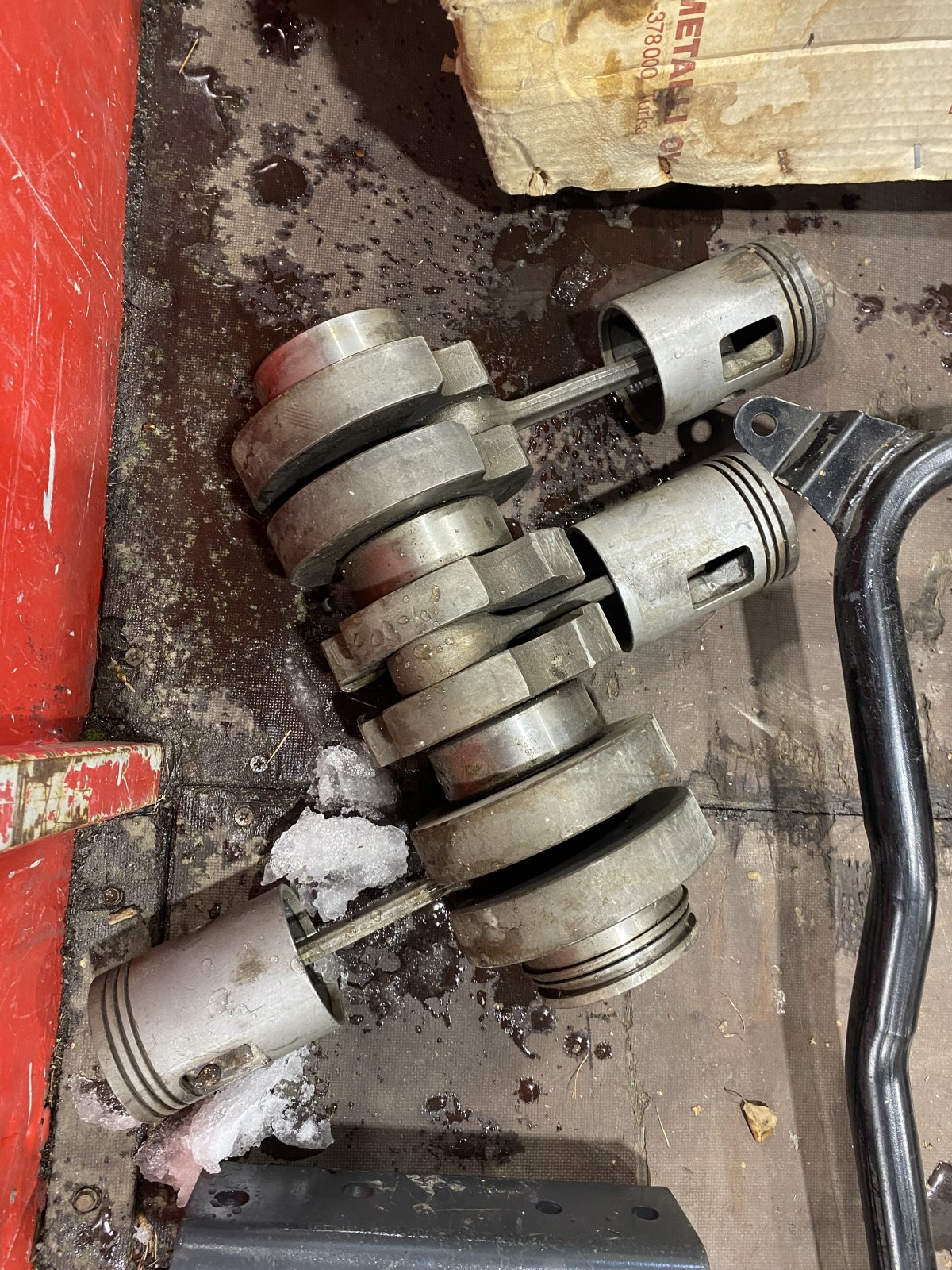

    That 4 banger crank sure has some severe counterweights....do you know what it out of?
    attitudor likes this.
  13. attitudor
    Joined: Sep 28, 2004
    Posts: 3,134
    attitudor
    from Finland
    It’s a 3 banger. I asked, and it is from a 1964 DKW from East Germany.

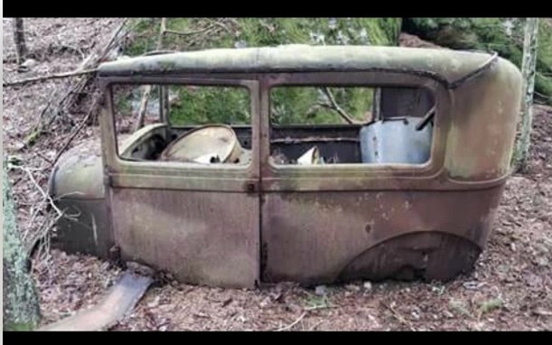

    I received cool photos of my car when it was found in the Finnish forest after decades of resting.

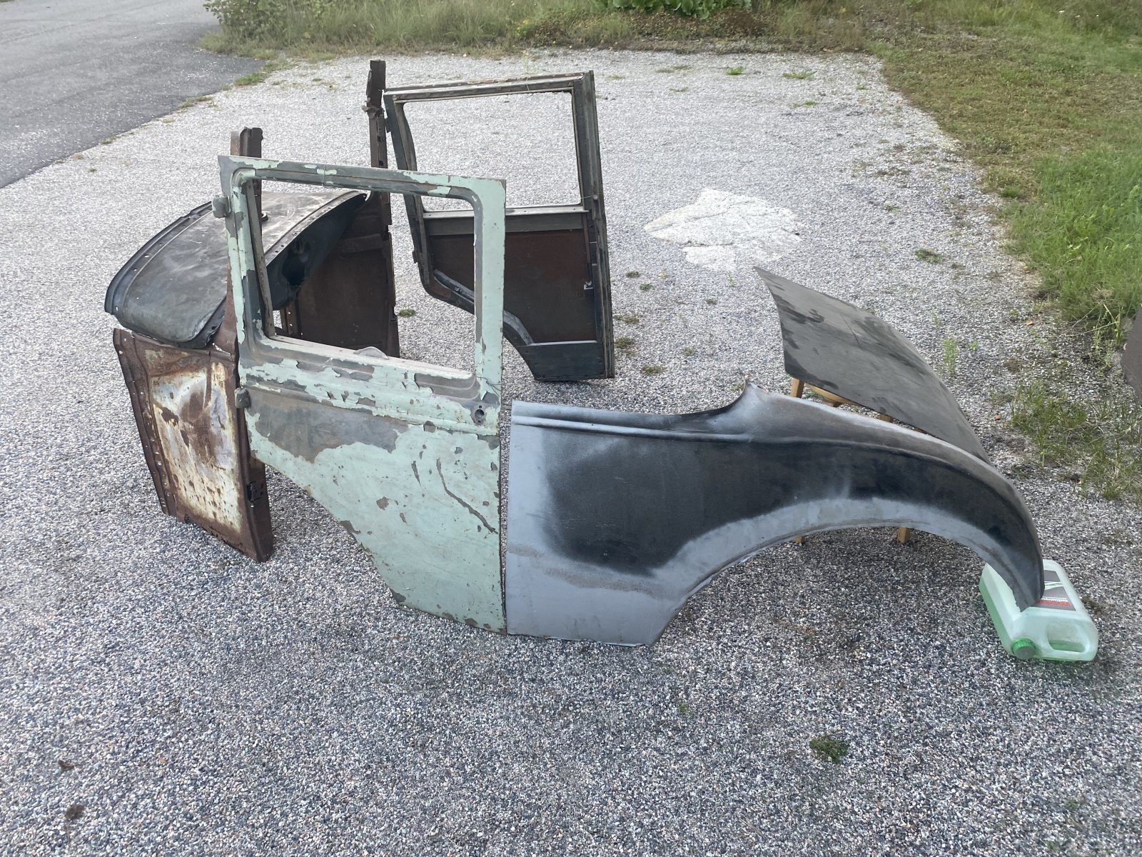

    Hi again. Summer is turning into a fabrication season again. I haven’t started with Coupe yet though. I made some horse trade earlier and got me the 30-31 Model A Murray back doors. They are almost the same lenght than Roadster doors. So I let that idea grow and here we are now: During the summer I was able to score all these parts which I will call a ”Roadster” now on.
    Now there is at least one rear quarter which is 100% more than what I had for the Coupe. I built them basically from scratch by hand.
    And also it will be way nicer to go to swap meets when you have something to search for.
