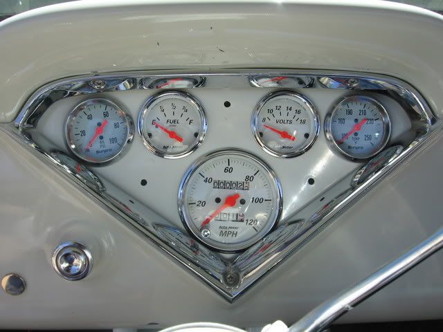

    Nice trucks for sure man. Heres a few pictures of one my grandpa built. Its on a 64 c10 frame. 327/350 combo. Everything done by him including paint and bodywork.
    [​IMG]Gauge Cluster was also made to fit gauges instead of ordering one
