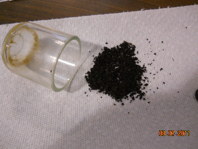

  7. Bob, the fuel pump was a M958 Carter - but remember, it was for a Studebaker. I think Carter has an awful lot of these old pumps still available - Look for the right one for your truck on Rock Auto to get the part #. There are a few places out there that sell rebuild kits for the carb and fuel pumps that have new material to deal with the alcohol in the gas - When I took the old pump apart it had a pinhole in the diaphram and lots of "about to fail" cracks in it.The customer didn't want to pull the tank so I put a filter in front of the new pump to protect the pump and the newly rebuilt carb. Here's the crap that came out of the sediment bowl - that pile's 1/4" to 3/8" thick.
