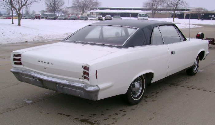

    I just found some pictures of my old projects. As you can see. This is my first real body work project.
    • Pink 65 rambler- 304 v8 Hurst promatic2 torqueflight trans.(Sold at 16. was my only car and I had no idea how to work on it. My dad never had time/the skill to help.)(mistake)
    • Blue 67 rambler rogue 232 inline 6 (bought and drove for about 6 months. Sold it and bought the rebel the very next day.(opportunity)
    • White 68 rebel 232 inline 6. Bought for 1000 bucks with transmission in the trunk. Installed it in saturday body shop and drove it home. Replaced a few odds and ends. Came short of money, and was burning oil like mad. So i sold it. A week later bought the 56 Studebaker.(opportunity)
    • 56 studebaker 259 V8. Bought it for 1500 bucks and drove it 100 miles home after it sat for 10 years in a drive way. I painted it and had the seats done in it, but I was pretty unhappy with the way it turned out. So i sold it.(mistake)
    • 72 comet 250 inline 6. Bought for 1000 bucks. Blew a brake line on 100 mile drive home. Shot black smoke all over. burned my eyes to stand behind it. I threw a carb at it, and rebuilt the ignition parts. Ran perfect. Bucked and darted all over the highway. Took it to get aligned with my fingers crossed, and my trusted mechanic refused to put it on a lift and said it was so rusty, the best bet was to unload ASAP. Sold it in 8 hours and made money.
    So as you can see, i like to play. I still have a ton to learn about patience and craftsmanship though.

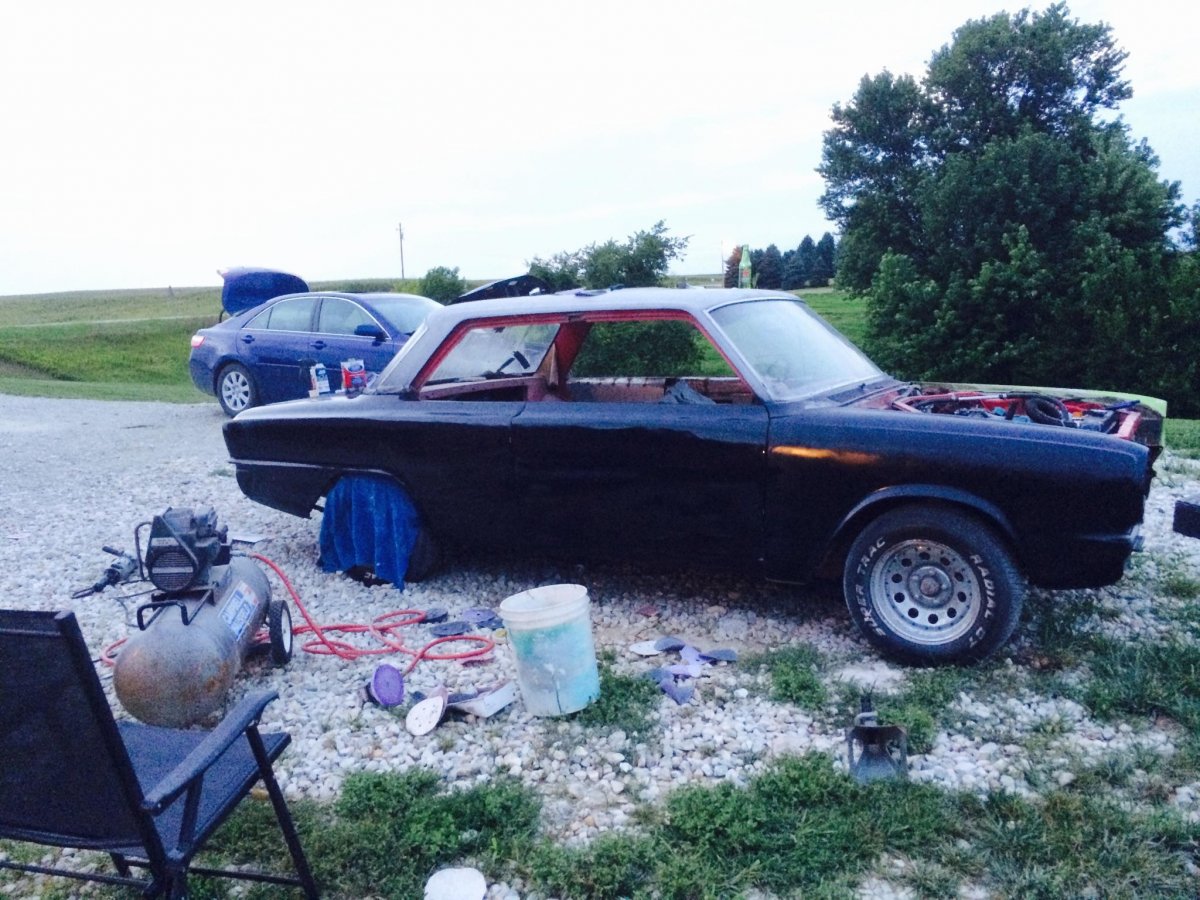

    So last two nights, re fabricated the passenger door. Learned some stuff. It has taken so much patience to hold off and do this right. My body hammers and dolly blocks came in last night. And I tried out my new inline sander as well. So, I'm really dreading having to chop the drivers door apart again, but the filler I put over my garbage work is cracking, and I'm so happy with how the passenger door is going.
    I would like to take a second to plug a book that has helped me tremendously. It's called "Eddie and Paul's custom bodywork handbook". It is super disorganized and the first section seems like they had a deal with some tool companies, but it made me remember a ton of stuff that I had learned at some point but forgot. Super cheap book, worth the money 10x.
    So new problem I hit, need a bit of advice. The inside door handles are not going to work now, because the glass pane inside the door is much larger than stock, so I will have to fab up a cable linkage as the latch mechanism is on the outside of the glass. Would a solenoid system be a good option for this? I really dislike shaved outside handles, but a*****on on the inside would be cool opposed to a handle. I'm not sure, sounds like a good way to get trapped inside as well?

    Do you not have a bending brake? It looks like you're cutting and folding sheet metal with pliers in that second pic. You can get a cheapo 30" from HF for $60 right now. I've got one, it does its thing and is cheaper than the time involved in making one at that price.

    Probably cant tell too much difference, but i spent a ton of time skim coating and sanding the quarter, probably needs another pass or two. The door is next, then i'll tackle the driver door. A neat trick I learned was to take fiberglass resin and mix it in with the filler. Its listed as a tip on bondo's website, and it really does work. Especially if you want to mix up a big batch and skim coat a large area, it takes a couple of hours to get it fully hardened. The only short term draw back I see is clogging up sanding discs if you try to sand too soon.

    So I got the drivers side looking pretty good. I was ashamed at how bad my driver side looked, so i cut out my old patch panels and found the the not so much younger, dumber me, had like 1/2 inch of filler on the door. I'm cutting it all out. I used a piece of rail road track to hammer in the complex shapes. For whatever reason, I cant upload files from my work computer today. Ill try and up load them later.
