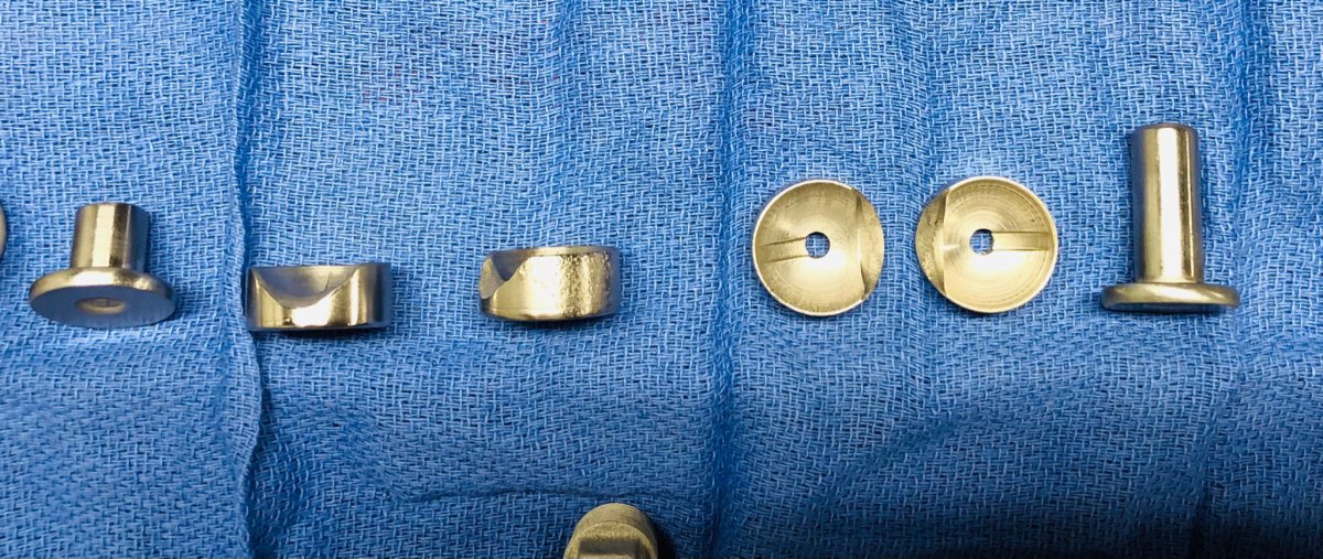

    I think they are heat treated, meaning through or case hardened, which is just about .03 deep. The area of contact is usually polished. Give one the file test. On the back side edge run a smooth file over it. If it zings it's hard, if it leaves a mark it's not. I am sure it will zing.

    Doug that would make sense. I would think they should be heat treated with the metal to metal contact that they are subjected to. Grease can only do so much so I am sure they were designed to take quite a bit of abuse before they fail-or I would hope so.

    I’ll give them a “zing” check next time I have a day off from working. Would the bead blast affect the case hardening?

    Not unless you blasted them long enough to get them HOT!

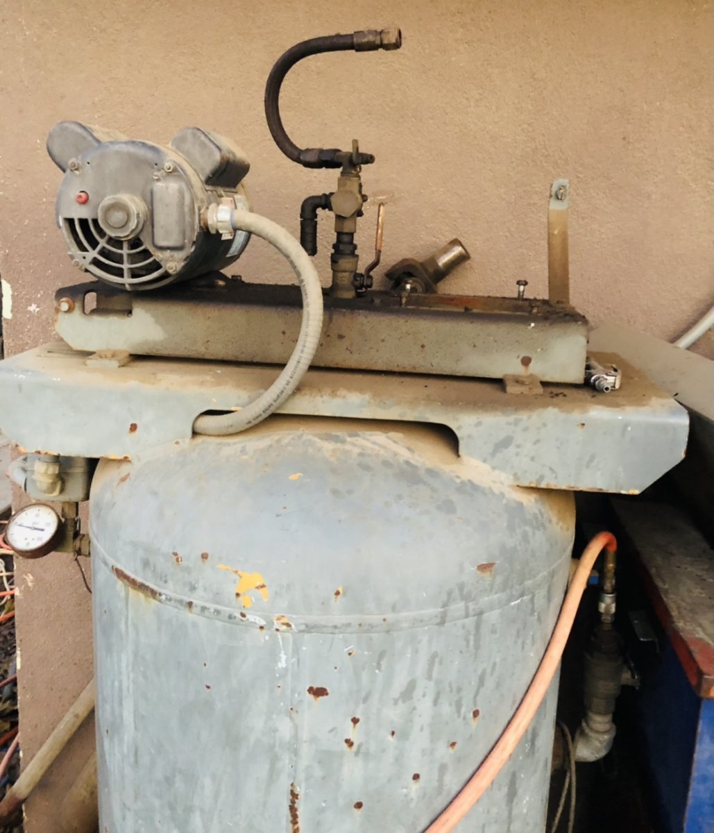

    And just like that my compressor locked up! [emoji30]. Hopefully it didn’t hurt the motor too. I really hope this doesn’t slow us down too much on the 61. IMG_3507.JPG IMG_3506.JPG
    Granted it was over 50 yrs old! Lol.

    I asked My buddy down the street (an old time hotrodder & machinist) if he could throw these in his lathe and polish them up a bit. He brought them back and said did you know these are case hardened? Lol. IMG_3510.JPG

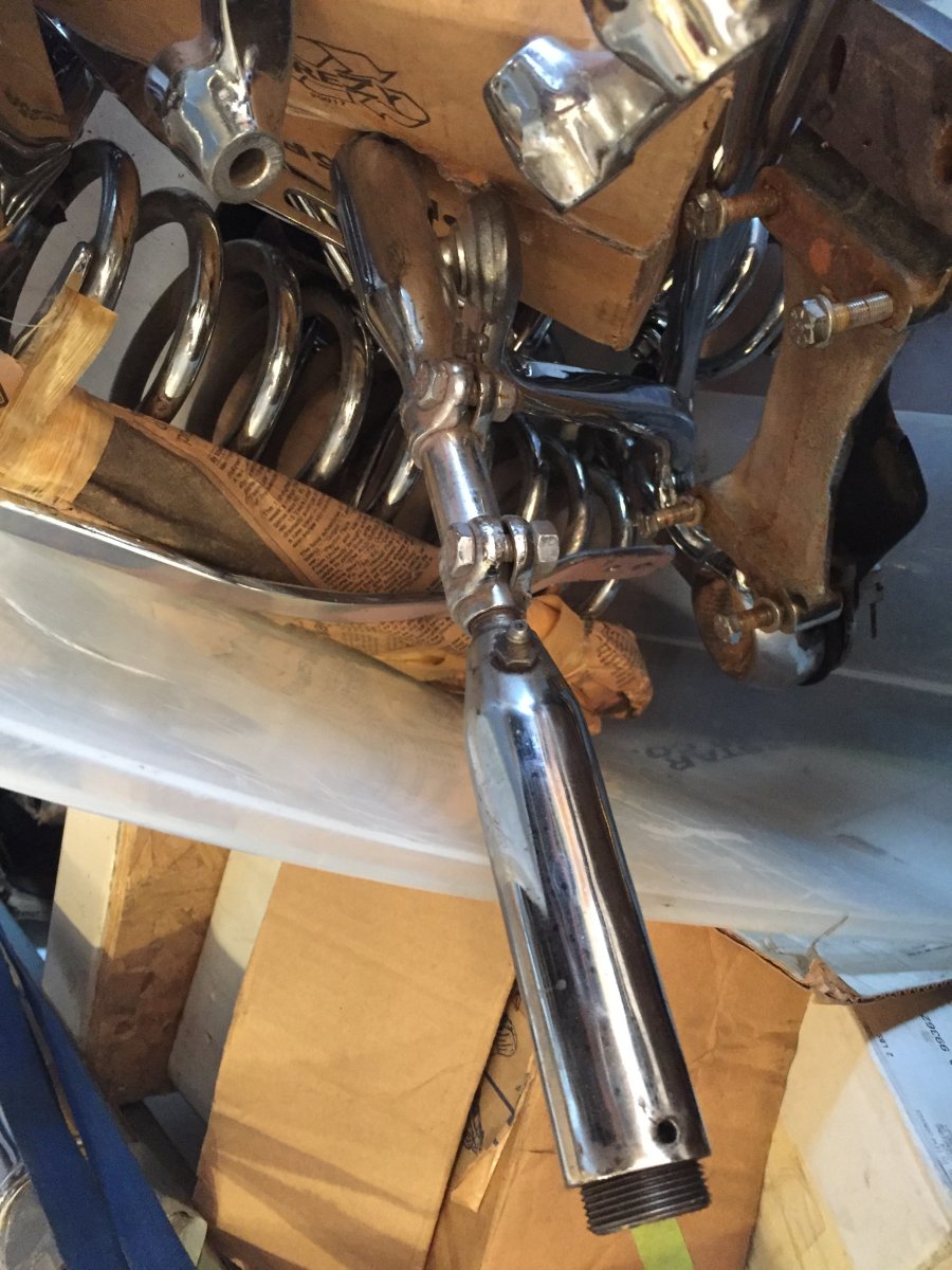

    I’m not doing a nut and bolt restoration but what color is the steering connecting rod suppose to be?

    Doh! Same thing happened to me about 2 months ago although mine is only about 25 years old. But, mine threw a rod out the side... I am currently using my grandfathers little 20 gallon compressor to get me by until I can fix my big one.

    I guess they are supposed to be chrome because I have 2 chrome ones

    In the day the front end came to the ***embly line as a sub ***embly. Everything was basically semi gloss black. An asphalt base ****. Not very durable. Paint it whatever turns your crank.

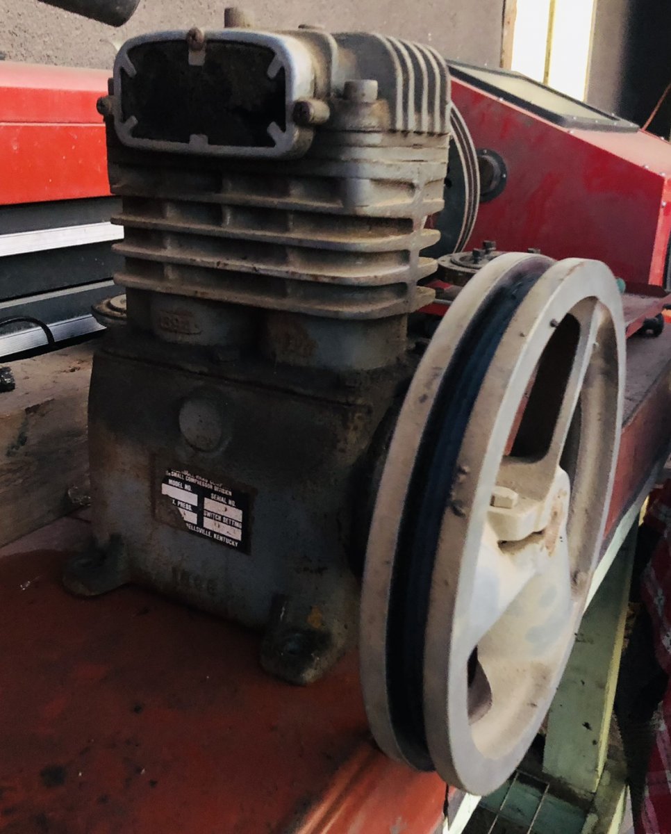

    Looks like the number one rod seized on the crank. Plus It had worn rings. I found another on eBay. I might get it to mess around with.

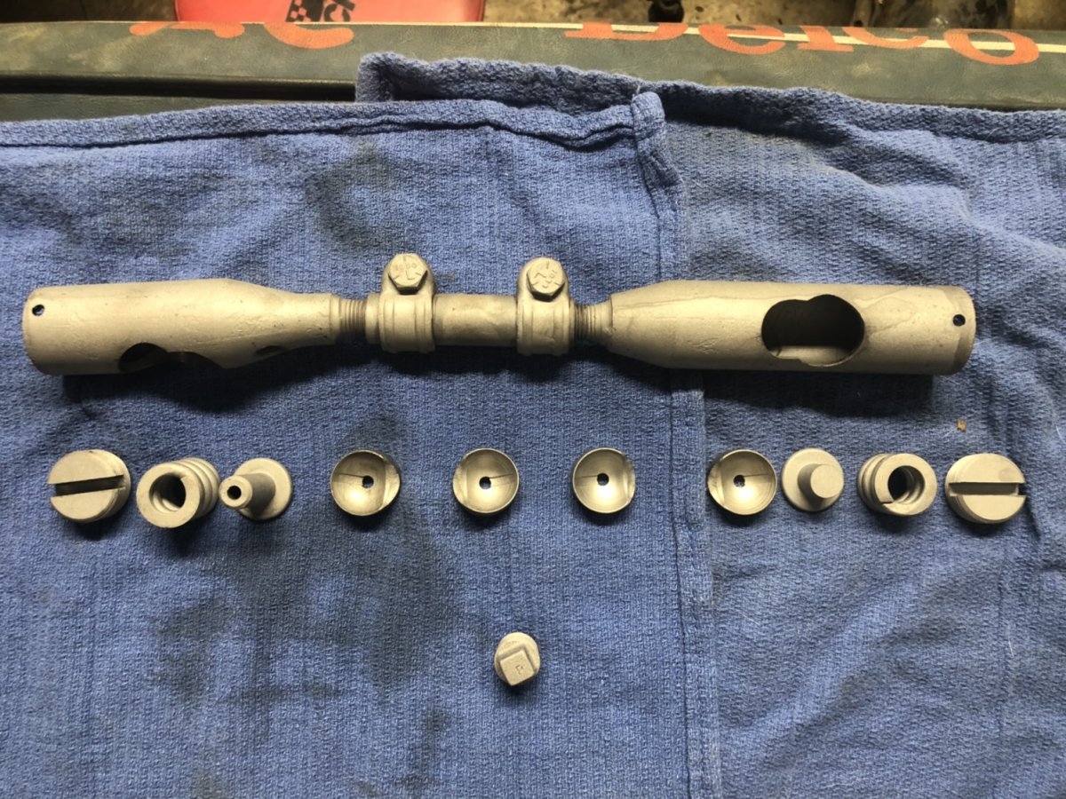

    Ive been working a lot because of covid so I haven’t had a chance to do much the past 2 weeks! But tonight we finally got to get back to the 61. The boys and I were able to get the third arm out fairly easily. IMG_3843.JPG

    So the bearing snap ring came out no problem but how does the bearing itself come out? I tried a little heat hoping I could melt any “gunk” that might be holding it in but it is still stuck in there. Open to ideas from those who know! IMG_3844.JPG

    You need to get it squeaky clean so you can see any parting lines. My guess is you’ll have to make a little cup shaped tool and use a nut on the stud to pull the bearing out. Better yet, get the rebuild parts first so you have them and can see what’s what.

    Scott, I am ***uming you do not have a copy of the Corvette Servicing Guide for the solid axle cars (C!s). It is a must and is available I believe through most Corvette suppliers. It has a 62 Vette on the cover with a sailboat off to the right. I am copying a page from the guide telling you how to do it.
    Scotty mentioned a good point and that it to insert a zerk fitting which you can do when you remove the bearing (so you do not put pieces of cut threads into the top of the bearing). Below you can see the scan I made which should help. The last one I did was the worst. I had bought a project and the steering was locked. When I removed the third arm it was rusted so the steering and nothing would move. I soaked it in my rust remover and it did nothing. I then tried the method below but it would not budge and I thought I would bust the housing. I then decided to drill a hole in the top ( directly opposite the shaft and nut on the bottom) and it was small but I was going to use if for a zerk fitting. I then used a thin drift that would fit through the hole and used heat and with tapping on the arm with the hammer and tapping on the drift I finally got it to free up. There is a zerk that is closer to 1/4" diameter which I ended up using. Third arm 001.jpg

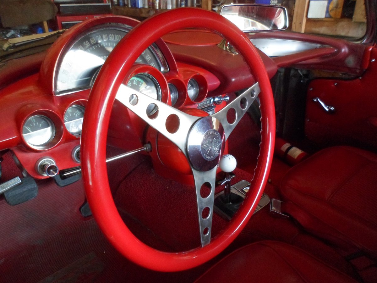

  19. Bob Lowry
    Joined: Jan 19, 2020
    Posts: 1,605
    Bob Lowry
    Another idea..non-leather wrapped...they do make it MUCH easier to get in...Bob SAM_1305.JPG

    The small grease fittings are 1/4-28 thread.

  21. Moriarity
    Joined: Apr 11, 2001
    Posts: 37,497
    Moriarity
    SUPER MODERATOR
    I went with a 13 inch Cragar wheel on mine, works great ...
    scrubby2009, catdad49, Baumi and 7 others like this.

    Scotty T - great idea! I was actually wondering why it didn’t have a zero fitting after we pulled it apart!

  24. 31hotrodguy
    Joined: Oct 29, 2013
    Posts: 2,699
    31hotrodguy
    Bob that certainly looks good! View attachment 4925278
    Hey Moriarity,
    Any chance that cragar wheel comes with the whole Pearl white interior? I never get tired of seeing it!
    For you guys running a smaller wheel I ***ume steering effort is not too much a problem? Keeping in mind that up until a year ago I have pretty much only driven a non pwr steering car all my life. BUT they always had a large stock steering wheel.
    Thanks
    Scott
  25. Moriarity
    Posts: 37,497
    Moriarity
    SUPER MODERATOR
    steering effort is ok, just a little high sitting still but as soon as you start rolling it is no problem
    enloe, loudbang and bchctybob like this.
