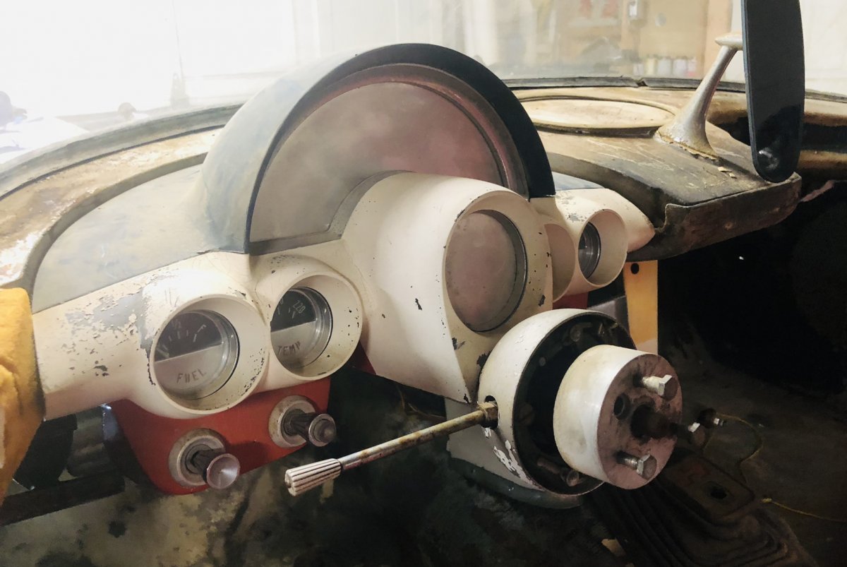

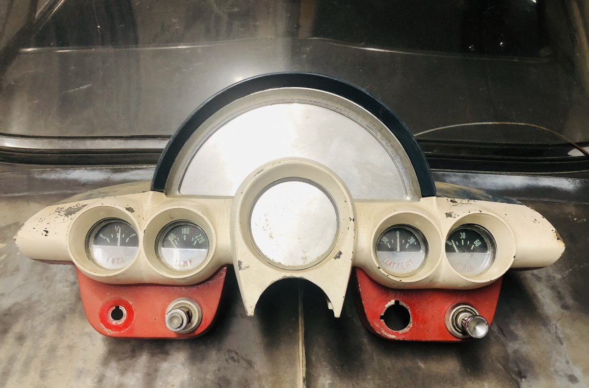

    Soon to be gone is the red, white and blue themed dash cluster!
    There Lots of goofy things going on under the dash! It will be fun trying to put it all back together without a complete picture to start with. IMG_4100.JPG IMG_4101.JPG IMG_4103.JPG
