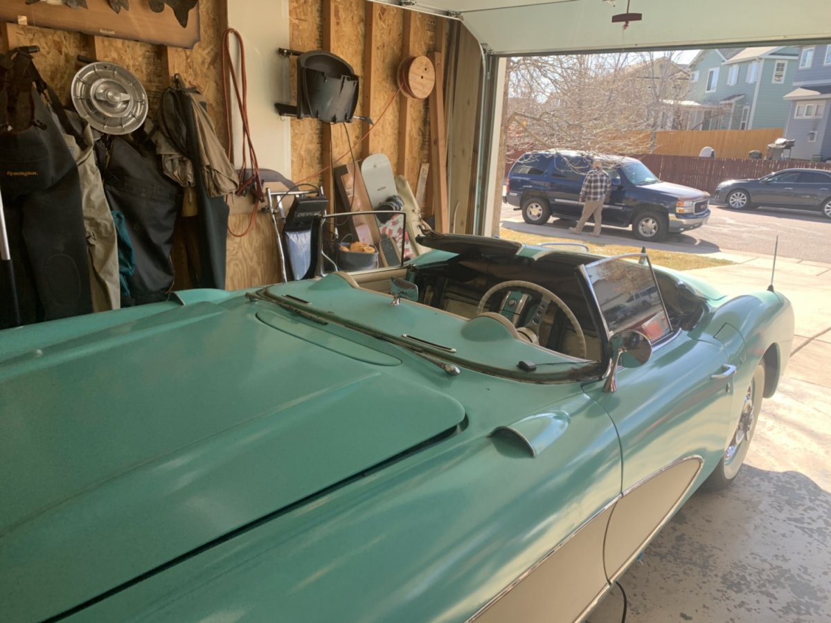

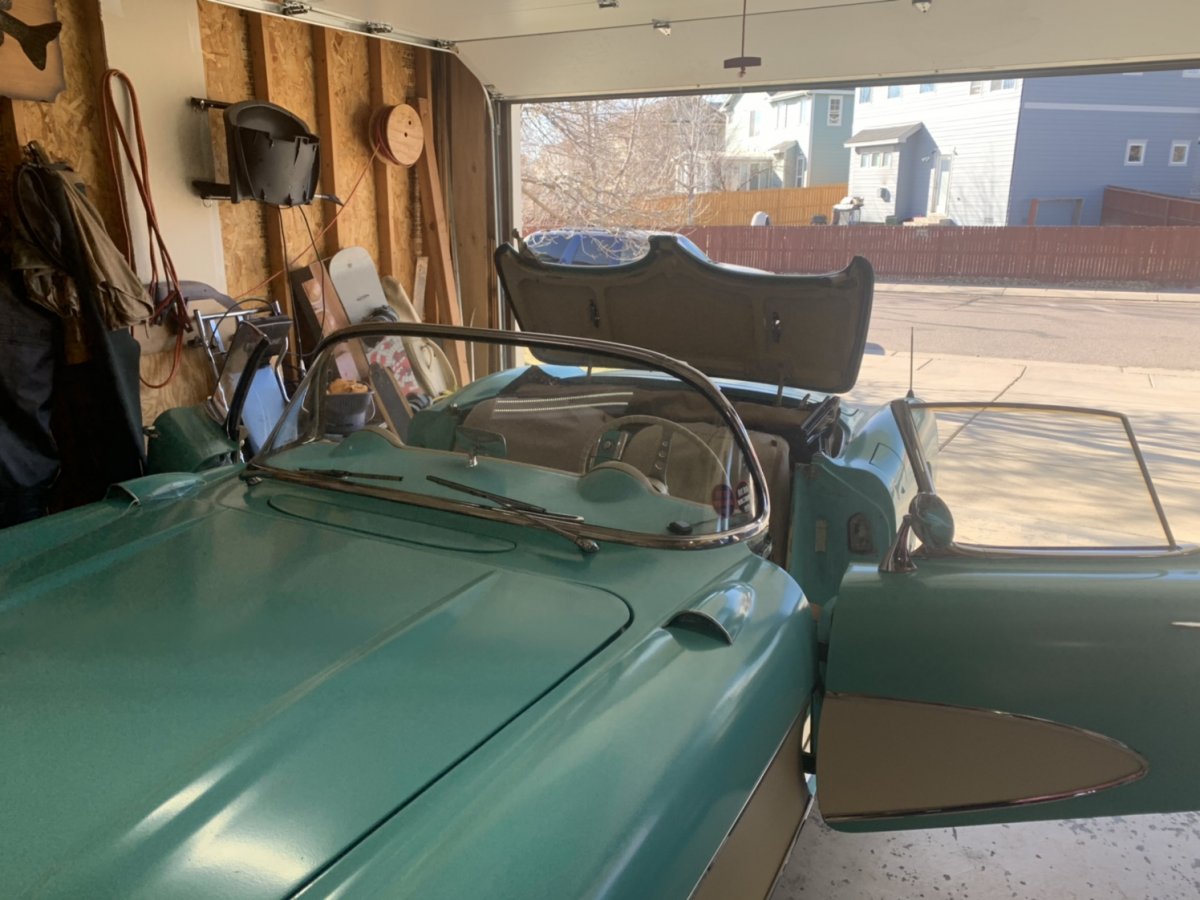

  5. e1956v
    Joined: Sep 29, 2009
    Posts: 2,582
    e1956v
    Alliance Vendor
    62767060124__60C8AF49-9F6D-4A76-AA9C-FB8EAC953C93.JPG 62767989601__213A4783-2B82-4467-AD90-078369E6C05D.JPG 62767957471__8AC81069-76D3-45C6-B31C-A8A018923A77.JPG
    Scott right there with you on pulling the windshield frame, the nuts on the far ends by the doors we’re a bear. I’m also replacing the windshield gl*** gasket as it is rock hard.

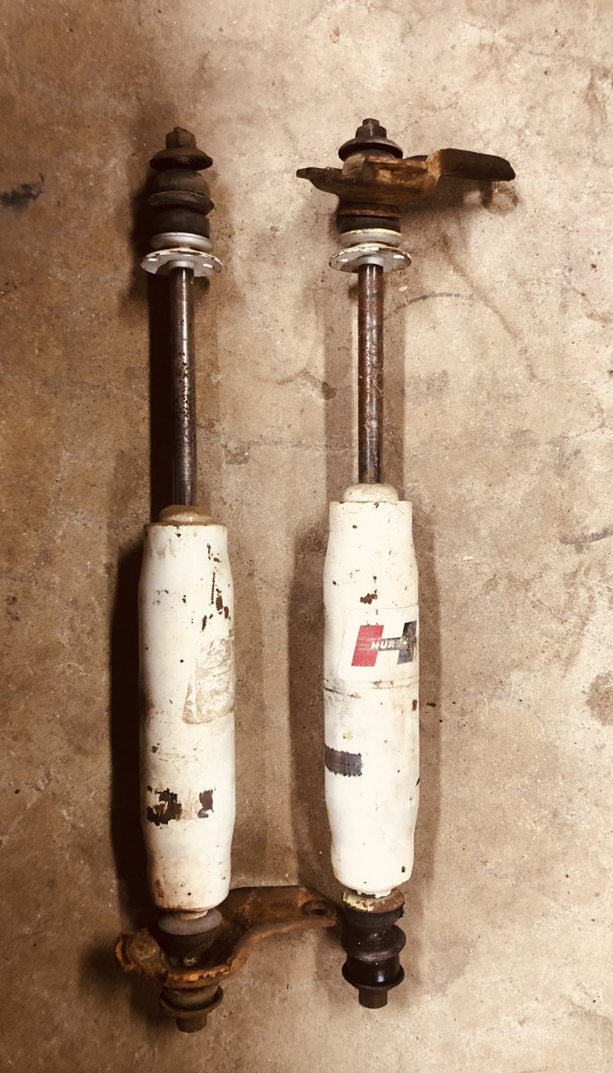

  9. loudbang
    Posts: 40,346
    If I remember correctly they were one of the first to offer the 90/10 front shocks.
  10. loudbang
    Posts: 40,346
    They may not be worn out it they are 90/10 there is almost no resistance to going up pulling the rod outward but a lot collapsing them so the nose would come up faster and stay up longer than ordinary shocks.
    They are still in use I had a set on my 1989 OT 5.0 Mustang but struts not separate shocks. :rolleyes:

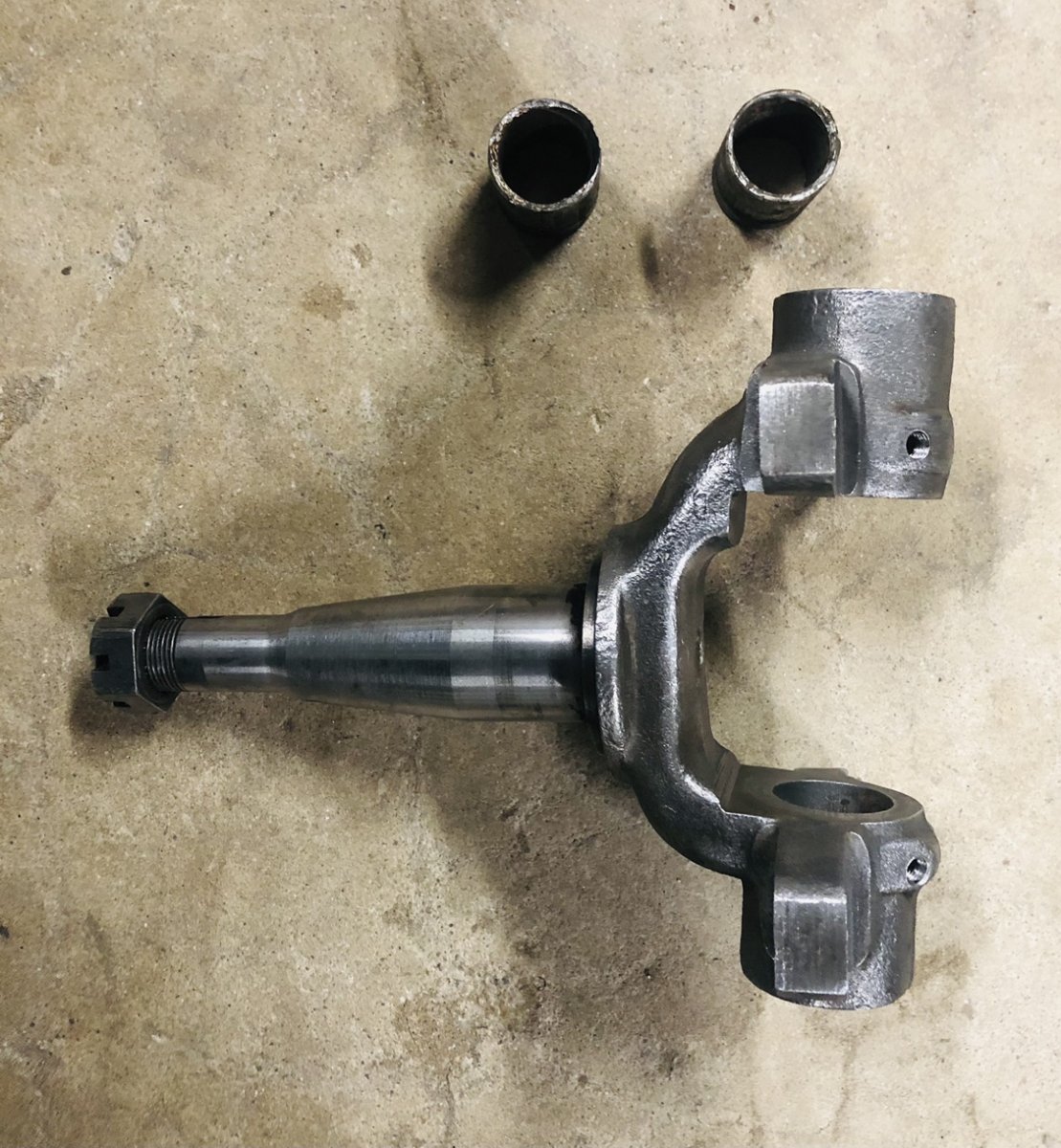

  21. bchctybob
    Joined: Sep 18, 2011
    Posts: 6,030
    bchctybob
    Getting the bushings out and back in is one thing, but finding someone to properly ream them to fit the pins correctly is usually harder.
    P.S. that is one ugly crossmember ain’t it? I like your idea of lowering the front, that way it won’t show......

  23. 31hotrodguy
    Joined: Oct 29, 2013
    Posts: 2,699
    31hotrodguy
    Hey Bob, yeah I was going to hit up the Ford guys for help reaming the spindles. Years ago I did the spindles on my AV8 ch***is at my buddy’s place.
    It is definitely ugly! My son was helping me and asked why it looked so different compared to our other cars. I said
    “well son it’s because This is a corvette crossmember. The inspiration for Its design was birthed in the Devil's ****. It was created by angry GM engineers who from their graves find humor in the fact that I had to take all 16 bolts out one quarter turn at a time while under the car!”
  24. GearheadsQCE
    Joined: Mar 23, 2011
    Posts: 3,670
    GearheadsQCE
    Alliance Vendor
    I'm going to go back to my earlier recommendation. Don't ream the bushings. Have them honed on a Sunnen machine as is used for reconditioning connecting rods. Not a brake cylinder type hone run by a drill motor.
    A long mandrel is used that keeps the bores in line. The pins can be fitted to tenths of a thousandth of an inch. (That's 0.0001") They will be round and straight and have a cross hatch for grease. Most automotive machine shops have the hone. The good ones will have the long mandrels and have probably done hundreds of these.

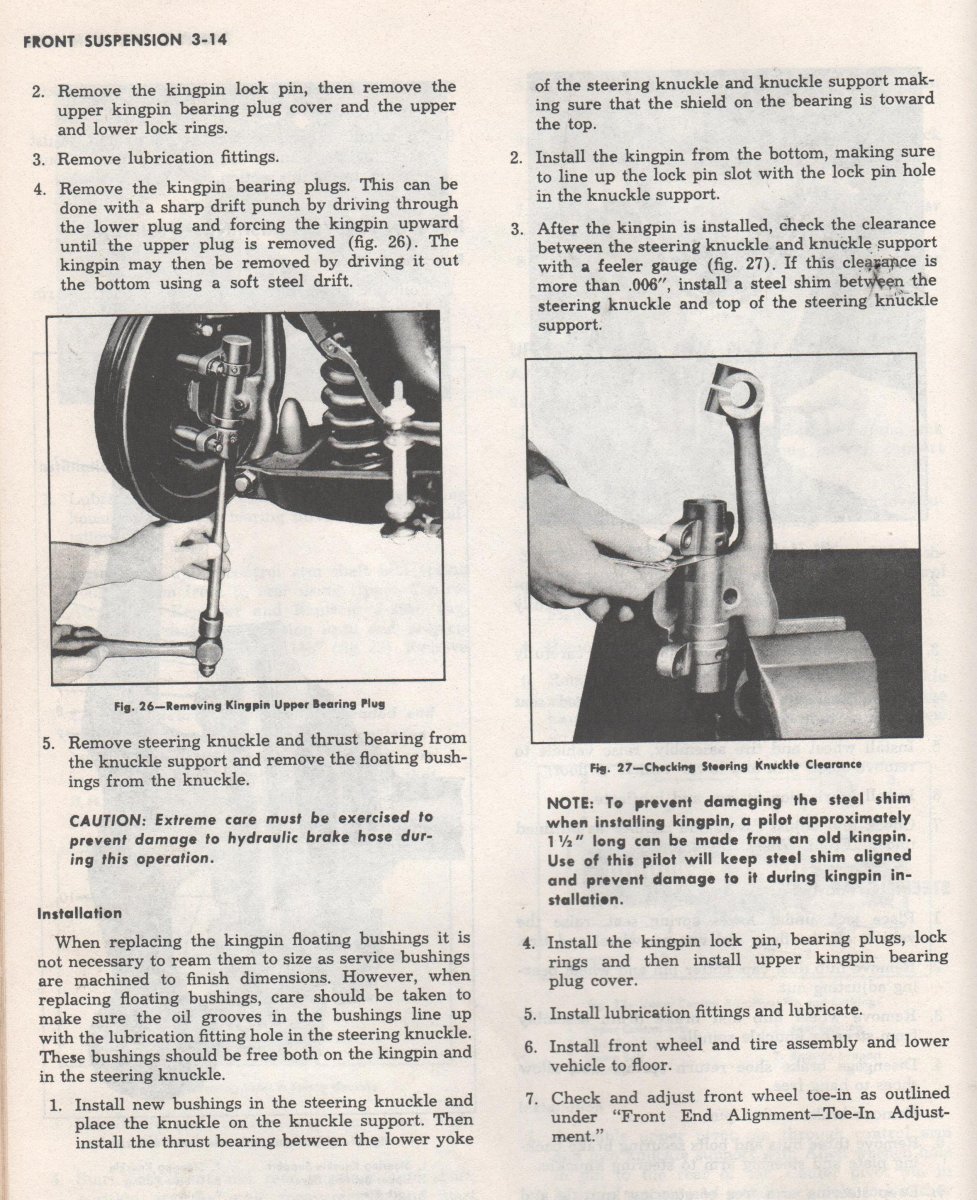

  25. jimdillon
    Joined: Dec 6, 2005
    Posts: 3,321
    jimdillon
    Scott here is a copy of the Corvette Servicing guide page 3-14 which I believe you have. If you want to talk to the Ford guys that is fine but there is absolutely no similarity between Corvette spindle bushings and Fords. The Corvette spindle bushings float in the spindle support and float on the shaft. There is no reaming or machining necessary and if your spindle support for some reason is out of round it probably should be thrown away. I only use a brake hone to remove any potential surface rust but if you feel better you can use scotch brite and little oil.
    Once the spindle support is clean, then the new shafts and bushings you can buy from Corvette Central or Paragon etc can be installed with a little grease and you are good to go. The only real critical part of this job IMO is to make sure you shim the spindle support on the spindle as they tell you in this guide. C1 s 001.jpg

  28. bchctybob
    Posts: 6,030
    bchctybob
    Well I’ll be, this time Chevy has the better idea! So Jim, how tight of a press are the new bushings in those spindles? Do they press in lightly and retain their ID?
