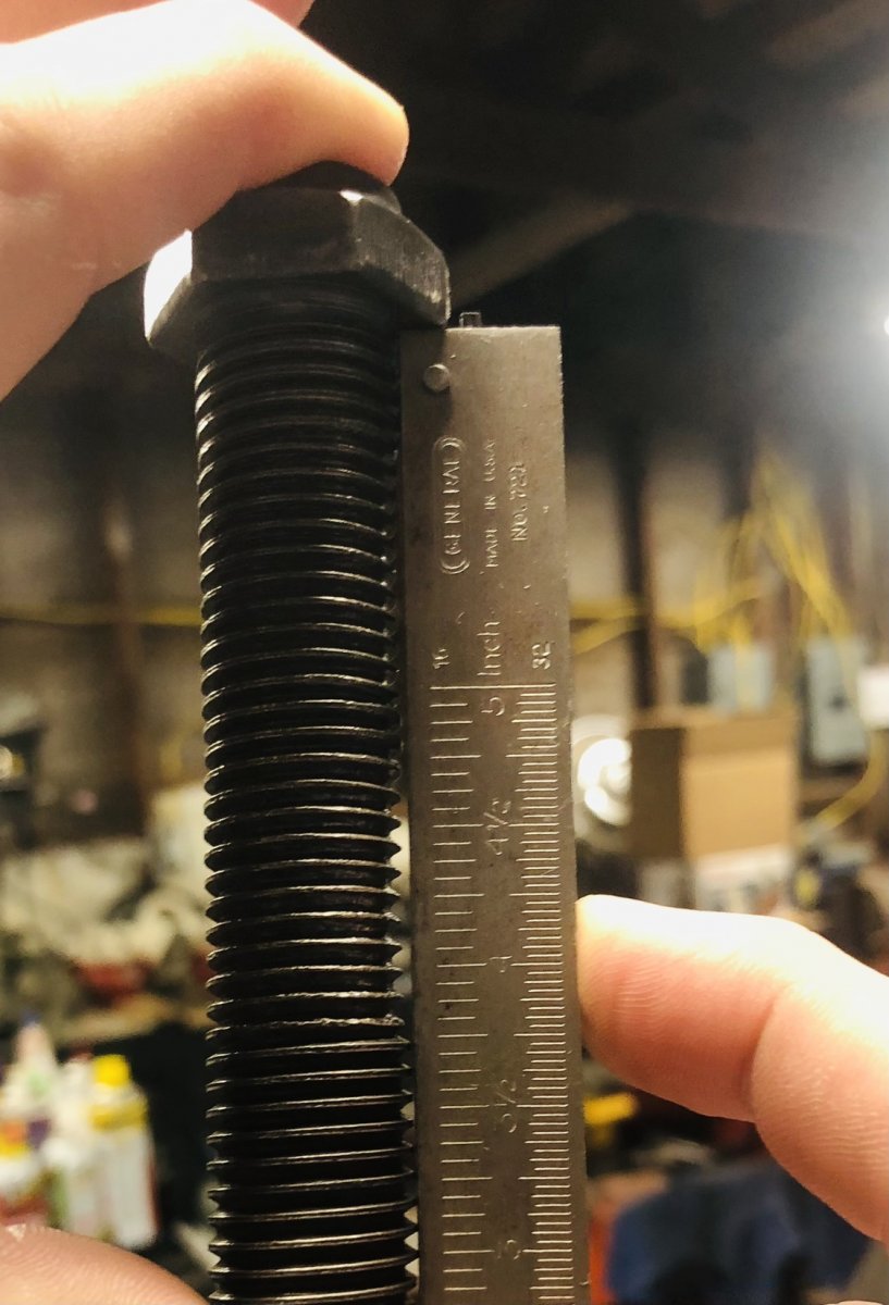

    When I hold my driver side lower shaft from the lower control arm up to a straight age the threads are worn. The shaft itself does not appear to be bent but rather the threads seem worn down. Do I need to replace it or am I just being picky. Keep in mind the replacement kit for all the shafts is $575 from corvette central. IMG_4799.JPG

    Worn or maybe stretched. Either way, probably best to replace it. Yes, the replacement kit is expensive, but in the scheme of things (ie. what the car is "worth" when finished), what's $575? Ron

    Is that a hardened all thread stud with a nut on it, or a bolt?

    Scott, I would replace them and the ones that I have purchased from Corvette Central were actually pretty nice IMO. They run $39.95 each for the threaded bolt and the sleeve. The kits get a bit pricey when you buy the whole kit with the all of the parts. As you can imagine the bolt is under a bit of torque so I would replace it. I have a couple of equally bad ones in some boxes I am sure.
    The other part that you should look at is the upper control arm shafts that go through the cradle which you have removed (the inner shaft in essence). If you can move the upper control arms with ease as it rides on the shaft then it is something to consider. You will have to remove the upper control arms anyways to install new rubber bushings anyways and when you do it will be easy to inspect the shafts. When they are worn the grooves are obvious. If you have to replace the shafts Tom Parsons has a great instructional paper on the topic with pictures. If you have to do that be prepared for a great deal of fun. It is one of the not so fun jobs. Hopefully yours are good.
    You probably will have to make a laundry list and see what you have to replace before buying the kits. I am not a fan of some of the new parts, like the upper control arms. I have purchased a couple that I did not like and sent them back and looked for extras at swap meets. Also when you replace the aluminum shims for caster (that sit on the cradle and against the lower part of the frame) the new shims are supposed to be 2* but the new ones are closer to 1*. I try and buy nice used ones at swap meets or on ebay.

    Budget 36, it has a passage way for grease from then end part to about half way where it travels through the spindle support. It is definitely not just a big bolt.

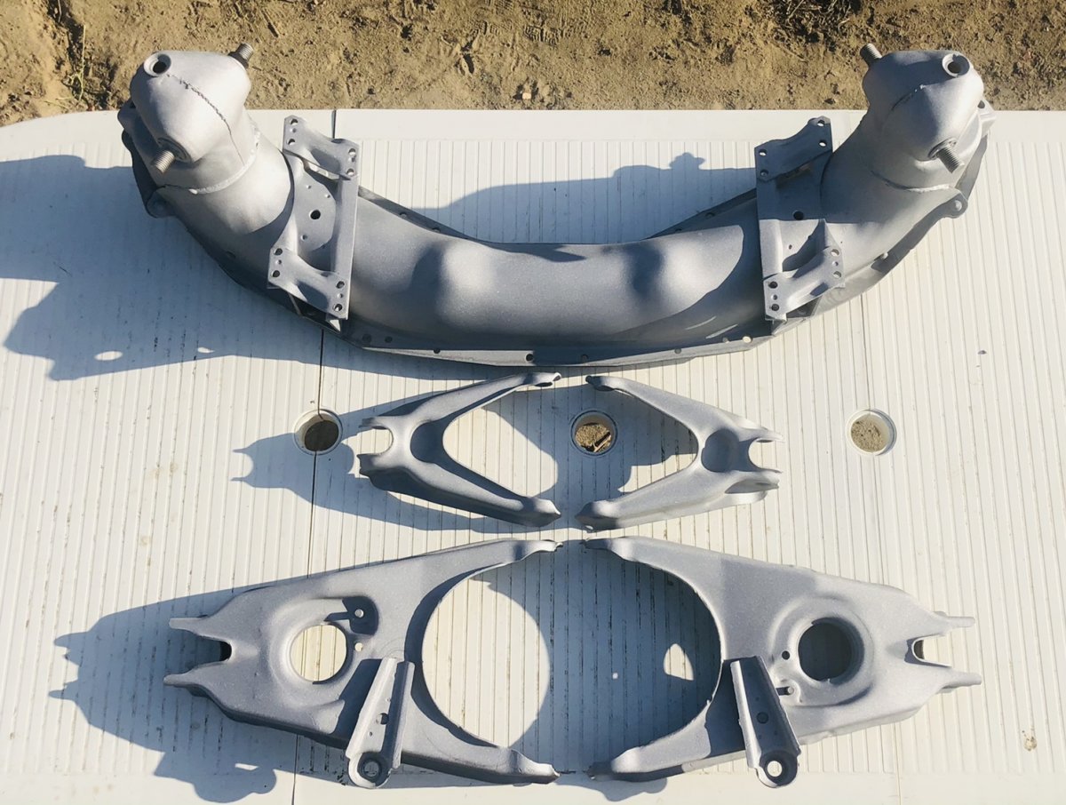

    Off to the soda blast guy! Some 60 Pontiac parts hitched a ride too. [emoji6]

    It is hard to tell from the picture but the parts actually sparkle. [emoji16]
    My first time having something blasted with water and glass. When it’s all done the treated water acts as a rust inhibitor. Or so they told me. It sounded good to me.

  21. GearheadsQCE

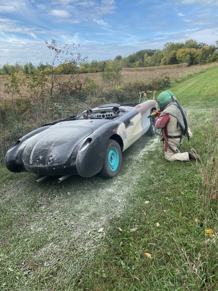

  23. 31hotrodguy
    Joined: Oct 29, 2013
    Posts: 2,699
    31hotrodguy
    Well I started sanding a fender! It was super cool for about 30 minutes and then lost its cool fun factor. A body man I am not but I am determined to learn! IMG_5530.JPG

  25. 31hotrodguy
    Posts: 2,699
    31hotrodguy
    Definitely! So far I’ve found dark grey primer, red, the factory fawn beige and some weird stuff!
    The car suffered front end damage and was pieced back together. With the help of a friend I am slowly over coming my body work fears.
