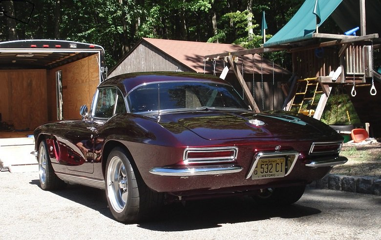

    These are wonderful cars. You are going to have a blast with yours. I know I do with mine

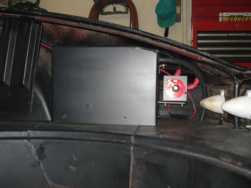

    Grounding to the frame is not good. Steel is a very poor conductor of electricity. A better way is to run both positive and negative cables from the trunk. In my red car, I used welder cables, super good, but expensive. In the black car, I went to a local NAPA store and had new battery cables made to my specifications. Double OO, If I remember correctly. Just an other way to avoid future problems, especially a the track.

    I use OO as well. You run the ground from the trunk to the engine?

    Yes. With NHRA required metal box.

    I thought the cut off switch had to be mounted outside the body for NHRA? Obviously yours is not which would solve a problem for me!

    You are correct for the cut off switch. I installed that one to protect the battery ( It is 16 years old ) from drains in these old cars. There are original factory un-fused circuits that can burn the car down.
    I have raced at many NHRA drag strips and never been busted for that. Someday I will add the "T" handle and rod.

    Got it! And thank you for the tip! I shall do the same!

    Have you made it into an impala yet??? (6 tail lights)

    Not that it matters but I am not a fan of the "six" BUT when there are other little " period mods" like Moriarity's it looks great.....................brownosing!

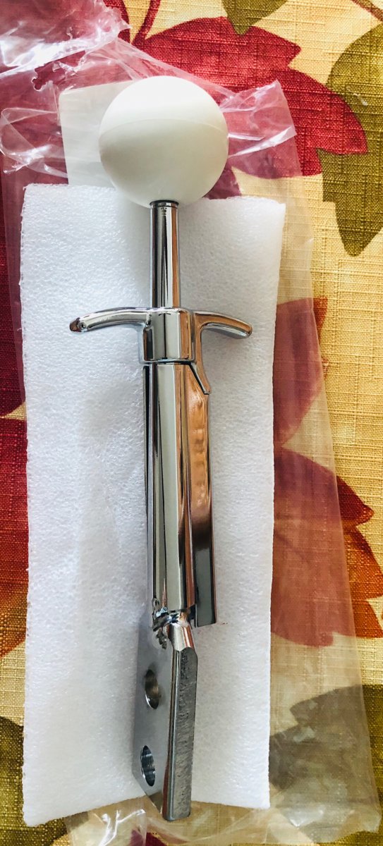

    “Honey, why are there corvette parts all over the kitchen table, couch and living room floor?”.....Me “because it’s corvette Christmas in October! And “next week when we are broke we can “lick” corvette parts” Lol Adjustments.JPG
    A hint of things to come! [emoji41]

    A stock appearing shifter stick designed to bolt to a Hurst Compe***ion Plus.

    The new looking Comp plus that came in my 59 after sitting for 40 yrs has a welded handle.

    At some point that changed from welded to bolted stick (handle).

    In regards to what Vetrod brought up with the battery in the trunk and the cutoff, you have a couple of options. Since I have fenderwell style headers on my avatar car, I mounted the battery in the trunk. I have a T-Handle next to the inner right tail light. After awhile I removed it and only reinstall it if I go to the track. For some reason, kids and people that act likes kids, like to operate the T-handle at cars shows so when I go to leave the car will not start. Happened a number of times. Easy to reinstall.
