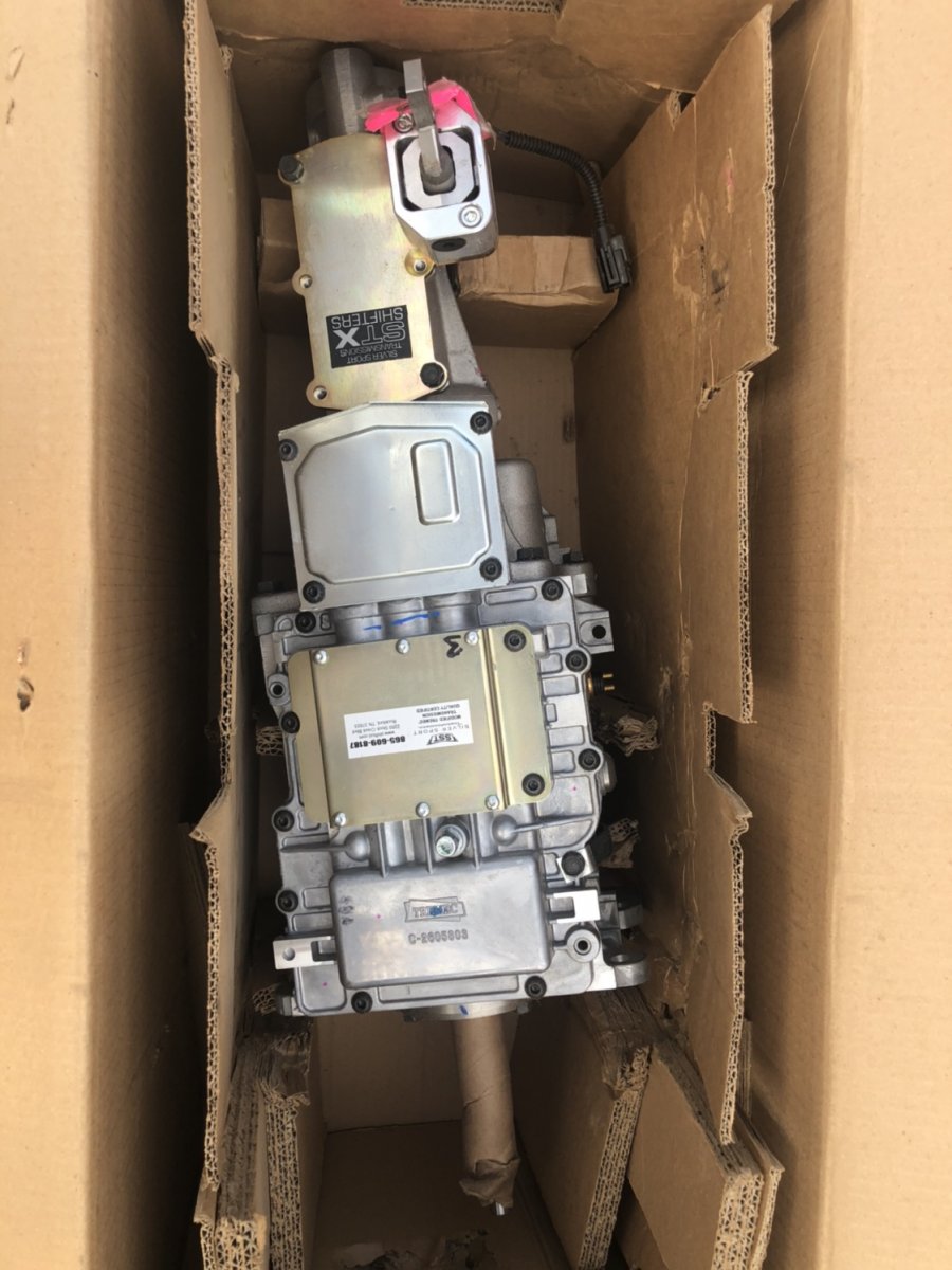

    I left a note for my family that says “if I get knocked unconscious transmission stays with me because I’ll probably never afford one again!”
    Vetterod, I read your comment about losing 3/10’s with the tremec. Is it because of the synchro’s that slows down the shifting with these?
    j-jock, -Brent-, shortypu and 4 others like this.
  2. There are ways to improve the shifting on the tremec. I’ve got something saved on my laptop. I don’t know what it says to do lol,I’ll try to post it tomorrow. I’ve got one in my 56 belair, so i’m curious about it as well.

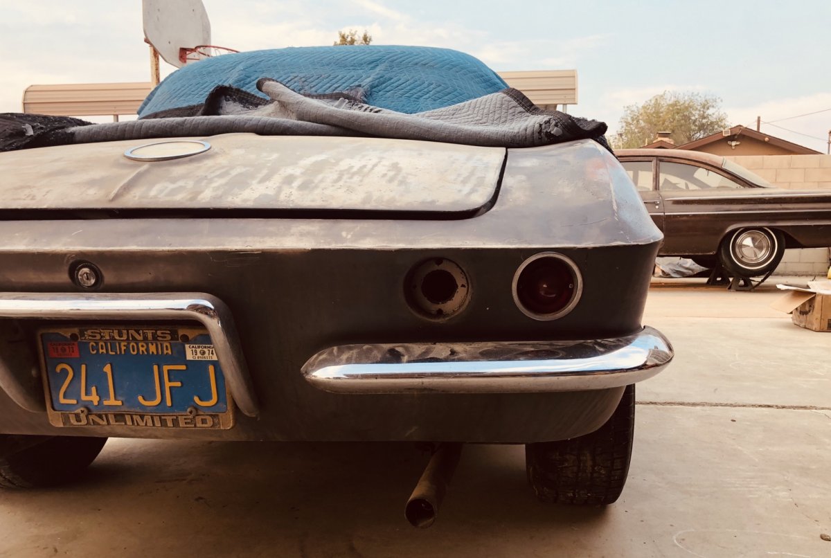

  5. 6sally6
    Joined: Feb 16, 2014
    Posts: 2,935
    6sally6
    Take it from a FoMoCo guy (who LIKES;) 61-62 and especially 63 split windows Vettes) 3rd tail lights look wacky on 61's.!:eek:
    Jus throw'in out there!:)

  6. vetrod62
    Joined: Jan 2, 2010
    Posts: 347
    vetrod62
    I think the slow shifting is that there too much rotating m*** for those synchro's to slow the gears to engage the next gear. My TKO-600 was from Keisler with the shifter off set to the to go through the stock location. maybe that modified shift was also a problem Finally, the 2-3 shift was awful. One out of 5 shifts would hang up on that 2-3 shift. I was shifting at 7200 to 7500 rpms.
    I read Scotty Ts tko article and see where those mods should help. Looks expensive. I expect shifts to very fast and sound like an automatic. Installing a TKO in one of these cars is no simple thing. I prefer unbolting the engine moving it forward 6", install the trans, slide the engine unto the trans. Jim

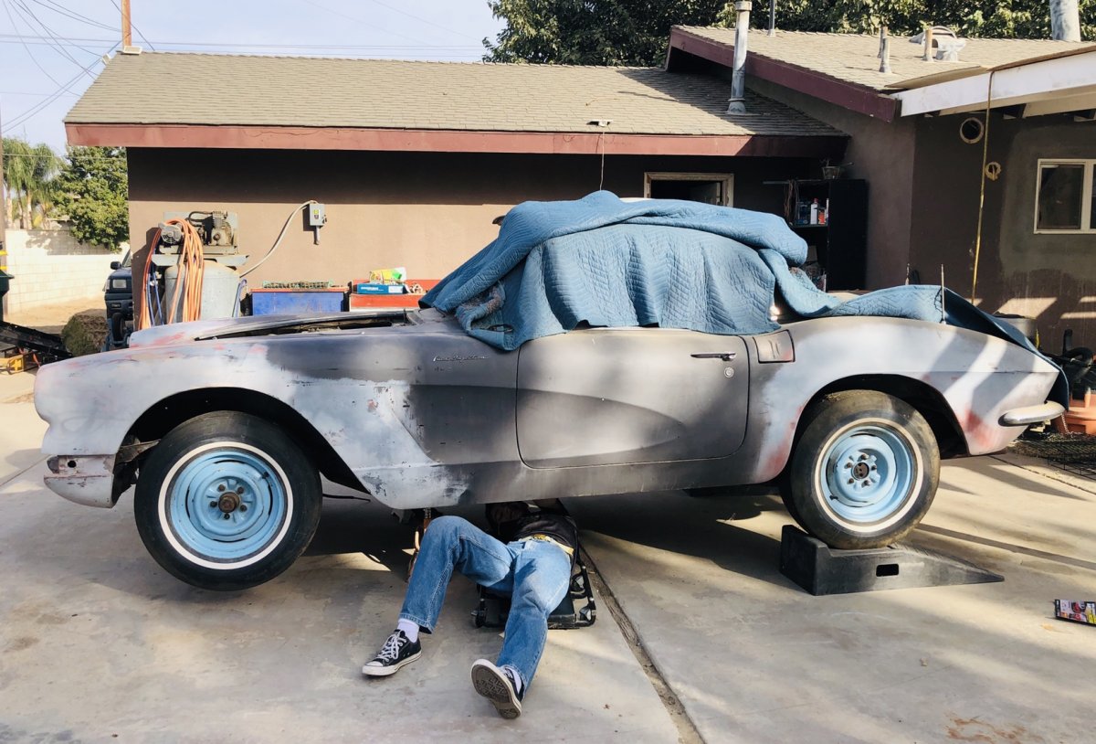

    My normal inclination is to get excited about a project, take everything apart before I get replacement parts. I think I did good this time. I actually waited until I had the parts!
    Last night we took our time removing petrified radiator hoses and everything topside to pull the engine and trans.
    I’m still waiting to clear a spot inside the garage. Fun stuff

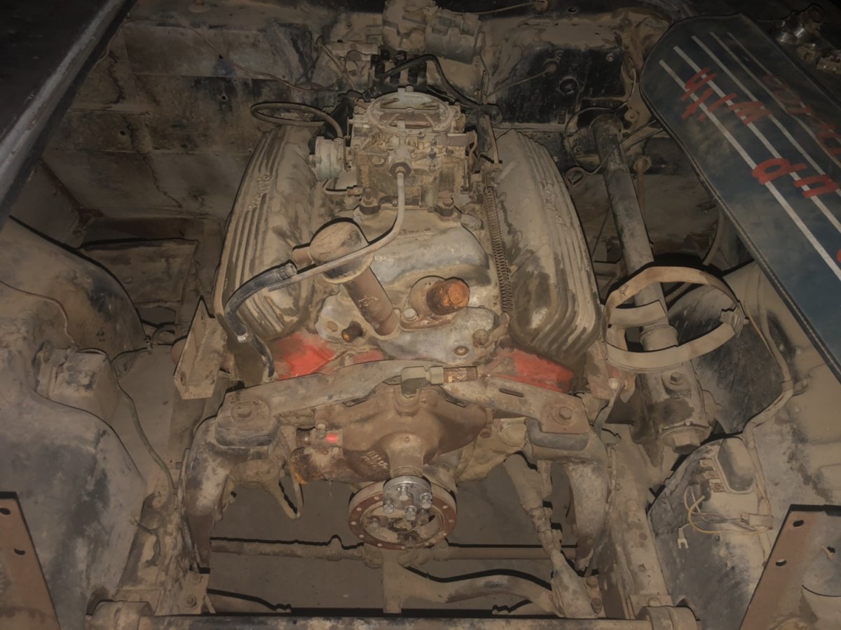

    Block is a 657, nothing exciting.
  10. I like those valve covers and is that a Say “why and” intake?
    31hotrodguy, enloe and loudbang like this.

  13. chevy57dude
    Joined: Dec 10, 2007
    Posts: 9,713
    chevy57dude
    Ir's a Corvette engine, the pic proves it!
  14. MCjim
    Joined: Jun 4, 2006
    Posts: 1,380
    MCjim
    from soCal
    Don't need to make a cup, just an "L" bracket will hold them in place,. Just make sure you get the right lights, they are all different. I'll try to get a picture and part # tomorrow if you want, let me know. And the 3 lights look fine...unless you are overly **** about symmetry.
