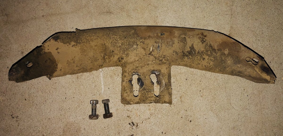

    Looking at your last 3 posts, That mount is total Bubba, never seen any thing like it. Your TKO-600 will require a different mount than stock. As I remember, when I had my TKO, I made mt own mount.
    First rule of C1 vettes: never put any weight on the front fenders, that will crack the entire length of the fender along the hood lines. Still the kids looks good in the picture.
    Never trust those carb pulling plates on aluminum manifolds.
    Those 63 muncie trans's were not the best. 1966 and up are far better.
    Jim

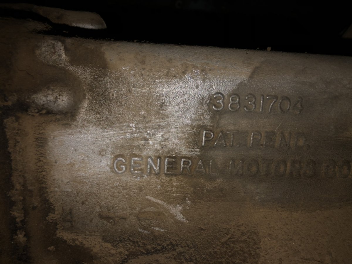

    My info on 63 Muncies is: 63 corvette is 3831704 case
    tail housing is 3831731
    side cover is 3831707
    front bearing retainer is 604932
    No Id tag.
    Suffix code is A for wide ratio and B for close ratio and C for close ratio in 1965.
    All you need to switch from wide to close ratios is to switch input and counter ( also known as the cluster gear).
    I would sell the 63 muncie to some fool restorer for big bucks. Jim

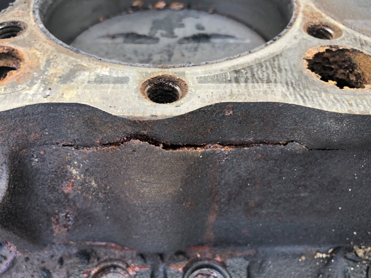

  23. 31hotrodguy
    Joined: Oct 29, 2013
    Posts: 2,699
    31hotrodguy
    Driver side. Not likely that it froze here in California. Possible but not likely. I was kinda hoping to have a std or .030 327 block in the surplus. Oh well.
    P***enger side had a lesser crack in the same location.
  24. Moriarity
    Joined: Apr 11, 2001
    Posts: 37,492
    Moriarity
    SUPER MODERATOR
    yup, that's a freeze crack.... straight water and less than 32 degrees is all it takes, too bad

  26. 31hotrodguy
    Posts: 2,699
    31hotrodguy
    Well after talking with the previous owner apparently there was a cold spell in the high California desert in 1990. He said he had a Dodge Dart that ended up with a cracked block but didn’t think the corvette was affected......apparently he was wrong.
  27. If that is the only crack, it can be welded or s***ched. If it is an original Corvette block, it is worth saving. I have stick welded cast using machinable nickel rods, but the material has to be absolutely clean. Before welding, I also always stress relieve the both ends of the crack by stop drilling, and then grinding a groove along the length of the crack.
    I always preheat the area to be welded as much as practicable, The welding has to be done by doing no more than an inch at time, and hammering to stress relieve the segment before moving on.
    There was a new thread just started on repairing a cracked block, and one of the posters provided this link regarding the s***ching process.
    Thanks to @19Fordy for this link. This is a lot easier than the way I learned how to make a repair using this technique. We just did the repair freehand, and with no special studs, but it worked.
    Bob

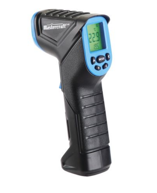

  28. digital temperature reader.png Here is a link to cast iron repair using a stick welder and Muggy Weld.
    Edit: We used to use temperature sticks to determine the temperature of the preheated cast, but what I use now, is a hand held pyrometer (Digital temperature reader), that you can buy at your favourite tool outlet.

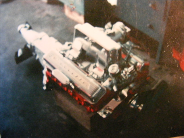

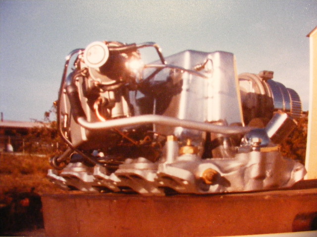

    Here's my old set up with a little back yard polishing and a few bucks in Chrome! About what you are starting with! Yes, that's a clothes dryer air intake duct, they didn't have it in black!
    catdad49, enloe, scotty t and 6 others like this.
  30. 31hotrodguy
    Posts: 2,699
    31hotrodguy
    Pretty fancy looking but with only a picture of the engine that’s more of a tease! Lol. Do you have any other pictures of the whole car? Looks good
