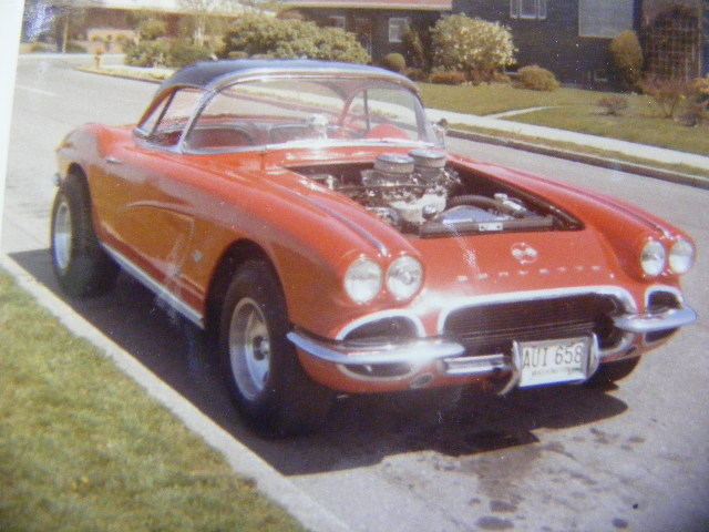

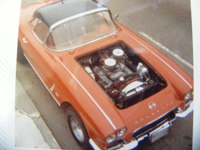

    "Pretty fancy looking but with only a picture of the engine that’s more of a tease! Lol. Do you have any other pictures of the whole car? Looks good"
    Your thread, hate to pollute it!
    DSCF1263.JPG DSCF1264.JPG DSCF1265.JPG DSCF1266.JPG DSCF1267.JPG DSCF1268.JPG DSCF1271.JPG DSCF1272.JPG DSCF1275.JPG DSCF1277.JPG DSCF1281.JPG DSCF1284.JPG
    Sick of it yet?

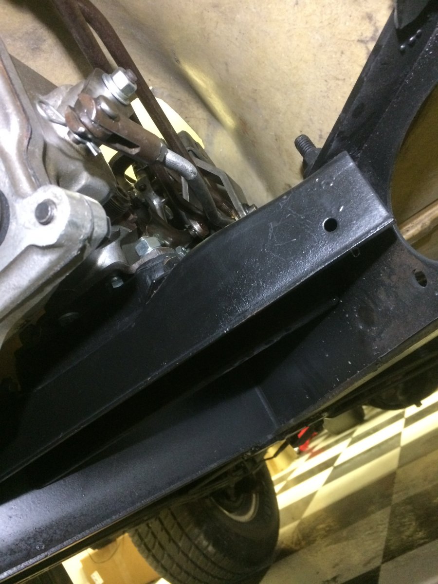

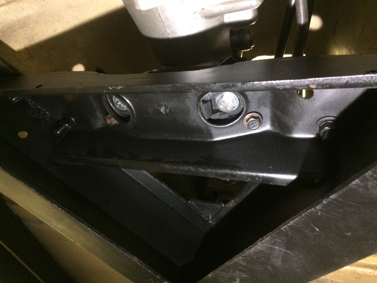

    Hey Scott, I was putting the shifter in my wife's 60 today and took a couple of pics of the trans crossmember. It is stock. Thought it might help:) IMG_3467.JPG IMG_3468.JPG

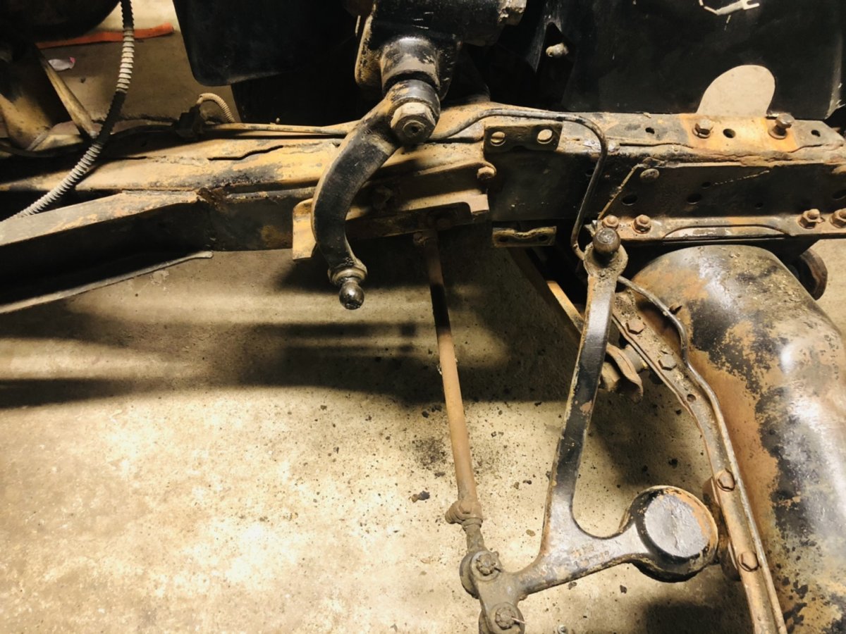

    With a little bit of heat I got the steering connecting rod off the pitman arm and third arm thingy. IMG_3370.JPG
    I remember in my younger days I just rounded **** off! The things you learn from older mentors like patience and a little heat!

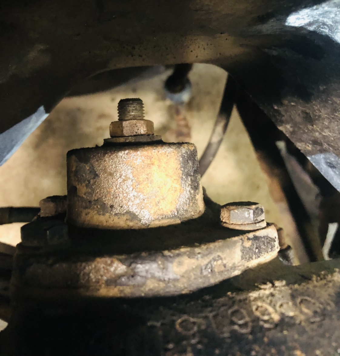

    Alright guys, help me out! What magical tool do you use to adjust the adjuster screw on the steering box? There is no room for even a short flat head screw driver?? IMG_3372.JPG
  14. Moriarity
    Joined: Apr 11, 2001
    Posts: 37,512
    Moriarity
    SUPER MODERATOR
    Offset screwdriver, don't tighten that too tight, that is how some sectors get ruined. I rebuilt mine last winter, really isn't a bad job if you end up doing it. Mine really drives a lot better after rebuilding it....

    Moriarity, I tightened it until the slack was gone on the pitman arm. Is that okay or is that too tight? I honestly don’t think it has ever been adjusted because there was plenty of thread on the set screw.

    There is a spec in inch pounds as far as how much force it takes to go past the “high spot”. It is measured at the steering wheel nut with the steering linkage disconnected. But if it doesn’t feel like it binds when you go past center maybe it is ok the way you have it

    It is binding at the “hight spot.” I’ll back off a bit.

    Much better! I definitely had it too tight! I got the “slop” out and plus now it is smooth!

    Scott, Moriarty is correct on being cautious on tightening the adjustment. As you probably know, GM sent a directive to dealers in the 60s to switch from gear lube to grease (I use ch***is grease) in the box. Mark is right that the rebuild is not too bad. Getting the box out and feeding it back in may be the worse part of the job. To grease the box, I remove one of the bottom bolts and use a heat gun with the top fill open and as it gets warm the gear lube leaks out and then I shoot in ch***is grease with little zerk fitting I made up (although you can use a grease needle) and when the grease runs out the bottom bolt hole and the top you should be good to go. You can ruin the sector if you go too tight. I would back it off a hair and drive it a bit and then inch up on the adjustment. Once they are done correctly they steer fine. I kind of wonder about the guys that insist these cars need power steering. I even use a small steering wheel and both of mine track great going down the road with very little slop in the steering.
