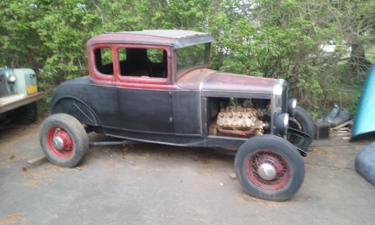

    I have been messing with it in my free time. It is now getting close to running and driving, I still gotta make headers, put on the dual carb intake, wire it and run fuel lines. 20160509_071626.jpg

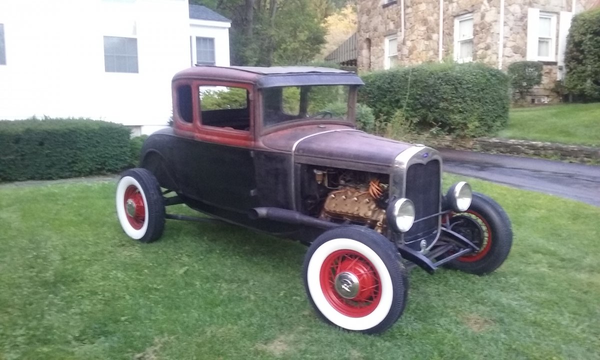

    Still got a lot to do but I drove it around the driveway today with am improvised gas tank.
    Our 7 year old daughter has been helping out a lot. And is really excited that her car runs now. 20160516_182110.jpg 20160516_200457.jpg 20160517_151043.jpg 20160516_200523.jpg

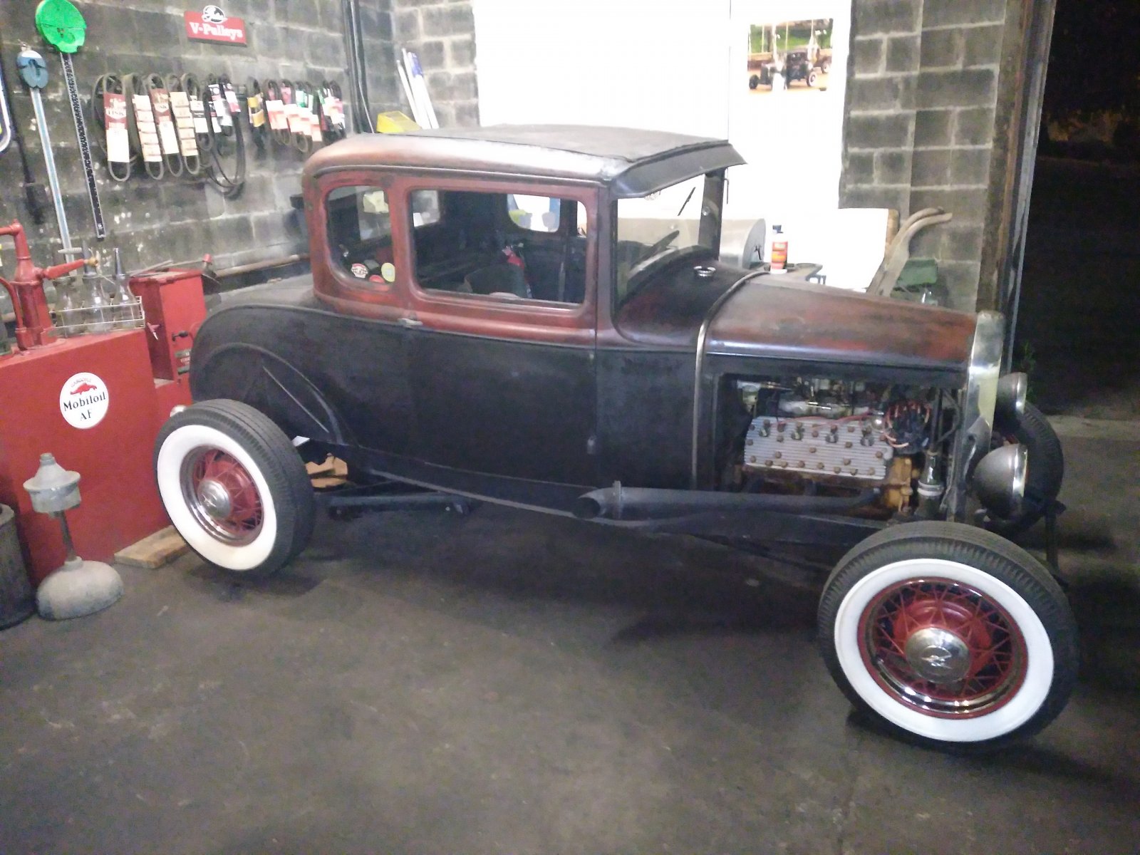

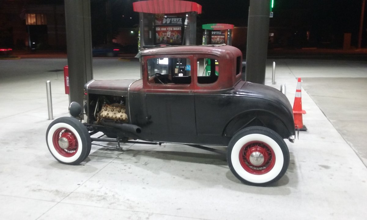

    I got a lot more done on the car and actually took it for a test drive. Still a lot to do but is is useable as a car for the first time in a long time!!

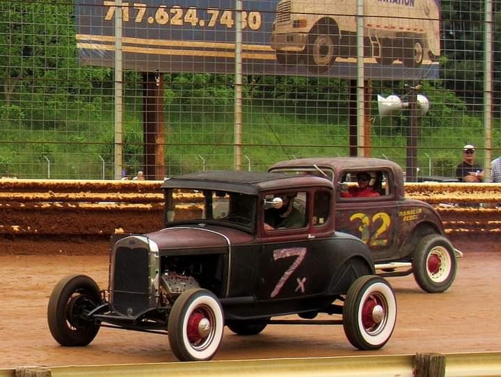

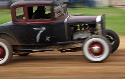

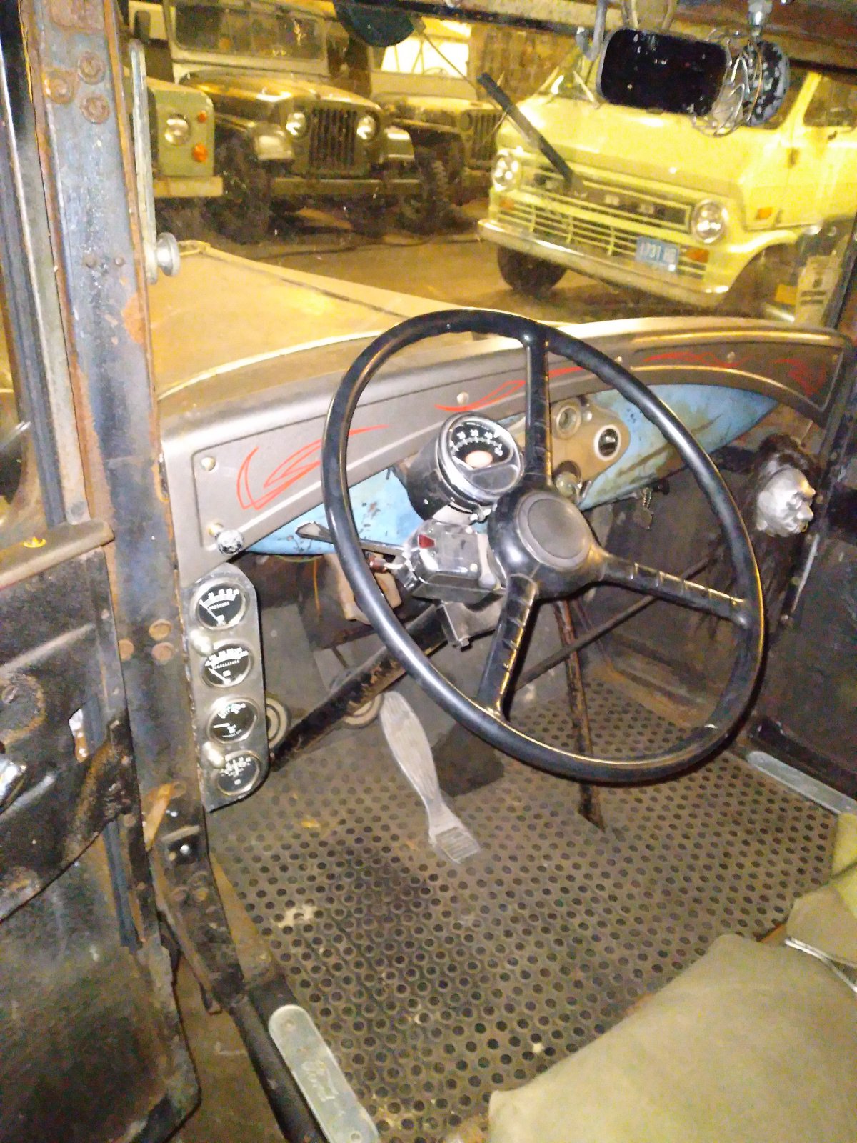

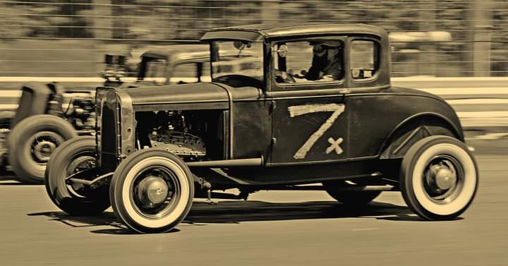

    Yup. Built a new flathead for it and have been running it ever since...

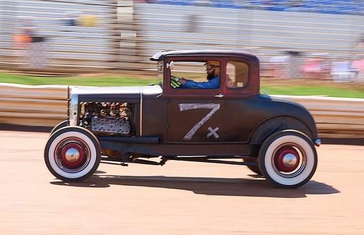

    I've busted a few things over the years but all in all has been pretty reliable for the amount of miles it sees and hard use it gets.

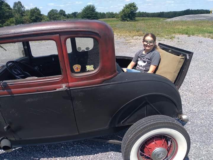

    Oh and our kiddoe that helped build it is now 12 and not so little anymore. She decided she wants to build a 48 ford truck for her first car now... so this year I will be helping her tackle it.
    Our littlest one is 8 and has been helping a lot as well and also has a lot of interest in cars as well.
