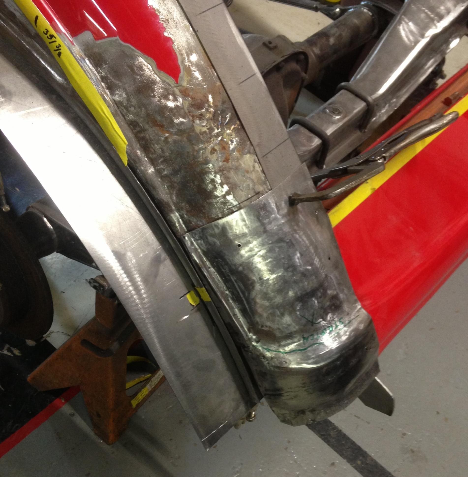

    I have only done what I have done on my car and learned by watching videos and reading forums. I have been practicing for about 6 months now and will be getting some real life training this month. I have used 18 ga. and .035 MIG and very basic tools. I will still need filler for a while.
    http://www.jalopyjournal.com/forum/showthread.php?t=667069
    Here's the latest patch I started. I did a small triangle at the bottom where the old wheel well was and started the beltline with a piece I cut from a door.

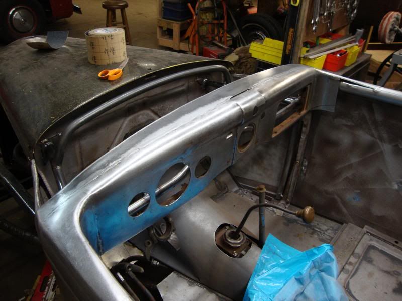

  10. Yeah !!!
    Only problem is they are 34 Chevy quarters with a 33/34ish fordish tail treatment. Way different than the 33/34 ford patches, I've already tried lol.
    This will work though, still needs some filler as opposed to buckets of it.
    Right now it fits. Some more planishing would make it nicer but I might loose the shape. I'm not sure how much better I could get it and it may still need filler.
    Guys who can make this **** perfect have some real talent, that's for sure.
