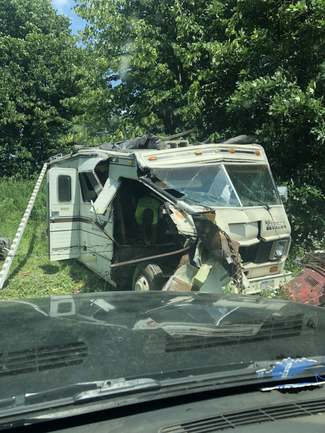

    so, i know nobody likes newer stuff here and neither do i. but a buddy of mine has this big *** camper, itasca motorhome 78' sitting at his place and told me i can have the 454 in it and trans. so i am peeling this thing apart. i have yet to get the numbers off it to really get a rundown of what kind of 454 i got, guess im just wondering if someone has any idea what i got. ill try to get some casting numbers after work today.

    obviously its a smog turd. has all that junk on it for 78, i think its a mark iv W porcupine. i been ripping **** off to try and get to it and its been a pain cutting and yanking stuff off. but i think tomorrow im gonna yank the motor out and update. i got a 37 chev frame i pay stick it on and possibly start a new project like i need one, all i need is a old 32 body to slap on it.
