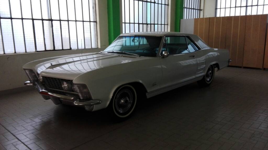

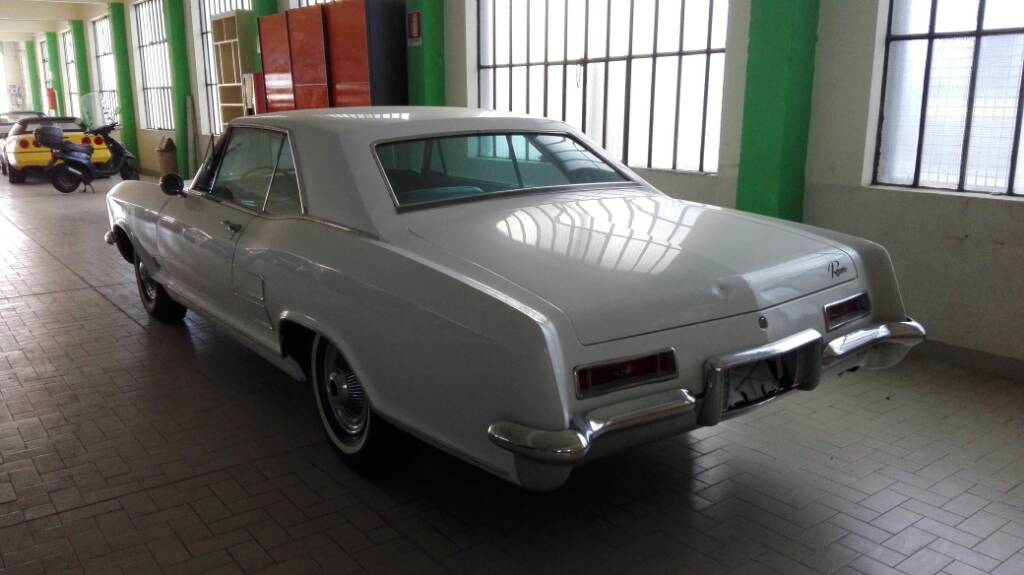

    Hi guys !!, I'm interested in 64 Riviera here in Italy, is in a good condition, some rust in the right corner under the rear window, I think is a cl***ic point of rust in the Rivieras, and another point of rust in the roof rail the interior is in good condition the problem is the engine, it is not the original 401 the car mounts to 322 Nailhead; the question is, is a small engine for the 'car, it is a reliable engine ??
    Here the pics:
    Thanks!

    Are saying that it has a 322 cu. in. engine? That's a 53 to 56 vintage engine, 160 factory hp. Are you sure it's a 322? If it's moving the car along now it should be fine. 53 to 56 Buicks were as heavy as that Riviera which by the way looks pretty nice.

    322 is a good engine, but it wont move that Rivi near as well as the 425 or 401 would. At least it has a Nailhead in it. Curious how well it all fits in there. Different motor mounts starters and such. The bell housing is the same as the 364 to 425 series I believe. I have played with a bunch of 364 to 425 motors and they are outstanding motors. The car looks great. Make sure all the electrics are good in it as well. Most of those that I have seen have power windows and such and get very expensive to repair and sometimes tough to track down parts for.
