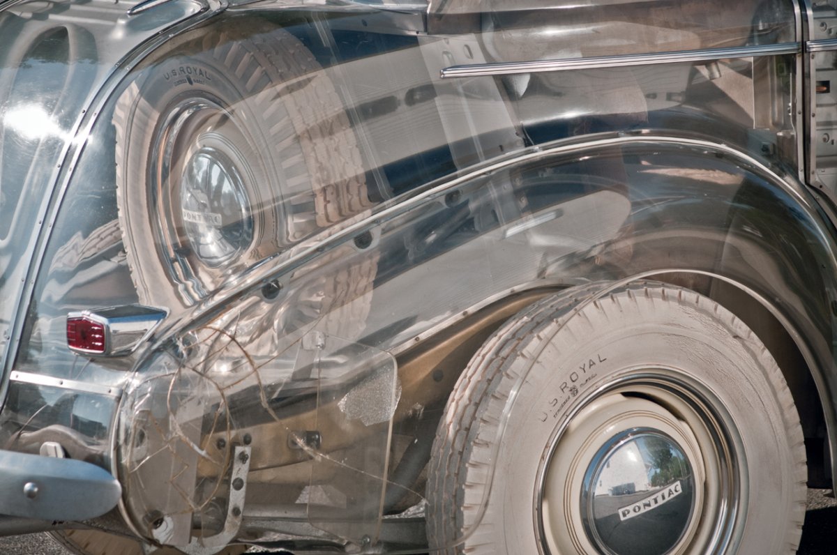

  1. Maybe the idea was that as the suspension goes up the rear spring hanger goes back and up so if you push the spring hanger up it may lift the wheel faster that the rate of lifting the body??
    Or the bumper bracket is just too weak to lift the car with and Pontiac owners don't want to get under the car to place the jack. The funny thing is, my '37 Cadillac does not have them so the Cadillac owner has to get under the car. Or the Cadillac owner's driver has to get under the car. I think Cadillac just did not want to have these funny looking brackets hanging under the rear of the car.

  5. On really long springs,
    Without them unless you jack under the axle, can you imagine how high you would need to go to get the wheel off the ground if you jacked off the body?

    Interesting concept, when you put the jack under the bracket, it would lift the car faster, and it would also lower the wheel from the body work to make it easier to get the tire out of the wheel opening.
    I've had a few cars through the years where adding extra clearance between the tire and the fender would have been helpful. Gene

    Also picking up some leverage helping the jack out and not nearly as dangerous as the bumper jacks to come.

    I don't know if it actually lowers the axle or wheel. To me it looks as though the spring is made flatter, when the rear shackle pivots up, and that keeps the wheel and axle from dropping. That helps to lift the rear axle more and not so much the whole car?

    I agree that the shackle being pulled rearward when the jack raises would seem to flatten/tension the rear spring. This would emulate placing a jack under the axle U bolts. It would raise the tire in the wheelwell allowing you to clear the tire free from the ground faster than a frame jack position where you have to wait for the leaf spring sag to clear the tire from the ground.
    I love ingenious stuff like this!
    • I'd guess it may be patented or we'd have seen the aftermarket offer it for other cars? Anyone good at patent searches?
    • I'd love to see the O/P jack up the car via two methods; a traditional frame mount jack and then the Pontiac shackle mount jack and show us two side pics and the difference (measured from bottom of frame to ground) to clear the tire tread from the ground on each method.

    I admit I havent read the entire post BUT the extensions on the rear shackle are to prevent the shackle from rolling over . Meaning it could under some conditions, have the spring above the shackle mount ( its not on the frame ,its outside of it and could flip or rollover and make it lean . At least thats what I was told .

    The mystery was solved a long time ago.
    And the springs are directly under the frame rails, with one shackle on each side. Look at the "clear car" in post #74.
