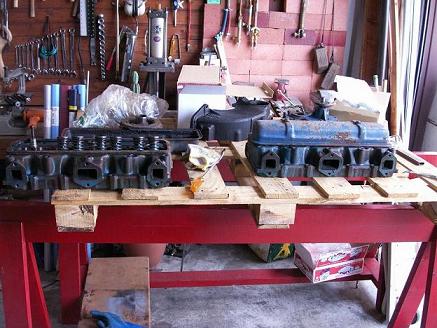

    Yes I continue, my motor is progress a little.
    inside condition was no good. chamber has many traces by broken valve .
    got some..harst front mount, lower flywheel housing, small parts..
    I have to look for some parts yet. Distributer , Starter,tranny parts.
    Rocketing is so long. I think.

    I am building a '56 Olds 324 engine also. It is for my '40 Ford coupe.
    I think I saw a piston marked ".060" in the pictures.That means that
    they are .060 inch oversized of course.
    My engine is bored to 4".That is no problem for a 324.
    Post a parts wanted for the Olds pan on HAMB.I got a '56 oilpan from
    a guy on the HAMB.I don't know how much shipping is,but it's a source.
    The new Speedway catalogs have new pistons,rings,bearings,gaskets
    and even oil pump rebuild kits for the 324.
    Look on the center exhaust ports of your for a large #10.
    That is the 9.25:1 compression ratio heads.Many people say these are
    the best '56 heads.
