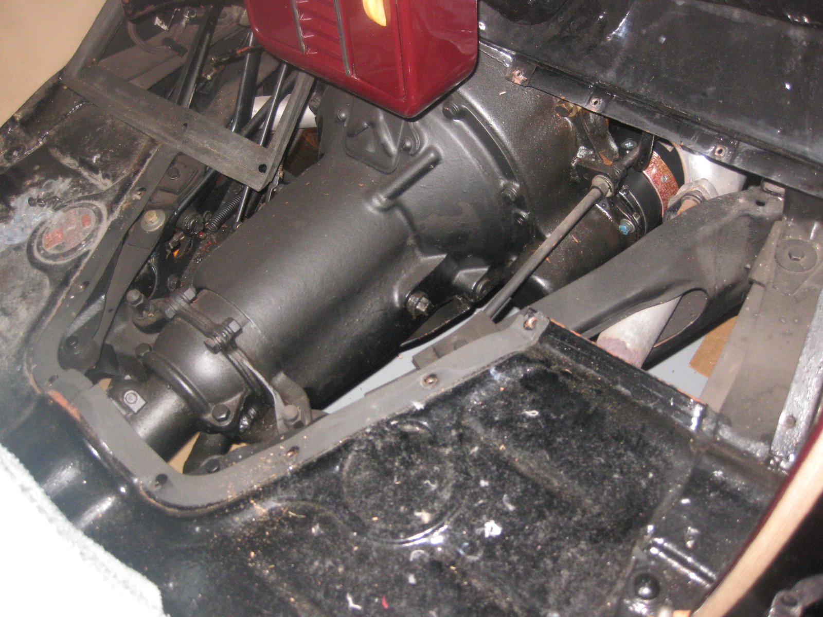

    Does your car have a set of the anti-chatter rods between the frame and bellhousing area? The 8BA doesn't have them cast into the block, so depending on what type of engine/trans mounting you have going on, you may have to fabricate some bracketry and add them back in.

    I modified my OEM 1940 anti-chatter rods to fit the 8BA in my 40 Ford. Had to weld on
    little ears to the Merc bellhousing. Also, modified the antichatter rod frame bolt. Make sure your clutch and brake pedals clear the rods when depressed. Headers are FENTON. Exhaust flange nuts are br*** with anti-seize.
    Last years, I saw on Fordbarn where there was a fellow making special brackets to easily fit anti-chatter rods on an 8BA. Do a Fordbarn search.
