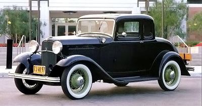

    Gas tank location, sun visor or not, windshield angle(if any), grill shell, B pillar door overlap or not, there are tons of small details the seperate the two. images.jpg 1932-ford-models-b-and-18-8.jpg

    Model A:1928-1931 four cylinder only, 103 1/2 wheelbase, frame is flat on top front to rear, fuel tank is in the cowl.
    '32 whether model B or V-8: 106 wheelbase, frame is swaybacked from cowl to just in front of the rear kickup which is radiused above the rear axle, fuel tank is between rear of body and in front of rear bumper. This is a very rudimentary description of the differences. There are many others.
