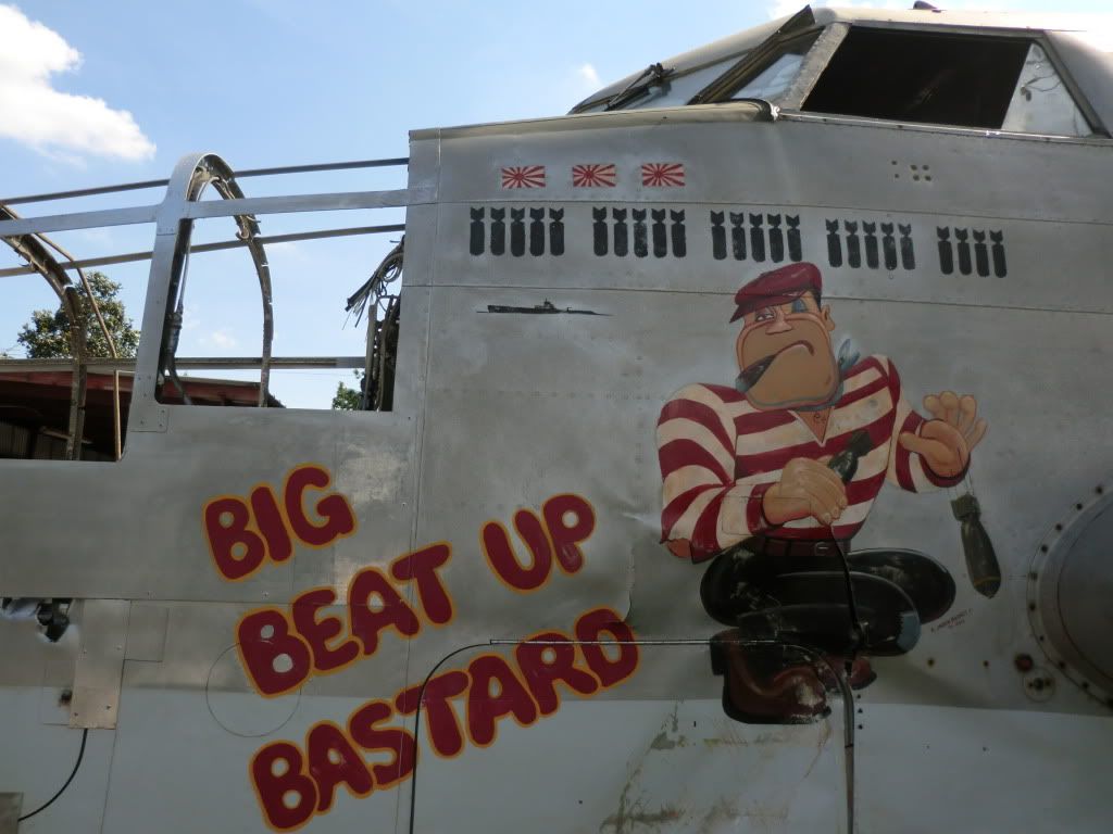

    Here is the work that I got done today. I made the nose look more like a B25 yesterday and I painted the simple nose art today.[​IMG][​IMG][​IMG]
    kidcampbell71 likes this.

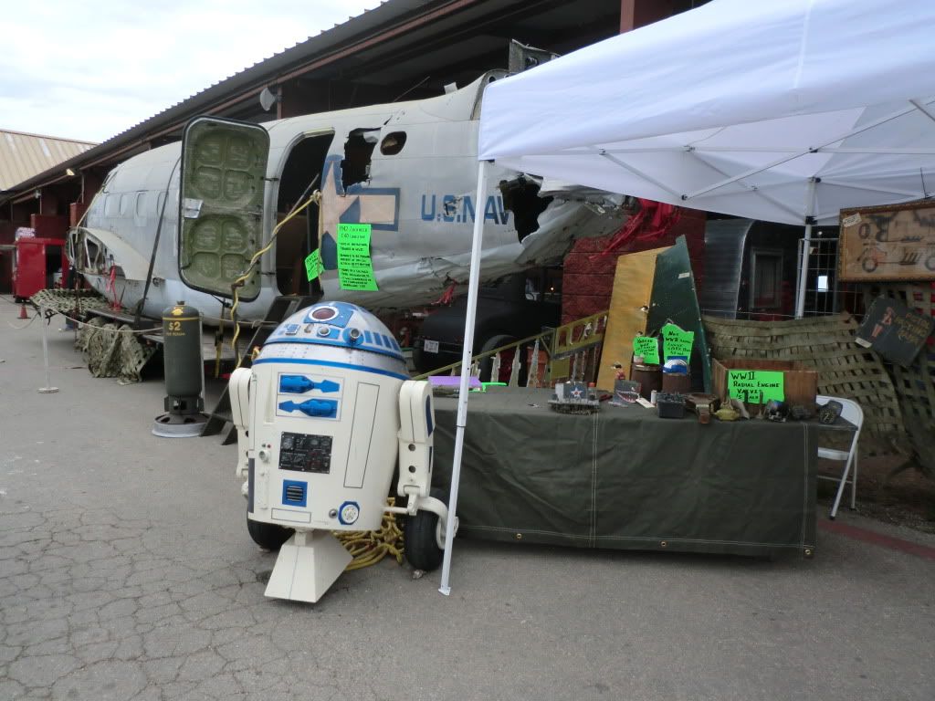

    Here are some pictures from out at the Lone Star Round Up of the plane. People were having a blast sitting in the cockpit. I posted in a new thread how much I appreciate all of you coming out and climbing aboard the plane, but I'm going to say it here too. I was pretty down about getting those three tickets on the way out, but those little $2 entry fees really helped me out. It was awesome to see the look on everyone's faces when they rounded the corner and saw the plane. There was nothing like seeing the kids sit up there in the cockpit having a good time. So many veterans came up and told me how much they liked seeing the beat up old plane.
    I have to make this giant motor home/ panel truck thing happen now somehow. I've located several other Lodestar junkers that would be a lot more rational to convert. Now all I need is funding and a pile of time.
    Jason Barnett[​IMG]
