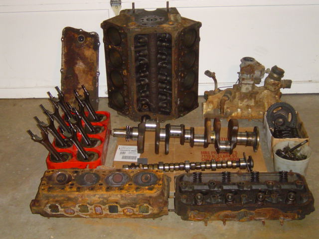

  16. 1) Like most things automotive, buy the most complete assembly you can (including oil pan, valve covers, H20 crossover, etc.). You'll spend less in the long run.
    2) I love my 354 :D
