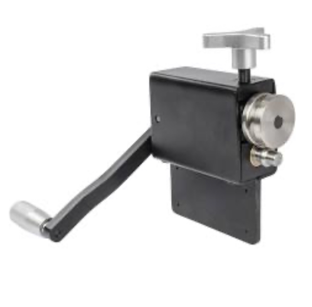

  27. Plumed an engine that was behind the cab and the radiator was behind the grill.
    Used aluminum tubing the same diameter as the hose fittings on the stock water pump.
    No issues.
    Porsche has done this for a long time.
    We used a bead roller to add a bead to hold and seal the hoses.
    Used an electric pump on another car that had the radiator behind the engine.
    Used this for the bead
