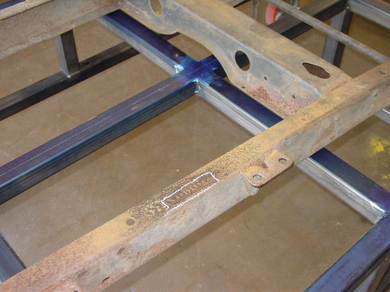

    I have done all the research that I can. I have a 1932 Ford 5 window. It was registered and the VIN on the frame matches the California title. I even have the 32 CA plates. Seems good so far right....
    Here is the issue.... there are no stars and no A's and no 18's.... it starts with a G352#####. It doesn't have any other numbers on the frame. This is the number on the driver side right behind the front tire.
    Do you think this is just a number from a different state? Do you think that there is no connection to a Ford frame? Did some state bust out the number stamps and do this?
    The frame is in OK condition but if is just an aftermarket frame... I would prefer to buy a used original.
    I have attached a picture of the stamped numbers....
    Thanks for even reading this.... I really do appreciate it!!

    It looks to me to be a home made number. Its hard to tell where the number is on the frame, but by your description it seems that it is not in a location Ford used. I am not familiar with flathead numbers, but maybe if the engine is the one that was in the car when you bought the car, it may be worth checking for that same # somewhere on the engine. Could have been a way a previous owner "linked" the two.
    If you have a registered car with matching plates what will you gain by changing to an original ford # (and doing a ton of work to swap frames)?

    I think Id be happy that you have it registered and be cool with your number. It appears to be an assigned number so dont pull the sleeping bulls tail. Your original frame number should be located to the inside edge of the frame rail in the approximate area of the firewall mounting leg and the large hole for the cowl mount bolt on the driver side.

    The font is incorrect for it to be a factory stamping. It's registered, be thankful.

    i agree with dick. the number is along the inside edge of the frame from the factory. if it is legal already, i would leave it alone. tampering with a vin number can be a sticky thing.

    Definitely an assigned title, and I do agree don't fight a good title.
    There have been some good pics posted on here of '32 serial location for original # so you would know where to explore...the ONLY reason I would even CONSIDER stirring the pot would be to ask CA to change title to a rediscovered original #, but that would be scary...look at the way people have been getting away with titling hotrods! You might excavate the number and discover that someone in Petaluma with an all-repro plastic deuce is using that number from some 50 year old registration he bought on Ebay...
    The good thing about assigned# and title is that it is 100% legit because a government put the number there. MANY of the original '32 numbers floating out there are in illegitimate use hand-stamped by an owner or attached to a repro frame, and if the gov tries to tighten rules as it has done in NJ on driver licenses and in California on titles a lot of people will be in trouble.

    There IS some value and status attached to 100% real 1932ness, but probably not enough to compensate for getting CA to look into the original stamping if it is recoverable and finding out that sloppy hotrod titling games have turned that number into a snake pit of issues.

    I transferred a title for a Model A here in Iowa and it had a weird number. Seems the previous state it was registered in gave it a new number (Wisconsin IIRC) and they used a W and a weird string of numbers. None of which matched a stock Model A series of VIN numbers. The lady at the DMV looked at it and said "oh well", and then gave me my new title. The next owner couldn't care less about the weird numbers.

    95% of the world's '32's had USA Rouge plant engines and hence serials even if assembled in Argentina as RHD or in Turkey or wherever. Canada also made engines and so had its own serials, which also populated Austaralia/NZ, South Africa. India...
    USA ones and British ones are all B-xxx (AB-xxx for early B's) or 18-xxx, with an F to denote RHD chassis or certain GB engines. No marks for the 30 assembly plants or anything like that. Pure serial numbers, from 1 to somewhere in the 200,000 range for 8s, 5,000,000 and up numbers for 4's.

    The 32 Ford numbers begin with a 5-pointed star, then B-(4cyl), or 18-(V8), then a sequence number of 1-6 digits, then another 5-pointed star. I've not seen any where another digit could be punched in between and other 2 digits but the stars are often faint and crooked and only showing 2 or 3 points.
