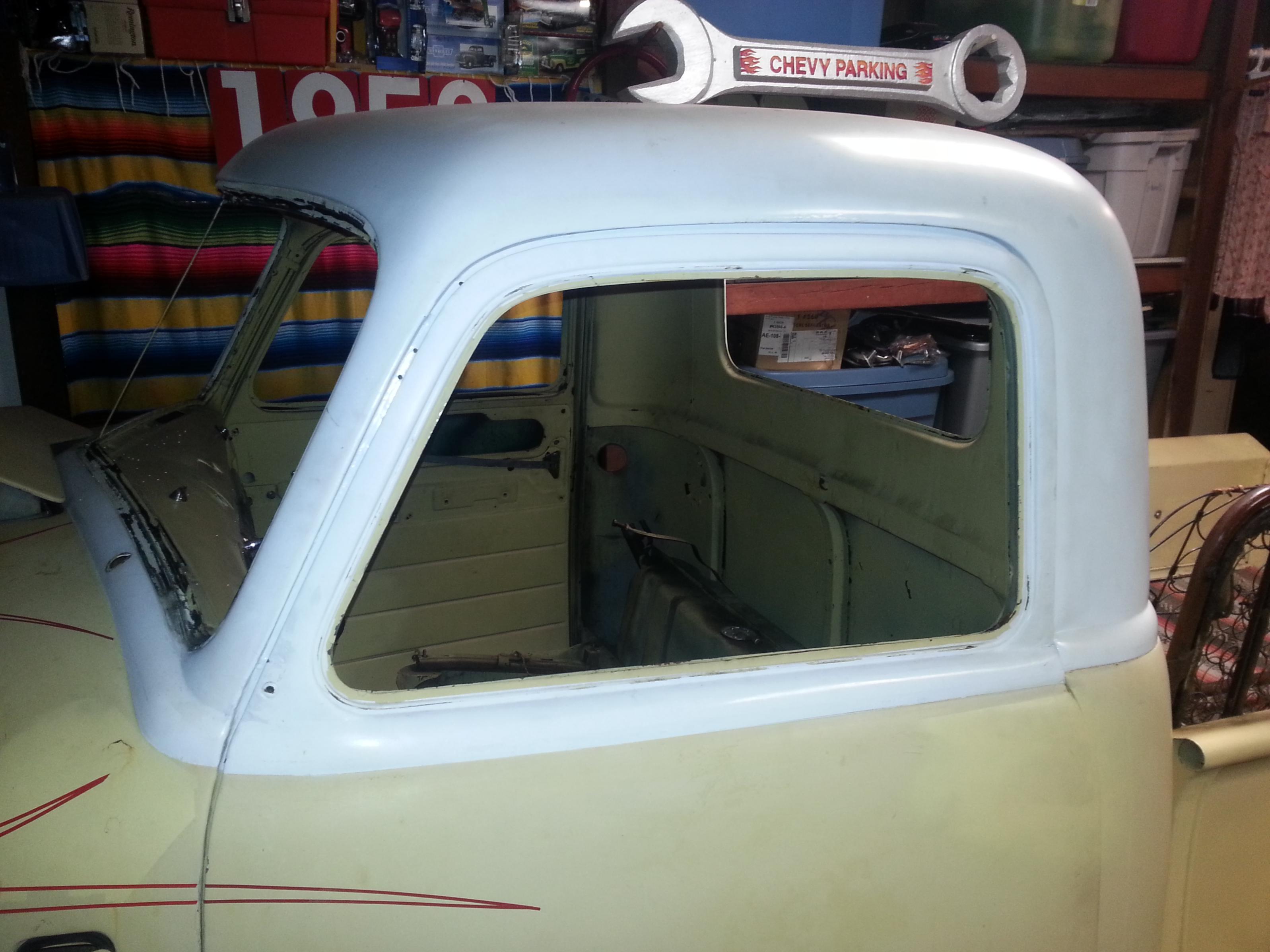

    Starting the road to a smaller roofline. 2 inches to be exact! First time for something like this for me, so I hope it goes smoooth. Done a lot of research, seems easy enough.

    So far the cab is completely gutted. Still need to line up the door gaps prior to cutting and then install some cross bracing.

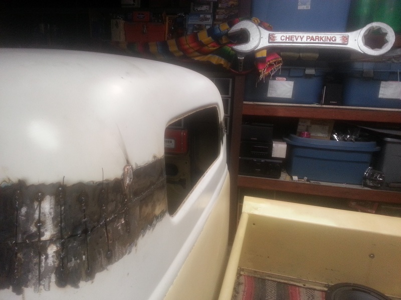

    More updates. Cut the roof today. 2 inch chop and leaned back the pillars.

    Yeah. The whole top got the two inch treatment.

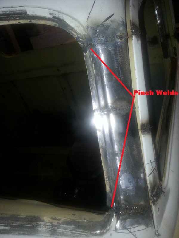

    How will the windshield align with the lower opening since it didn't get leaned back at the bottom? I think you'll have a problem there. The gl*** will be kicked forward below the angled cut line of the A pillar. May want to seriously check into that before you finish weld it.

    I'm with badshifter on this, I think you need to rethink the windshield cuts. At this point I'd make up a mock up windshield gl***, a piece of 1/4 masonite or plywood would do. Hold it up to the pinchweld and make sure the pinchweld (where the w/s rubber fits) is level and tight against the gl*** or board in this case. Easier to bend metal now the bending gl*** later!
    Pretty gutsy project for your first chop!

    Ill try to post some pics, but the pinch welds actually lined up ok. I will take your advice seriously and double and triple check it though.

    Thanks for the advice. I was planning on using some cardboard to get the dimensions of the gl***. I now think the wood would be more representative of the gl***. Might even take it one step further and actually install (temporary) the wood in the windshield rubber to see how it lines up.

    Here are some pics to show how the pichwelds are aligned.

    Looking really straight.

    The windshield rubber is very forgiving !
