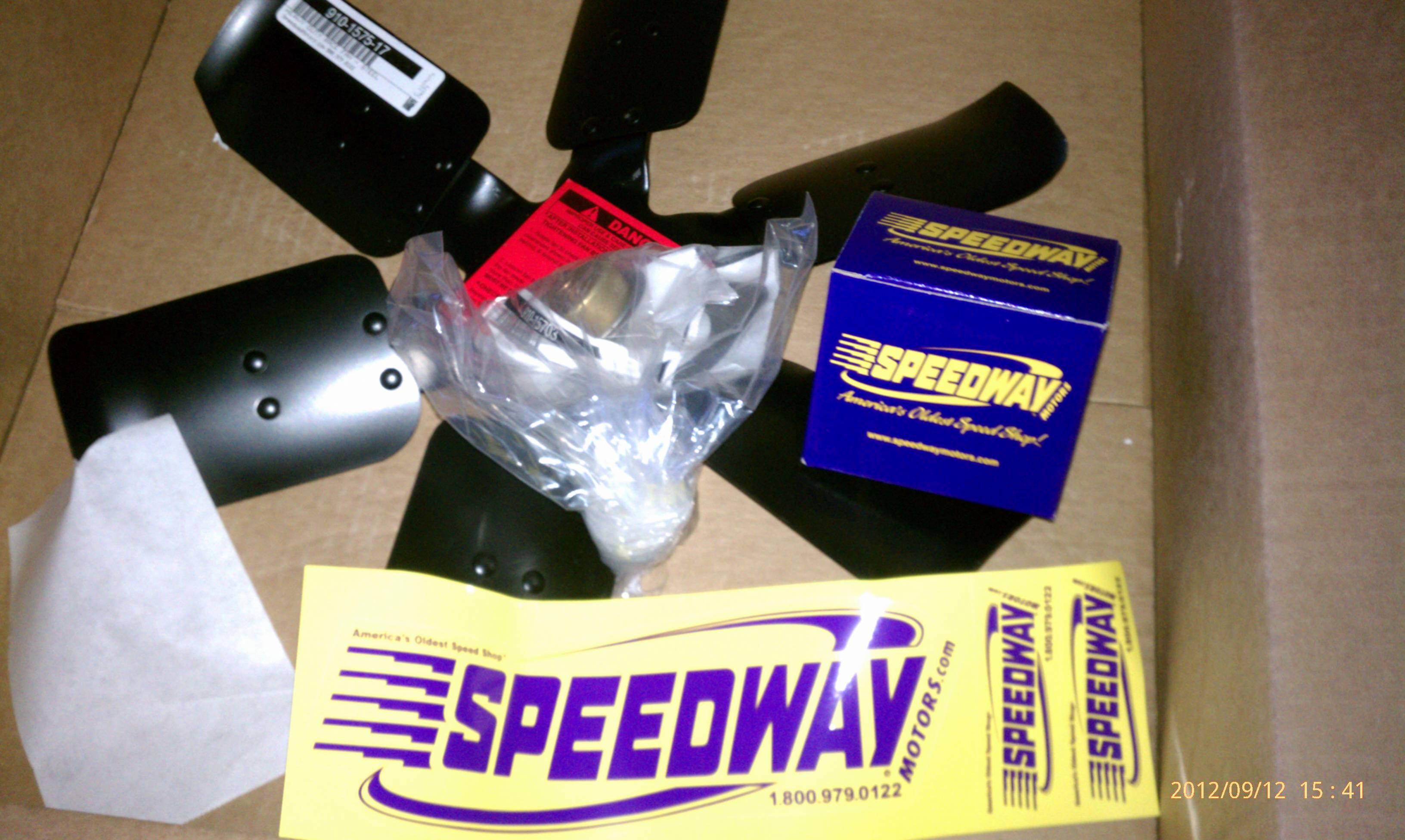

    I have been, now looking at that fan in Speedway. Do you prefer the steel rather than aluminum? Why?
    Is there any advantage to the HIGH FLOW thermostat Pg 207, item #910-15703?

    I bought the steel because Aluminum has a life span. I also wanted an aggressive pitch all the time. I didn't want it to flatten out at high speed...
    I also want to mention HRP recommended this fan, and I find he is an incredible wealth of information. In my case, he was once again right on.
    I just took out my High Flow thermostat, The engine will not heat up right. I am runnin a regular 180 degree, and she heats to 160 fast, then slow go to 170 and it stays 170 to 175 with A/C on....85 degree day....

    Thanks Mustang, I need all the help I can get. I will go with the steel, rather than aluminum, and keep the regular 180 thermostat I just installed. I also have problem with no good outlet for hot air getting from under the hood. I put louvers in the inner fender, doesn't seem to help.
