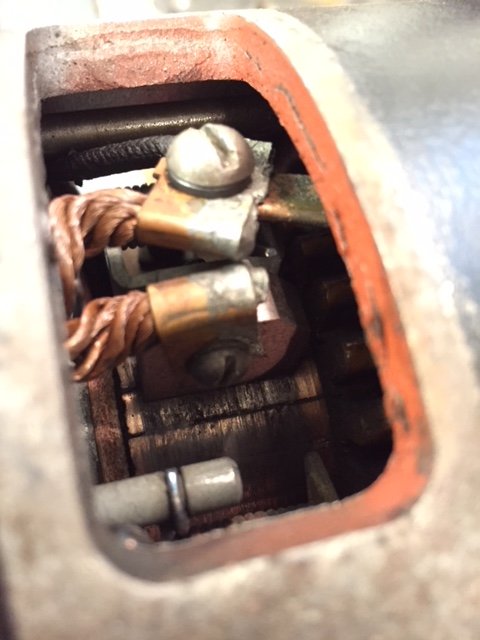

  8. Thanks man I appreciate it! The opportunity to own a genuine old build and bring it out of hibernation is an opportunity I never thought I'd have in life?! I did a little cranking on it last weekend with not much luck. The old starter was sounding a bit taxed so I took it in for a rebuild and got it back last night after work. I got it reinstalled and messed around with it a little. It still doesn't seem to be spinning as fast I think it should though so I'm looking at some other issues. I got it to pop a couple times but that's it. Hopefully I can get back out to the shop tonight.
    Thanks Lanny. It's amazing the toll the years dormant can take on this stuff! All those moisture attracting fluids have made a mess of things, ha! Of course I foolishly thought I'd be driving it by now but if we don't have our dreams what do we have, haha!

  16. Well, nothing good, ha! I did some more cranking without much luck. After talking with a friend I think compression is low from sitting dormant so I'm soaking the rings a bit. Last week I said the starter didn't seem to be cranking much better than it was before the rebuild. Well this would explain it???
    See it in action here...
    https://instagram.com/p/Bahu1xJgvek/
    So, I decided to clean the shop instead...:mad:

    Oh man. I would have to take a few and walk off the mad before I went back to the rebuilder for an explanation on that one.
  18. Yes, they are not open on Saturdays which worked out for them! :D
  19. Hey, a set back happens from time to time, although I would love to be there at the shop who "supposedly" rebuilt your starter and see the expression on his face. Let us know Mike and sure would make another interesting post on your thread...

    WOW! And they charged you for a rebuild? Are you going to see what their "explanation" is before you let us know who this ripoff rebuilder is?
    I might have a starter from a 394 Olds, if that will fit you're welcome to try it.
  21. Hey Bob! I’m sure it was just a strange oversight? We’ll see what they say? I’ve had good luck with them in the past. I appreciate the offer. I took the one off the 371 but it is different (shorter, different bendix, etc.) Hopefully they will put a rush on the re-re build, ha!

    I'm not sure how that can be alibied as an oversight! :confused::confused::confused:
  23. Yeah I’m not sure either @**** Stevens? I’m trying to be less of an ***hole in my older age? Ha!

  25. Still, the starter issue might end up working in your favor, since you're soaking the rings (more time to work in). With your heads off, are you soaking the rings with engine oil or MARVEL Mystery oil?
    Sent from my SM-G955U using The H.A.M.B. mobile app
  26. The heads are back on. I had freed everything up from being stuck in the bores initially. I think it’s just dry from sitting now. I had been spraying with WD-40 while the heads were off just to keep the moisture out.
    When I was rolling it over I put some ATF in the holes to seal up the rings and make some compression... and then the starter quit starting :confused:.

    I'm just imagining one guy writing up the tag that it needs to be rebuilt and repainted. He puts it on the bench and goes home sick. His colleague puts some power to it, it spins over, and he figures it's been rebuilt, but not repainted yet. He repaints and you get it back.
