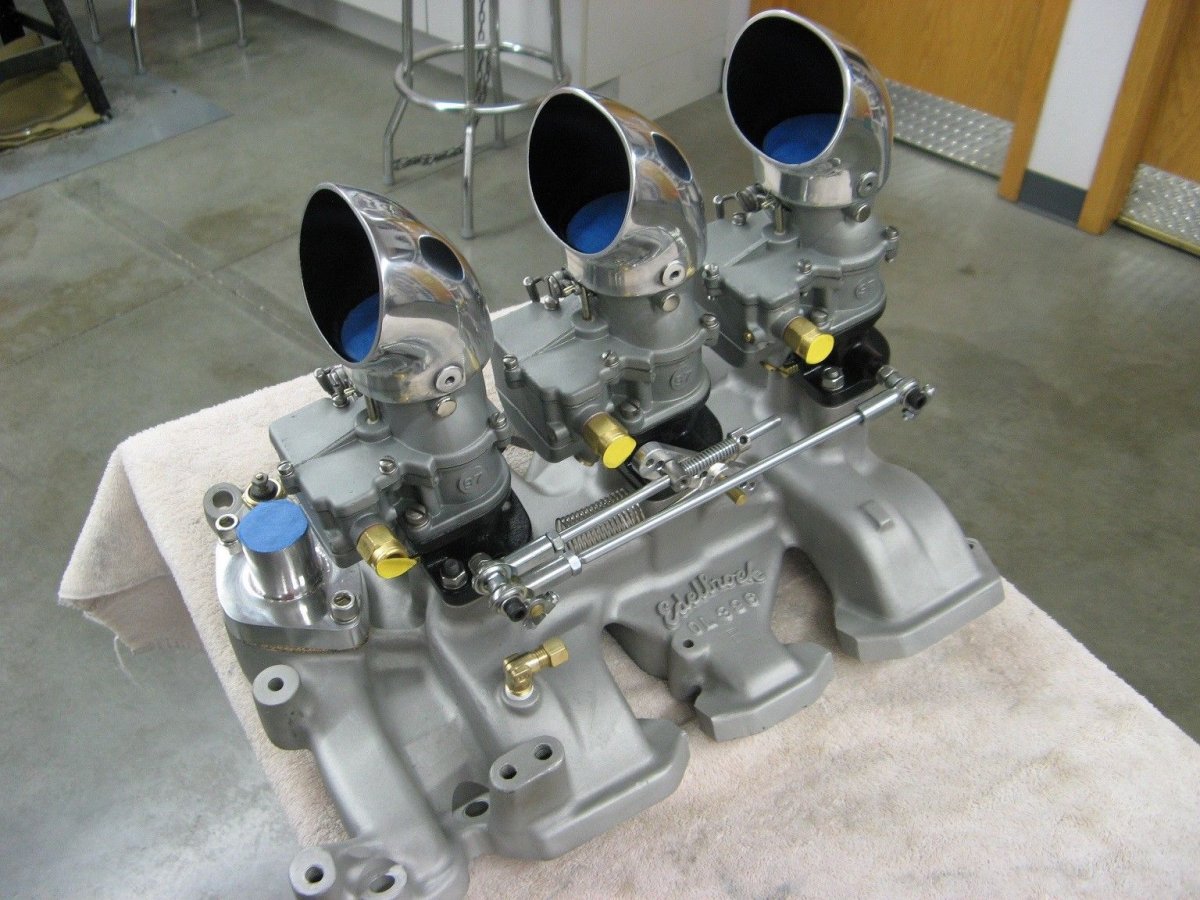

  13. Just scouting out on eBay for your manifold, but you better mortgage your house to get this one... She's GORGEOUS though!! Just a teaser... Olds 396 Intake.jpg

  17. Yes I saw that one! Too rich for my blood, ha! It is for a 324 anyway and while it may work the ports would not be matched I don't think?
    It is really hogged out and and port matched to the 371 ports. In doing so the runners were blended into each other. 371 gaskets may work (I had 303 and they leaked at the top.)
    Heads are for sure 303 with the smaller ports. According to my old Moon catalogue the OL396 B is for the '54-'56 engine.
    This Olds business is all new to me so I will take all the info I can get, ha! Thanks for your thoughts!
