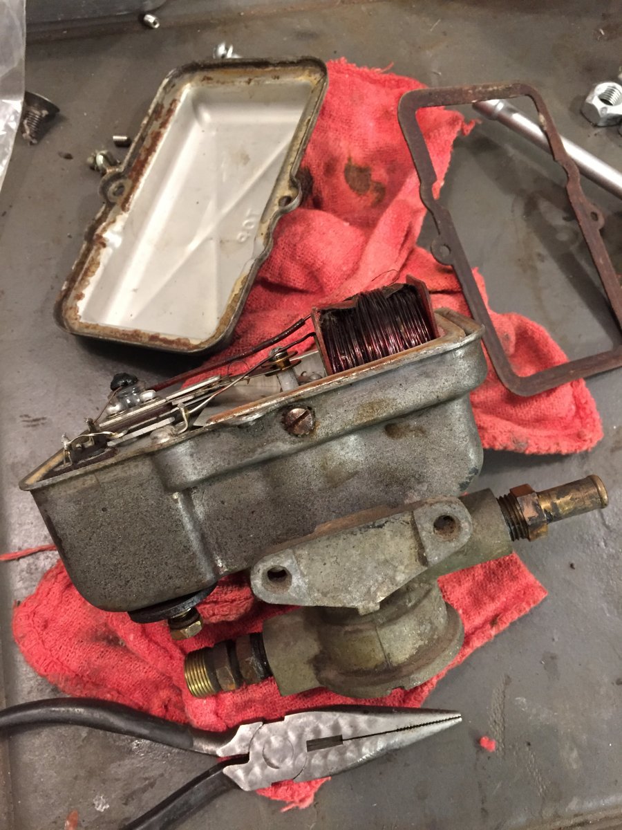

    Electric fuel pumps from so far back (pretty nice little unit and you found ink on it to boot)...and the ole water pump looks NOS now and it's working...the countdown is on yeehaw!

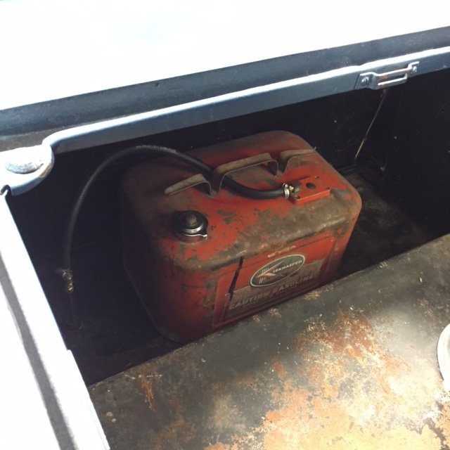

  3. There are remnants of some 3/8" copper line connected to some rubber of the same size. Lanny told me that after he pulled the tank out of the rumble seat area to build a new one he used a boat tank to be able to move it around. I have an old Mercruiser tank that I've been cleaning up that was my dad's. I plan on using it for the maiden voyage and until I decide what I want to do for a more permanent solution.

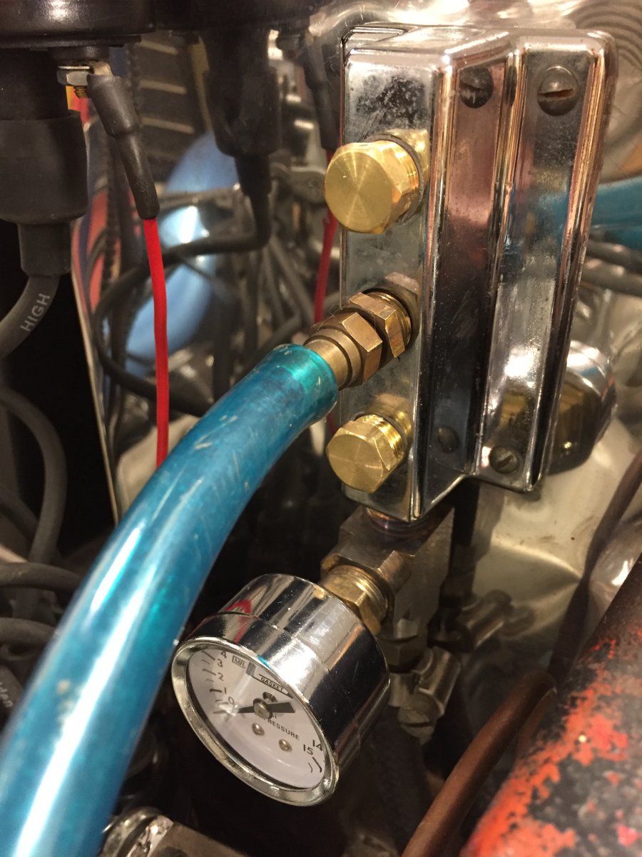

    Here is the fuel pump re-installed with its new filter access from below.

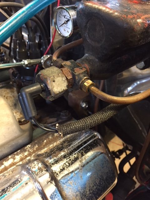

    I added a fuel pressure gauge to the block via some br*** fittings. I darkened them up so they don’t stick out like a sore thumb. I’m looking for a more vintage (MOON?) direct mount gauge if anyone has one to let go? (The other plugs will be replaced as I add carbs of course!)

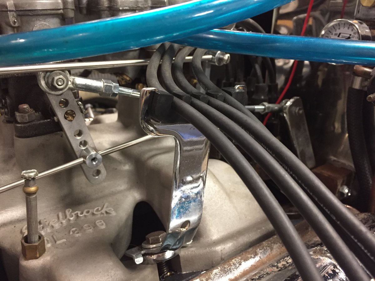

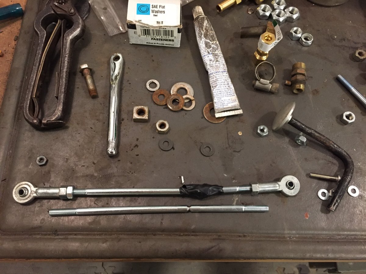

    This chromed lever mounts to the firewall and connects the gas pedal to the carb linkage. I’m not sure if it was used when the engine ran the stock four barrel or was added to make the change over to the tri-power? Maybe @Lanyard can fill us in?

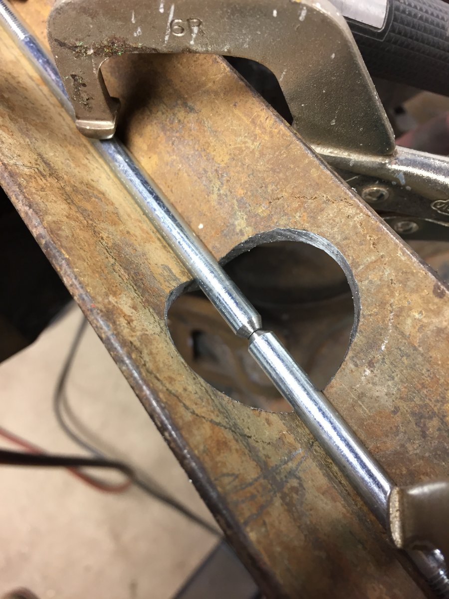

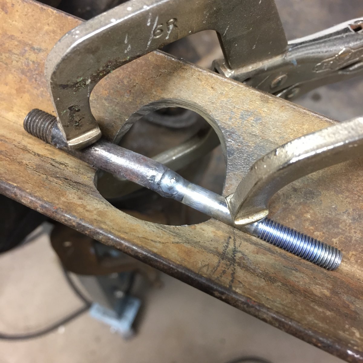

    I did some mock-ups with some heims and bolts I had.
    Once satisfied with the length I did some cut and paste.

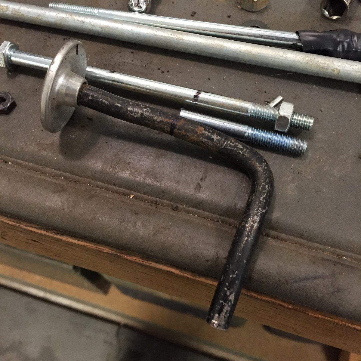

    I also had this stock Model A pedal and part of the linkage I cut from the Levee Leveler.
    Some more cut and paste and this will attach through the firewall to the low end of the chromed bar via another heim joint.

    The fuel block shown is the one that has been on it. I can’t find a name on it. I would just like to find a more vintage pressure gauge to mount rather than the Mr Gasket one I put on it for now. You can get the Moon gauges new but they don’t have quite the same look!

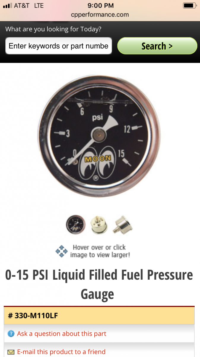

    This is one in the ‘63 MOON catalog.
    This is what is available now.

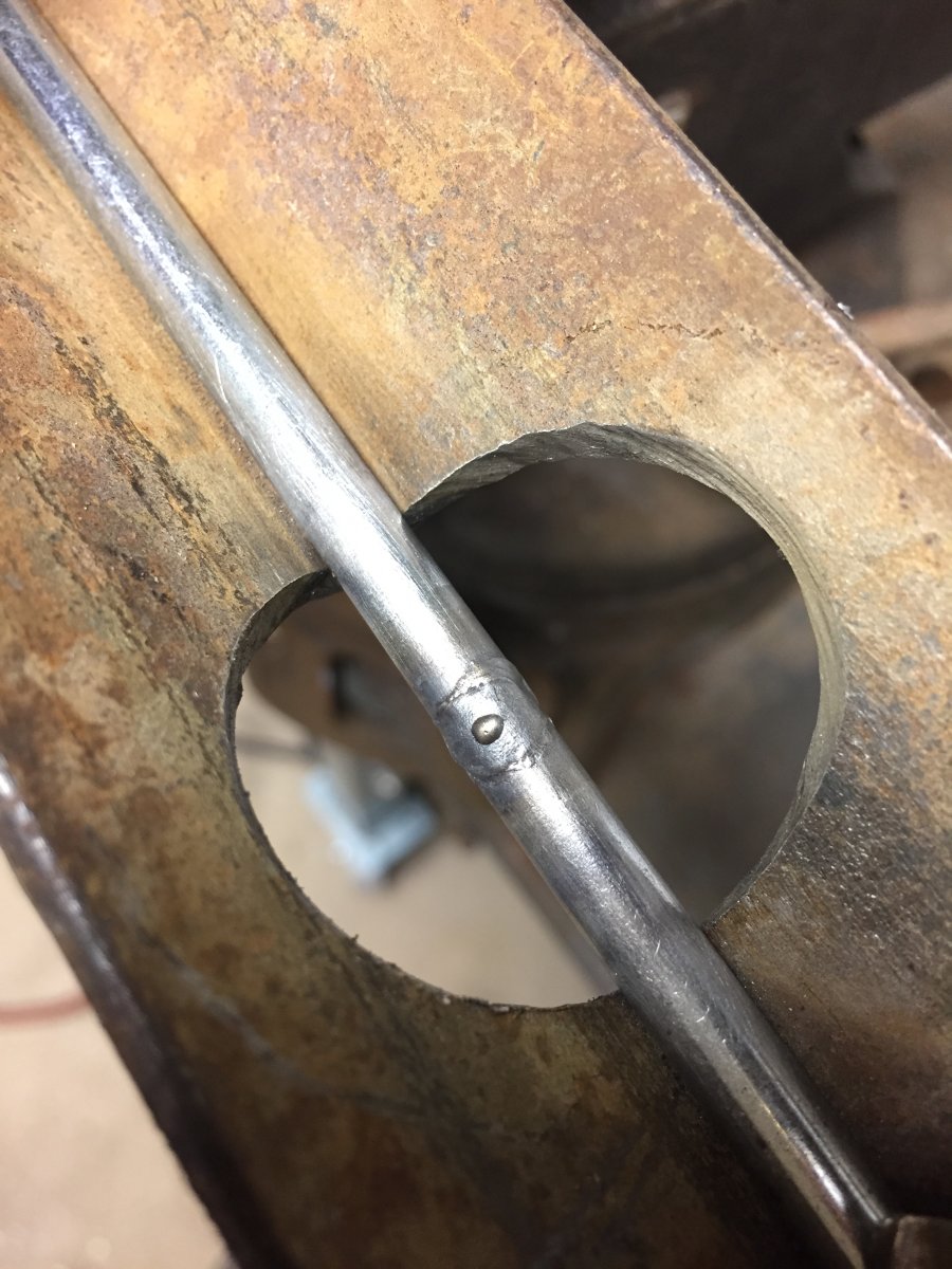

  27. With good weather and a long weekend ahead I made a huge push on the roadster trying to tie up some loose ends. I ran a new hard line from the fuel pump to the trunk and adapted some hose to the temporary boat tank.
    I also tidied up some wiring and wired up the brake lights with some stuff I had leftover from my truck build.

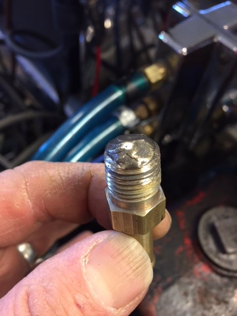

    Lastly, in an effort to drive it by the end of the long weekend I brazed up a couple of fittings and made some 20ga steel block-off plates for the two end carbs. Past experience has taught me that getting the 3 carbs to work together will take some finessing so rather than get frustrated I chose to just deal with the center carb for now. But, it looks cooler to have all 3 mounted!
    I made a few final checks. I put her back down on the ground and nervously torqued the rear axle nuts to about 170lbs by the time it was all said and done and then...
    https://instagram.com/p/Bb-jDFRAEJP/
