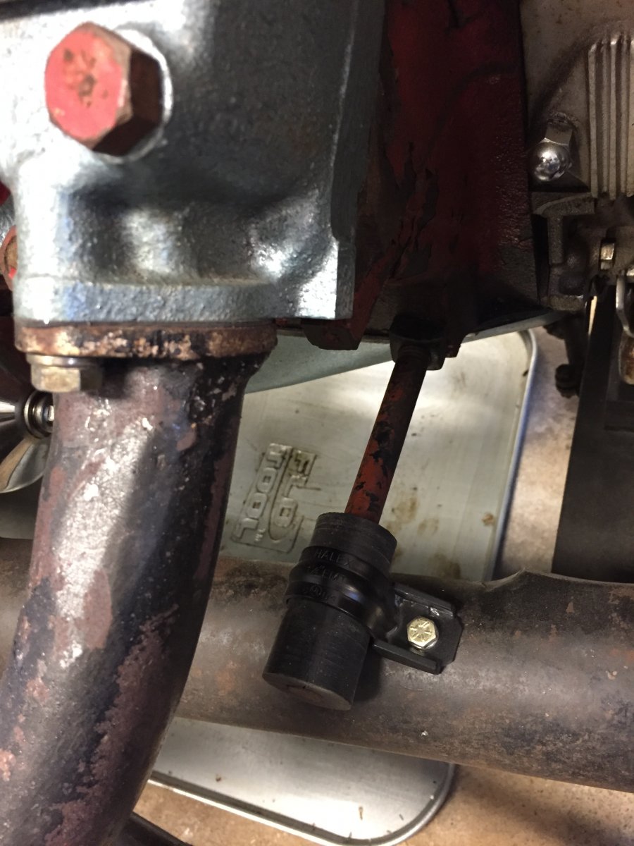

  7. The engine in the B.B. is mounted via the stock center Olds mount at the front and the ‘34 Ford trans mount at the back. Lanny added some “torque arms” at some point to keep the engine from rolling. He said he replaced them a lot as they would bend. He’d just unscrew them and screw some new ones in. I love that!
    Well, they still tend to bend but rather than change anything to say a Hurst type mount I decided to make a couple of little bracket to help keep it screwed down. That way the original design doesn’t change an I only had to drill and tap one little hole per side on the frame. We’ll see how it does. 08DEAF0E-8B8E-460C-8B0A-0D65AC145FD2.jpeg 676D59ED-8EB5-46B2-91E1-117D4707AE4A.jpeg

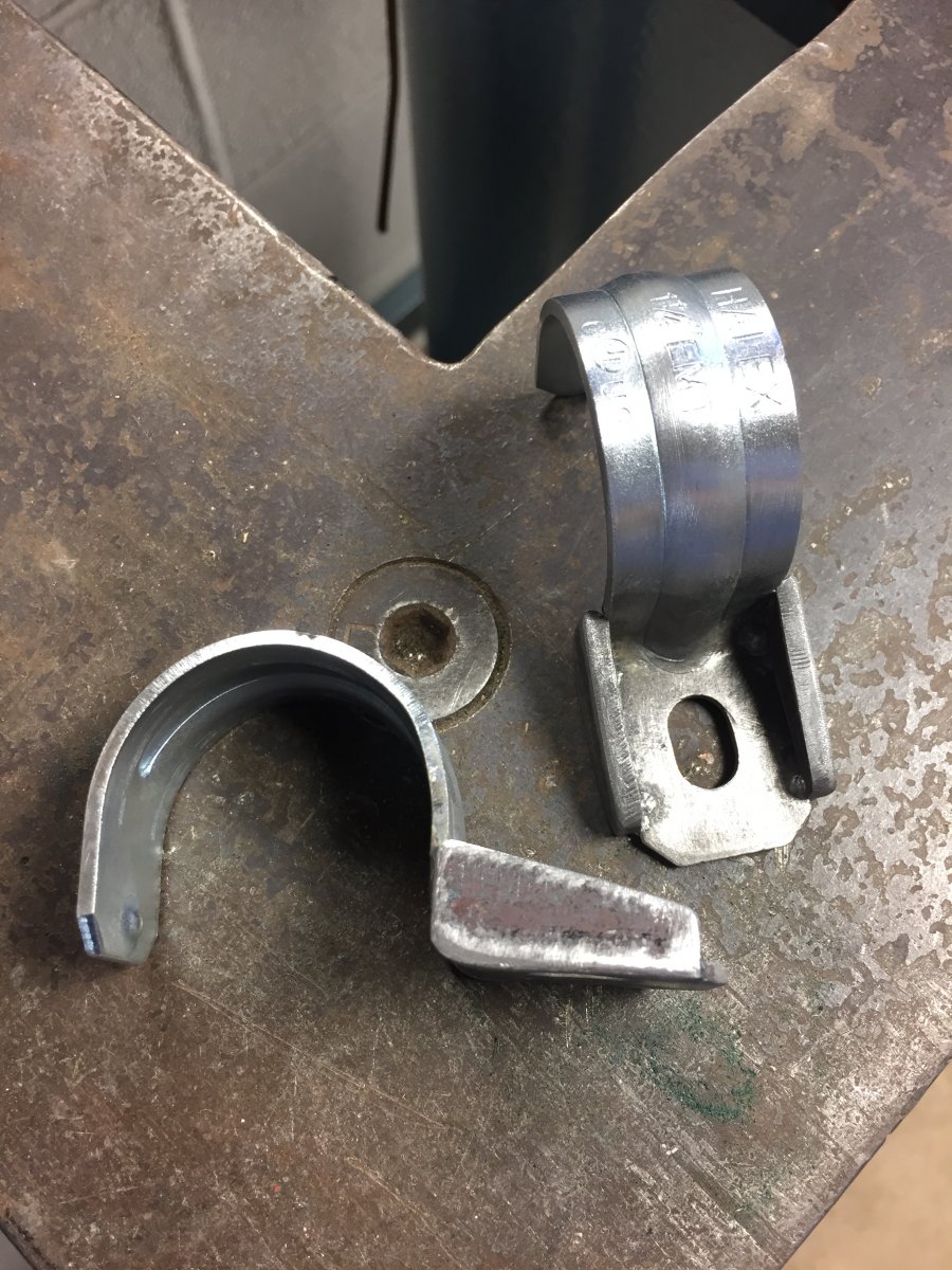

    With the Drags coming up next weekend I needed to figure out some sort of catch can for the coolant in order to p*** tech. I took a cue from the lakes plugs that are on the car and used a piece of 2” exhaust tubing that I had and a pipe plug and a coupling.
    4CA1BBEB-8F6B-41FA-B741-5FF51A5984A5.jpeg A3CCCD80-1491-46D6-90DC-9387B960AF98.jpeg
    I tried to hide it the only place I could. I need to leak test it and maybe paint it black. For now it is wire tied on to test fit. I also need to get a black piece of tubing.

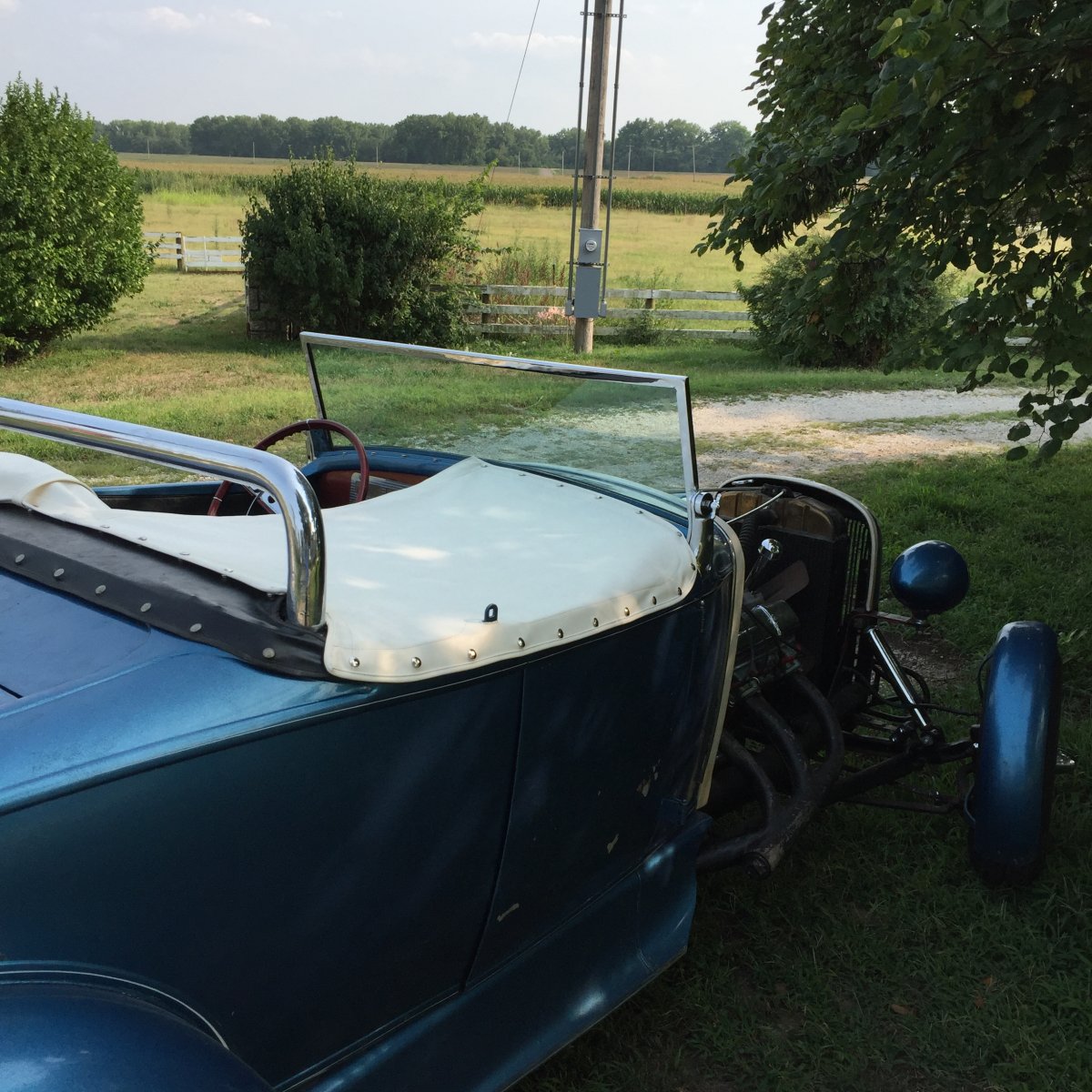

    Here’s a glamour shot. I had the cover made to zip in half and had them make a couple straps so I can roll it up behind me when I’m running solo.

    How’s it going down the road with the half cover?
    Was going to stop by this afternoon but it was time to go home for a nap
    loudbang, Stogy and 31chevymike like this.
  9. Outstanding little improvements Mike! The BB will get all the attention she deserves - have a BLAST at the DRAGS!!!!!!
  10. A little floppy but seems to stay put. When I towed it home from KC yesterday I left the whole thing on to see what would happen. It was a little spooky at 70 mph. There's enough air coming through the firewall that it balloons pretty good. Don't think I'll be doing that again unless I figure out some way to batten it down that won't hurt the cover or the paint.

    Could seal up the firewall?
  12. Well I'm afraid it's firewall, floors, doors, etc. A loosing battle. I really just wanted the cover for outdoor overnight protection and because it used to have something similar and just looks so damn cool if I do say so myself.

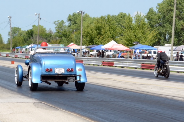

  15. Last weekend we loaded up and headed for the HAMB drags and had a ball as usual! image.jpeg
    My pal Brad @Blakmerk gave me this Rocket keychain pencil for the BB. Thanks again Brad!
    Lanny and Sally came out too! I took Lanny for a ride! The first time since 1964! image.jpeg
    Had fun running down the track with my pal @Kevin Lee! Lanny told me that back in the day some guy in Salina got a new Harley so they decided of course to race and see what would happen. Well, let's just say this was not the first time the BB got beat by a motorcycle, ha! All in good fun!
    I'm not sure who took this pic?
    Our own @J.Ukrop was in attendance and snapped these killer shots as well!
    And to ice the cake the BB was presented with the Kontinental Cup! How cool is that???
