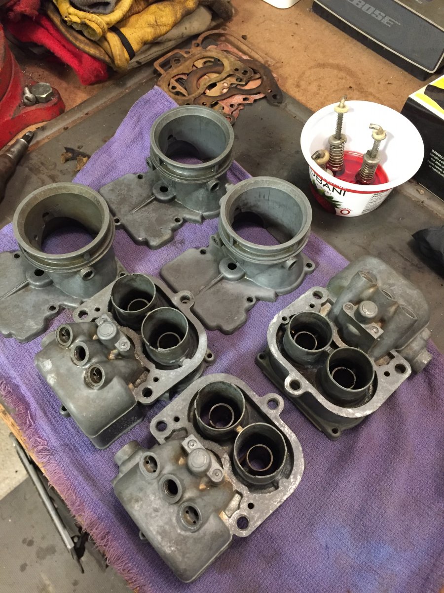

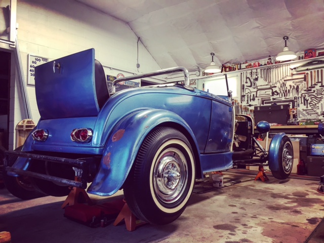

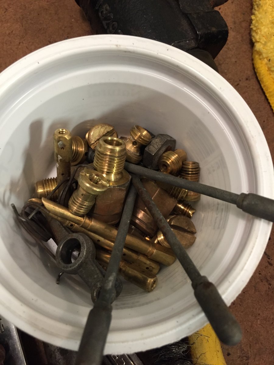

  6. Saturday was rainy so I got to spend some time in the shop instead of the yard. I dove into getting the carbs apart and cleaned up for rebuilding. I kind of want them to retain their current "patina" (sorry) so as to not look too out of place with the rest of the finishes on the roadster so I didn't soda blast them or anything. They seem to be in pretty good shape but missing some parts. IMG_3450.JPG
    And one broken throttle body...

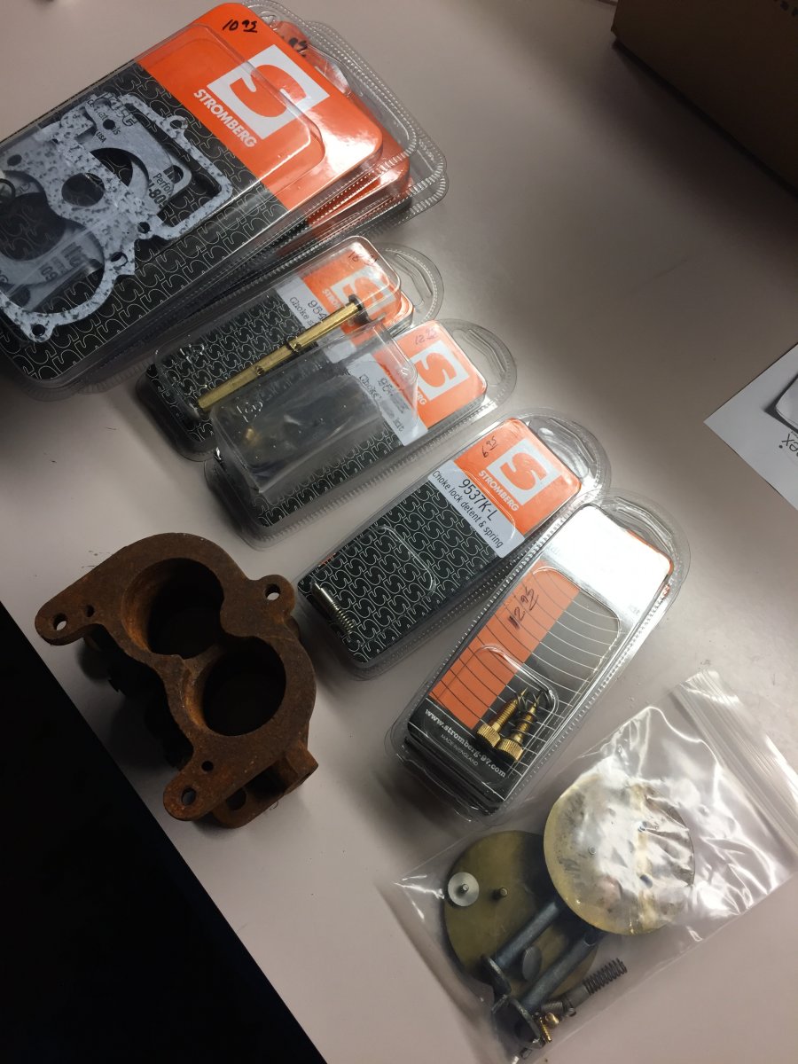

  7. We are fortunate to have in our little town a place called Baxter's Early Ford parts. They are a Stromberg dealer and a few emails back and forth and Bob had all the parts ***embled that I needed! He even saved me some money by subs***uting good used parts if he had them. On top of that he stayed open a little late to give me enough time to get there after work. Good folks!
    Hopefully I'll find some time this week to get the carbs re***embled.

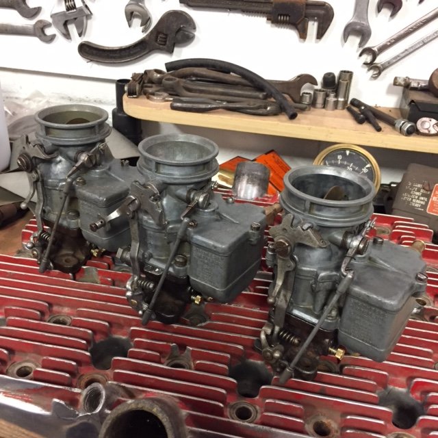

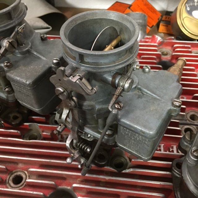

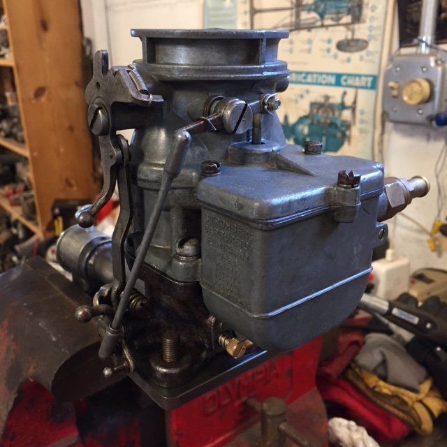

    I did make some progress today though. I got the carbs all cleaned up and re***embled. The two end carbs have the chokes locked open as per Stromberg's recommendation when using in a tri-power as they say they are designed to use the chokes help airflow.
    I didn't want them to look new so I wire wheeled them on the bench grinder and got the nooks and crannies with a wire brush and also a small cup brush with my flex-shaft. I coated them with some Krylon "Crystal Clear Acrylic" as I've had good luck with it in the past on some other projects. I like it because they look uncoated due to the matte finish.
    Next I think I'll soak and pump up the lifters with some oil so I can re-install the heads and get this thing fired up soon!
