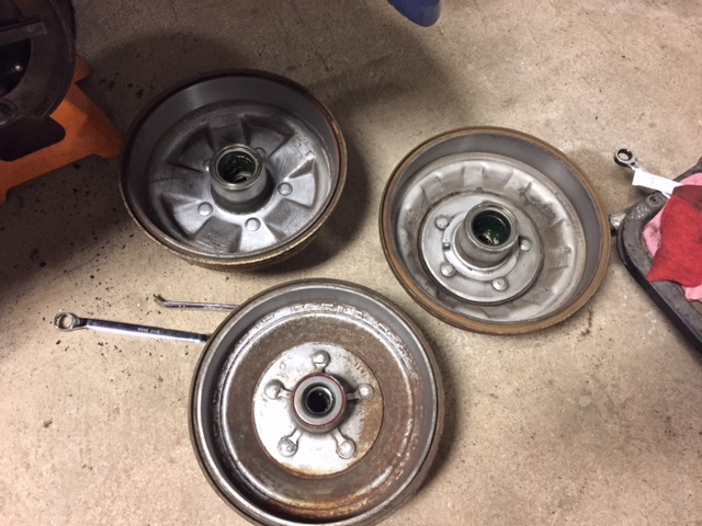

  1. As you can imagine, everything is pretty crusty after sitting for 50+ years. I got a couple kits to repair the clutch/ brake MCs from Baxter's. I also got a couple rear wheel cylinders as one had some bad threads and the other a little pitted. I just happened to have a couple new front cylinders as well so I will use those in the interest of time. IMG_3727.JPG
    I filled the brake MC with some of that miracle rust converter as it was a little crusty in the resovoir. The bore cleaned up pretty well. Hopefully I can use them both.

    Before we left I pulled the brake drums to find they were all pretty thin. Also, I was able to pull the rear drums by hand (no puller.) Yikes!
    The rears were mis-matched and I happened to have a set on the shelf for another project with a similar mis-match? Weird.
    After some practice on an old drum I put my new (to me) brake lathe to use. It worked a treat!
    I greased the wheel bearings and added all new seals of course. I put everything back together and got it all bled by Sunday evening. I thought I was doing so well and then noticed all the brakes were stuck like chuck...dammit. I pulled the fronts back apart to see what was going on and did a little Internet research.
    It turns out the tiny bleed(?) hole in the MC was barely plugged not letting the fluid return and acting like a check valve. I got that cleared and put everything back together and re-adjusted and crossed the brakes off my list! (Hopefully they're still holding when I get home from work!)
