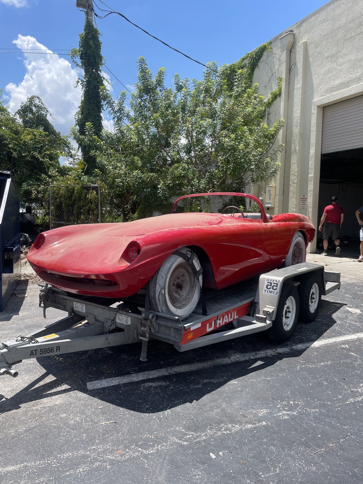

    I had no intention of getting another project but this was too good of a deal to p*** up.
    These were introduced in 1960 by La Dawri, but I'm not sure what year it is, the company went belly up in 1964.
    It’s on a shoebox Ford frame with a 1955 Pontiac 287 engine and a 4 speed Hydramatic. I don’t know what the rear end is yet, I'm ***uming a Ford, it has 5x5 wheels front and back.
    It’s very well built with a steel firewall and inner fenders.
    I’m hoping it’ll be a fairly straightforward project. All the hard work has been done.

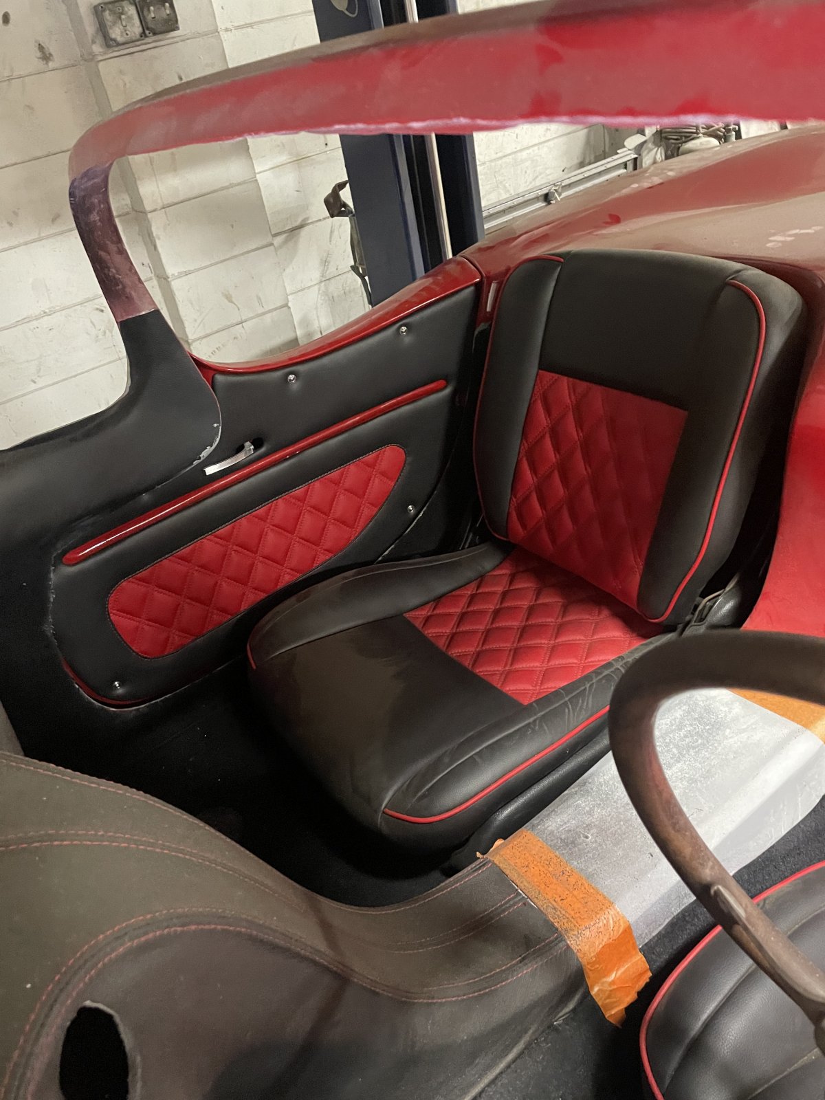

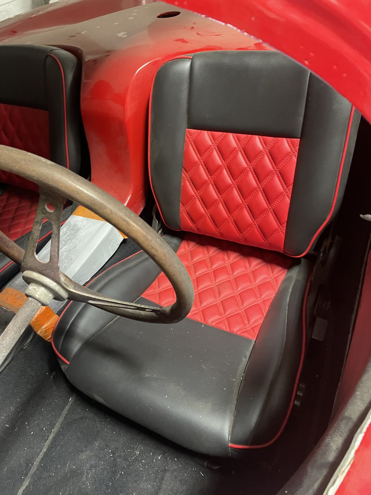

    The interior has been upholstered in a modern pattern that I dislike. But it does have the center console and beautiful instrument pod that were options.
    I’m going to repaint it, I really am not a fan of red cars.
    I’ll share a lot more pictures as I dig in deeper. FD90C5BE-B42A-4717-82DB-35067EF381DE.jpeg A721C475-1F5B-4ECA-B2D9-DF8DF644CC74.jpeg B3768082-F92D-4F17-A091-C04487D18F08.jpeg B3768082-F92D-4F17-A091-C04487D18F08.jpeg

    Super cool! Is there a certain OE piece of gl*** that fits in the windshield opening?

    It's an upside down '55-'59 Chevy/GMC windshield, they are readily available and not expensive.
    The tailights are 1950 Pontiac but pretty much any round one that fits will work.
    The body is in great condition with no cracks or crazing.

    Neat car. Since it has a Pontiac engine, it's possible the original owner used a Pontiac rear end too - they have a 5x5 bolt pattern.

    Neat car, I can't see a upside down windshield working. Maybe a cut down one.

    That's what fits. It's what's specified in the catalog and build manual.

    LaDawri had some of the prettiest body designs of the "build your own sports car" era, they kind of look like if Ghia or Pininfarina restyled a Corvette. This one could be really pretty. I'd like to see what one of these would look like with covered headlights, like an E-type or 250 GT. It certainly has the bodywork to support headlight covers.

    that's a great idea. Les Dawes was just 23 years old when he designed these.

    A number of the fibergl*** bodies from that era were built around a windshield that was readily available along with the backlite and even side gl*** on some of the coupes. You see how setting the gl*** the "other way" lays the windshield back in post 12.

    looks like it would be more laid down on its back than "upside down"

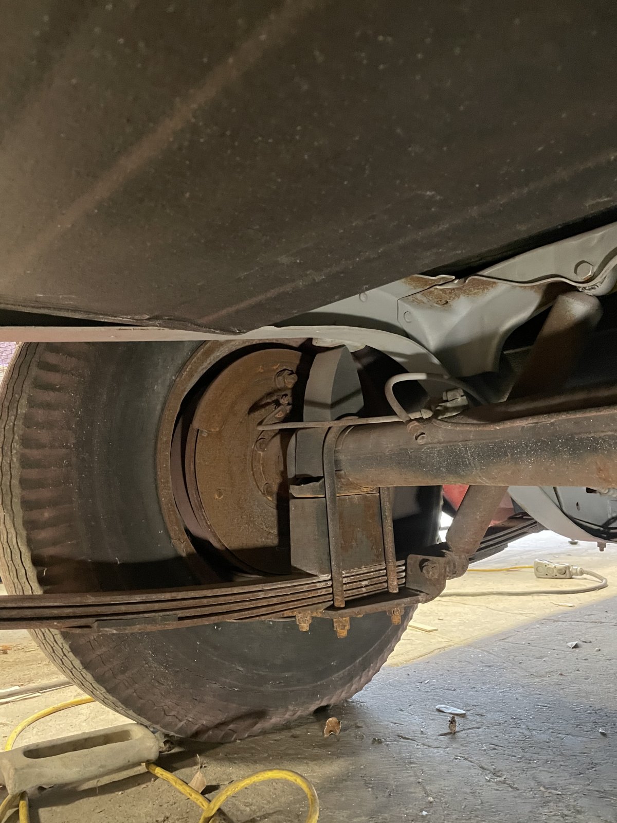

    Does anyone know what this rear end is?
    The interior is too modern for my liking. Tuck and roll would be better. A580F634-7497-438A-A56A-8613507B7047.jpeg 20F1D452-E605-483A-B8E5-AE02E8D2778F.jpeg C0923AF4-F2EA-4E3C-9A6D-BB283D7878BD.jpeg 730F3A88-B819-497A-AAA1-5E0059AAC622.jpeg 7F7B5ECD-BE8C-4C91-A674-6E06FFE4CD5B.jpeg

  24. The welded seam tubes resembles a MOPAR axle I have stashed somewhere
    That brake adjuster suggests a pre self adjusting rear axle
