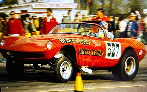

    Here is a rare shot of the finished Gary Weldele and Bob Foster La Dawri Sports Car in the B/Modified Sports Car Class. Sponsored by the world famous, Compton Service Center Speed Shop on Atlantic Ave.
    Pure power raised the front end on full acceleration. It was not a raised up front end set up like in the fad that happened in the late 60s. There were modified shocks that had a 80-20 ratio and the full drag racing shock was 90-10. (A 90/10 shock, on the other hand, requires more pressure to compress it, but very little to extend it. That makes a 90/10 an ideal front shock for drag racing because it lifts the front end of the car quickly and holds it there. That helps transfer weight to the rear of the car.)
    No need for the fake front end raised to the sky, let the motor transfer the power. Big M&H slicks, small tires in front and Halibrand slots all around, a great combo for show and drags. A super clean, So Cal Modified Sports Car.
