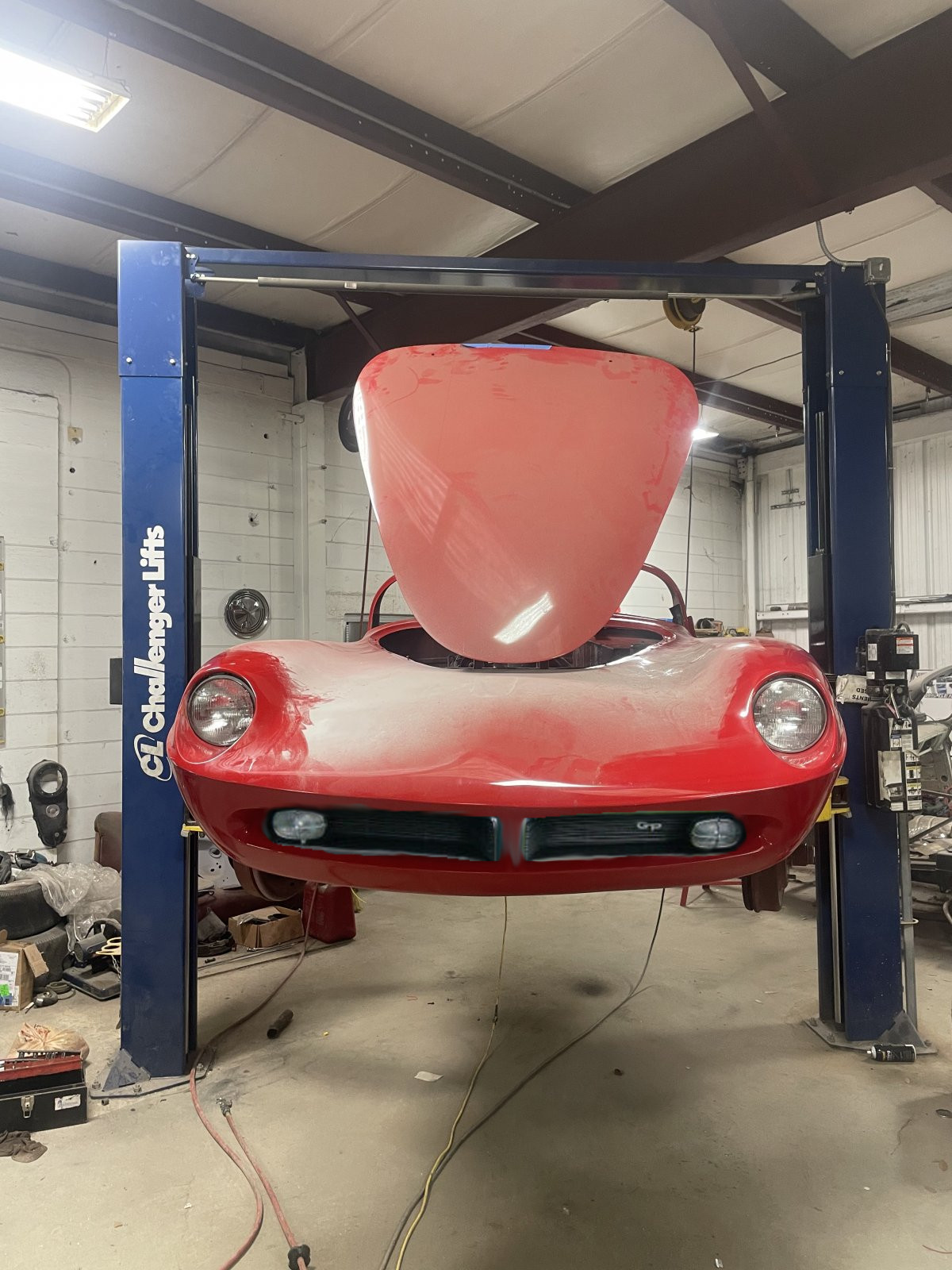

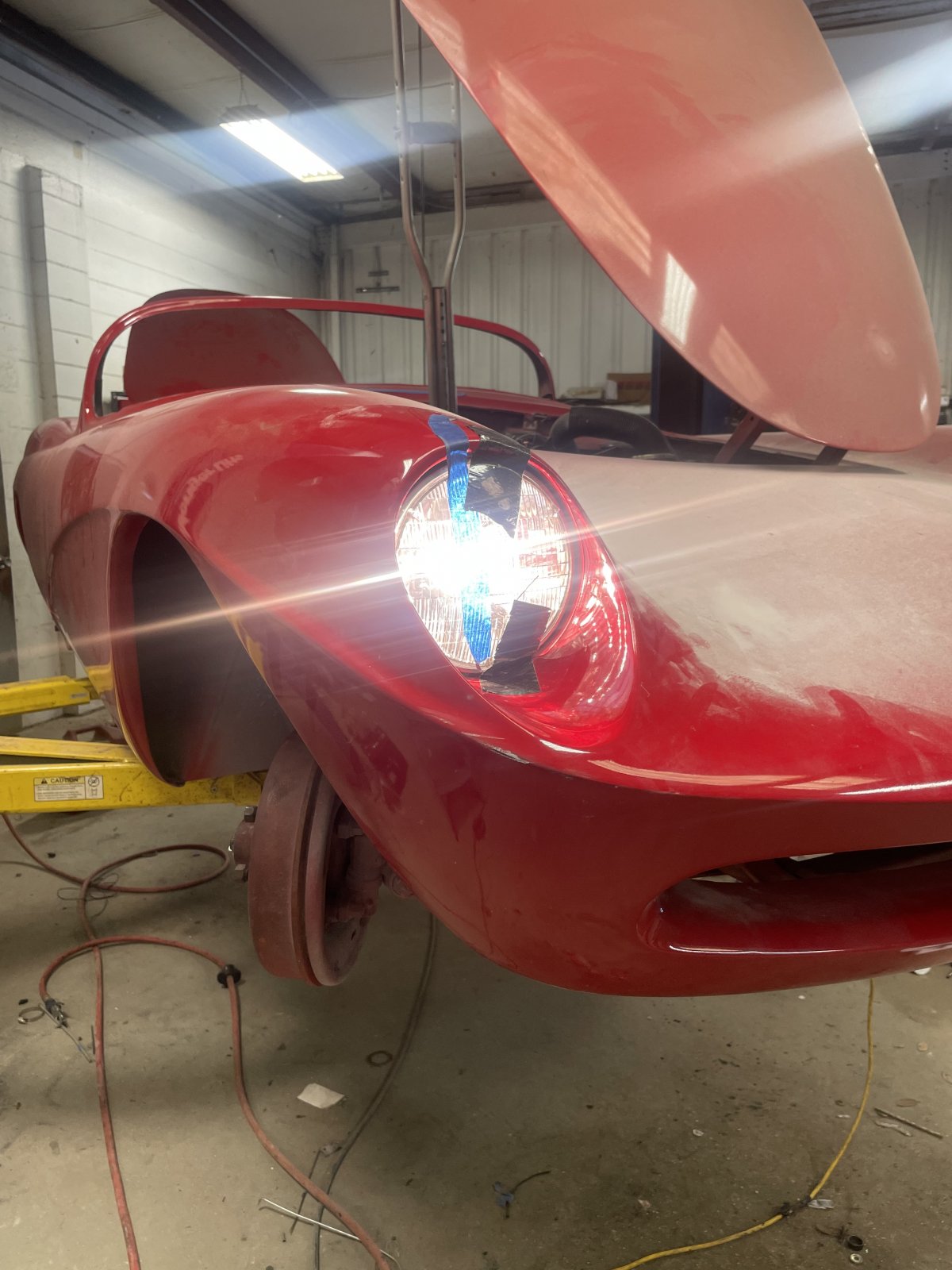

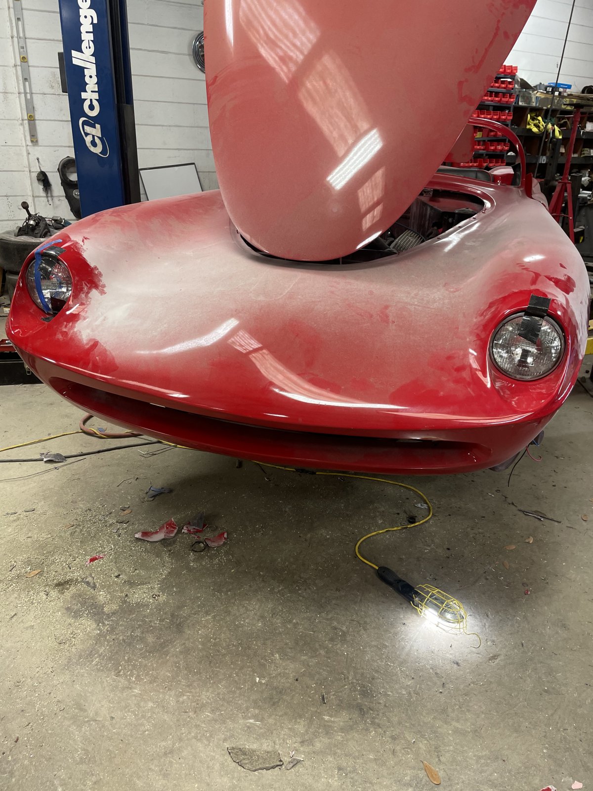

    Headlights and taillights are in.
    79B45BF8-044D-4255-9567-1F725503B4C0.jpeg Headlights were a giant pain in the ass. Someone had glassed in those weird buckets. A normal 7” bucket wouldn’t fit in. I had to grind it all out and I got some fiberglass in my eye. I mounted the bucket from behind and epoxied some brackets made from 49 cent L brackets from J&L Hardware. I’ve been going there for forty years. They are tiny and I love the people that work and shop there.
