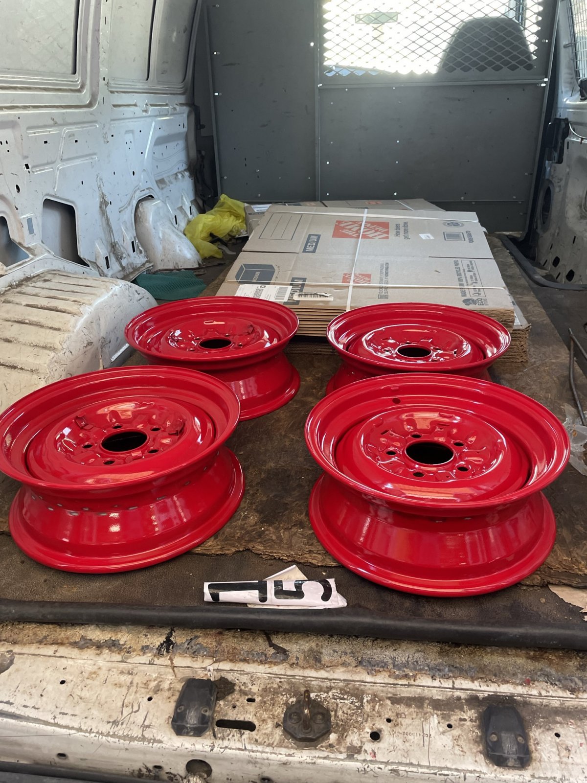

    I got some Auburn bias ply look radials to put on the powder coated wheels. One of the tires had tiny holes in the sidewall that let the air escape, Diamond Back said they’d replace it

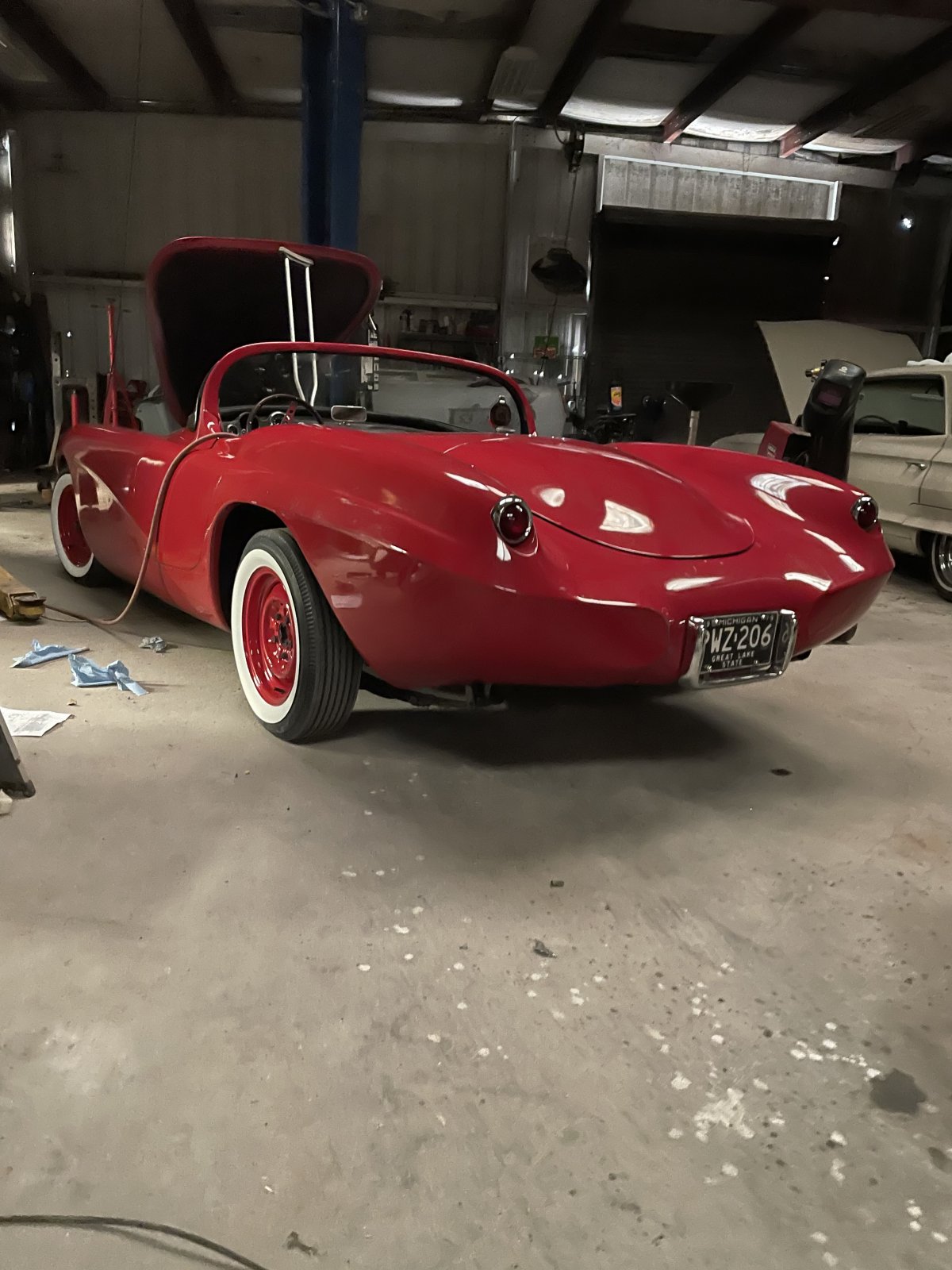

    I modified a ‘57 Cadillac license plate surround to fit and I think it looks pretty good, just a tiny splash of chrome to break up the expanse is color.

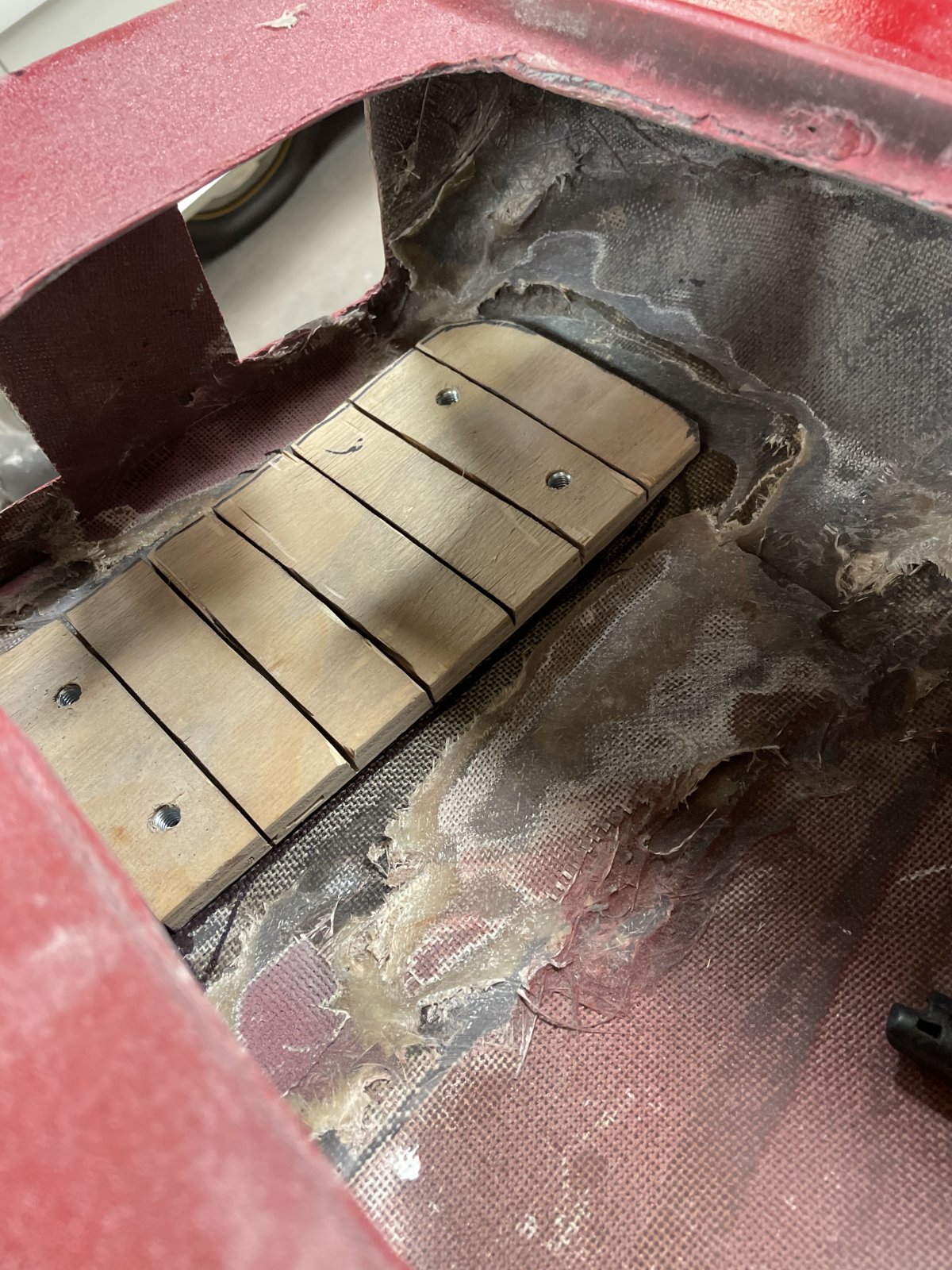

    I had to remake the hinge plate on the passenger side, as you can see the plywood was totally rotted. It was a pain in the ass to do but it’ll hopefully last forever. Amazingly the driver’s side was fine.
    A half sheet of plywood fits in The Karachi Krusher. I only used about sq foot. 77752FD5-836E-47D1-A402-C7D3D30063EC.jpeg 30CBDE5F-7C5B-4598-8A77-188BDFE0B9F6.jpeg 02AA8A31-4A31-4ECC-92AA-4FF816BDBF9A.jpeg 69766835-C7CD-4A99-B483-6F28D84C9429.jpeg 58886B1D-4854-4FAA-8E1D-F0C811C6F95E.jpeg 45F47FE2-9A8C-4457-BF29-7CB7BC81571C.jpeg 18B3B6F1-DBCA-492F-8B8F-BA60410C9C18.jpeg 0A5C9596-A389-47F5-8938-D44B1729E876.jpeg CBB5A70A-B029-481A-BB66-B7D1546B0D0D.jpeg

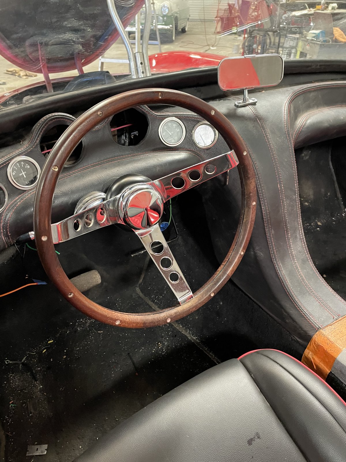

    7D85CAEC-513A-47B8-B914-5C66FDC8C32F.jpeg Here’s that old Grant wooden steering wheel in place, I think it suits the car and my wife loves it.

    The Cadillac license frame looks like it was made for that spot (or that spot was made for it), gives a bit of a bumperette look.

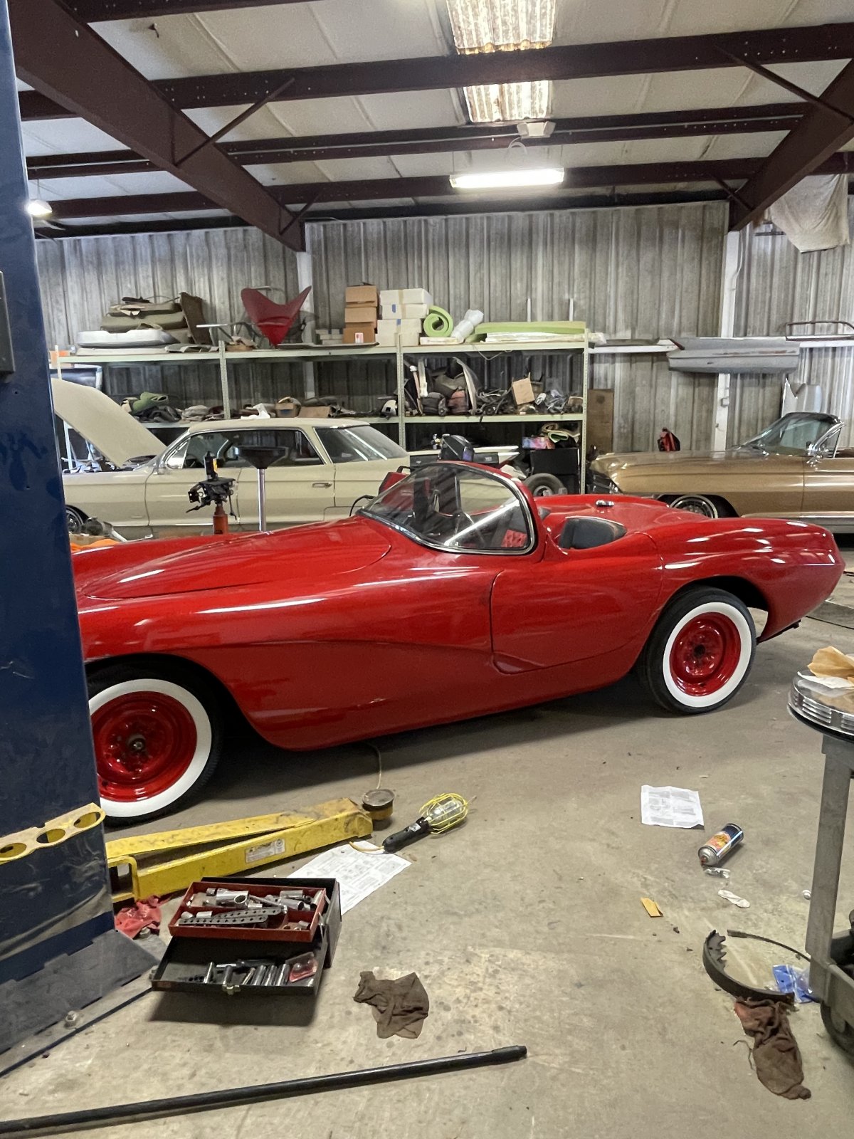

    8B0CF6CB-ABA8-45E5-84D5-C4DF938CEA8C.jpeg C21E6676-9794-40E3-B681-75429410AF0E.jpeg 355C1FBB-1953-4F55-88A4-90C9D087E4E4.jpeg Well kids, she’s running and driving. I’ve got to dial her in. The four barrel is sitting on a two barrel intake with an adapter. I can’t imagine this is optimal. I think I need to install a 4 barrel intake.
    Plug #4 is sooty, I don’t think it’s firing, the others are a nice color.

    Coming together quick! Looks good outside. Just for fun I wanted to see what it'd look like with covered headlights. This is a badly butchered photoshop but gives an idea, just for the heck of it.

    I absolutely love it. How would I make them? I have to come up with a plan.

    The ass end is definitely its best side F4BCEDEE-AE6C-4984-A181-BAB05AD92D40.jpeg

    Not sure how to make them, but there's a fair amount of info out there about bending plexiglass/polycarbonate, I think you'd bend up some steel rod in the shape of the headlight opening, make one of those air pressure boxes with the plastic on top like how guys were making bubbles for bubbletop show rods, then bolt the wire frame to the top of that and heat/blow the bubble into it until it takes the shape of the wire frame. Cut it out and add some kind of flexible trim. Probably massively more complex than that, but I think that's also how guys are making tail light lenses custom to fit into cut up bumper guards for 40's/early 50's style cars, just on a smaller scale.
    For the photoshop I robbed the headlights off of a Ferrari 250 GT replica picture and just stuck them on, the angles of the openings in the LaDawri are a little different but I'm not good enough at photoshop to make it perfect, they are pretty close though.
    It shouldn't involve any cutting or painting on the original body though, the body looks like it was designed from the start to have them.
