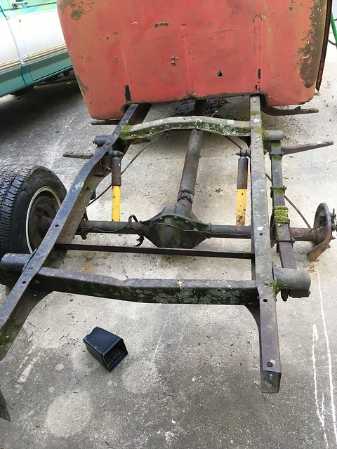

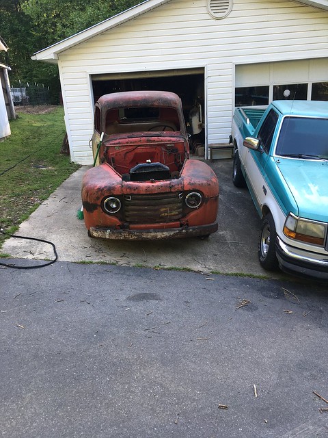

    My brother is coming to get the F1s tomorrow. I had no idea he had interest in it. I’m proud he wants it.
    That joker is going to put a “Mystery Motor” in it.
    Straight axle F1 with a 396...
    Holy Moly!
    “ You’ll shoot your eye out kid”
    My brother found the Fairlane for me years ago and for that reason I’m hanging on to it.
    Although my son kind of bailed on our ‘65 F 100 project, he wanted to keep it, so it’s staying too.

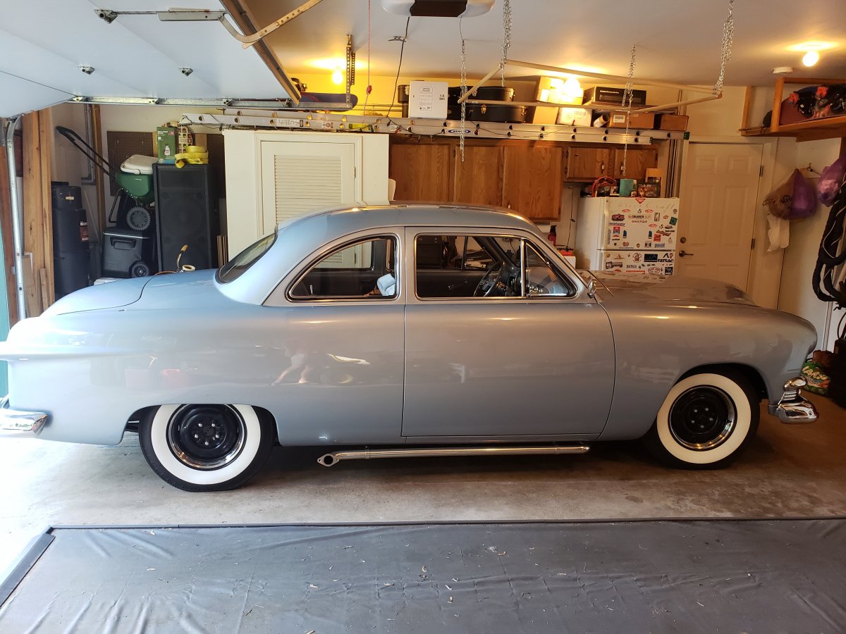

  12. That car looks real solid, congratulations!
    I finally got my 50 coupe running & was able to put some miles on it.
    Unfortunately mine is nowhere near as solid.
    Resized_20200529_143734.jpeg My first car at 14 was a 1950 sedan, getting to drive this was like going back in time.

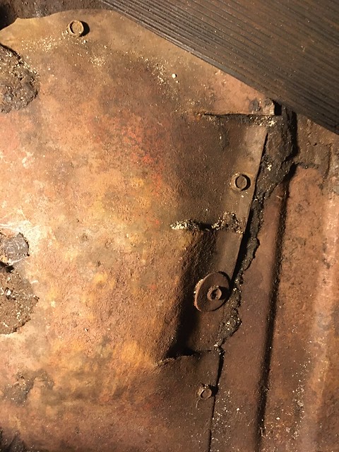

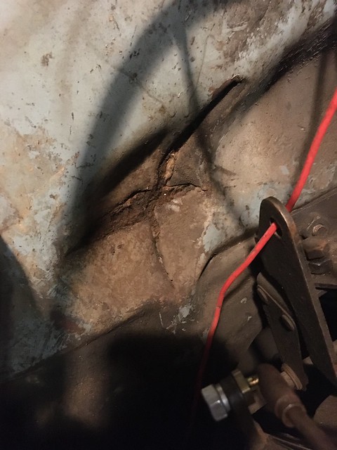

    Well.....
    Things just got interesting about the ‘51.
    Stuff was not adding up.
    Cut up floor and patches where there was no rust.
    Strange holes cut in the floor in odd places.
    The center of the firewall and toeboard plumb past the pedals has been cut away and patched back up.
    The center of the front crossmember has been trimmed....
    The car is still 6 volt and still has the original wiring except for some stuff under the hood.
    A big bashed in area on the firewall where about the spot where a Y block or Lincoln distributor would be.
    Ancient pieces of aluminum between the coils of the spring....just on the drivers side. This is to raise, not lower.
    Interior, absolutely original including the smell.
    The car is from the ***berland Valley Tennessee manufactured in Louisville Kentucky.
    Three main points....
    The car was modified for a big engine in the 6 volt era.
    The cars appearance was kept absolutely original down to the original interior.
    Strange holes for no reason.
    My conclusion......
    I think it was a blockader.....whiskey car.

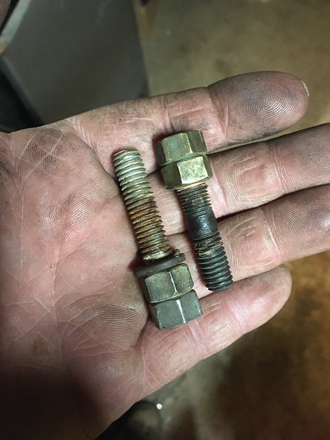

    Well I've dodged some bullets. I was able to make a repair that could have easily gone wrong.
    [​IMG]Un***led by Travis Brown, on Flickr
    The front two exhaust ports on both sides were ***embled with the wrong size "studs". On a Flathead the front 4 exhaust bolts ought to be 7/16. They glued in 3/8 studs with sealer.:rolleyes:
    I was very fortunate to be able to make this repair. ( Chase and clean up the threads with the engine in ch***is)

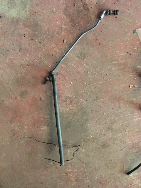

    The accelerator linkage was a nightmare. It was barely functional. This was one of the main things that made the car near undrivable.
    You gotta love the "porch door" return spring attached with bailing wire to the generator bolt.

    To do what I wanted to do with it led me to this one.
    To do the F1 like I wanted meant swapping frames, trying to repair the 50 sheet metal and going back with the flathead.
    The red parts truck in the drive way sent my wife over the edge, over the edge in a good way.
    After about a month of the parts truck in the driveway, she told me. If you liquidate those trucks, we'll get something nice.
    Hence...
    My new 51.
    I was stuck with the F1 project. Maybe I just had it too long.
    This blue Ford. That one I can handle.
    I had to be honest with myself.
    I can repair one, not build one.
    I can repair the blue Ford.
    In theory I could have built the F1, in reality maybe not.
    I can handle the blue Ford, The F1 was just too much.
    My wife even posted on her FB when the blue coupe was delivered. She called it.... Travis has got his Coupe back day.
    My brother got the F1 and the parts truck. It's in good hands. He has lots of plans for it.

    On with the accelerator issue. This was a major problem the linkage flat out would not work safely.
    This is what I found...
    Somebody had cut out a piece of sheet aluminum and threaded a plastic nut and bolt through it. Then they drilled through the plastic bolt to make a bushing for the accelerator rod.:confused:
    Here's the floor.
    They had used a heavy piece of aluminum sheet to "rebuild" that portion of the floor. This was not rust damage although the car has a little rust damage to the floor.
    This was from a previous engine swap.
    I had to hand form a proper panel and attach the accelerator pedal ***embly correctly.
    Bingo!
    The gas pedal is repaired correctly, it now has a well functioning Go-Pedal.:)
    Here some of the carnage from the engine swap...
    Got Clearance?
    The toeboard looks like a patchwork quilt.
