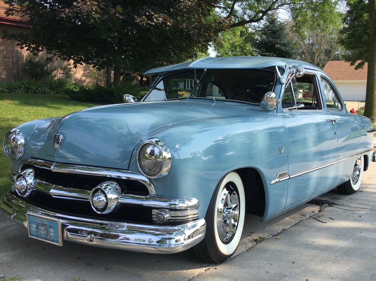

  5. IMG_1451.jpeg Very nice coupe, a great starting point! I have a similar one!
    loudbang and F-ONE like this.

    That's a very beautiful car Nifty One.:)
  7. tubman
    Joined: May 16, 2007
    Posts: 7,952
    tubman
    "Nifty One", after seeing your coupe, I think I'm going to have to put some lowering blocks in the rear of mine. The "Rake" is getting old.
    Very nice looking car.
  8. tubman
    Posts: 7,952
    tubman
    After a second look, I am also seriously considering removing the bumper guards.:D
