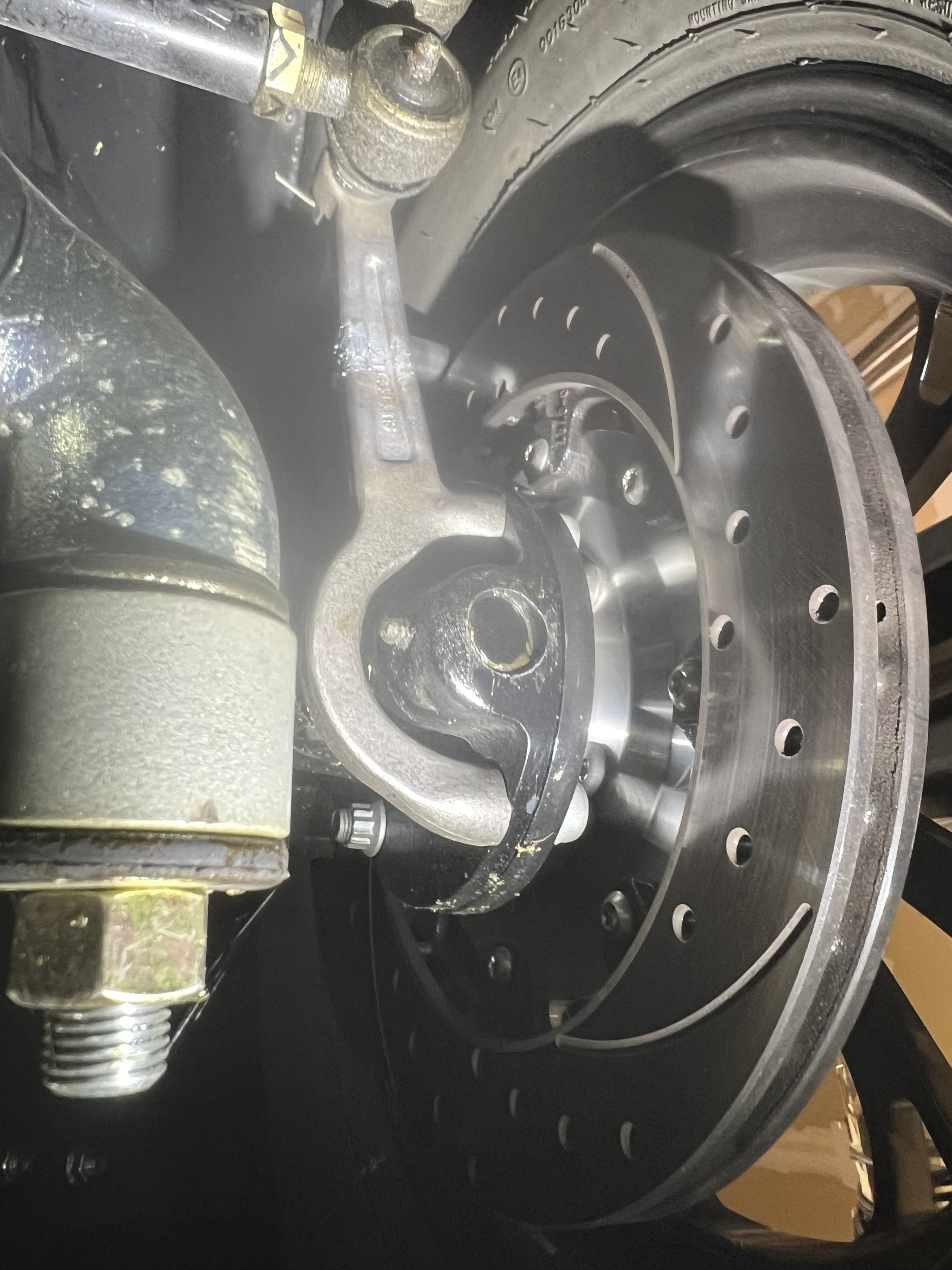

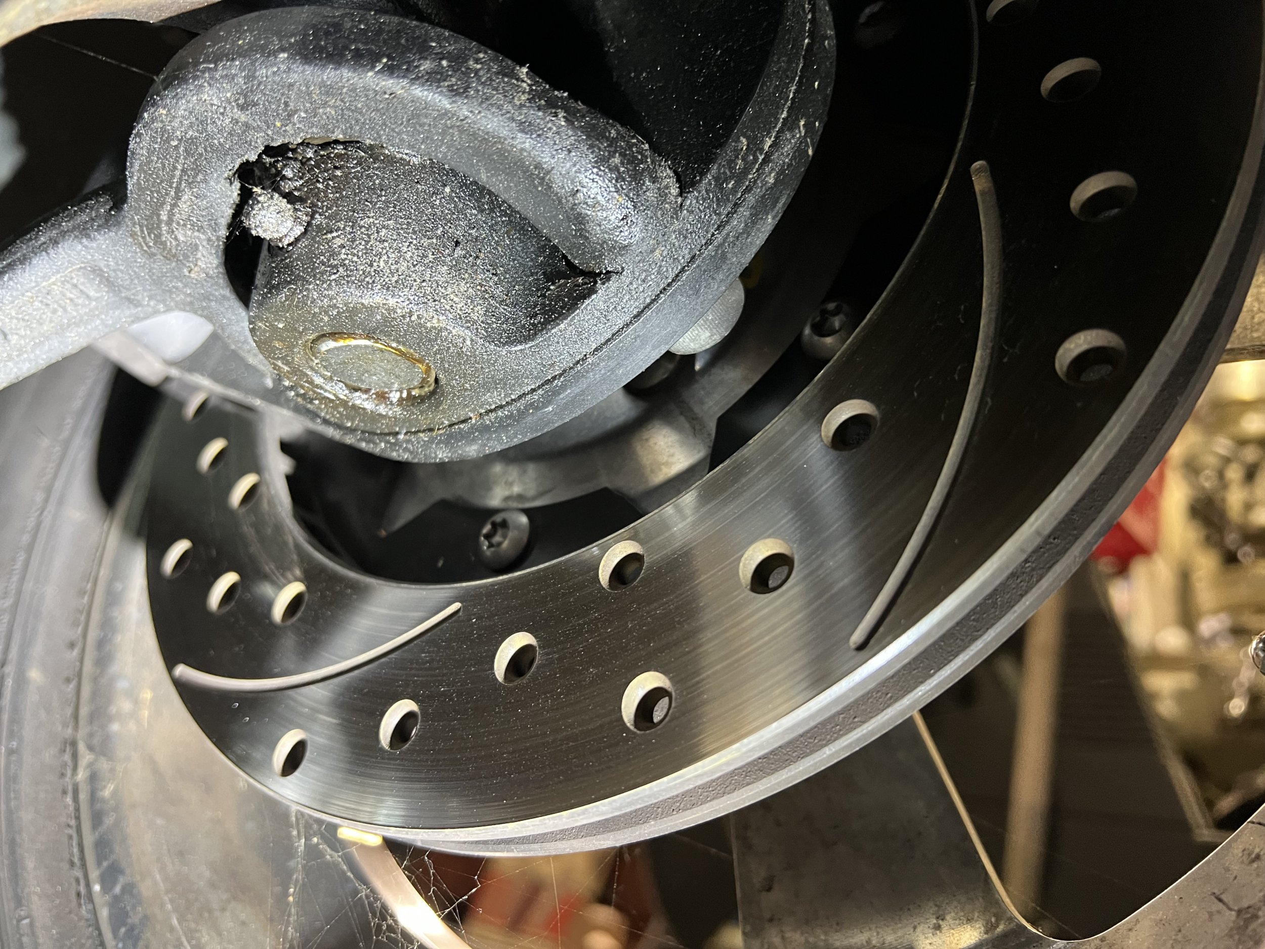

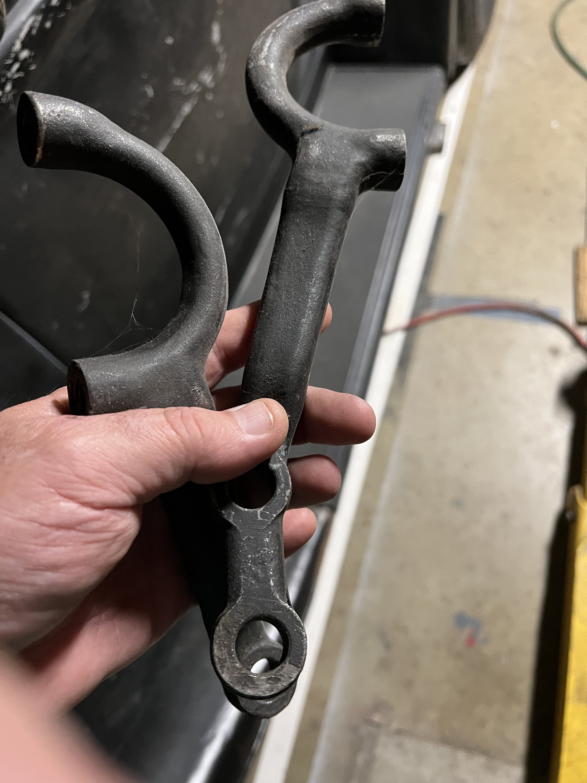

    Here is pic what Op looking for,?
    To make this style 3/4 -7/8 plate ,
    But could be done
    5/8 ,
    I took the P&J extra long & heat to bent
    To clear a Non split bone on a 32
    lostone likes this.
  13. wheeltramp brian
    Joined: Jun 11, 2010
    Posts: 3,395
    wheeltramp brian
    The flat type are good because they clear a dropped axle without clearancing them.
    lostone likes this.
