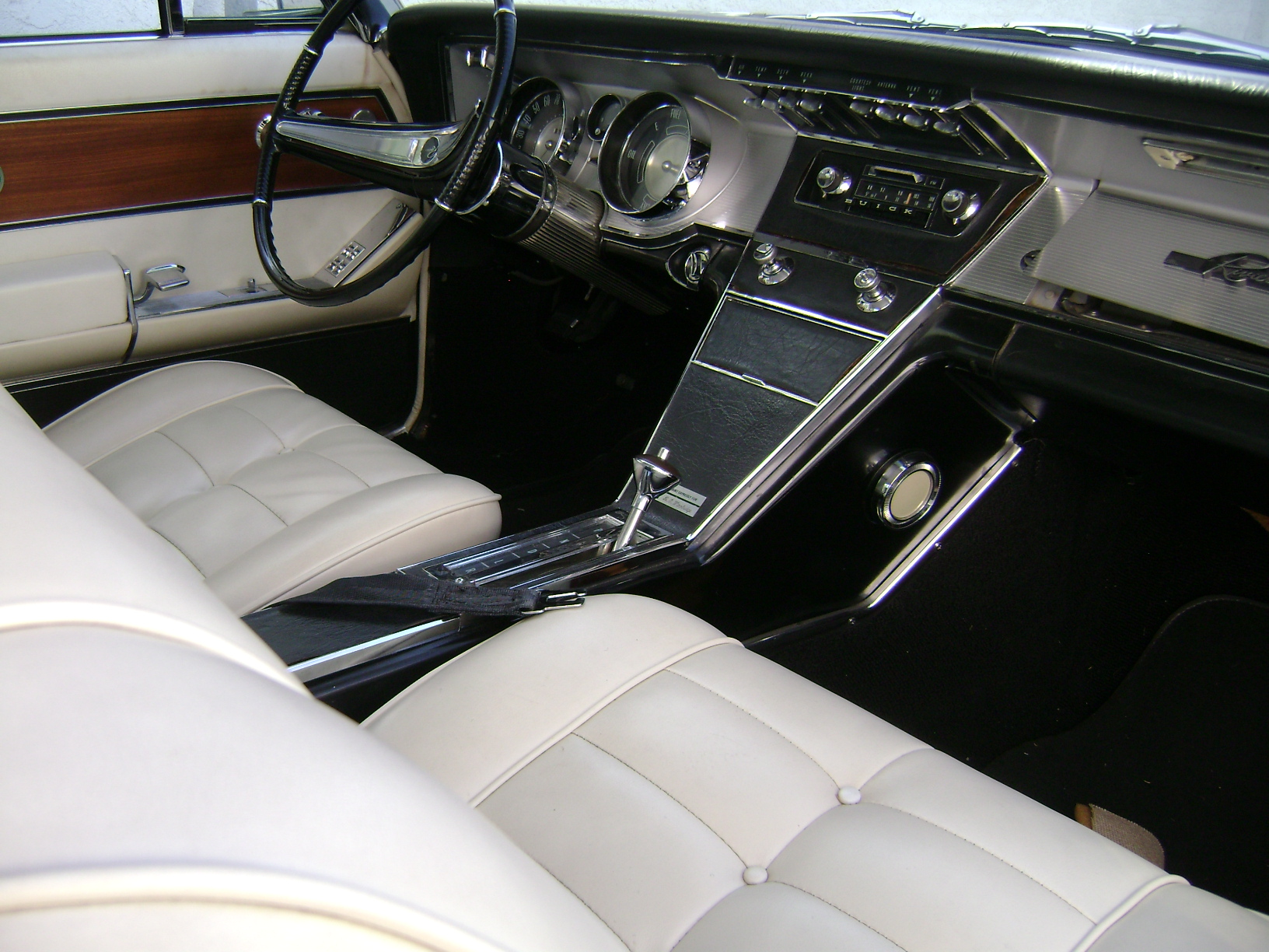

  1. One family owned (Mom and Son) with lots of options (1/2 of which don't work-LOL), but a pretty fucking nice car. So, is there a seperate switch for the "Country" horns that look like trumpets and R mntd under the left side of the hood? And where's the fader for frnt/rear speaker (the surround by the tuning knob does nothing)? THNX

    There is no separate switch for the horn. Your trumpets were probably added later? As for the fade, it should be the "background" knob located behind the volume knob. The often fail.

  22. The one behind the volume seems to adjust tone, and the one behind the station changer does nothing. (probly failed as you said). On the trumpets.......a guess woulda been they're not legal in town (I vaguely remember the term "town and country" horns) and therefore been on a separate switch(?)

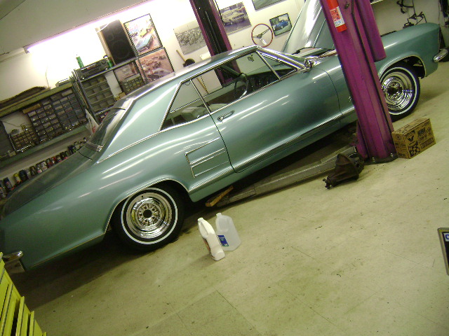

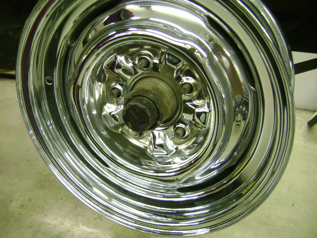

  23. So much for all that. My wheels won't fit over the hubs (frnt) or axle flange (rear) DSC07812.JPG

    First off , thats a hell of a nice Rivi! As far as those wheels are concerned , just open them up with a reamer and they will be fine.
    Its hard to find wheels to fit those large riviera hubs.
  26. If you know a machinist, he would be able to help you open up the center bores on your wheels.
  27. 1/4" spacers DSC07817.JPG
