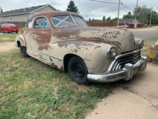

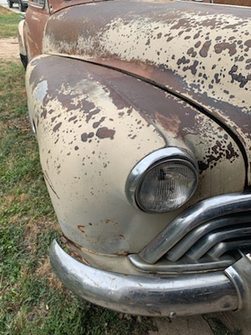

    IMG_2302.jpg IMG_2309.JPG IMG_2304.jpg IMG_2303.jpg IMG_2300.jpg I just picked up this solid 1946 Oldsmobile project. This car lived in a garage across the street for the last couple of years. The chance to buy it came up and I jumped at it. Not sure of the Plans yet. Leaning towards a mild custom. Lower a couple of inches and make it able to drive highway speeds. Might not be the easiest with the stock straight eight that is in there. So I will probably be looking for a motor trans swap. I really am digging the great body lines on this car. I definitely want to paint it as I don't like the "patina" look. Many cars deserve to be saved but this one I think is a little too far gone.

    That car looks extremely solid. No rust in the usual places (that I can see), and the trim on the drivers side looks real good. That puts you ahead of the game.
    As to highway friendly, I don't know much about Oldsmobile straight eights except they are 257 cubic inches. I have a 255 merc in my '51 Ford with no overdrive and 3.55 gears, and it will cruise all day at 65. I can't believe that Olds is much heavier than the Ford, and it looks more aerodynamic. I would think a little head work, a better ignition, and upgraded carburation would make that a decent highway cruiser.
    BTW, Hydra-matic or stick?

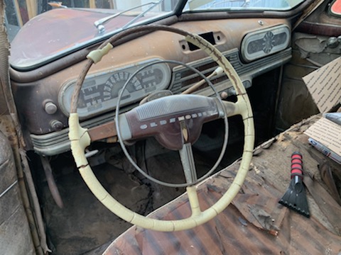

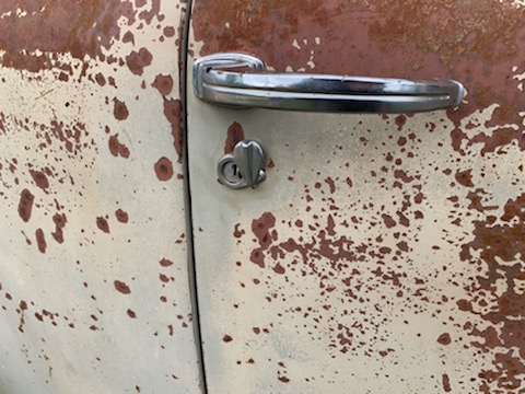

    The car is an automatic Hydromatic drive. I will see if the engine runs and then decide what to do for engine and so on. Here is a few more pictures!

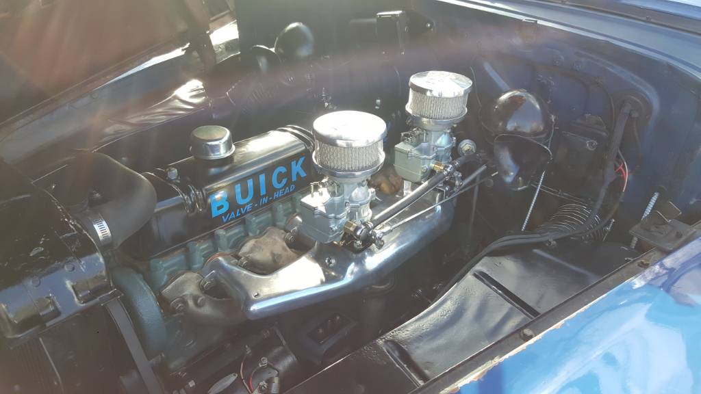

    Here's one that belongs to a customer of mine. Just for a little inspiration. I know it's a Buick but their kissing cousins.

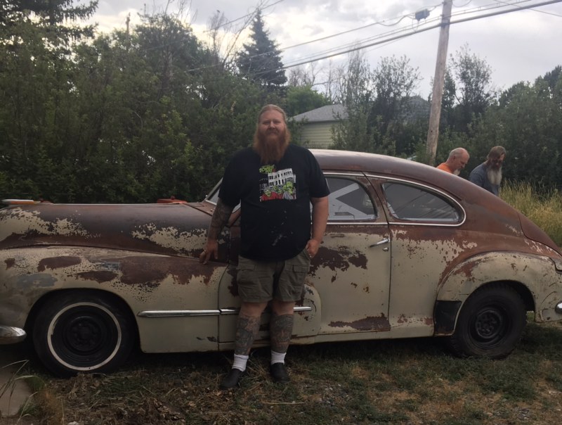

    I had the crew to push the car home. It literally had to come from across the street. maybe about 150 feet total. I ended up with more help than necessary. I think some of them just wanted to see the new project. @winduptoy are you and Rick going to make the Hill Climb in about a month? I hope to see you down there.

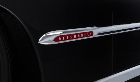

    Same body as my Olds 46 sedanette, model 76 (Straight 6) Dynamic Cruiser however spears on your front fenders aren't 46 but 47/48, check your data plate for style as prefix indicates YOM. 76/8 was the intermediate 'B' body, 'A' bodies were 66s with 'C' bodies being 98s. Yours is a 78 (Straight 8). Wrap around rear bumpers give it away as a 'B' body. 'A' and ''C' body parts won't interchange with 'B' body however some may.
    • 1946 - OLDSMOBILE name in an oval recess in the fender molding;
    • 1947 - OLDSMOBILE name in the molding but not in oval recess as per '46; and
    • 1948 - Plain chrome molding without Oldsmobile name.
    1946-1947, triangular emblem with grill blocks and full chrome grill. Rubber gravel shields on rear fenders
    1948, circular emblem with no grill blocks and painted lower grill tray. S/S gravel shields on rear fenders
