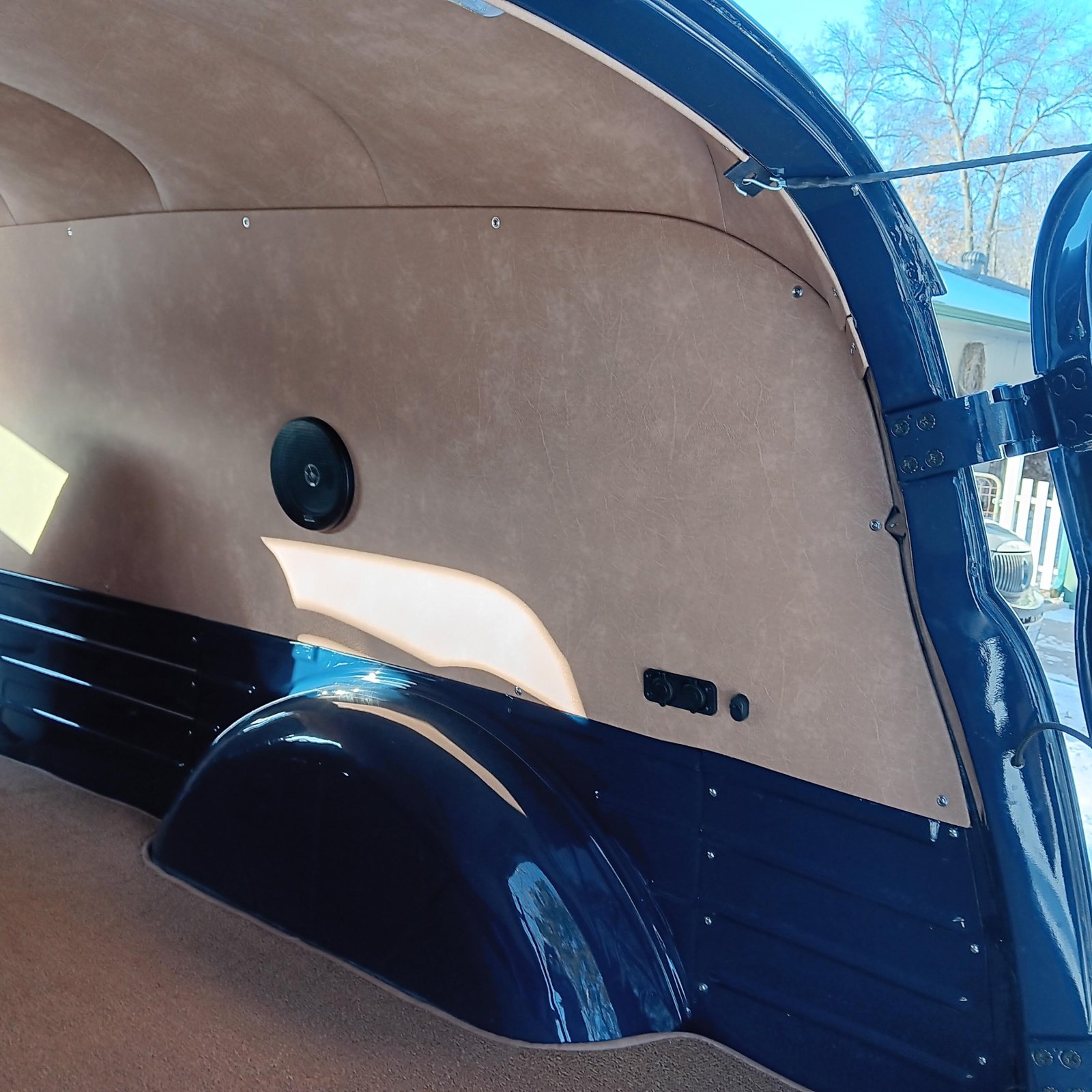

    Here is a pic (not Clarence) that shows where they go and what they look like. Obviously they are disconnected from the doors.
    Here's Clarence with the temporary cable hold open strap:

    No shame in my game. I've lost count how many parts I've had plated that were left assembled. You get a minor misplate where the rivet is. Who cares. The majority of parts like this are not meant to be scrupulously inspected even in show venues. Discuss it with your plater. Sometimes it simply doesn't matter. What have I done it on? 6-figure restorations that still netted perfect judging scores. Who else does that? The OEMs. Some things don't require such a deep dive into the should I pool.
    Quick edit; I'd plate em fully extended so they look best when the door is open. Pretty dark back there when they're closed, right?
