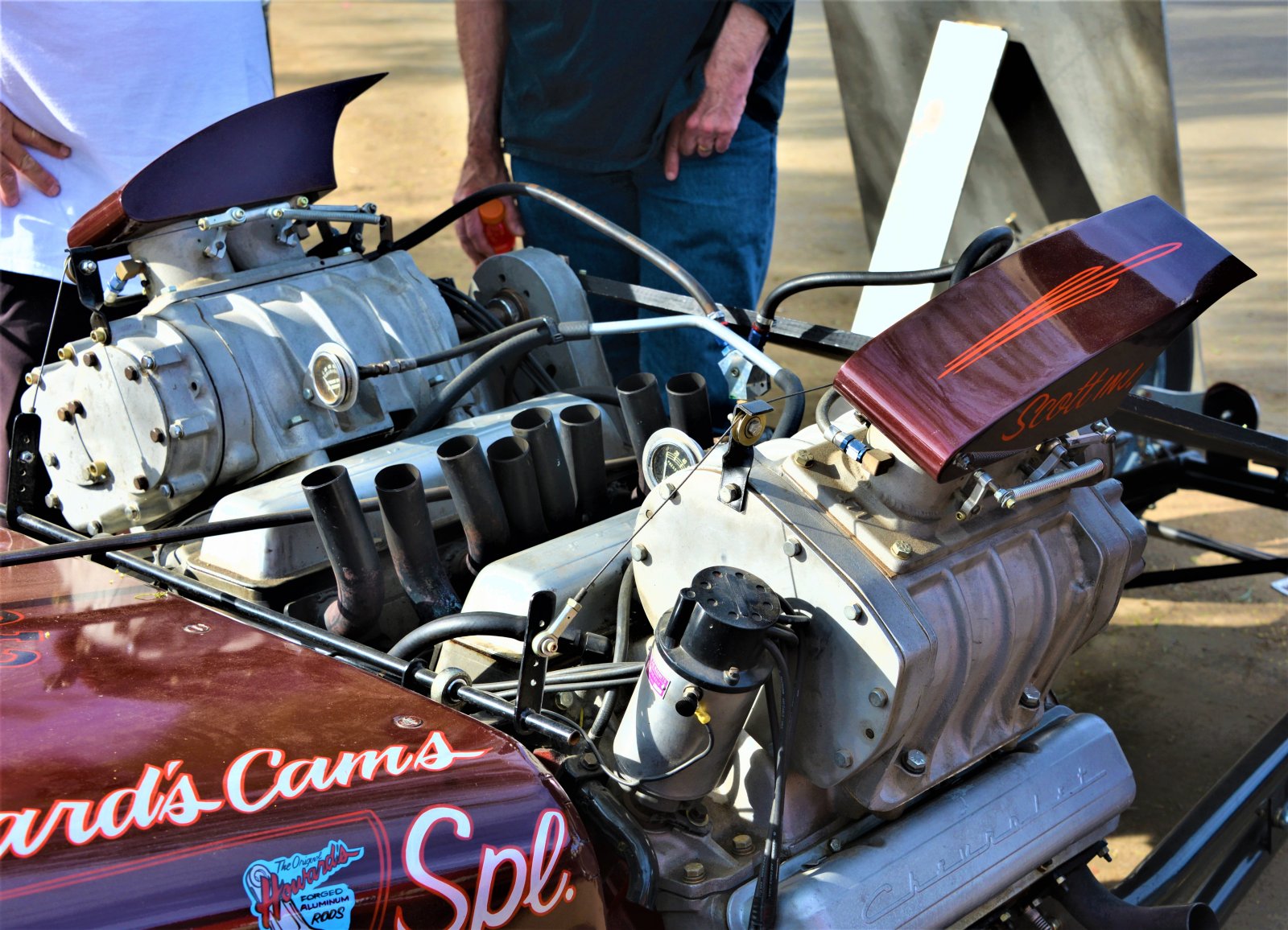

    Wait... I only count three magnetos. Maybe the fourth Buick engine was a compressor for the airbag suspension.

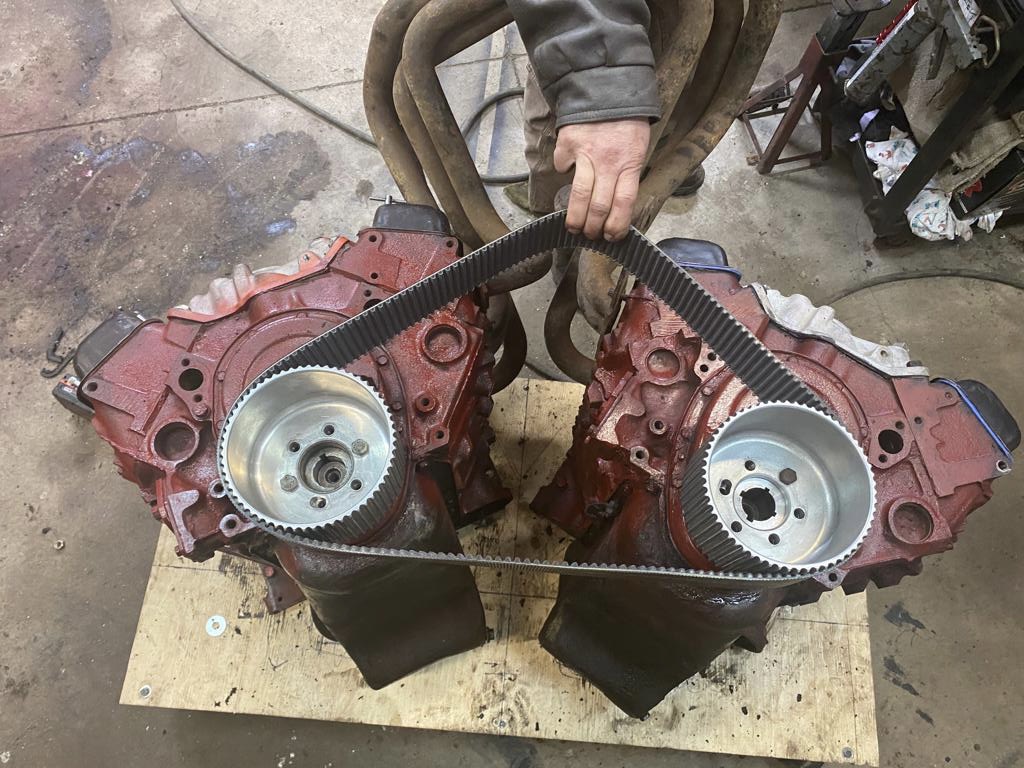

    We built a two engine racecar powered by inline SBC’s connected with a chain coupling so both engines spin together all the time. It starts off of one starter and a large battery. Only the rear engine has a starter. They’re not high compression engines so one starter is enough.
    our next project is a side by side twin engine car with the engines connected by a glimmer belt like for a supercharger. It will only have one starter and probably won’t work.

    There are four. The one you cannot see is shorter.
    The forward-most is shorter, too.
    Outback, Driver50x, Deuces and 7 others like this.

  21. Use a chain. A 60 pitch double throw will hold it.
    Lots of side by side setups are gear drive. You can source the setup from a boat. Depending on how it is built one will have to run backward. I have seen them set up with a gear setup that allows both engines to spin in the same direction. I do not have my good computer set up, if I did I could draw it out for ya.
    That said I would chain them before I would try a Gilmer belt.

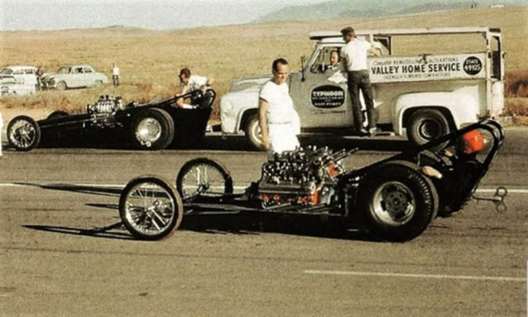

    When Tommy Ivo brought his twin to Lion’s Dragstrip in the late 59 time period, he was getting ready. By the end of December, he was in compe***ion mode and showed up at the huge Riverside Raceway Drag Meet as known as… “The East vs The West” event. It was the biggest event in So Cal for the times.
    The black cladding then turned into the more popular red cladding.
    Tommy Ivo at the December 1959 Riverside Raceway drag meet, staging to run against the Valley Home Services supercharged SBC, a fast FED.
    Then, when that meet was over and the new year settled in, he started setting top speed and low e.t. records at various So Cal dragstrips. He topped it off at the Bakersfield Smokers March Meet #2. Where he did an unusual thing…

    Ahhh...I see it.

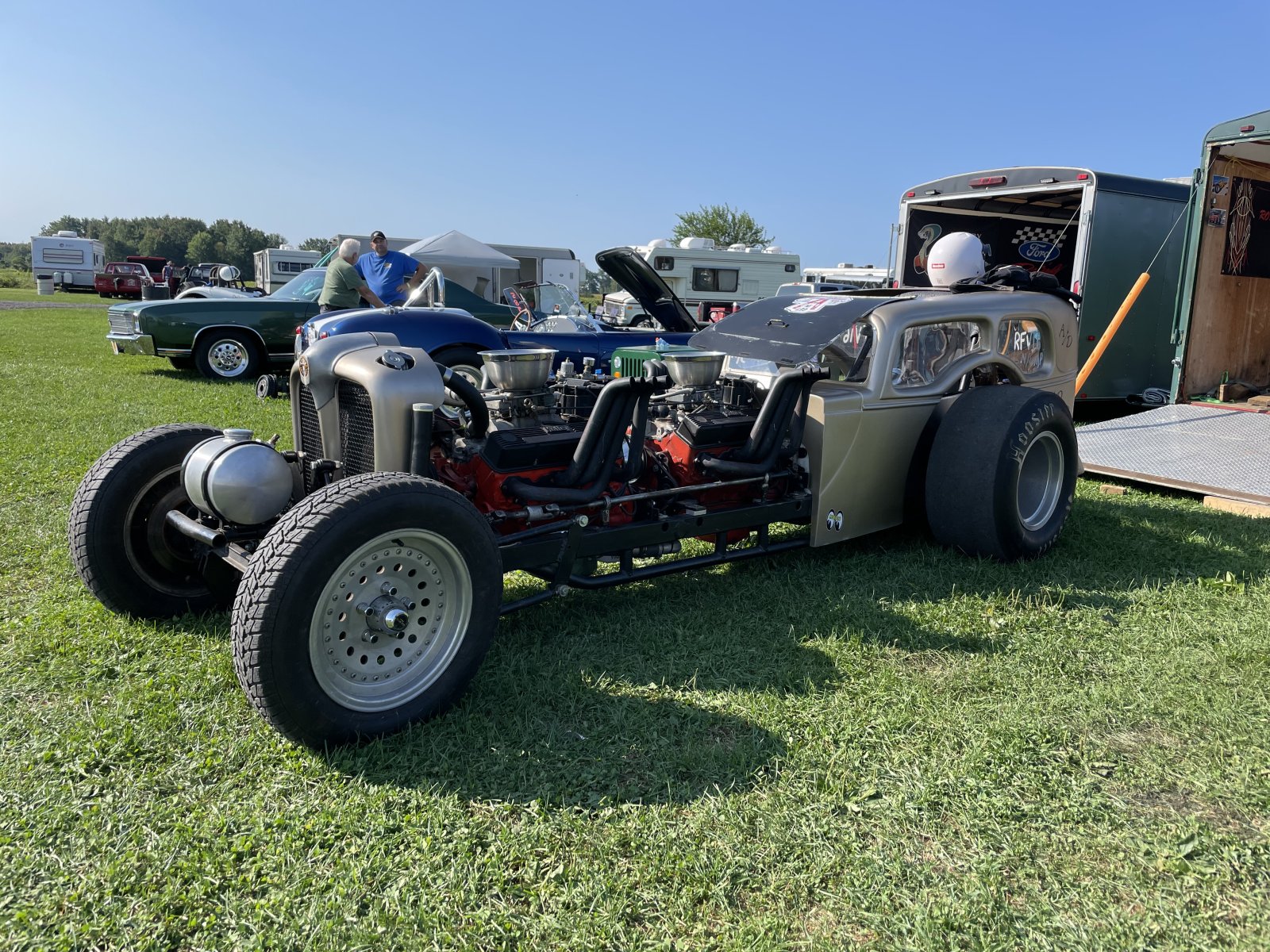

    One of my favorite twin, FED dragsters, as seen at the CHRR at FAMOSO in 2016.
