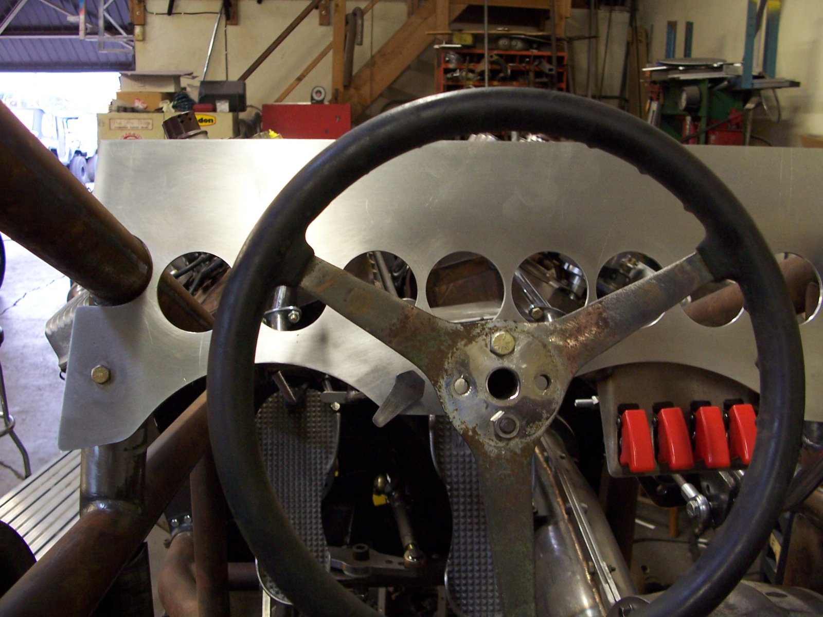

    The 4 engine car was always push started and without provision for starters. There was also only 1 clutch peddle to operate both clutches . Inside the drivers compartment there was a lockdown lever to hold the peddle down while pushing the car, without it, Ivos skinny leg would start shaking. after you got use to it, with being pushed started, you could light all 4 at a single time, and being on gas, made that much easier. The 4 mag switches are on the right and they were all tied together so that they all shut off at once upload_2023-2-18_10-1-9.jpeg

    Ivo must have been a compact dude.
    I'm not overlarge, and I couldn't even get into the seat.

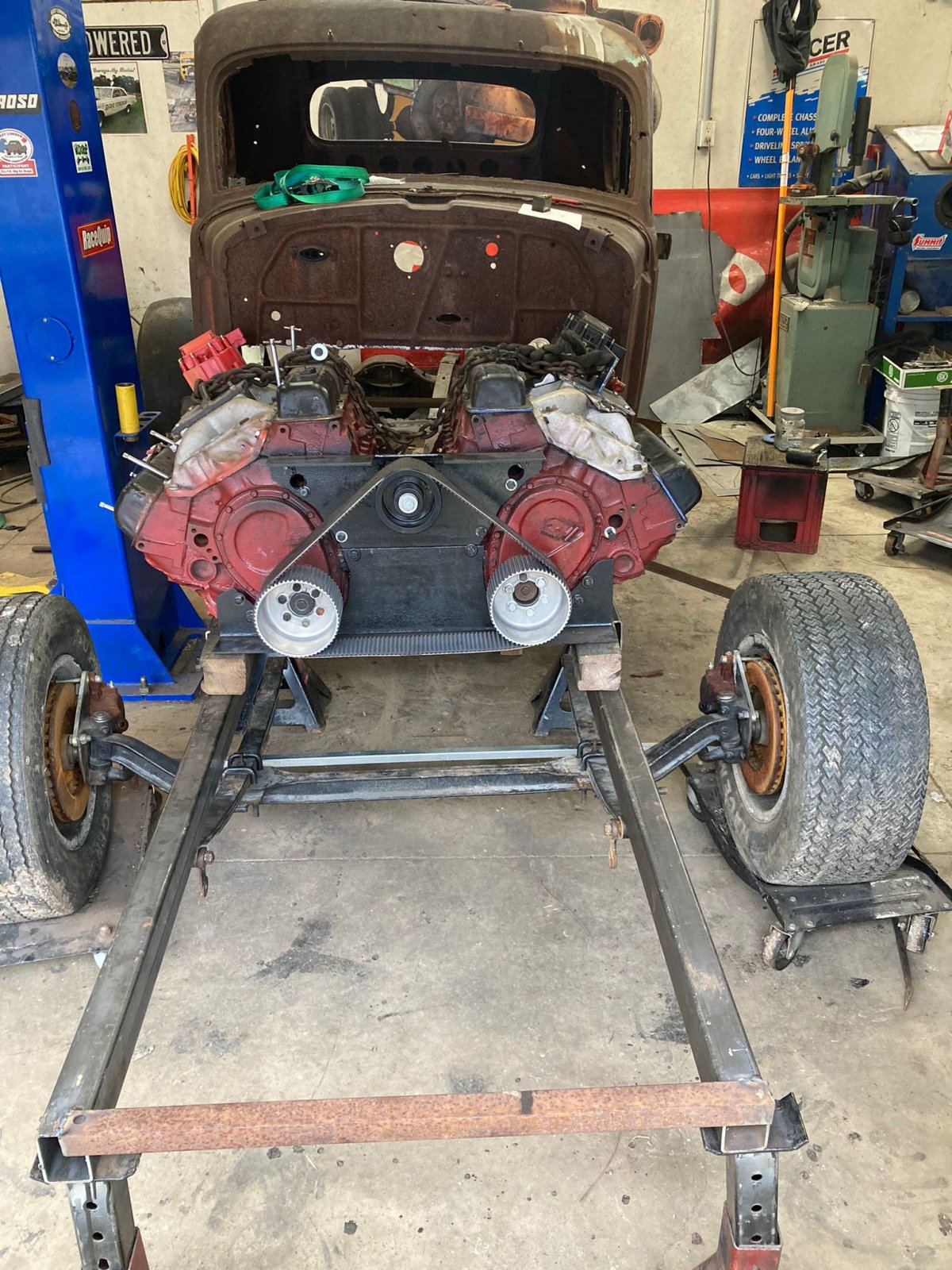

    Things to consider by using a belt drive, Unless you are extremely lucky with the pully teeth, you are going to need tensioners top and bottom, one to take up the slack to keep the crank timing equal and the other to take up the belt slack. Since the pulley hub sticks out from the crank snout, and the extra keyways, it weakens the hub and it will split, roll the keys out of the snout, Generally ruin your day and wallet. ATI makes a SBC blower hub, but the OD is the same as a BBC to give you more "MEAT" around the snout and much harder to crack with 2 keyways and there are some aftermarket front covers that will accept the bigger seal. Or if you have a good machinist, they can shrink fit a Chromemoly sleeve over the stock hub and then machine it down to BBC OD.
    All and all, I never heard of anyone doing a front belt drive, I know its probably been tried before, but must be a reason it never caught on and why meshing the flywheels did. The last side by side twin was build a few years ago by Rocky Phillips
  16. AldeanFan
    Joined: Dec 12, 2014
    Posts: 1,184
    AldeanFan
    thanks for the cool video!
    This isn’t my own project, it’s a project I’m helping friends with. And by helping I mean mostly drinking their beer. I don’t think the blower belt will work, but we need to confirm that before moving on to other options.
    If we only did things that are proven to work we would be building a turbo LS engine lol.
    The inline two engine car initially had a double cardan joint between the engines. That failed spectacularly and broke a crank before we gave up and built a chain coupling.

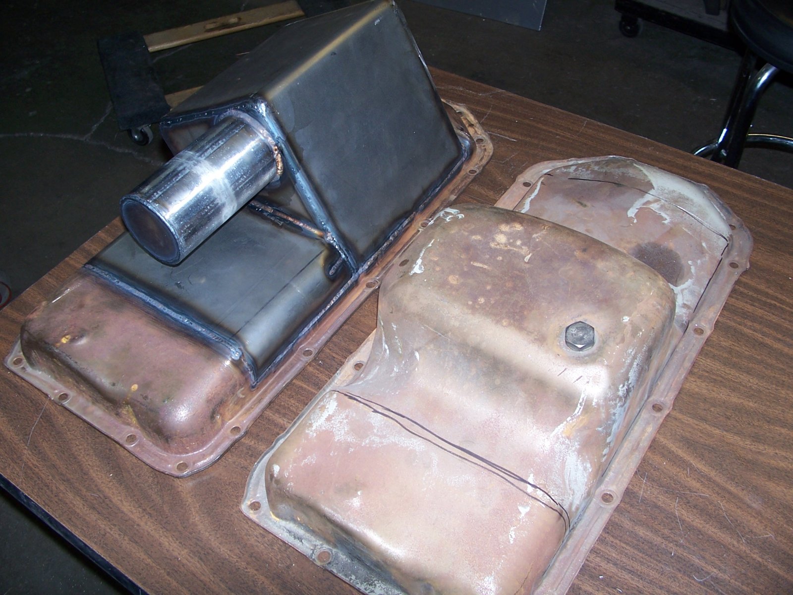

    Our current concern is wether we need to modify the oil pans for the engines being on an angle. One theory is the bottom of the pan must be horizontal. The other theory is that we just need to modify the pickup to **** from the lowest point in the pan and there’s no reason that can’t be the corner although windage might be a problem with a stock pan on an angle.
    gimpyshotrods and 41 GMC K-18 like this.

  27. AldeanFan
    Posts: 1,184
    AldeanFan
    My friend’s current project
