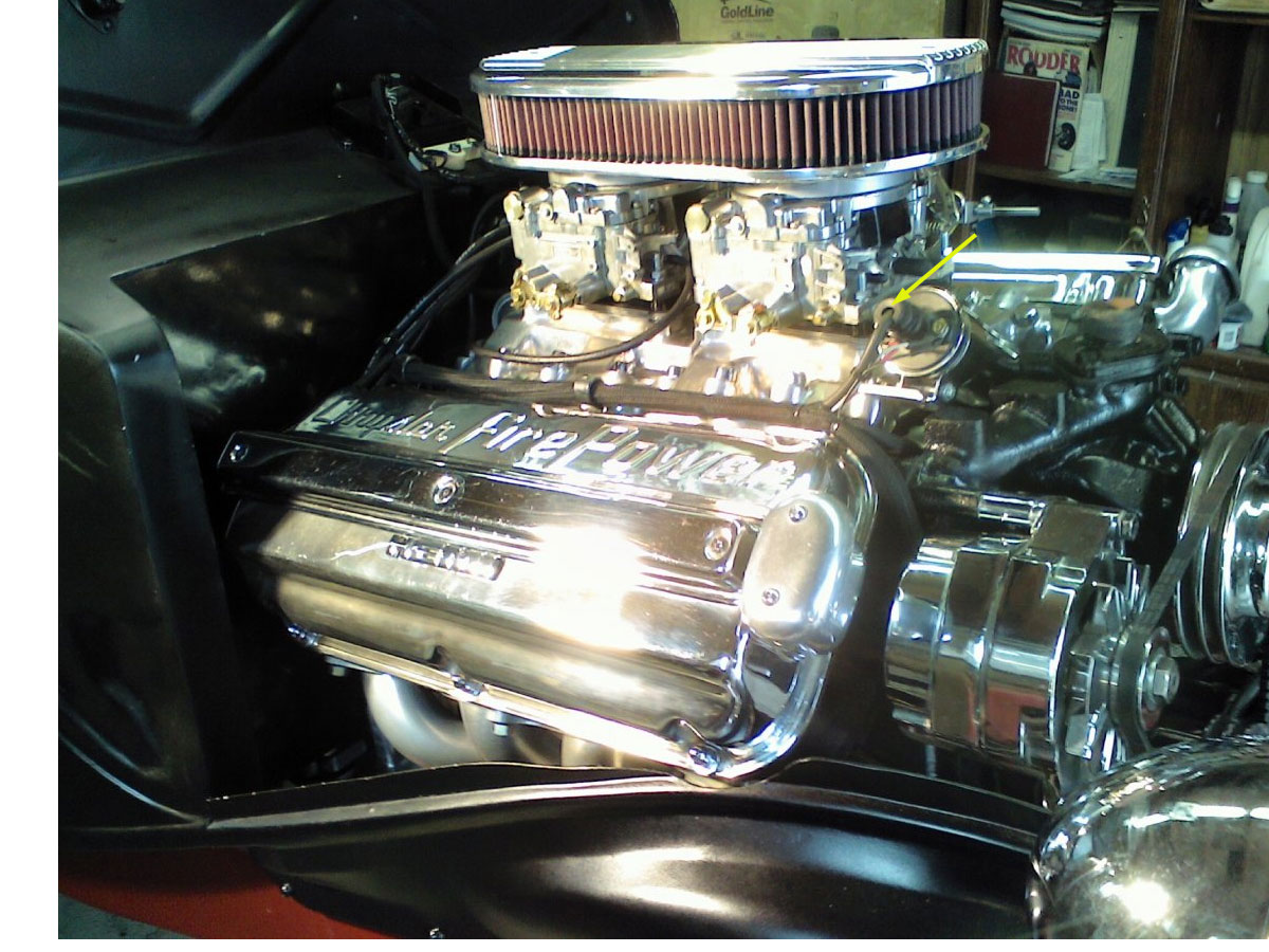

    I empathize strongly "may have" found and eliminated the miss in my 331 that I decided to chase down and get rid of, way last April. I've posted at least twice before that
    I had found it and got rid of it, only to have to eat my words and slink away into the darkness. I have yet to put it under load on the road and will after tidying up a few loose ends. It starts better, runs quieter, and sounds better and it ran good at 5500 in the drive, all this without the miss, (now I just jinxed myself), but as 31Vivky as reminded me, the proof of the pudding is on the road and under load. I finally smartened up and won't say what I discovered, and how I went about fixing the problem. I'm tired of way Crow tastes.
    This shot give a clue as to what I believe it was if you want to take a guess. may 13-20 3.jpg

    All the coil wires bundled together ?

    To much shine to see the spark jumping from the coil high tension wire to one of the primary terminal posts? I always run one with a miss in the dark of the night to watch the light show

    The coil wires bundled together creating a magnetic field that was screwing with ya !

    Gotta go with the coil wire bundled up with the others.

    Ballast resistor arcing to rear of air cleaner base

    You just added the ballast resistor or you didn't need the ballast resistor..................

    :rolleyes:...A few Wild N' Crazy Guess's...Void in Coil Wire dust cover on coil end (see Arrow) exposing possible arcing issues,
    Second guess...
    I'm ***uming a Vacuum hose is being used on aft Carb at fwd right side but capped off on front carb creating possible unbalance or...
    Thirdly...
    Possibly a coil wire internal breakage by side pull tension at coil due to existing shear condition induced by an overyanked wire...in the loomage for those with dirty minds...
    Lastly...
    and I think Coil Angle had possible ram...Get That...Ram-ifications time for ******coil...
    Coil acting up due to inner coil oil coverage...it was discussed recently in another Thread...

    Like others have said. I’ve never seen a coil wire bundled together with other wires. Mount coil to rear area closer to distributor and don’t wire tie it to anything.

    Answer is yes and replaced it and a "before".

    Always had the resistor but replaced it with MSD 8 ohm resistor.

    Okay now back to the problem. All you pointing to the coil is in my opinion, right now at least, is where I have made the change. Originally mounted to the intake caused the coil to go bad because of getting repeatably way to hot ......I think.
    I have now moved a new MSD coil to the firewall and that along with an 8 ohm resistor are living in harmony with the new MSD distributor and wires. All the ideas everyone came up with are new ones to me and maybe anyone of those could also be the culprit, I really have no idea.
