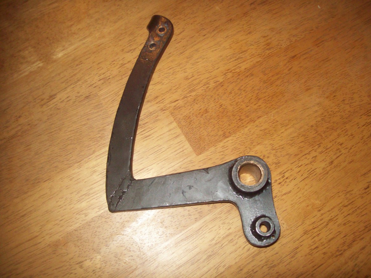

    This is the modified brake pedal I removed,it appears to have been shortened at least 5".
    This is the Pete & Jake's replacement. HRP

  9. Danny, that's what I figured happened, I posted in your other thread.
    The pedal will be into the steering column.
    If the pedal pivot can't move rearward the foot pad MUST be at the end of the 12" pedal.
    If the foot pad needs to be located where it is, the pivot MUST move rearward.

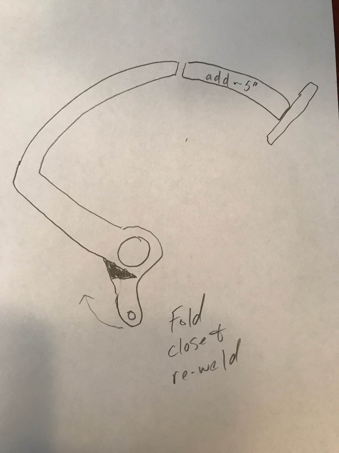

    I literally just went through this very same issue. Here's what I ended up doing.
    Because of the way I built my frame, the crossmember was smack dab in the way of the brake MC mount that I had bought. Additionally the straight part of the brake pedal (same pedal as you have) was hitting my floor substructure. If I moved the whole ***embly forward, the curved part of the pedal was in the column. What to do.
    I ended up notching out a rather large C section to clear the substructure in the floor. Then, because the "throw" of the pedal would not provide me with the correct geometry to give me leverage, I extended the curved portion of the pedal arm by about 5" using the same arc. Works great.
    I also had to make a new MC mount and machine a longer plunger to go under the crossmember.
    Not sure if my pic helps. If you need a close up just holler. [​IMG][​IMG]
    Forgot to mention the most import part. The piece pedal arm under the pivot, that connects to the MC plunger rod, had to be pie cut and made to that I still got the actual travel I needed when pedal was depressed.
    I'll draw a pic and attach it here shortly.[​IMG]

  12. How far over did you bend it.
    Pedal ratio is figured in side view.
    So if you put a Z type bend in it, that shortened up the ratio again
    ladyhrp and HOTRODPRIMER like this.
  13. jackalope
    Joined: Mar 11, 2011
    Posts: 692
    jackalope
    Nope. Everything remained the same. Essentially just moved the location of the actual pedal and MC plunger hole AROUND the main pivot. Ratio completely unaffected.
